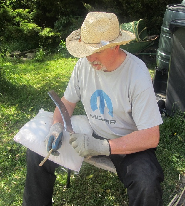

Making Spars for the Cottage Re-thatch.
In essence, these are Hazel staves that have been split into 4 "quarters" and to about three feet long.
These are then soaked in a tank overnight, and then an idiot in a straw hat has to cut each end to a sharp point.
These are then twisted in the middle so it looks like a big hairpin.
It is now a "Spar".
This is then used to "pin" the "Yelm" in place on the cleaned up elevations of the cottage.
You then make 9,999 other "Spars"; which is nice..............
Pete Spars.jpg (207.12 KiB) Viewed 1811 times
You don't look very happy in your work Pete .........or is that concentration ? :D
What's the tool you are using called ?
Looking good fella :thumbright:

Must say you look thrilled Pete :D
Trigger_Andy
Posts: 7867
Location: Stavanger, Norway
Post by Trigger_Andy »
I think its called a knife Mossy. :D
Looks to me like a double handles Skinning knife thats snapped?

What are you whittling about?
Posts: 7111
Looks like a broken draw knife to me. Could be wrong.
Posts: 22109
It was a Rape bailing knife that I took an Angle Grinder to........

Pete wrote:It was a Rape bailing knife that I took an Angle Grinder to........
Wondered if it was a thatching thing ..........

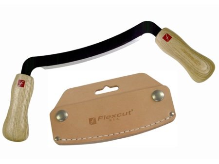

Posts: 7111
Yep. That's what I meant by a draw knife, Andy. An old fashioned one has straight through handles though and is just a curved blade.

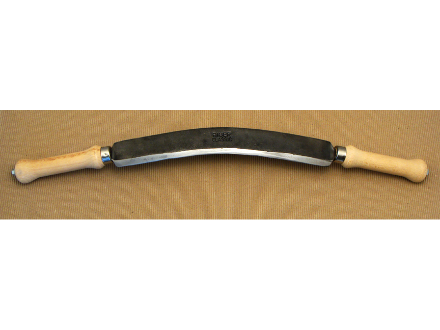

Posts: 7111
More like this. But old looking. :D
