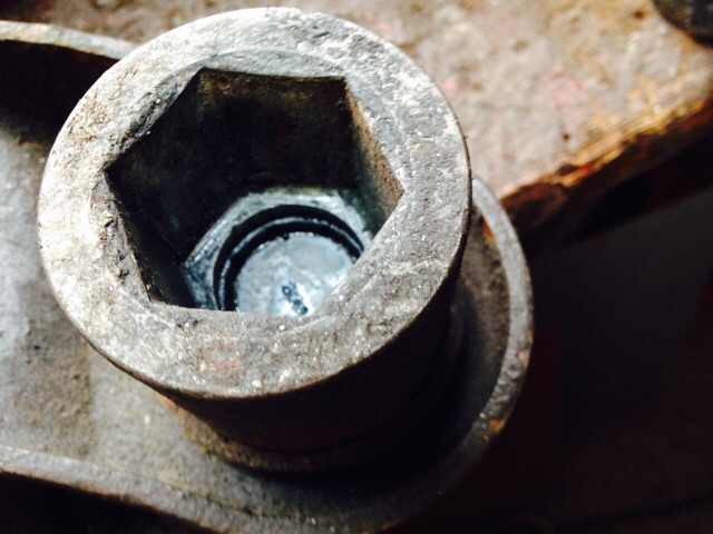

There was for a short time, a glimmer of hope that my Charger would be at the Nats next week, but then, while tightening the LCA pivot shaft nut to 130 ft lb's ( as stated in the FSM ), it sheared off.
I'm using the Hotchkis, greaseable pivot shafts ( same as Morgan, pictured in previous post to this ).
I know my torque wrench is correctly calibrated and I've checked the specs in the FSM twice in case I misread them. Can only assume that the Hotchkis pivot shafts need a lower torque setting than original Mopar ones do. If I order another one today, it won't be here until the end of next week at the earliest, so, I'll have to do the Nats in my Fox Body :banghead:
Anyone know the torque setting for the Hotchkis pivot shafts?

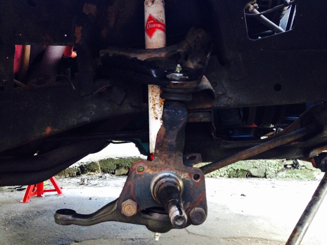

Also, does the spindle look ok in the pic below?
I'm convinced that the bottom of it is leaning back ( towards rear of the car ), it also looks like the sway bar links will be on an angle as well, I'm almost sure that they should be vertically straight.
I'm thinking that the LCA isn't sitting far enough forward where it bolts to the lower ball joint.

Just spoke to a guy at Summit Racing via live chat, explained that the pivot shaft had sheared off when torqueing up to FSM specs, sent him a pic of the sheared off shaft and he is sending me a replacement pair free of charge.
also received the order confirmation via email.
Great customer service :thumbright:

Rebel wrote:Also, does the spindle look ok in the pic below?
nope. looks totally wrong. I know it isn't at ride height but the lower ball joint shouldn't be that far back behind the top. that looks about 5 degrees negative caster. with power steering you need about 5 degrees positive at ride height.
as the suspension rises the top ball joint will move back but the bottom will also due to the arc of the tie rod until it is parallel. from then on the caster will go more towards negative as the suspension is compressed more.
the top arm is angled for antidive but this means when you accelerate you lose caster.
also with cars jacked up at the rear the caster is even worse. must drive horrible with a set up like that.
I would say on droop there needs to be zero caster (top ball joint directly above the bottom then as the suspension compresses the caster should go to a decent amount. I do basic set ups on race cars so have done a fair bit on set ups.

Thanks Boz, I'm not driving it like that, just busy putting it back together. The strut rod isn't tightened up yet, so it should pull forward a little. I'm more concerned that the new LCA bushes are causing the LCA to sit further back than it should. I was thinking that the spindle should be inline vertically, making both ball joints line up with each other.

At ride height the top ball joint should sit back a touch further than the lower, so the spindle leans back a bit, that gives you caster, picture the forks on a motorbike for an exaggerated image. I think those LCA studs must have a lower torque setting as they are hollow rather than solid like the originals.

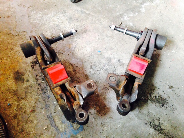

Had a look at everything earlier and found the below that might be causing the issue.

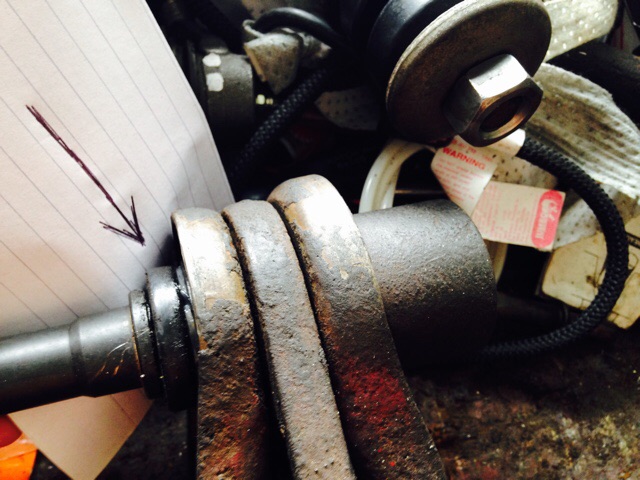

I'm assuming that the pivot shaft should go all the way in to the LCA, as can be seen in the pic, there's a gap between the end of the pivot shaft and the recess for it in the LCA. ( this is after trimming the bushes by the same amount as Morgan had to with his )
In the second pic, the black part with the arrow pointing to it is part of the poly bush, this coincidentally looks to be the same size as the gap left in the LCA recess. So the pivot shaft needs pushing in by that amount?
Looking at a set of original rubber bushes, they seem to sit flush with the LCA, so I'm now thinking that if the arrowed bit of bush wasn't there, the shaft would be in the LCA all the way. Meaning that the LCA would sit closer to the K frame, therefore eliminating the problem of the lower ball joint being to far back?
