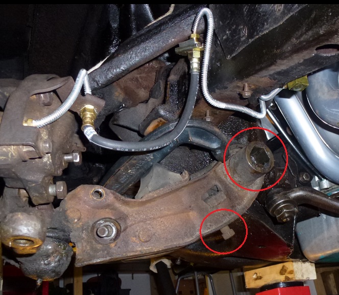

Here is a pic of mine before I rebuilt it all - note the hanging LCA and adjustment bolt. Does that help ?
- rebel.jpg (153.34 KiB) Viewed 1122 times
Thanks Morgan, it does help.
Thanks Blue, it doesn't look as though rust is the problem, the adjuster bolt was moving freely, think it's probably because I've left the jack under it, creating load when there shouldn't be any
