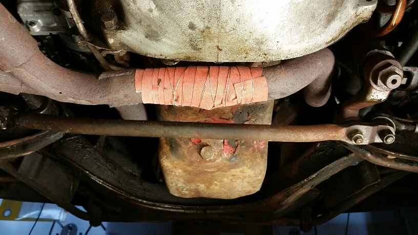

New carter carb needed
- 20151016_170809_resized_1 (1).jpg (158.71 KiB) Viewed 2031 times

Sammy, I would recommend taking Pete up on his offer to look, he won't give bad advice and knows his stuff. I can let him know exactly what I have and he will be able to explain all.
You can trust Pete, to be honest it doesn't sound like you can trust your Exhaust man!

2) in My opinion your exhaust should not be costing that much. Pull it out of where it is and get in touch with JohnR or Anton on here. Anton is APD automotive

there would be delivery or travel costs I'm sure but I can't think either would charge £750 to weld up an exhaust.
