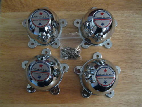

Have we a picture of said caps?

As requested .....

Ah...OK thanks...similar then

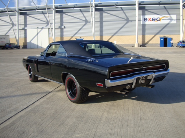

275/60/15 on 15x8 should fit fine on the back of charger as seen here , but this was 4" back space from memory , along with 15x7 on the front with 225/70/15 :thumbright:

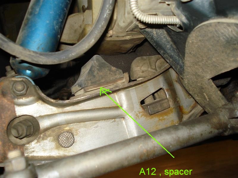

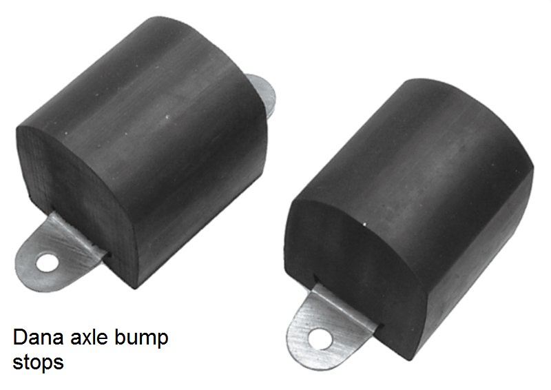

Your welcome to try my wheels Lee , although you only really need to if you want to replicate my set up exactly ,because it is tight on the front at full lock with the suspension dropped onto the lower bump stops , that's why for a extra margin of safety , I fabricated version of the A12 front lower bump stop spacers ( see picture below ) , yes wait till the better weather ,& no rain , the chargers locked away in fort knox at the minute haha , think it would be an idea if I came to you ,would be a major logistical battle plan to get both chargers side by side where I am , with out getting the unwanted attention of neighours & the like , with in a half a mile radius .

Yes that the black 70 charger looks a good set up (HEMI472) 275 looks good on a 15x8 wheel , think 4- 1/2 back space would be the best at the back , or get a custom wheel made maybe .. 15x8-1/2 with 4-1/2 back back space or a 9 inch maybe . . the 70 series tyre looks good , has that back in the day look to it , on our type of cars , I never tried to 70 series on my wheel rite thingy though. (( forgot to mention the other night , if anyone decides to buy one of these percys wheel rite things , its a good idea to have a supply of wire coat hangers , to bend up into various tyre profiles you want to use . will be much quicker, as in the kit they only supply one piece of soft bendable wire )).
all the above sizes I posted above , was factoring in , having the tyre tucked under the wheel arch , with a safe amount of clearance between the wheel arch lip & tyre wall , under all of the suspension travel & steering angles , & to give it a factory lookish ! not a gasser style . also I forgot to mention , I have the stock 11x 3 inch drums still on the front , i'm not sure if any of the aftermarket disc brake set ups would alter the front tracking width ? ... although I think this would only matter if you was going to use a 255x60x15 tyre with a 15x8 wheel with a 4 inch back space up front . a 15x8 wheel with a 4 -1/2 and a half inch back space , with a 235 or a 245 x60x15 tyre your be ok , same with a 7x15 with a 3.75 back space , 225 or 235 or 245 , there are guys in the US running255 on that size wheel too , although I personally have never measured that size my self with the wheel rite thingy. will have a look for all my notes & findings I made , with said wheel rite , sometime over the weekend & post here , might be of help to someone .
also thinking about it ( just for reference ) when I mentioned stock suspension, I was referring to , NO tubular upper or lower control arms or K frame ,, or coil over shocks , just the basic Chrysler desgine ,although mine has lower control arm reinforcement plates , 1 inch solid steel strut rods , A12 desgine lower bump stop spacers, polly graphite bushings front & rear , solid 1-1/8" front & a 7/8" rear sway bars , 1 inch MP torsion bars , ( imo 1.03 or slightly larger would be the size to get with modern tyres , mopar XHD rear springs & polly bushings & dana axle bump stops , plus lots of K frame & chassis strengthening mods etc . mentioned these just for reference as in mine is stock ! but not stock if you know what I mean . not sure I would want to fit 245 or a 255 tyre on the front of a straight 6 car with out a sway bar .

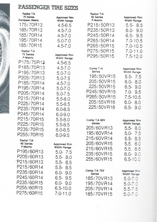

something also found out a while back, all over the internet these days , long before the internet & computers , I collected all the info as we do ( started collecting when I was at school before I even had the charger no joke ) :oops: :shock: , about our car etc for future reference from various sources , well the BFG Goodrich info plainly stated back then , as follows
tyre size rim width inches
min max
225 -- 6 - 9
235 -- 6.5 - 9
245 -- 7 - 9.5
255 -- 7 - 10
all these above were recommended min & max sizes , in various publications & tyre companies info at the time .
now with the advent of the internet , you do a search & this is what you find
tyre recommended rim width inches
225 -- 7
235 -- 7.5
245 -- 8
255 -- 8.5
I don't know the latest tyre legislation , if any ? why would it change ? think i'll stick with the old school info .

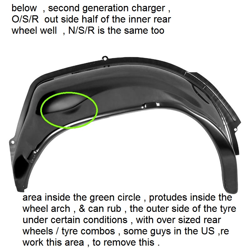

nother thing , while you can adjust wheel & tyre combos & see how far away from springs & wheel arch lip , it does not factor in the protruding hump in side the wheel well, & if it rub / come into contact at maximum suspension compression , as shown in picture in my above post .
the wheel & tyre combo on the silver 70 looks great , that combo would not work on mine , or it was close very close at max suspension compression travel & or lock to lock , sure the fronts touched the wheel arch lip , i'm sure I tried it with the wheel rite thingy , or I tried just at one end with one tyre size , & gave up because I wanted all 5 the same :? , see , Chrysler quality control & a wide variation in factory tolerance , no two cars are the same !
