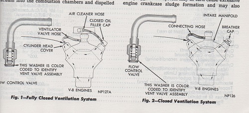

mine is set up with the PCV on the pass side and breather/ filler on drivers side....1968 383 HiPo....
polara engine venting 1.jpg (230.9 KiB) Viewed 1698 times

Posts: 7454
....which matches the manual....
Image (55).jpg (54.63 KiB) Viewed 1693 times
