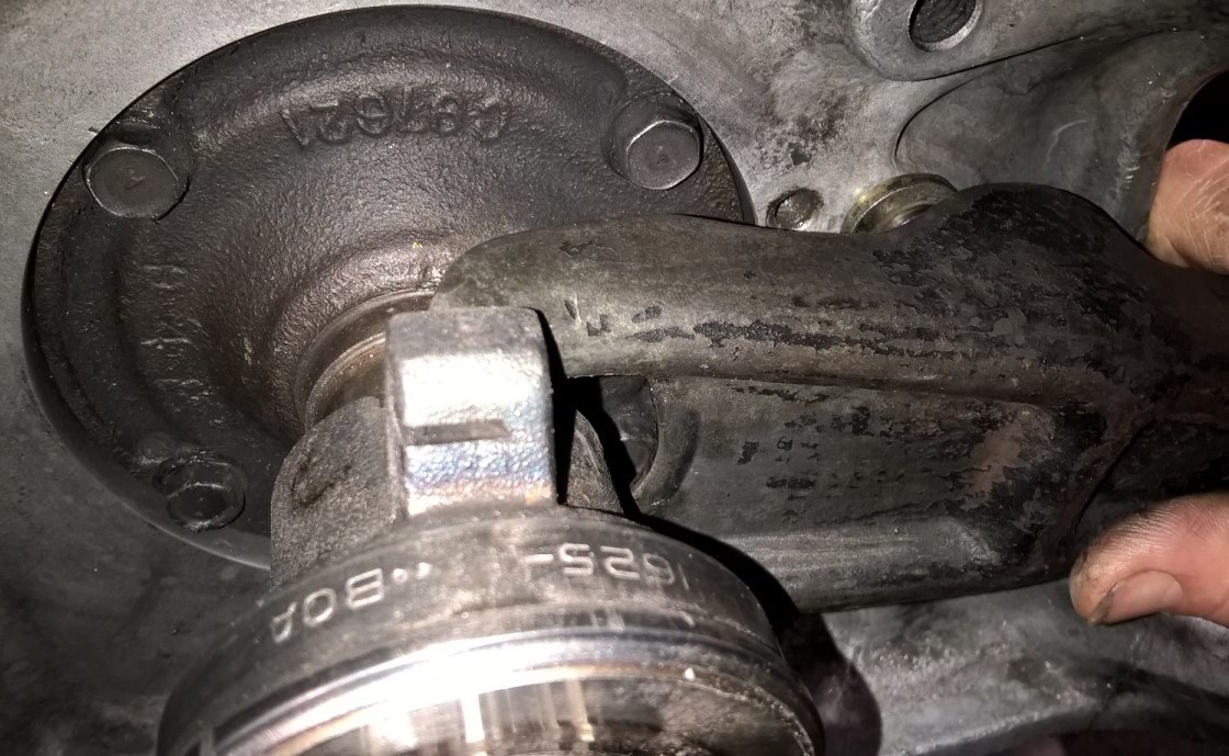

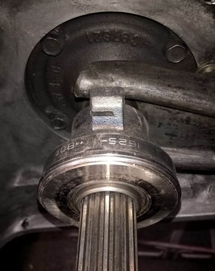

Did the arm come with the hemi trans? As Blue said there are some variations, used to have a selection but that was a long time ago!
The trans came from Dunc, he gave me a box of them to try and I picked the one that looked closest, how wrong I was!
You can see in this pic just how far out it is!
It's great actually as I've always had trouble adjusting the clutch and it's always felt a bit 'wrong', now I know why!
I'll get the proper arm and pivot ordered from Brewers.

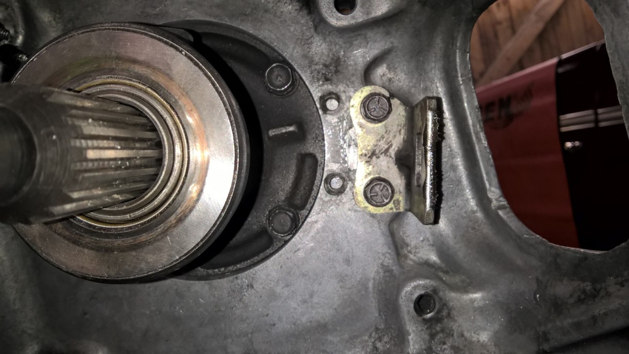

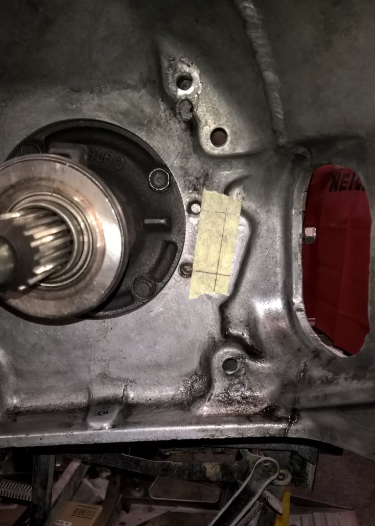

I worked out the arm protrudes 5/8" too far into the release bearing.
So, I drilled and tapped the bellhousing and just moved the bloody pivot!
Now it's bang-on. I mocked up the Z-bar and it actually improves clearance between that and the starter motor so it appears there's no downside :thumbright:
I just need to order the retaining springs and it's done. The gearbox will then hopefully be off to Duncs for a freshen-up.
Clutch fix 02.jpg (213.53 KiB) Viewed 440 times
Clutch fix 01.jpg (196.21 KiB) Viewed 440 times
