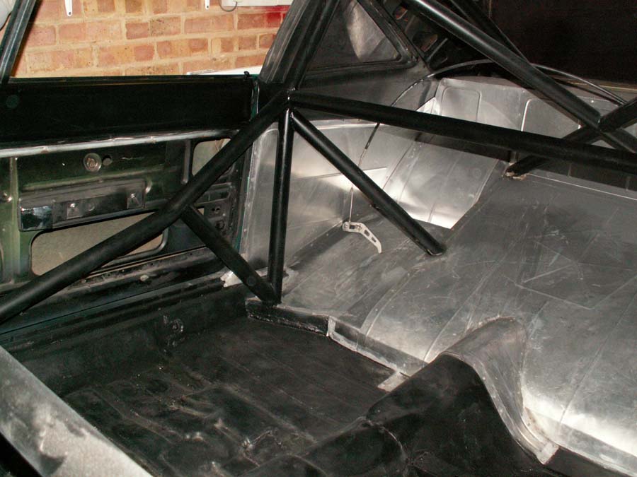

Some pictures of the car as is

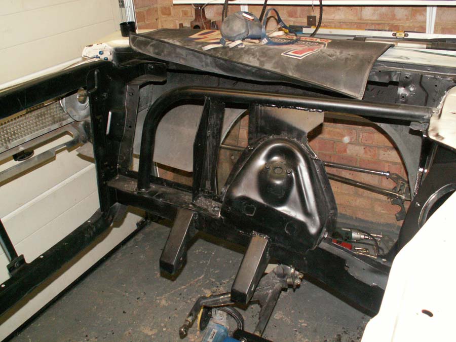

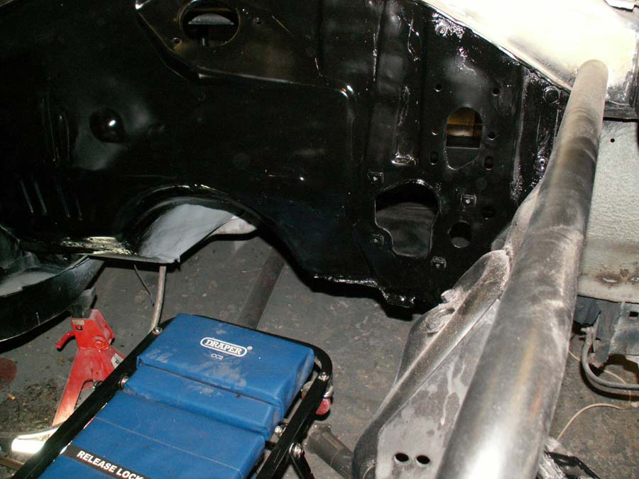

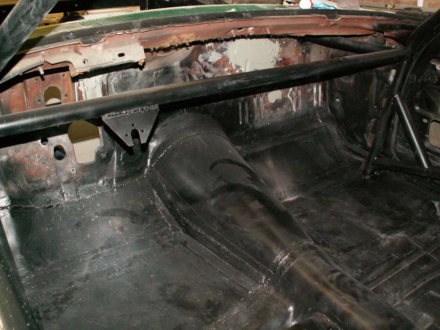

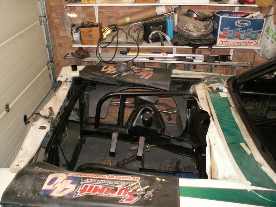

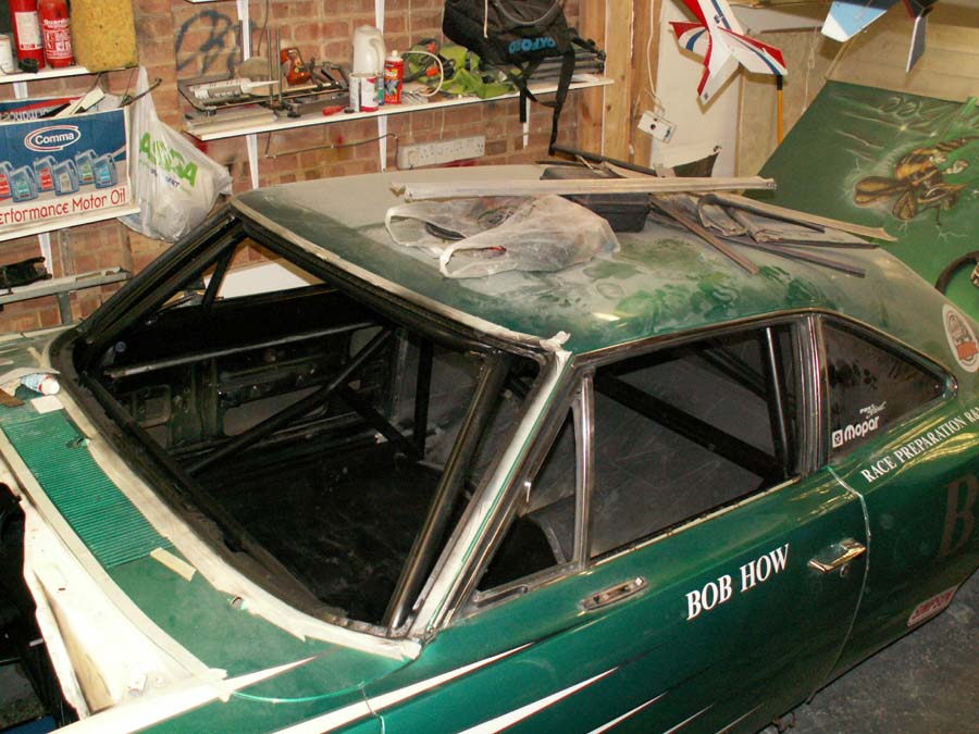

what colour ou gonna do the interior and engine bay bob ??
are you gettin the body colour changed ?? if not i would do it all white it looks much nicer than black, bri,s cuda was black in side and looked dull as dishwater
he painted it white much better now
Hi Dunc, time is not on my side so its Satin black for this season, I have treated all the bare metal or replaced it and etched primed it so it's all solid and straight, it is going to be satin black for this year.
At the end of the season will get it stripped and painted proper.
It ain't going in the show and shine

fair enough then bob, and i remember you said you are not to well, dont go breathin them paint fumes matey,Knightcharger wrote:Hi Dunc, time is not on my side so its Satin black for this season, I have treated all the bare metal or replaced it and etched primed it so it's all solid and straight, it is going to be satin black for this year.
best dunc

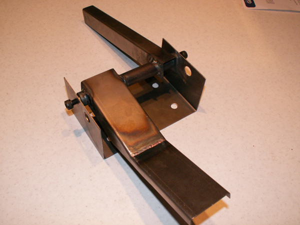

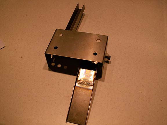

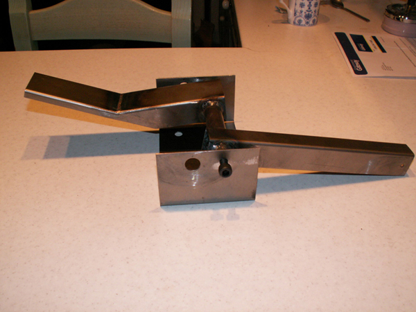

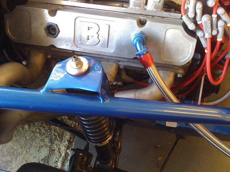

Done away with the throttle cable early in the build after fiddling with the original last year and not being happy with it.
Decided to make a direct link with small rose joints and a rod.
Here is the inside bracket assembly which bolts directly through the inside of the bulkhead.
The throttle link arm is of sett 110 mm to line up with the carb and the foot plate is 50mm wide.
it will be spring loaded under the dash and also have the normal triple throttle springs on the carb.
The movement is 1:1 and it will move the throttle arm 60mm
