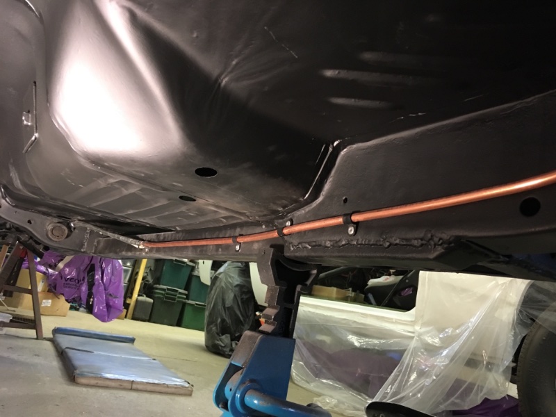

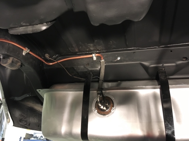

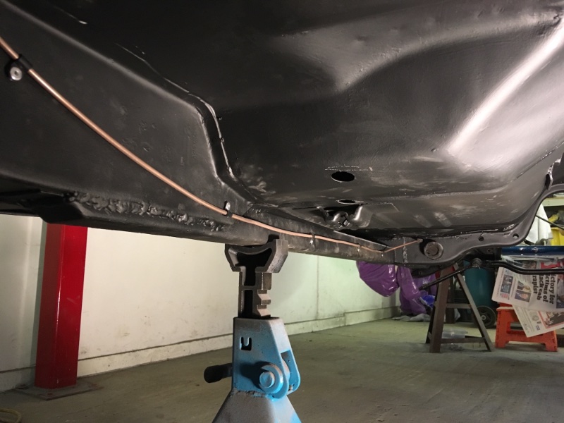

New tank, 3/8" sender and fuel line, all new brake lines...
- IMG_0128.jpg (103.77 KiB) Viewed 2033 times
- IMG_0129.jpg (128.47 KiB) Viewed 2033 times
- IMG_0130.jpg (125.52 KiB) Viewed 2033 times

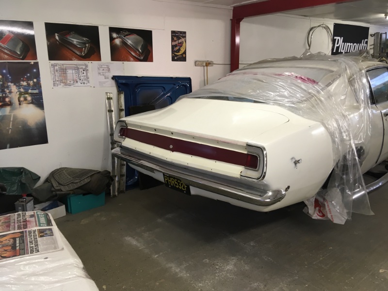

Coming together in leaps and bounds now, new rear bumper and tail light bezels and a "spring special" trunk lid stripe. The stripe is typical repro standard, about 1/8" too narrow to fit between the trims and they have thoughtfully punched out the lock hole too large. The upshot is I had to match the stripe colour and paint the panel first so you don't have white showing through where you shouldn't, frustrating...
