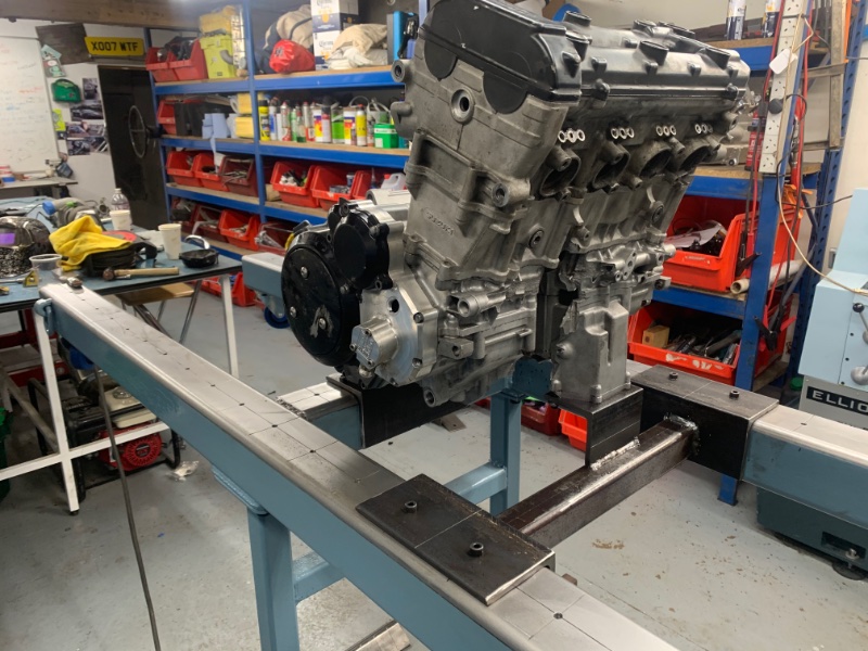

Re: Fifty shades of Jade

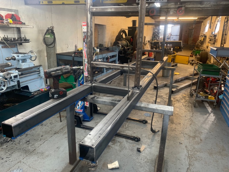

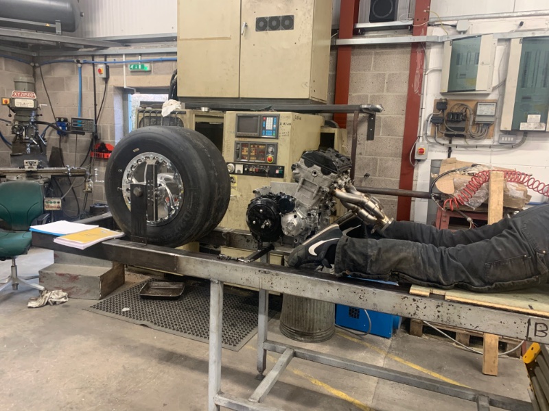

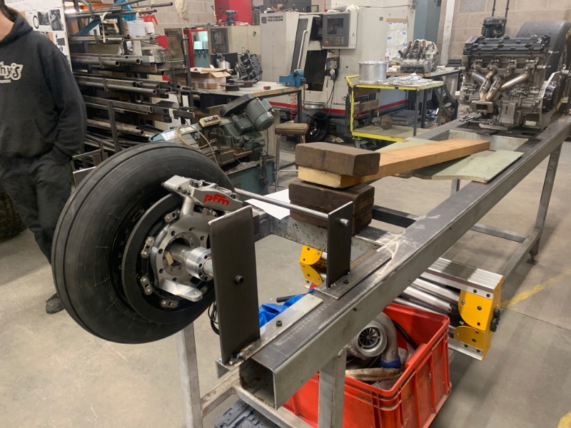

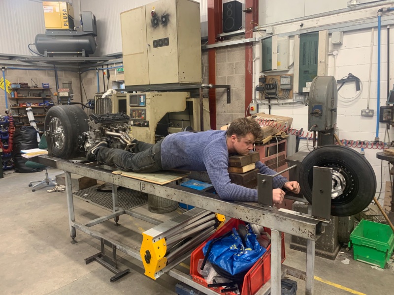

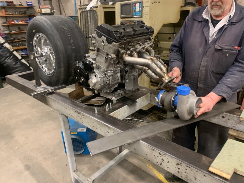

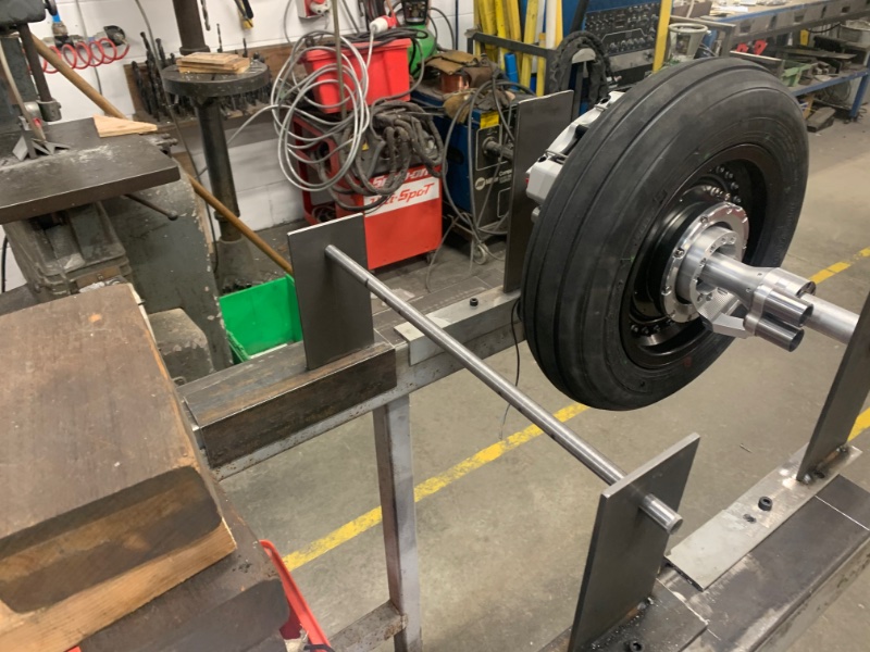

All major parts are now jigged up in place :roll:

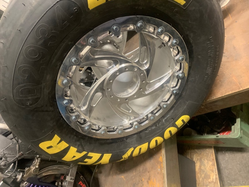

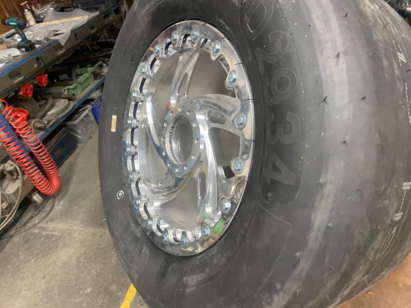

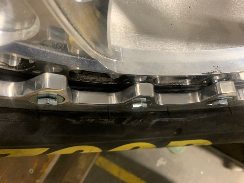

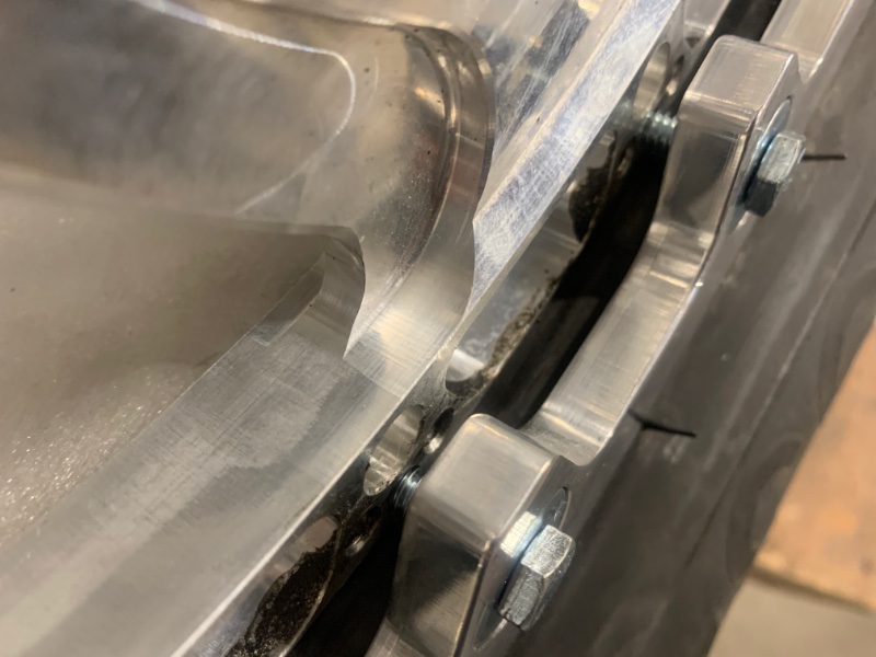

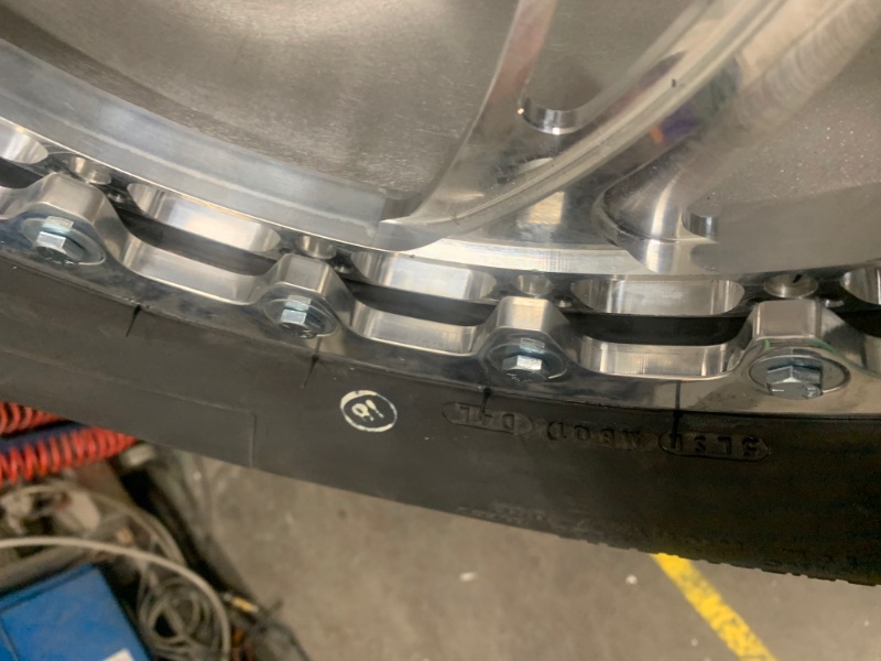

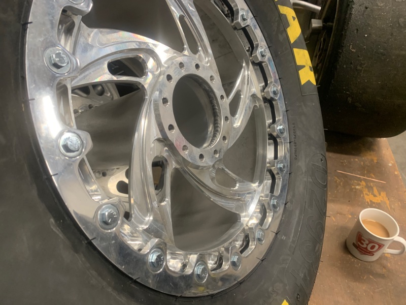

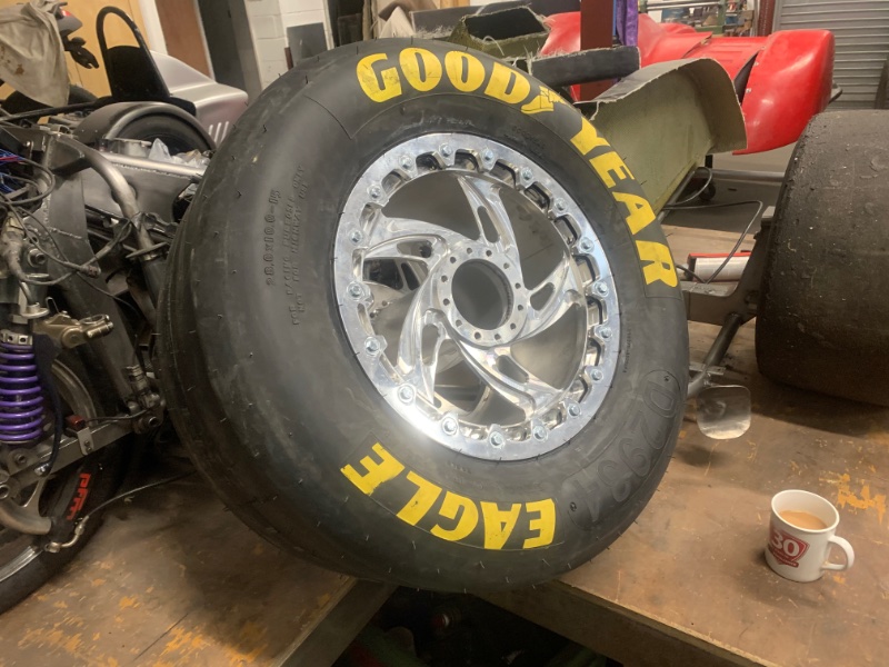

Well I didn’t see this one coming !
Land speed tyre have a bead that is thicker than drag tyres !!!
:banghead: :banghead: :banghead: :banghead: :banghead: :banghead: :banghead:

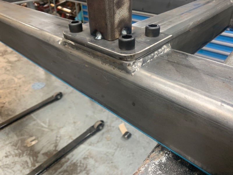

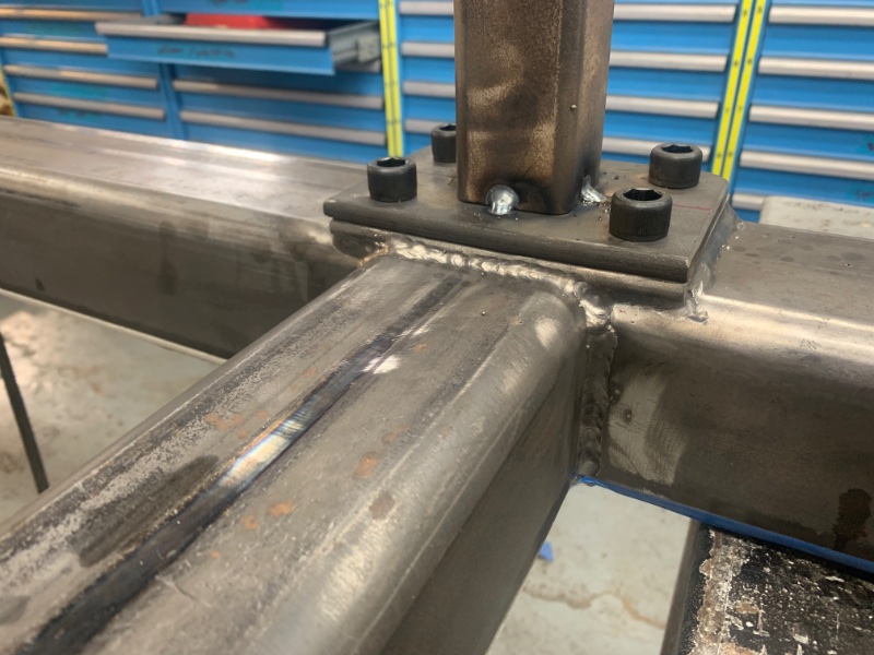

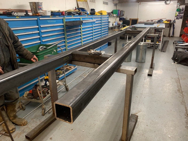

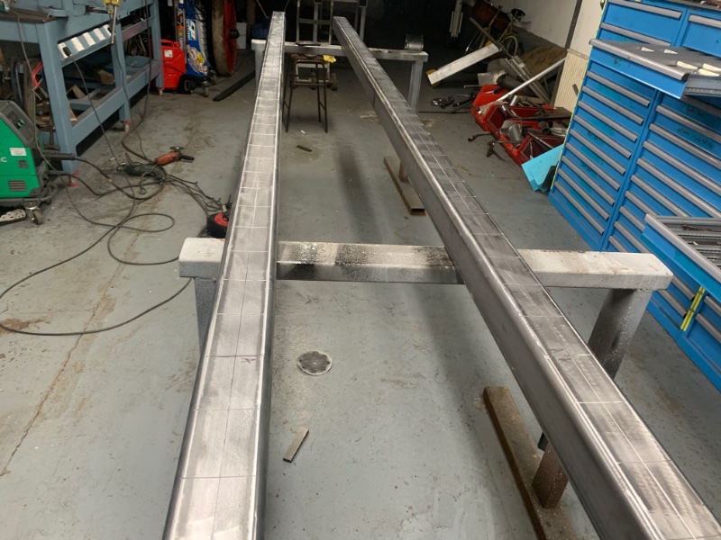

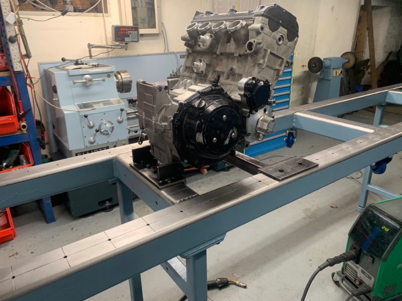

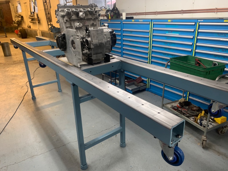

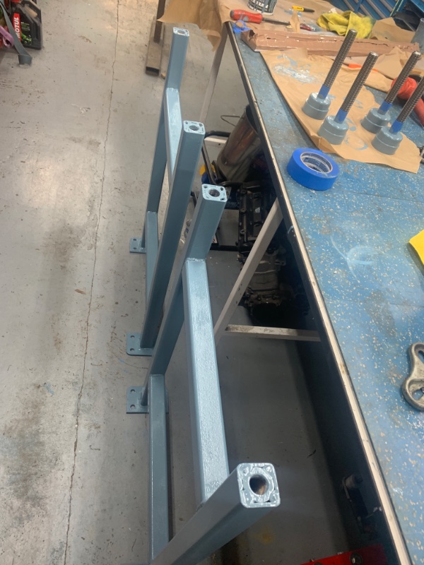

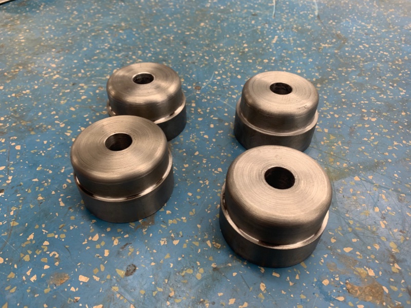

Hello Boys and girls
I hope you are all keeping well and safe in this new world.

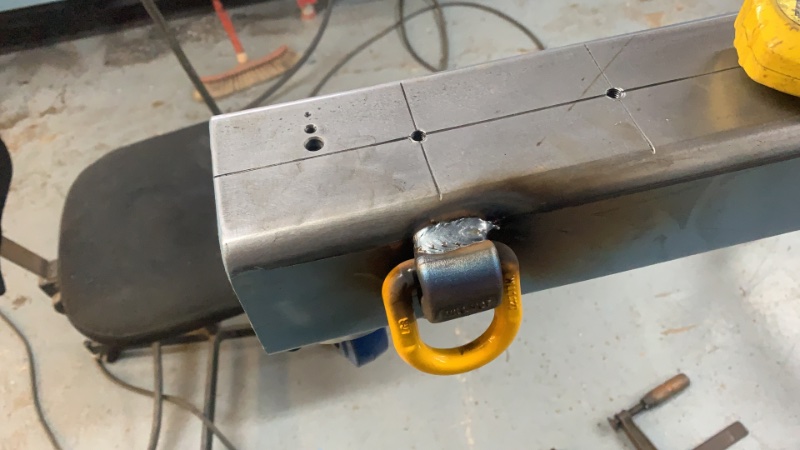

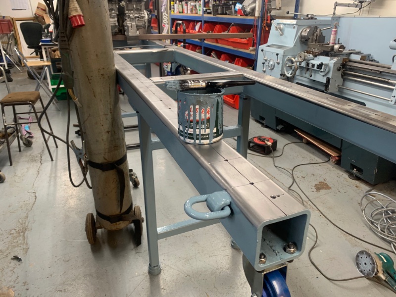

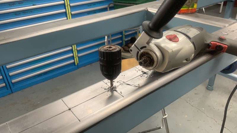

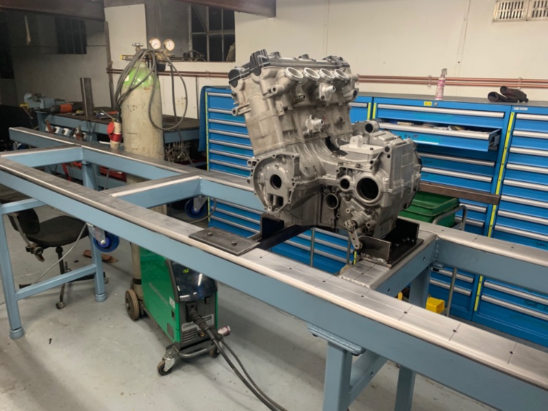

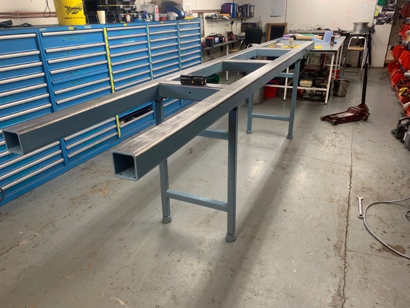

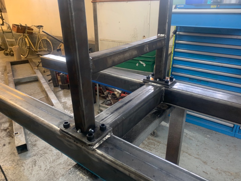

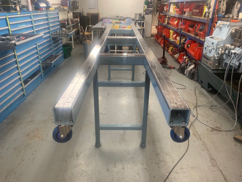

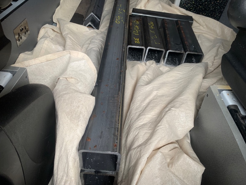

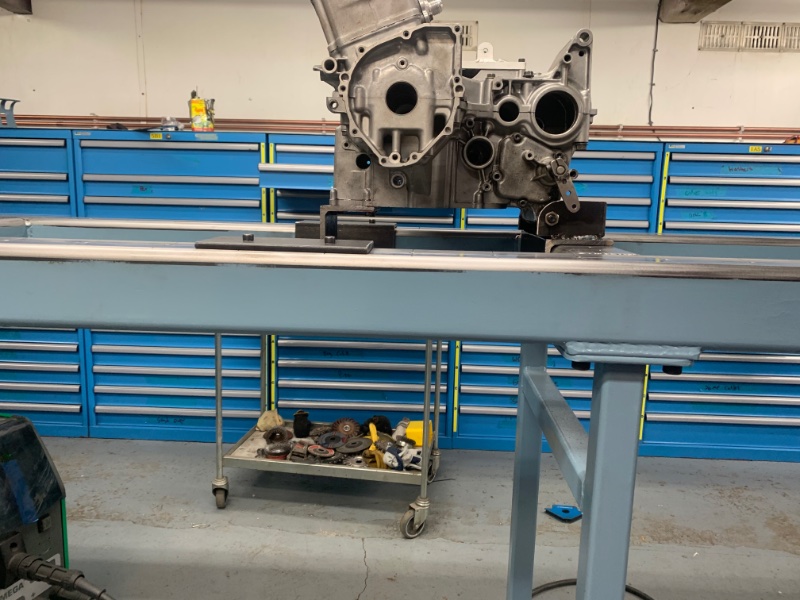

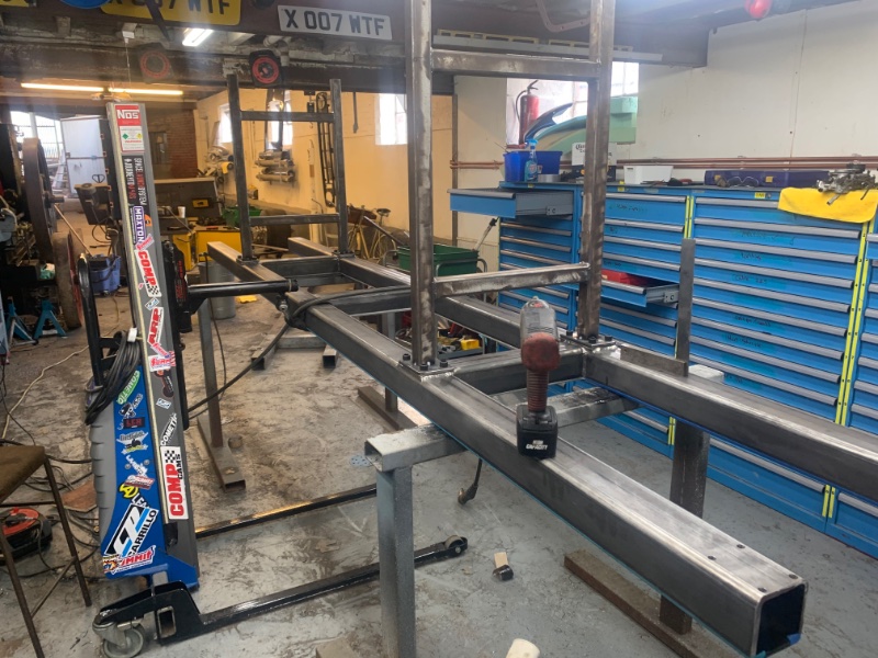

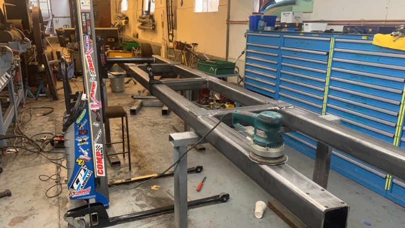

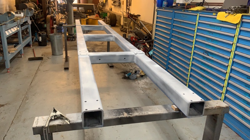

Things are moving forward and decided to build a brand new Jig to build the new bike off !!
The steel is all 10mm Thick and way OTT
Posts: 22137
Fantastic work as ever!!!

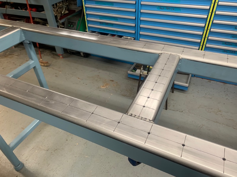

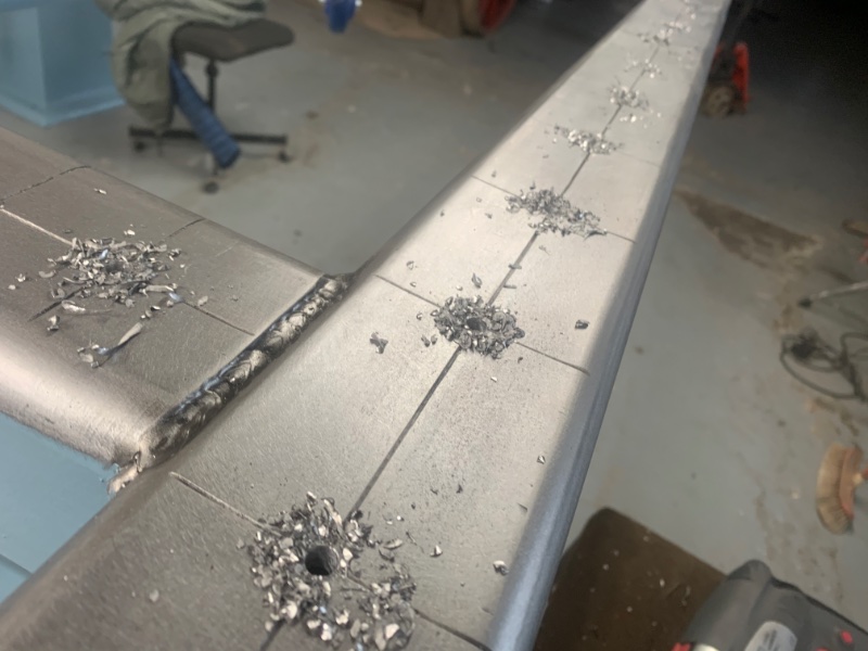

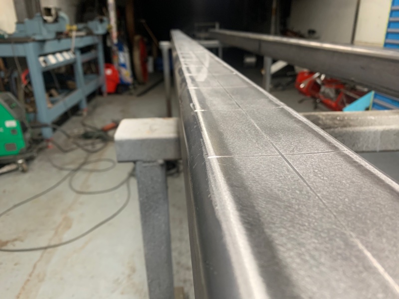

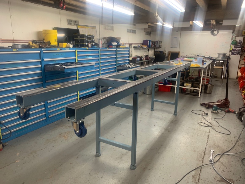

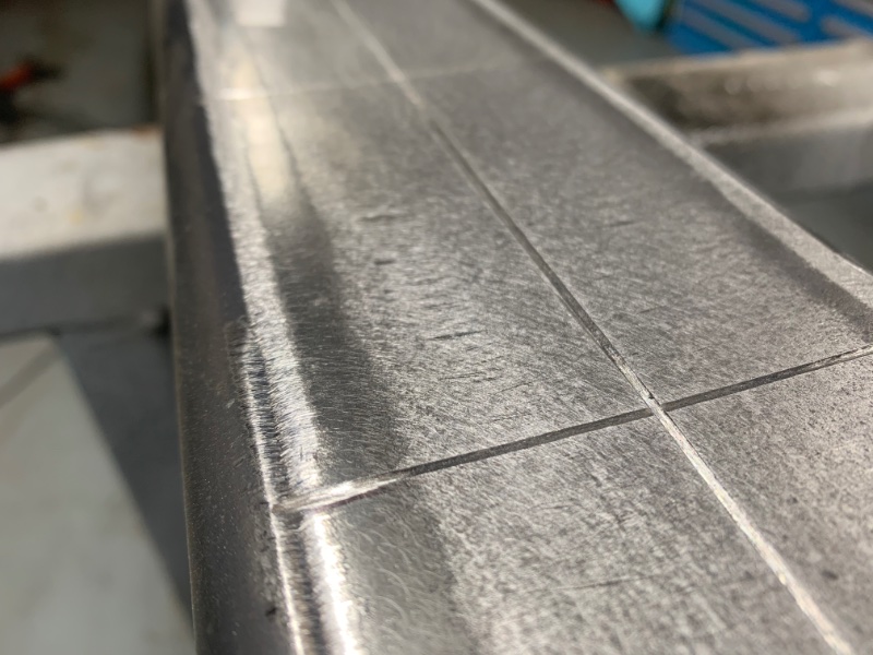

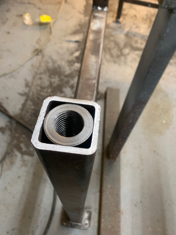

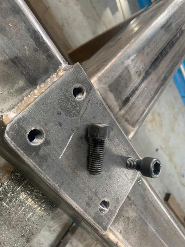

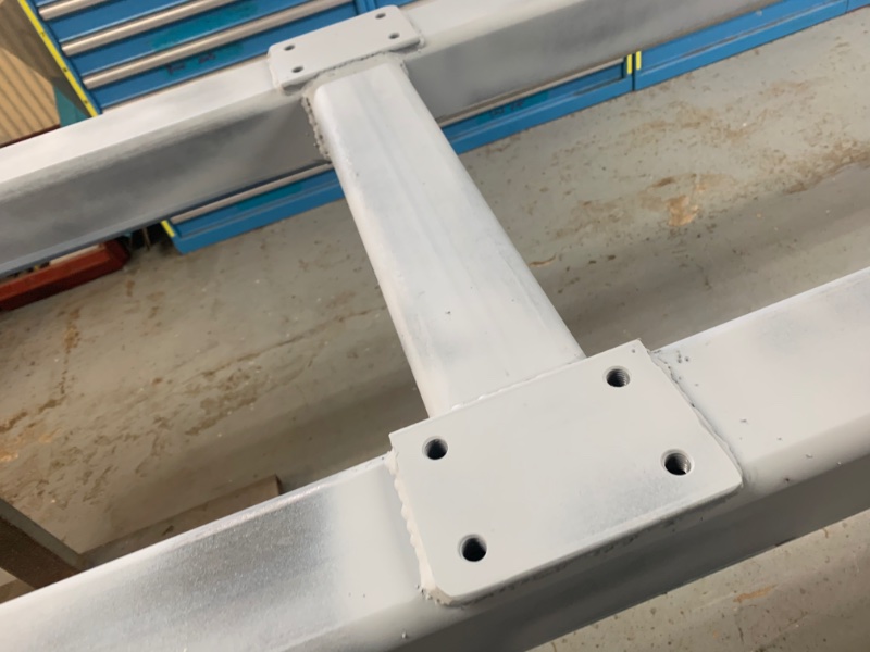

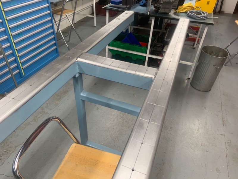

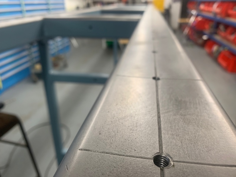

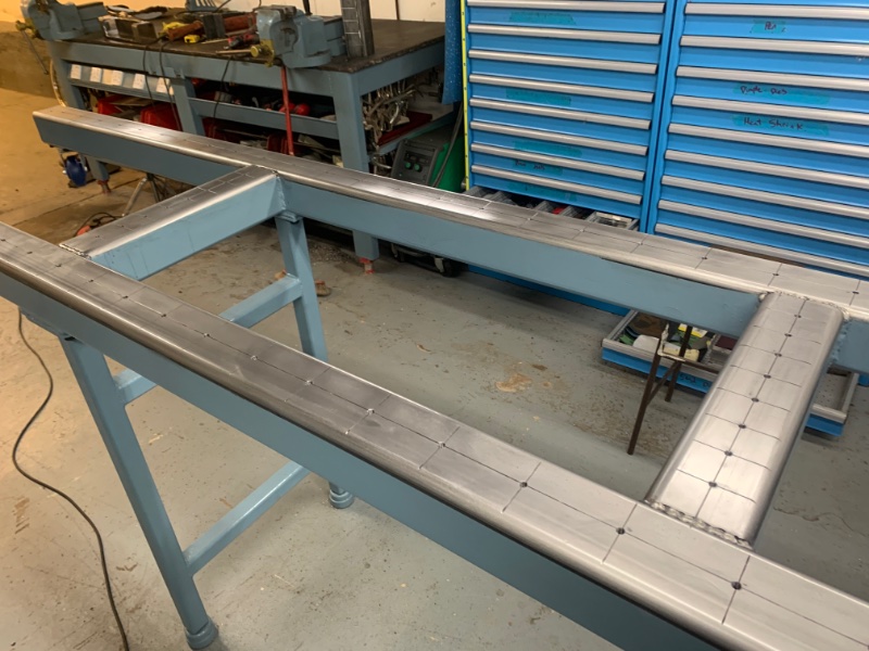

Table is 4000mm Long using 100mm x 100mm x 10mm Box bars

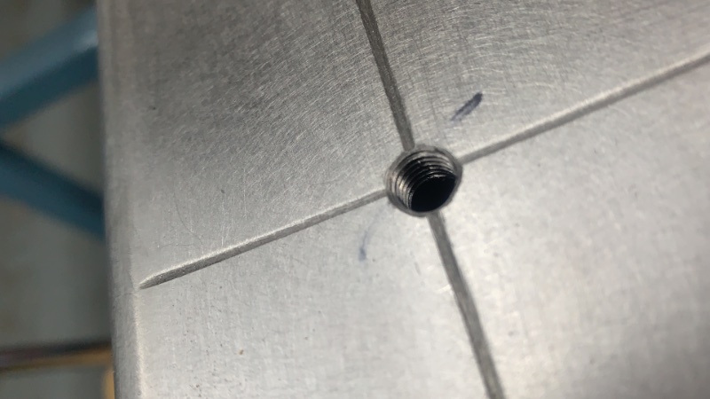

Table is Level in X Y Z and parallel to the grinned lines and taps holes within 0.3mm and 0.1° :geek: Mission

Looks substantial, that ain't going bend :thumbright:
