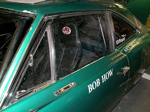

Fitted one of the lexan door windows.
The kit is set up to do away with the quarter light but as I am trying to keep the car looking original I have modified it and fitted a separate piece of lexan in the quarter light outer.

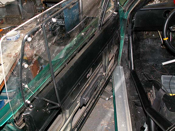

OK sorted out the roll cage and it turned out to be a bit easier than we thought.
Also James sourced the frame work for the door nett from Andy Robinson.
For those that don't know the door net is there so that if the door comes off during a crash the drivers arms and any other appendages are restrained within the car.
The net is supported on a top and bottom small steel tubes, the top bar is pivoted behind the driver off the roll cage and the front of the top bar has a release clip part of which is welded to the underside of the top of the front hoop of the roll cage. This allows the assembly to drop down behind the seat to allow access.
The lower bar is held in place with two straps attached to the lower bar and the door bar.
