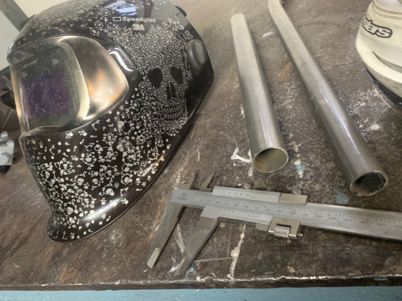

After lots of research I have decided to use T45 steel tube for the frame build
Carbon-manganese steel
T45 tube is a very unique seamless Carbon based steel tube that has been used in many applications throughout industry.
This great material has been around for 60+ years and was first designed for applications within the Aerospace Industry for use as airframe structures due to its high strengths and ease of forming and welding. Over the build period many aeroplanes such as the Spitfire, Hurricane and other known Hawker models have used this quality material within its structures (and still do today on historic rebuilds).
The motorsports Industry took to this tube with excellent results, products such as Roll Cages, Space Frames, Impact Protection, Wishbones, Anti Roll Bars were all produced and still are. The use of this versatile high quality material is still in high demand today. F1, WTCC, WRC, ERC, BTCC, ETCC ,Bikes, Karts and even Cycle Frames use or have used this high tensile carbon manganese tube within their construction.

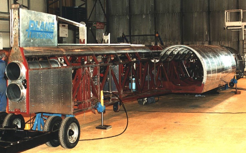

It has also been used for the land speed record breaking Steam powered car, Thrust 2 right up to Thrust SSC
Oh and it's British not like that Molly American stuff

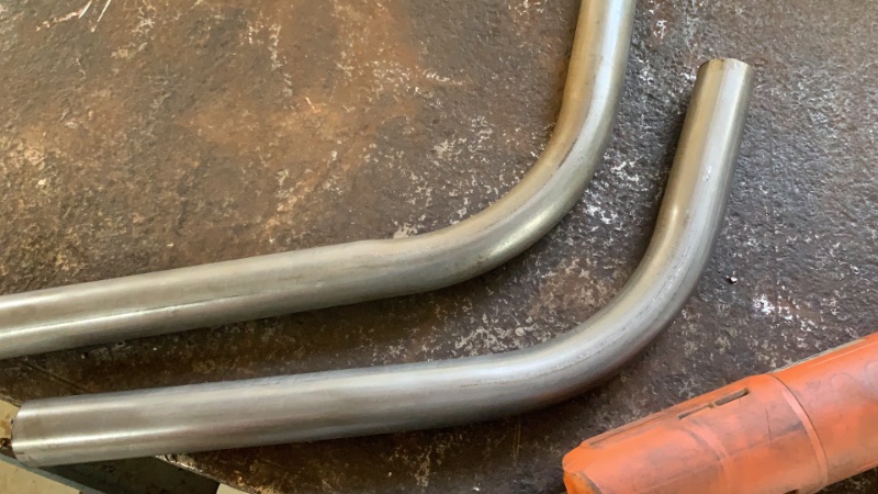

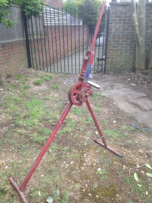

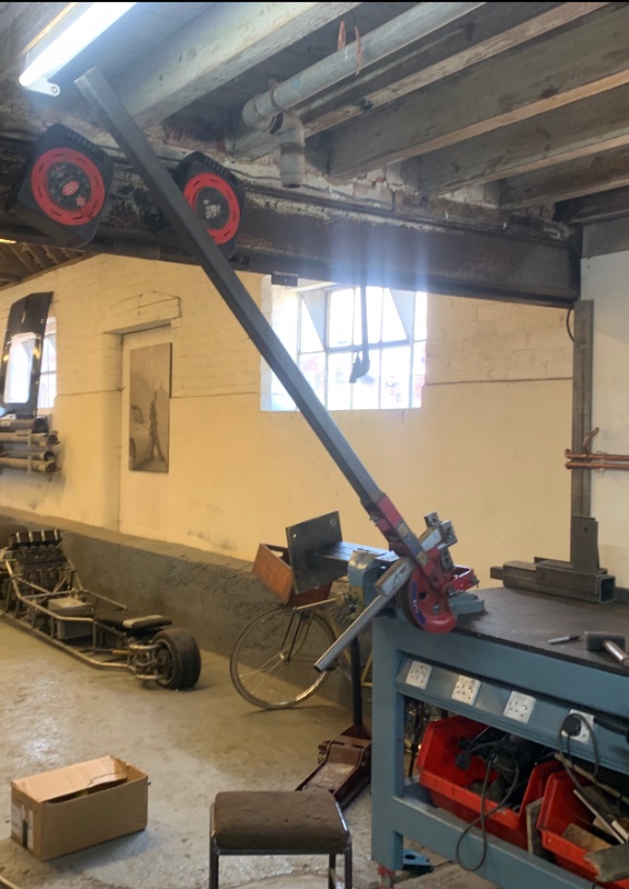

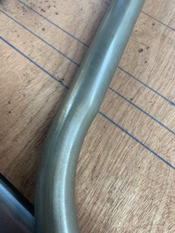

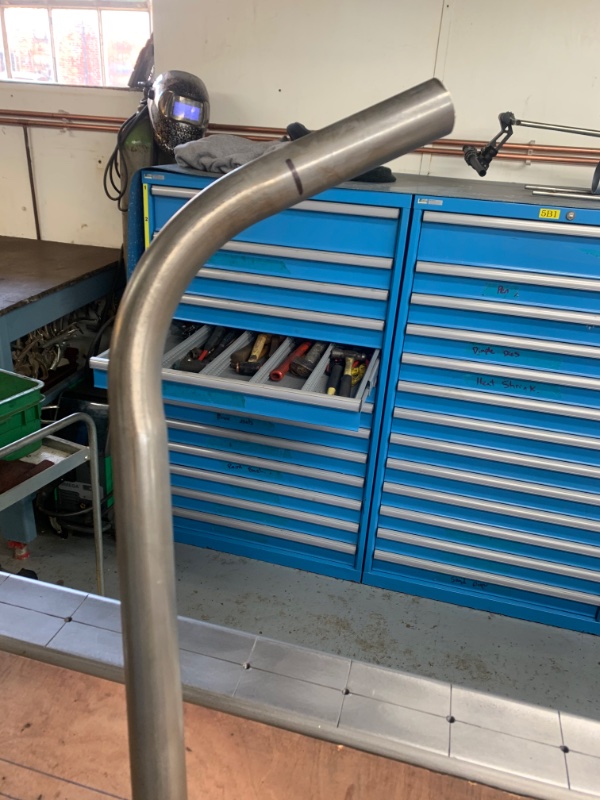

Tube Bending! Bending tube

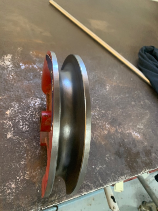

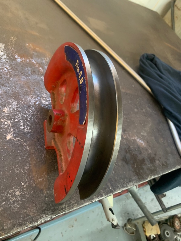

Trying to save money i commandeered Grandads Record 220 pipe bender.
This model had cast iron wheels and followers (no not alu) and it work ok!
My only issues were the amount of forces needed was a 2/3-man job and there was a very slight oval ling of the tube on the bend.
I had the bender in the vice hanging upside down with my feet on the ceiling pushing down to make it happen.
s-l1600 (1).jpg (158.19 KiB) Viewed 1878 times

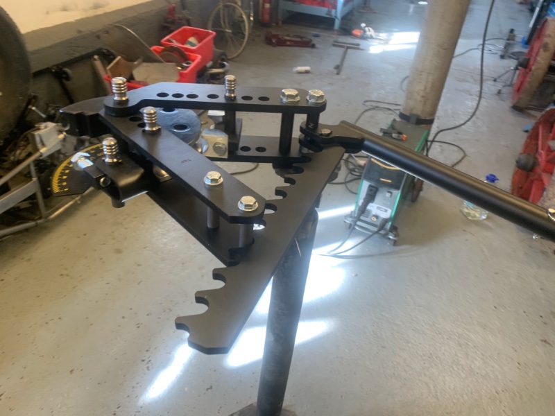

Re: Fifty shades of Jade

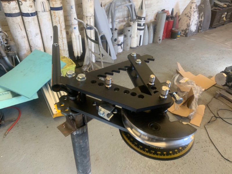

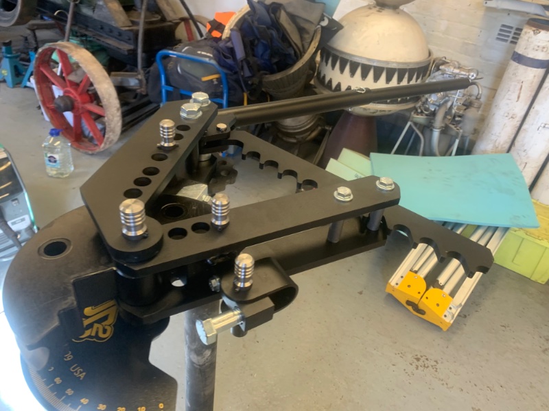

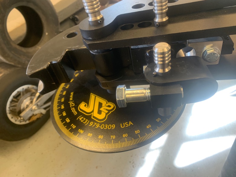

In the end i bite the bullet and brought a JD Square Model 3.
In hindsight the bends are only marginally better and to be honest the Record bender did a very good job.
Now i have the ability to bend tubes easily using the geared up lever system but more importantly i can do them safety on own without the Circus act
Post by mygasser »
i've got one like this i used for the cage in my anglia as well as suspension arms etc since. i got mine from stakesy's here in england though it's not on their website currently.
neil.
https://www.speedwaymotors.com/3rd-Gen- ... ,6614.html

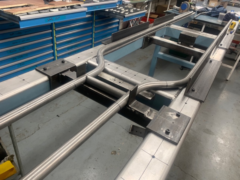

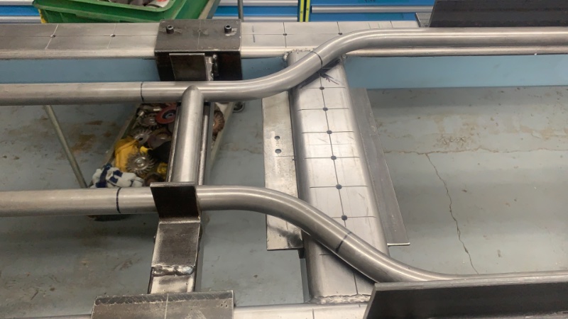

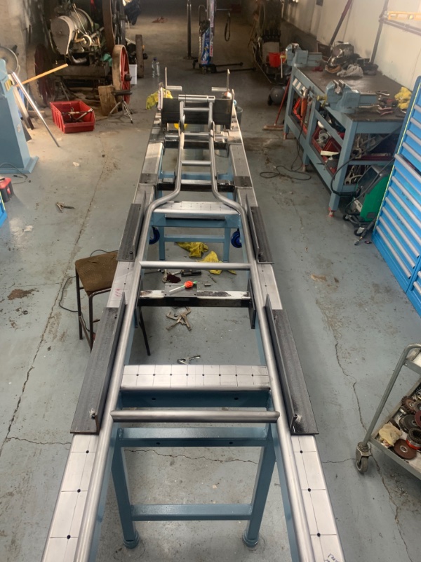

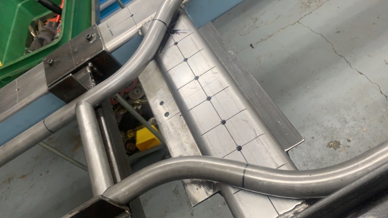

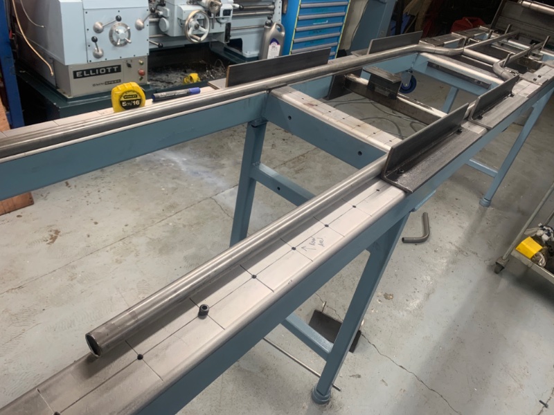

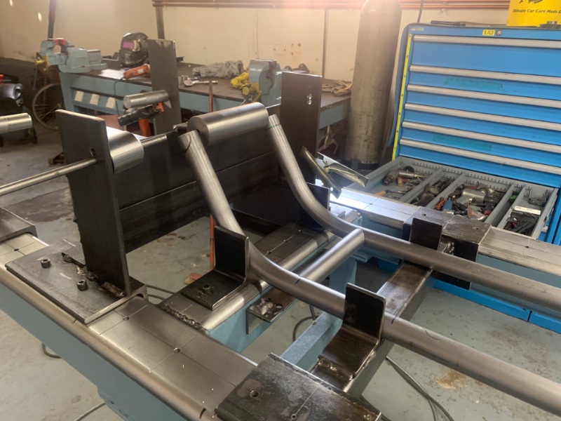

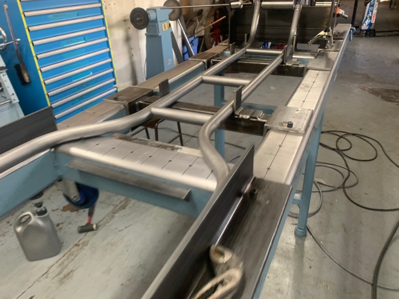

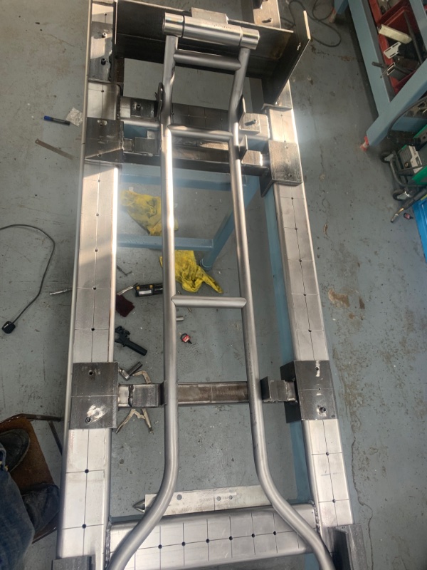

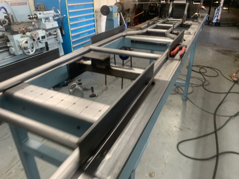

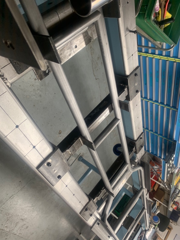

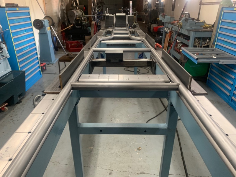

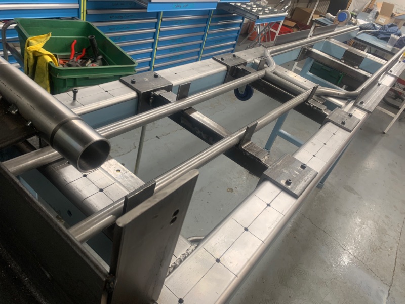

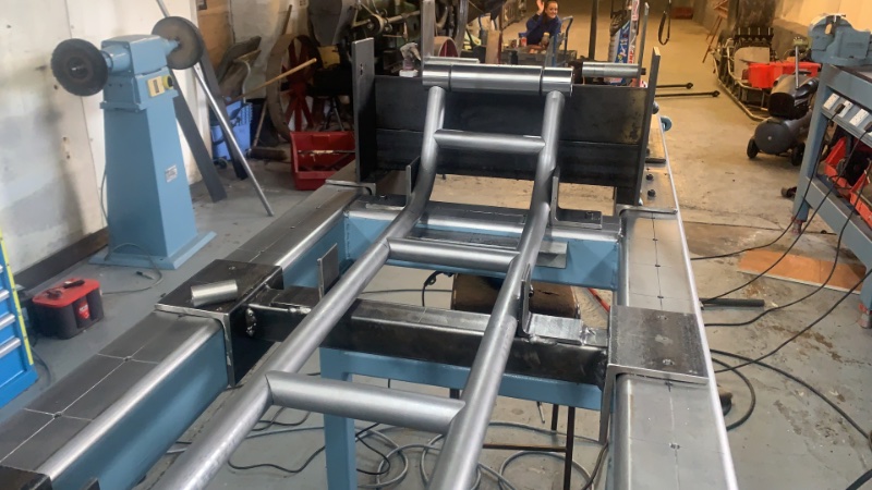

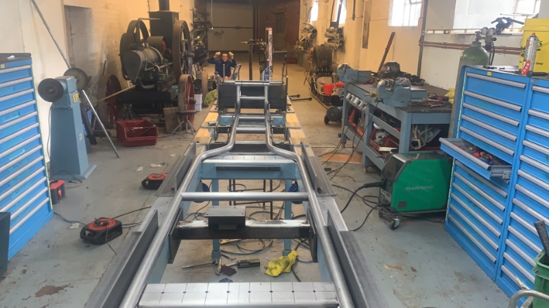

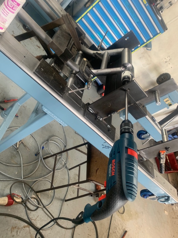

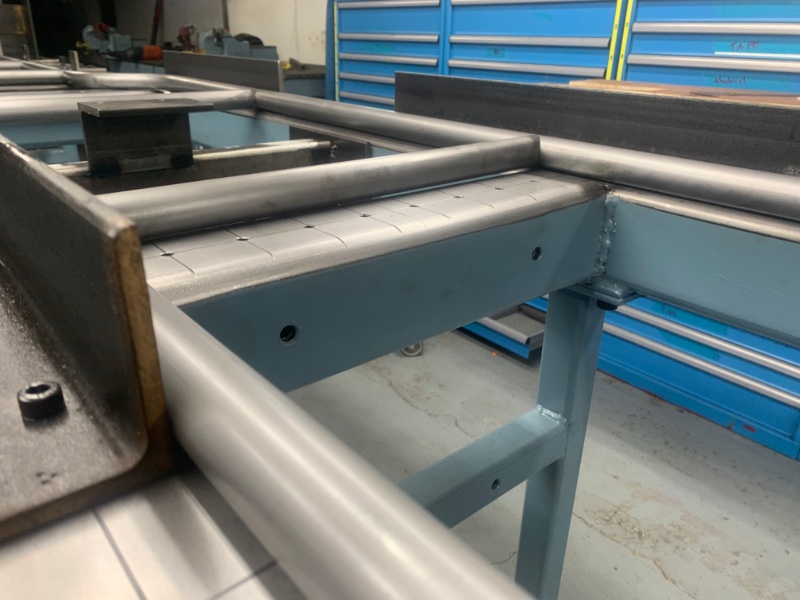

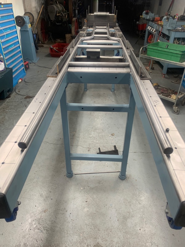

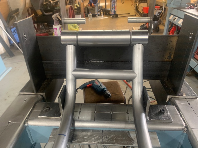

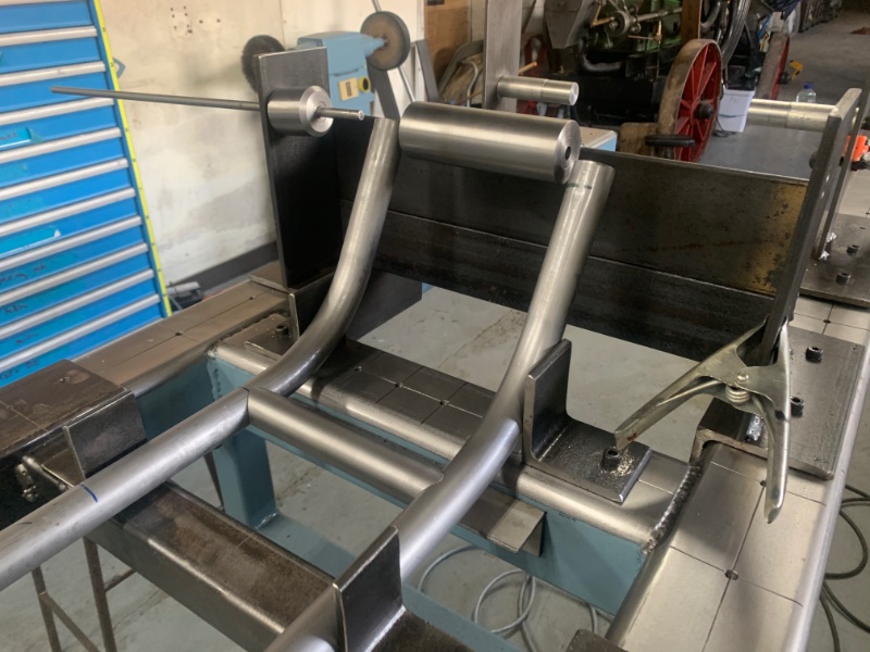

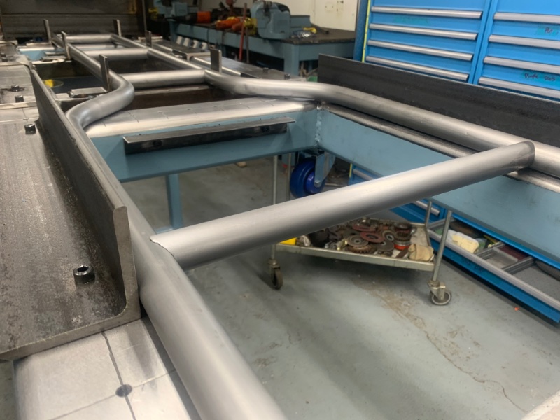

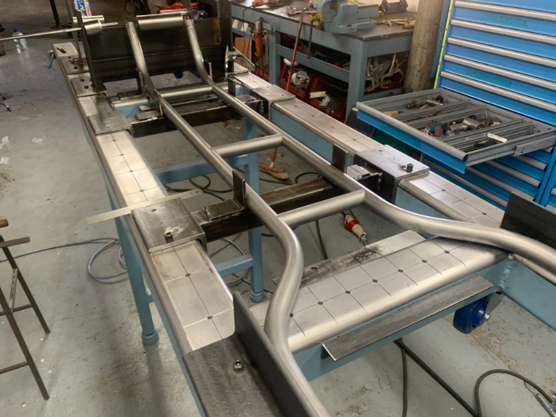

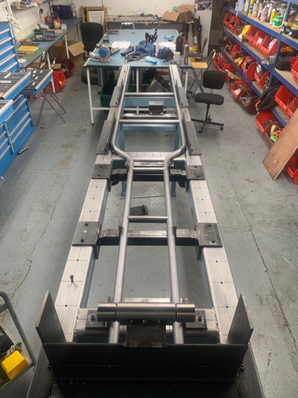

Finally i got the bottom frame rails fitted !! \:D/
Feels like all i have done is spend hours building a table :roll:

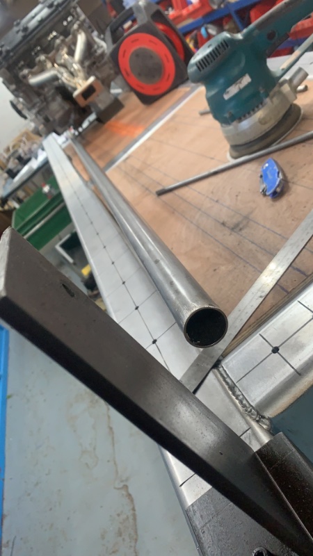

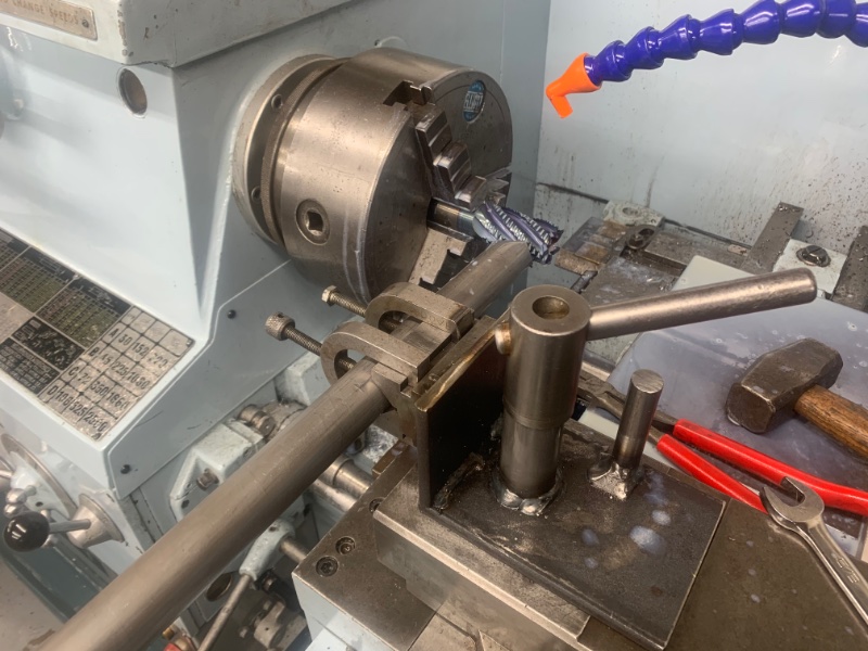

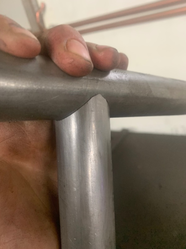

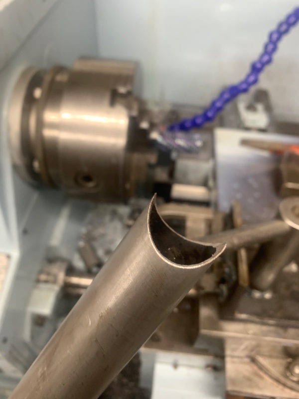

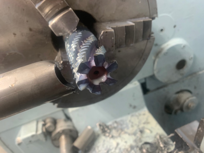

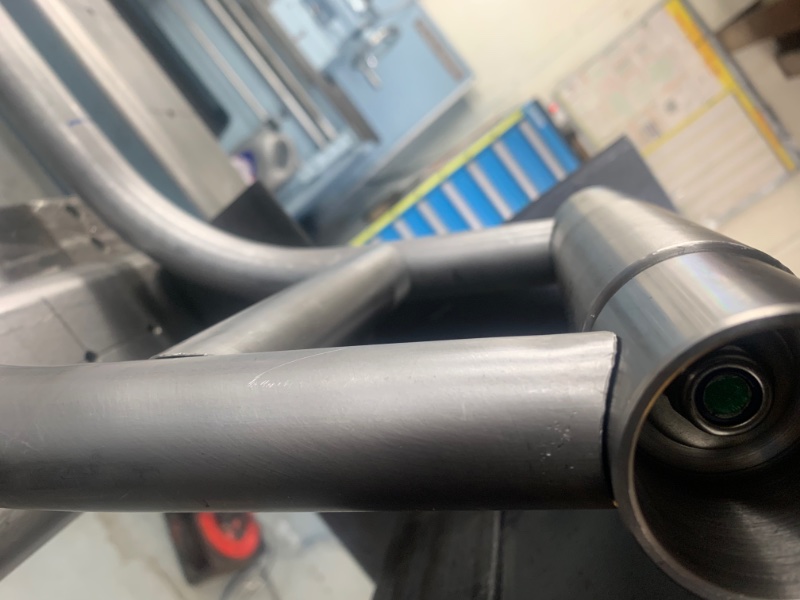

Tube notching
To achieve this i removed the tool post from my lathe and made a special tube holder from an old V-Block.
This will except a range of different size tube.
You then use a roughing end mill the same size as the tube you want to Notch and drive the tube into the mill. (Slowly :? :help: )
Advantages - Coolant for cutting - Degree wheel adjustment of tool post - DRO dial measurement of cuts !
It works soooo well if you have a lot of Tube notching to do buy an old lathe off ebay and convert it :salute:

Good idea using the lathe to do your notching :thumbright:

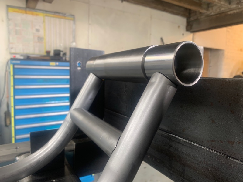

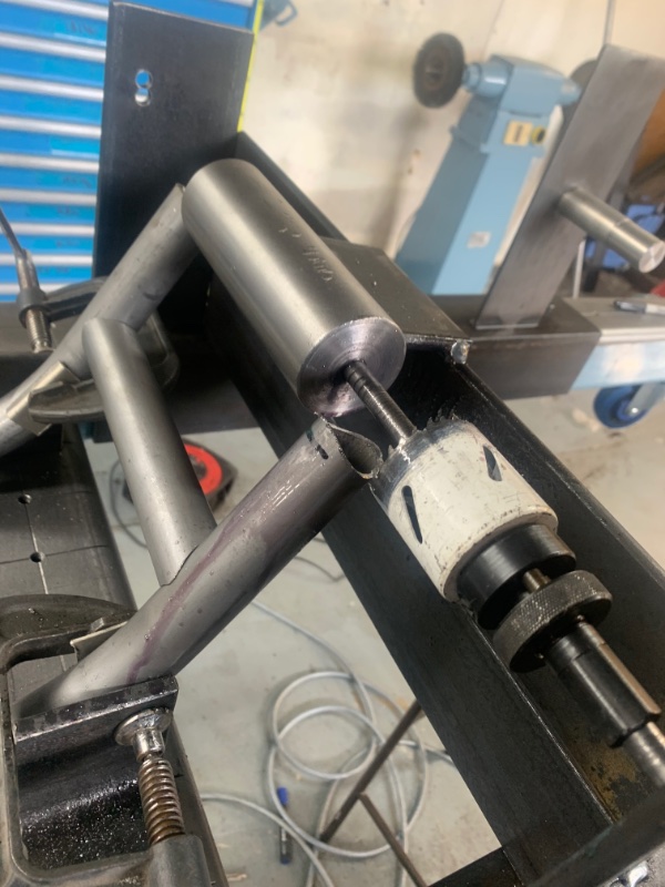

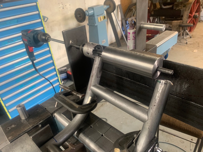

Over the years I have learnt one thing about this building cars and bike malarkey
:brushteeth: THERE ARE NO RULES :brushteeth:
Anything goes...

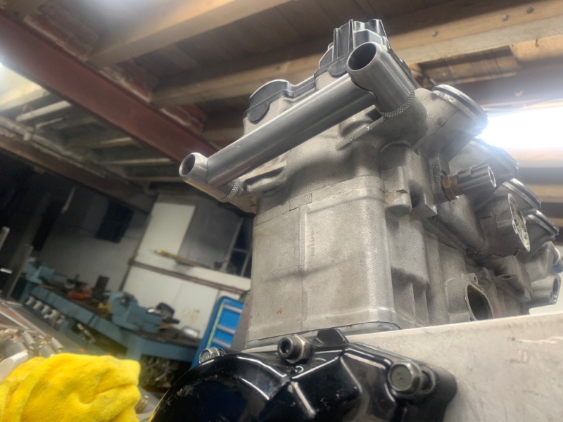

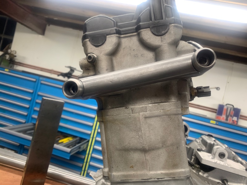

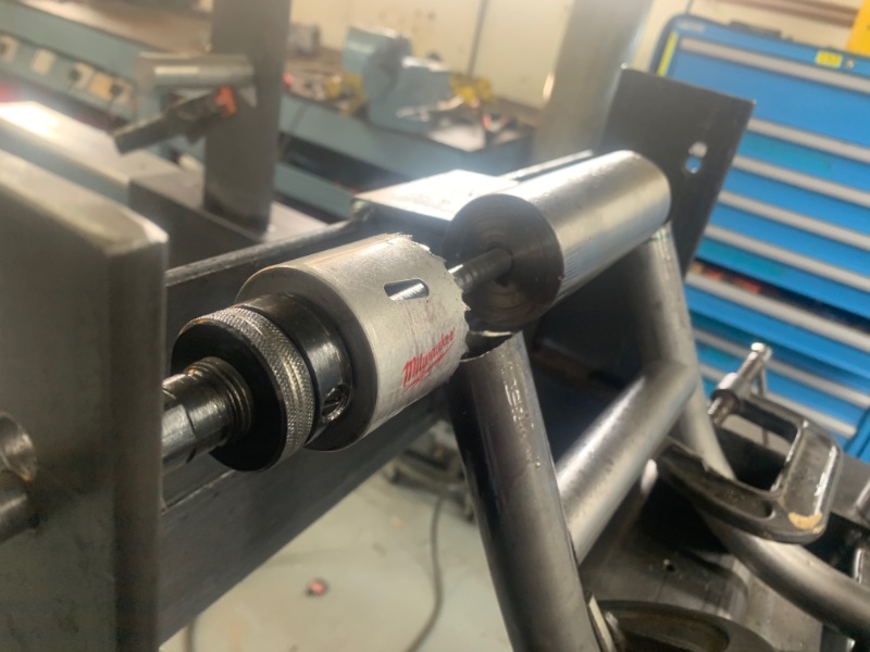

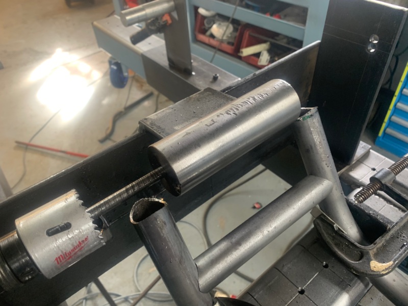

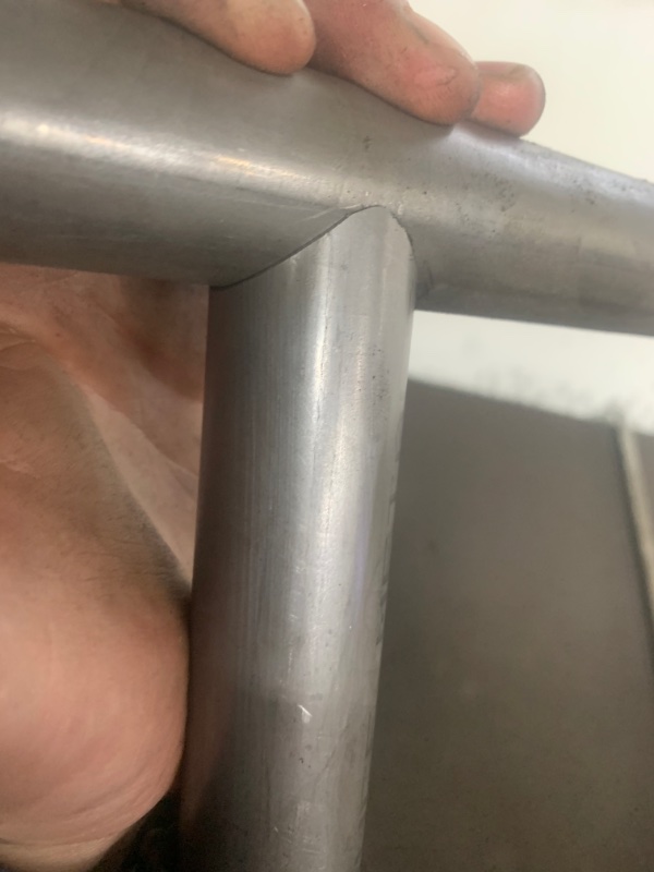

I used a Hole saw on a bar and cut the tube notches in the bottom chassis rails to the swing arm bushes.

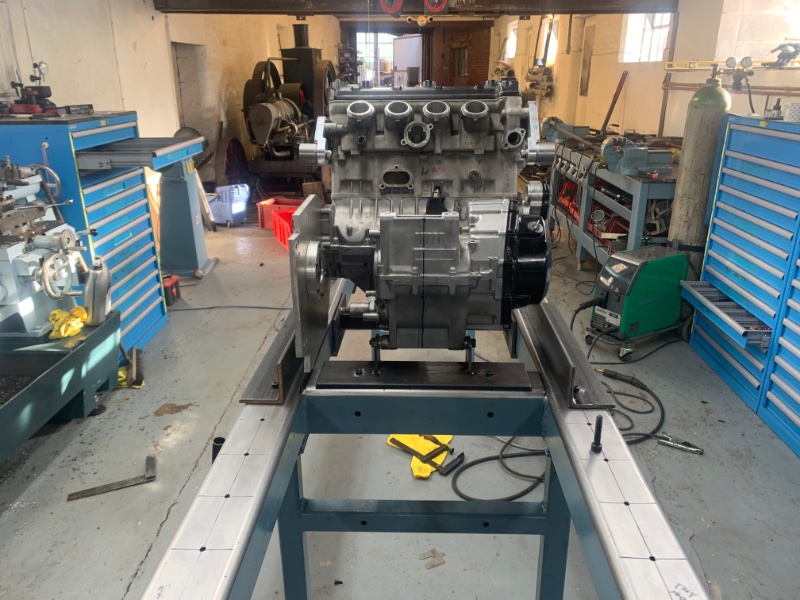

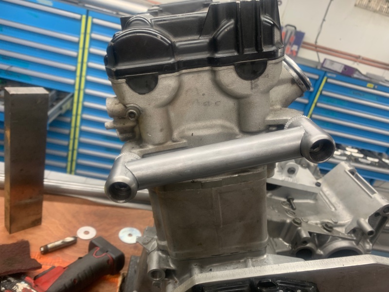

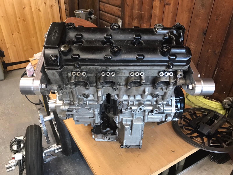

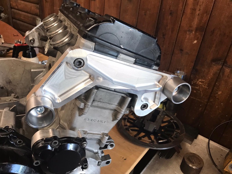

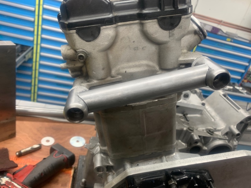

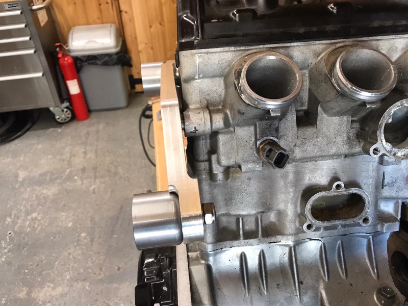

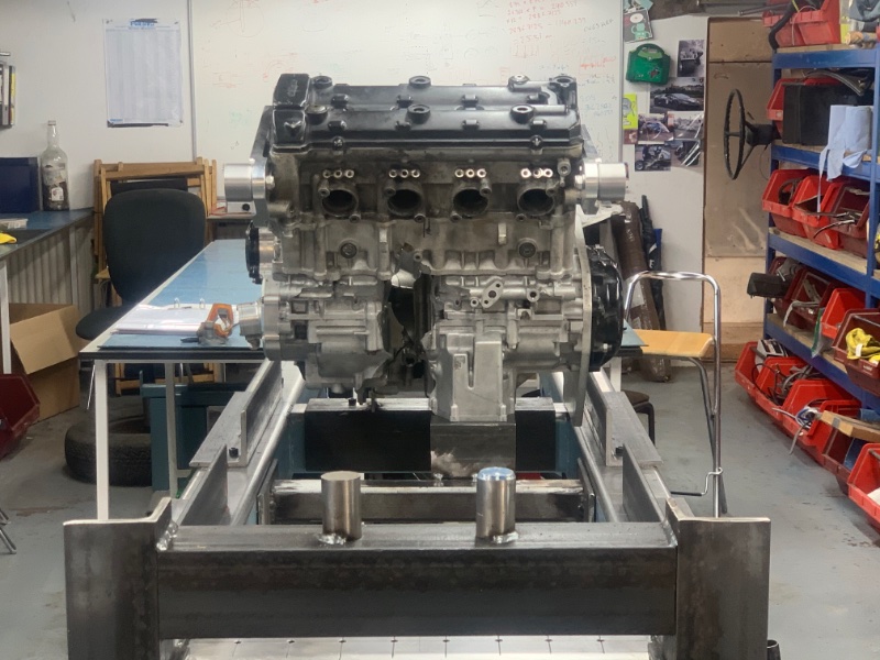

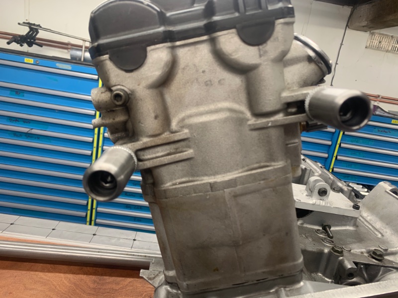

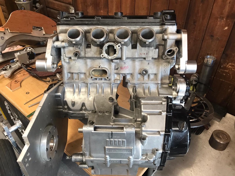

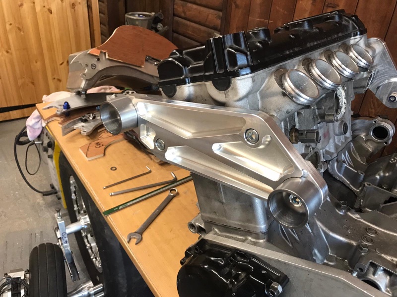

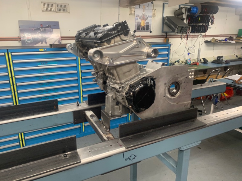

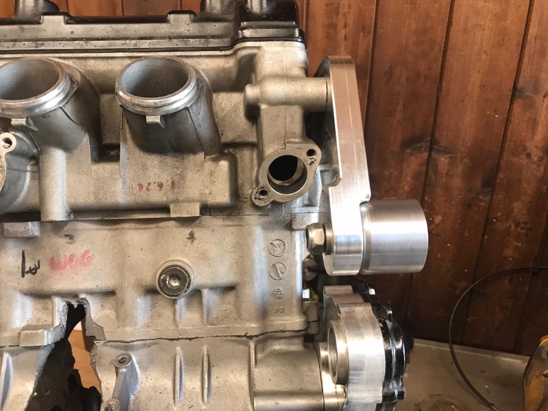

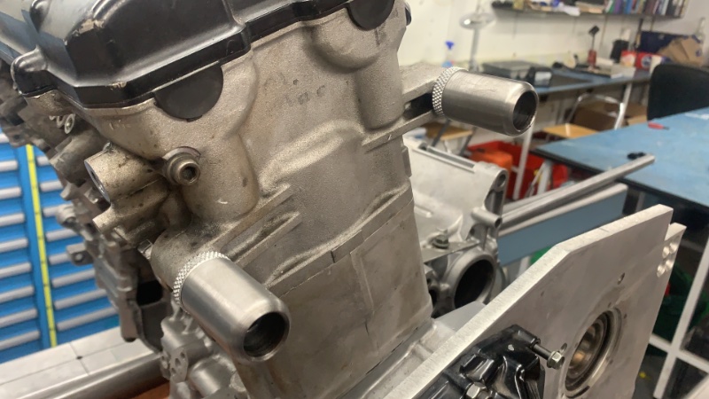

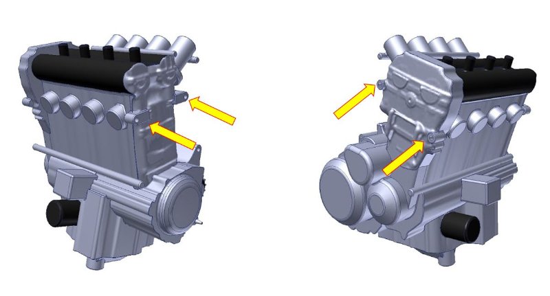

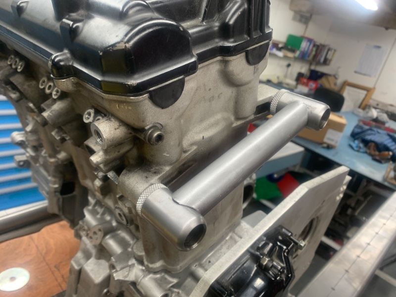

My first idea was to mount tubes around the engine and to remove the engine it would be through the bottom of the chassis the same as the last bike.
For some reason Suzuki decided to make the engine mounting nonsymmetrical which will make my frame look really strange
Engine mount not straight.JPG (49.48 KiB) Viewed 1836 times

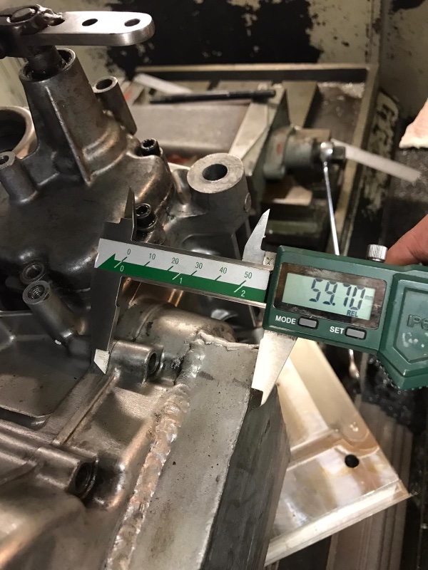

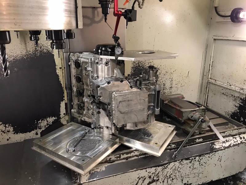

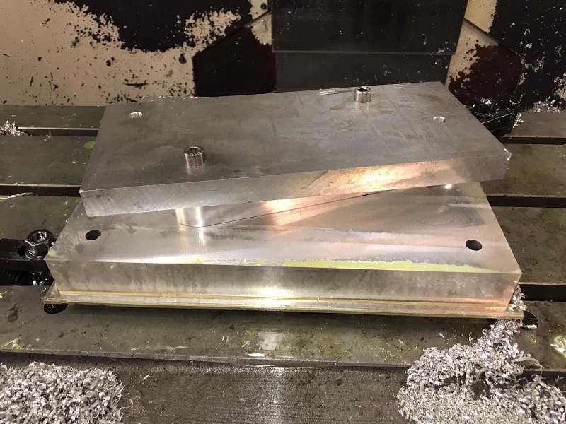

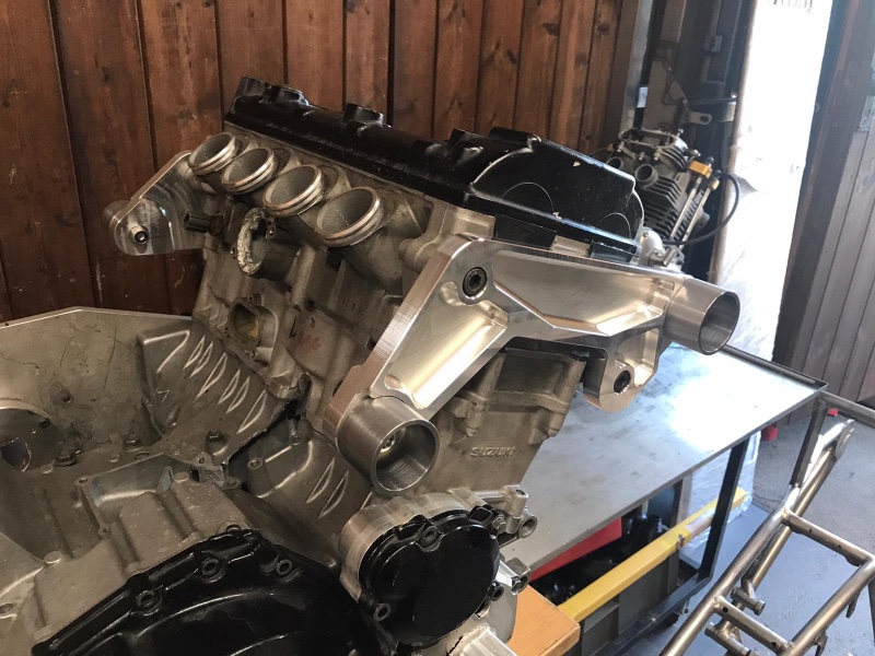

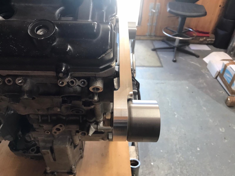

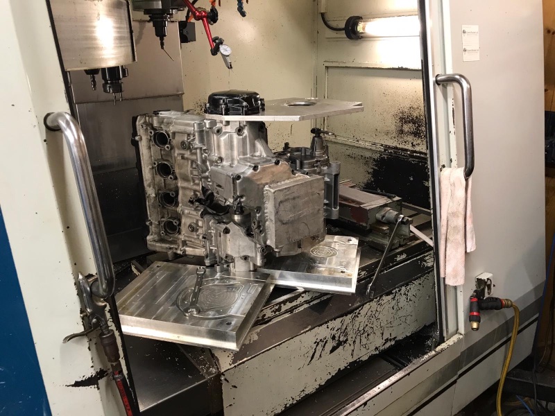

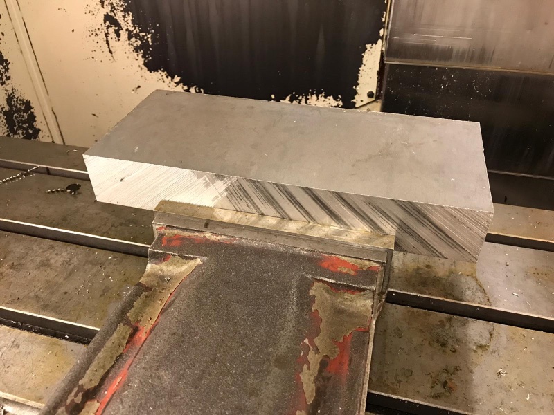

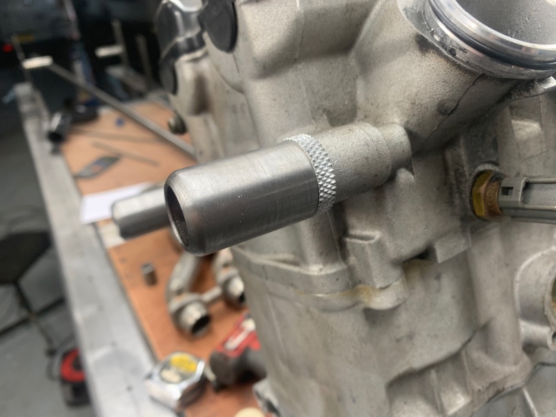

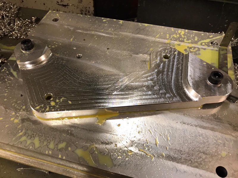

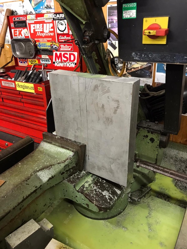

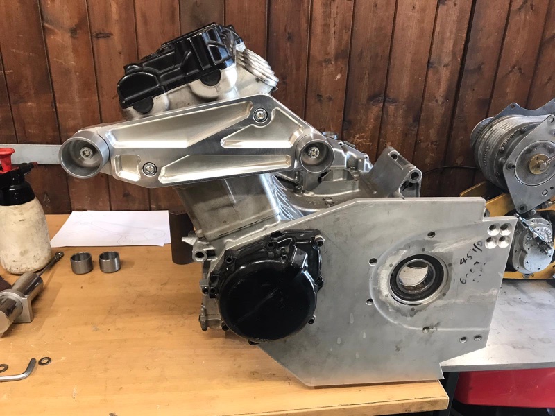

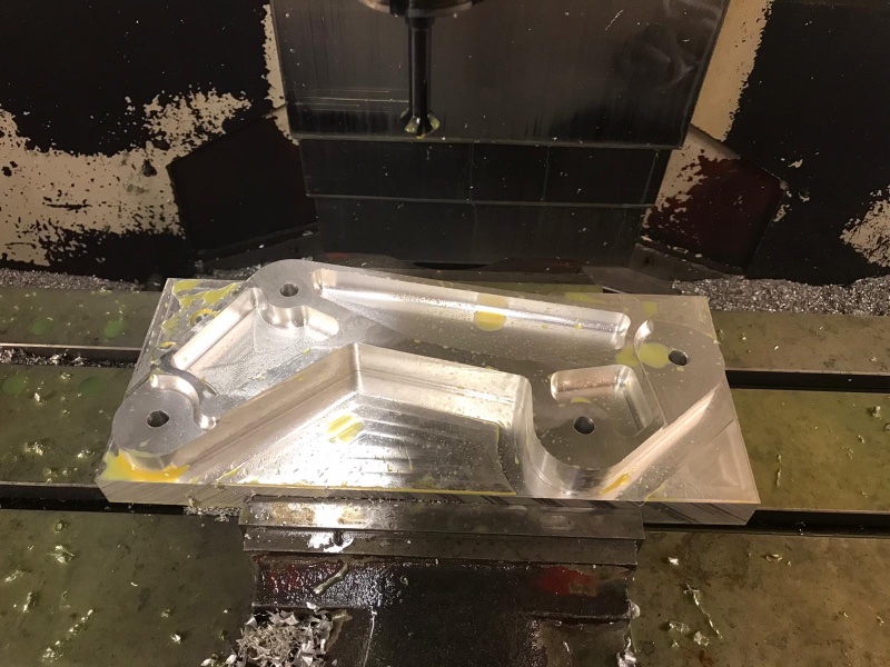

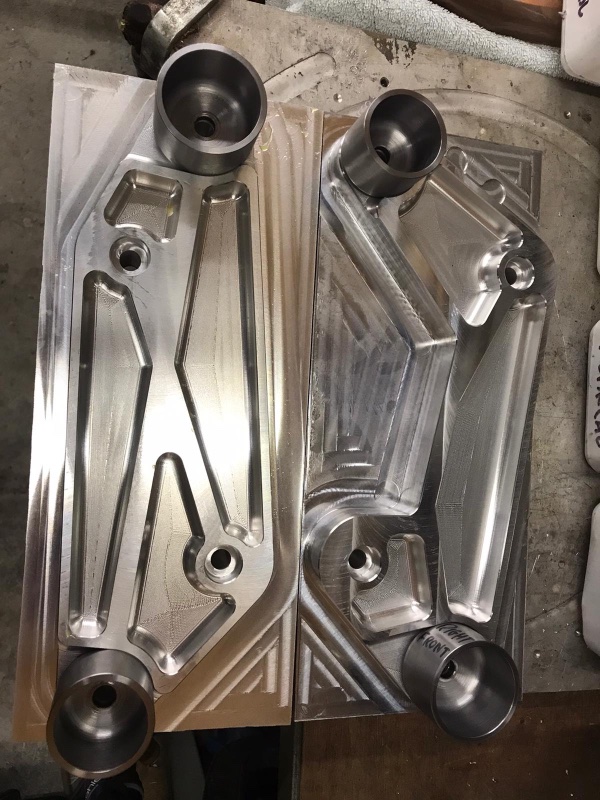

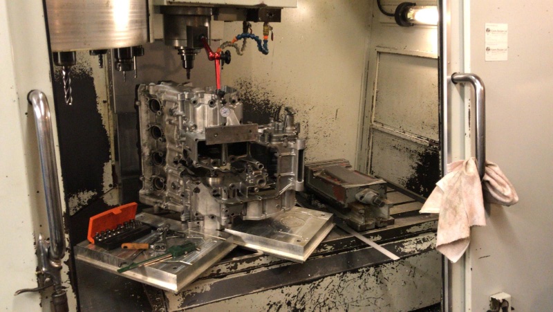

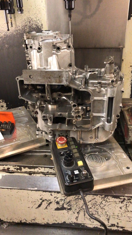

To get around this issue placed the engine on a measuring machine and measured all of the key points of the engine.
This later will also help us with 3-D modelling of the engine

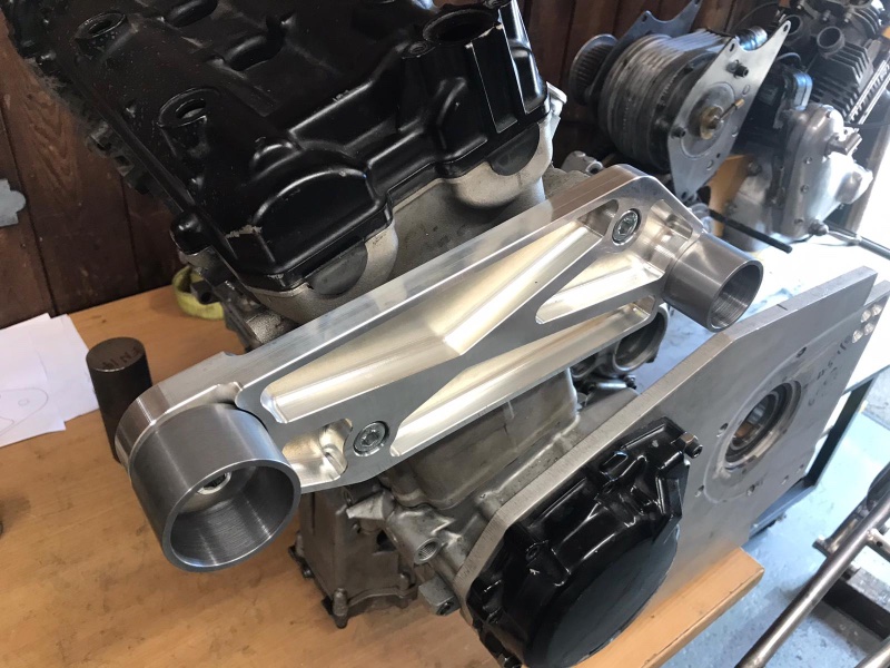

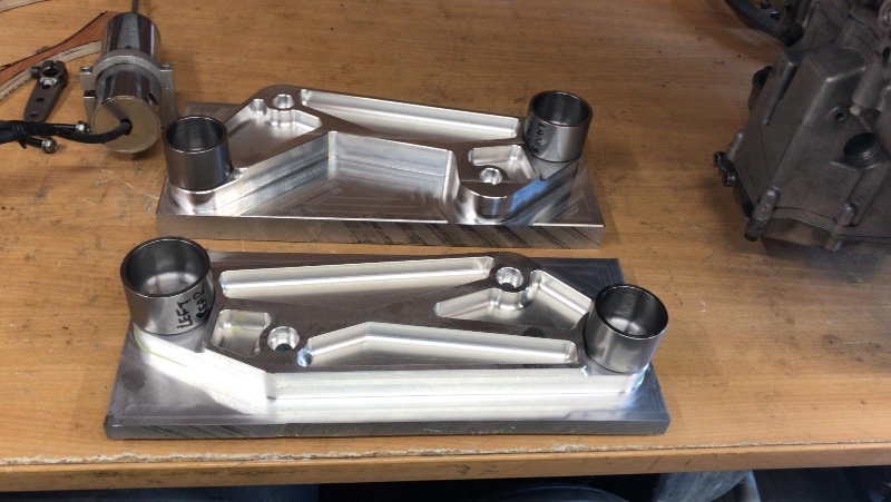

A set of aluminium plates was made which make both chassis mount symmetrical on both sides of the engine. this also meant that the aluminium plates could be removed and the engine removed from the side of the motorbike.
This will allow us to put a lot more structural rigidity in the base of the motorbike frame meaning it can be made lighter and stronger
