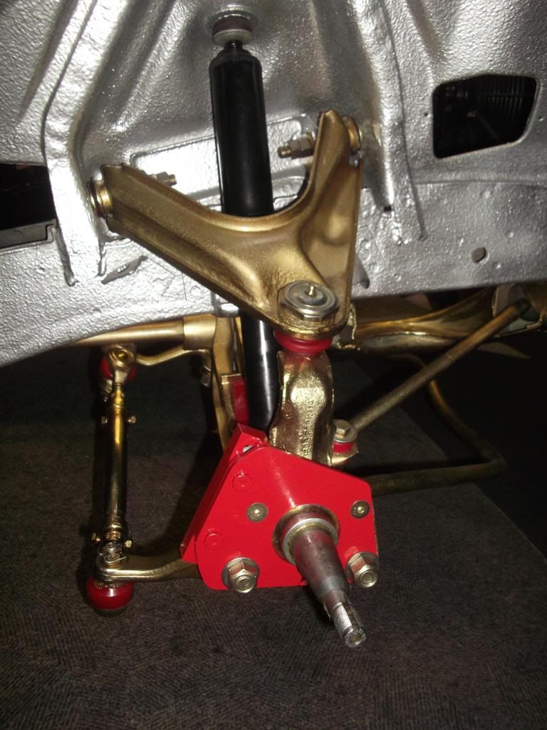

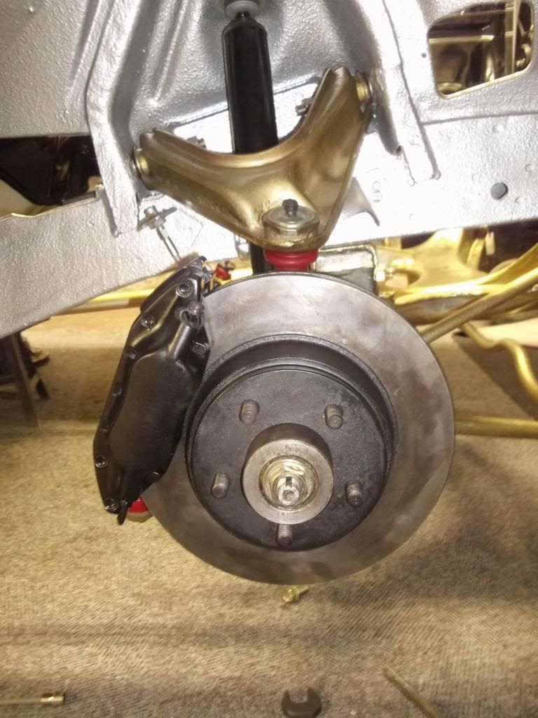

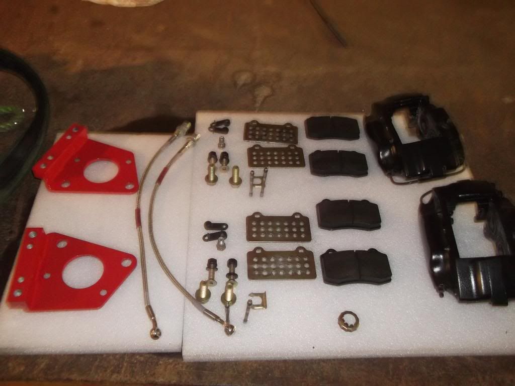

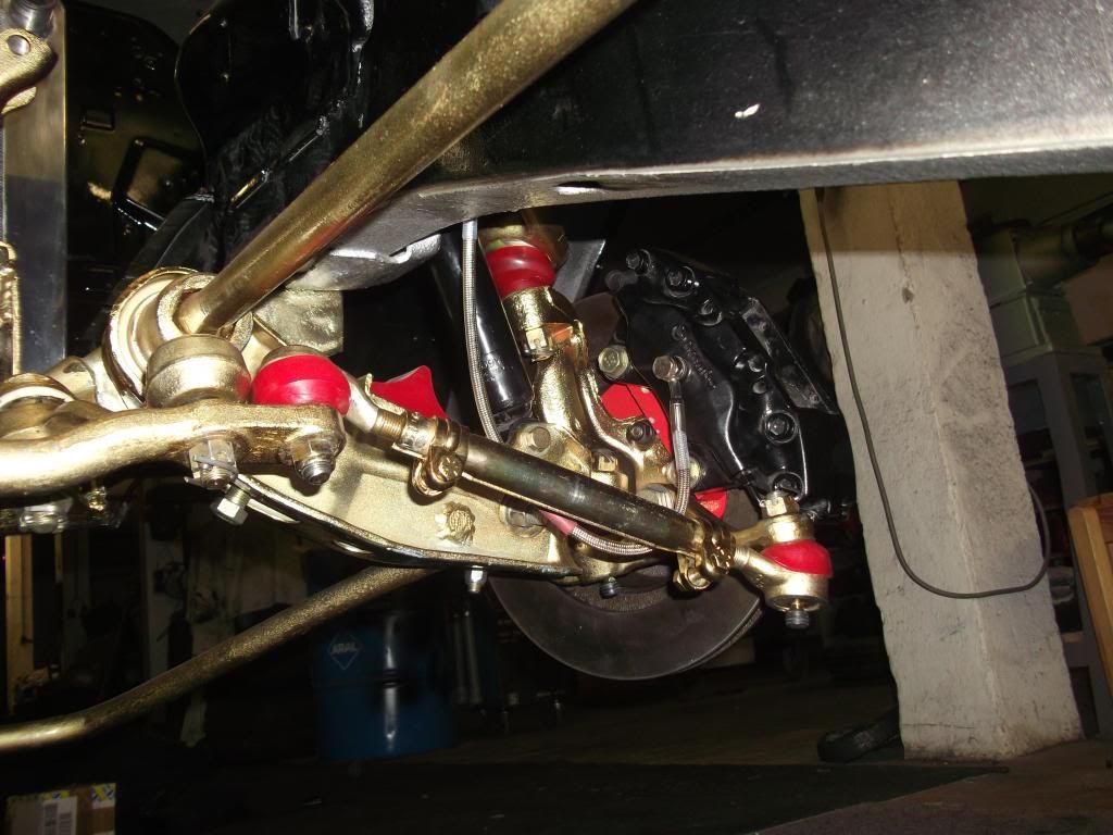

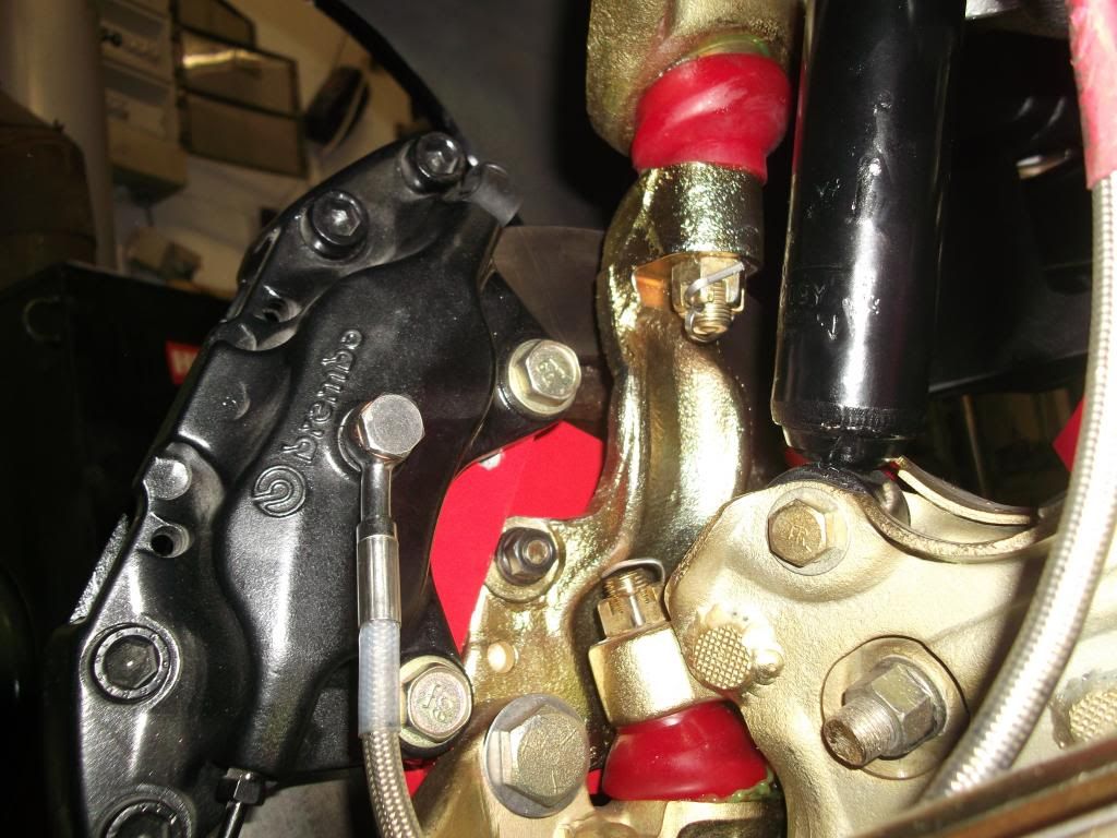

Front installed dodge viper caliper. The kit uses a spacer plate (red) to fit viper calipers. Also there are pad shim plates to bring the pad futher in. (gold with holes in )

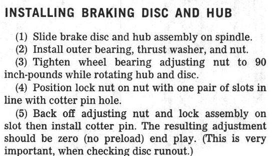

Q. The spindel nut (wheel bearing) I take it i just nipp it up as its a cone roller bearing ???

Dave wrote:And where is your workshop manual young man?autofetish wrote: Q. The spindel nut (wheel bearing) I take it i just nipp it up as its a cone roller bearing ???
The instructions below should read "90-in/lbs and then back off one slot".
Thanks dave a massive help as always.
Pete hope i did you proud nice kit thanks

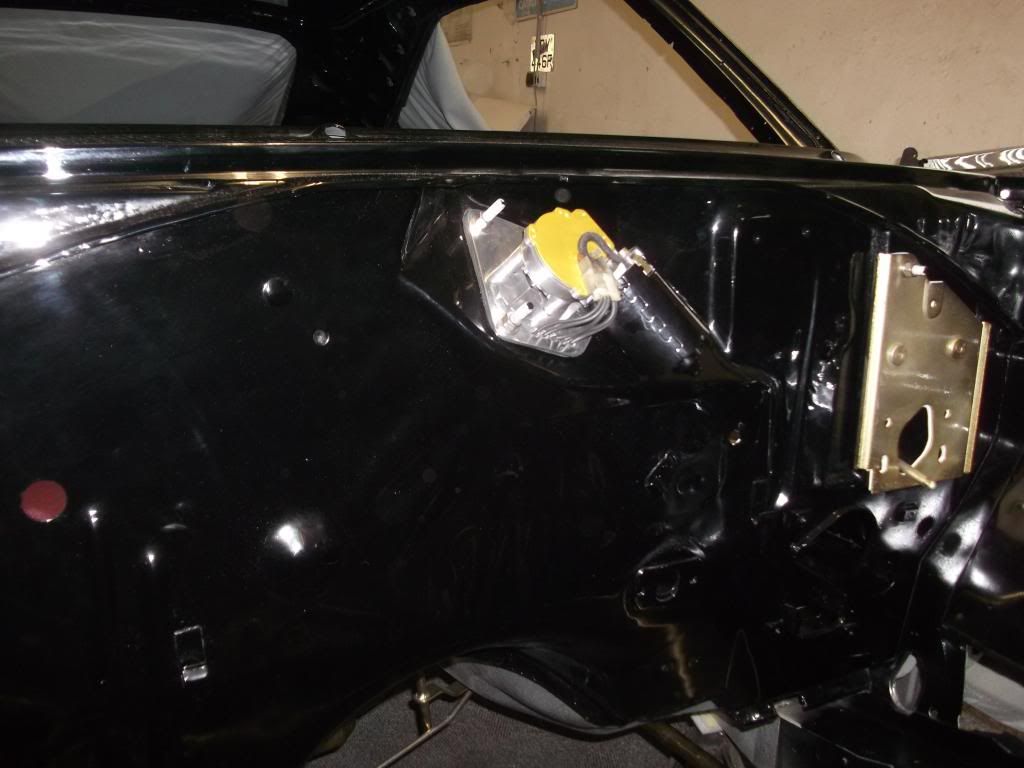

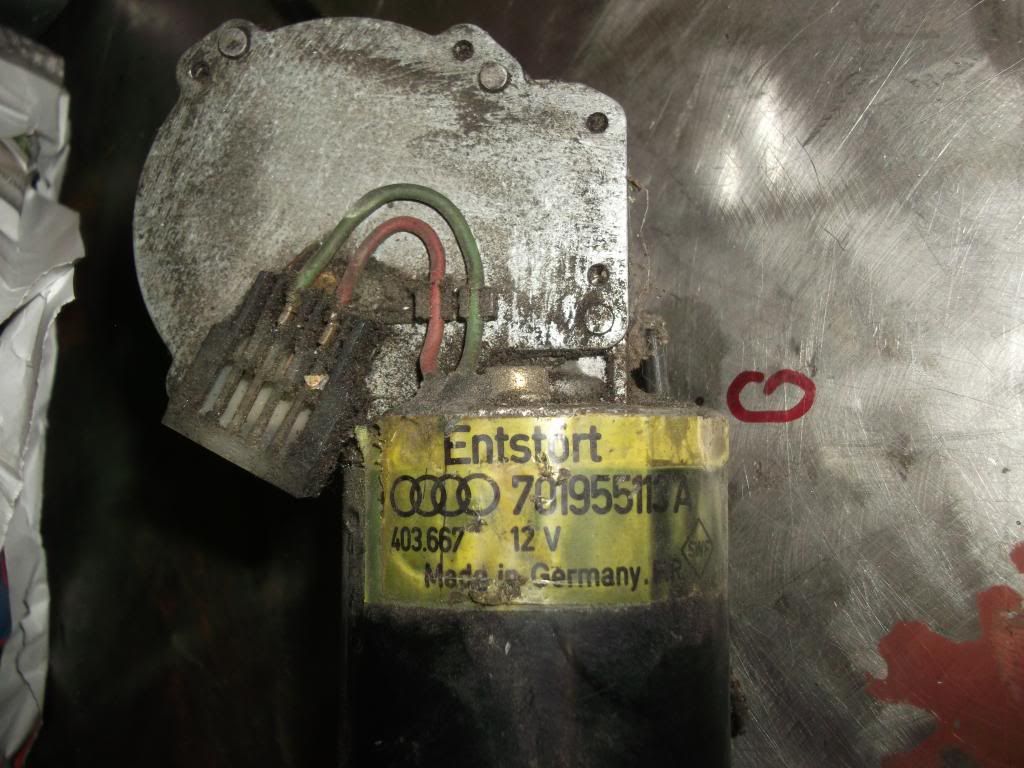

After spending too much time on the orginal wiper motor i gave up. The inner winding are fa bucked .
So i spend even more time running around scrap yards with a battery checking the speed of motors trying to find a modem wiper motor that will
Fit,geared correct,park alone, not to fast and not to slow.
Well i have it.
Might save some of you alot of $$ and time.

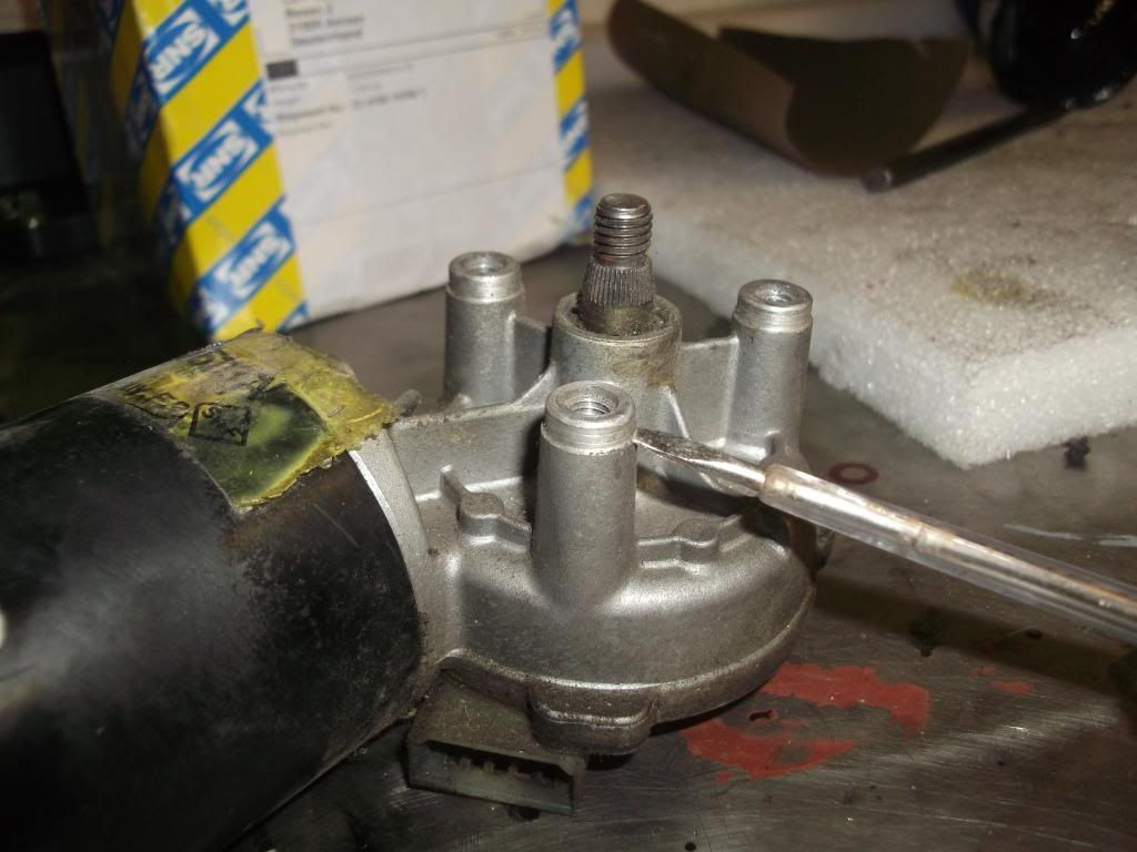

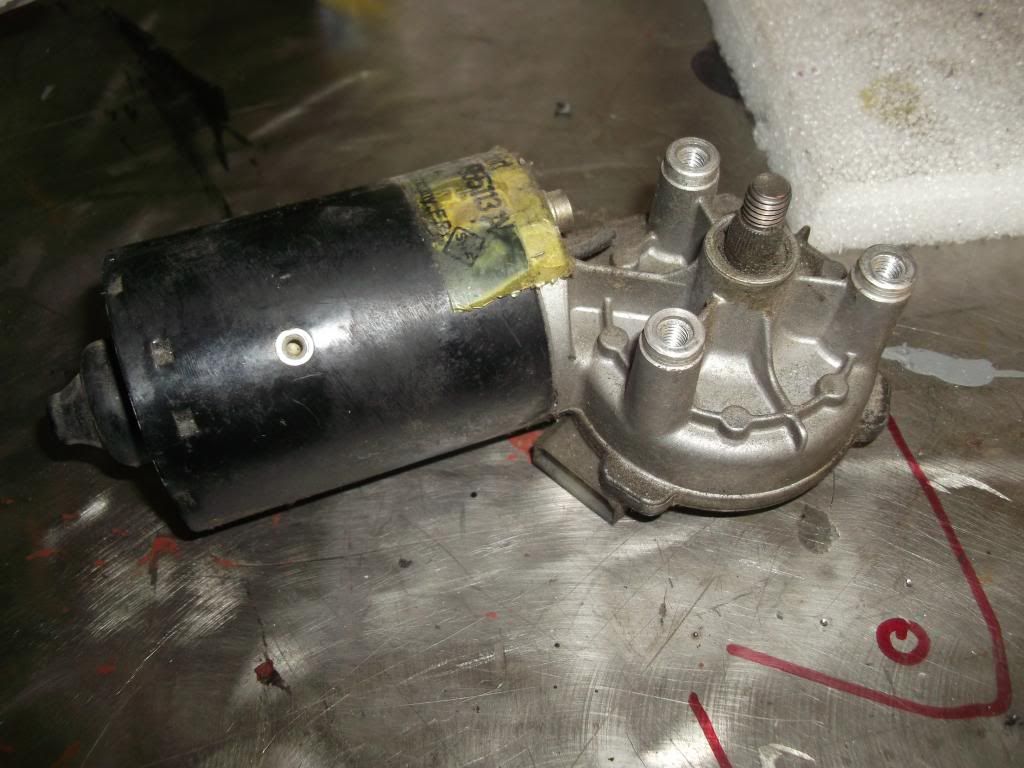

VW T4 Transporter front wiper motor 7 quid off ebay
Also used on some vw golfs im told
<a href="http://beta.photobucket.com/" target="_blank"><img src="http://i73.photobucket.com/albums/i205/ ... ure021.jpg" border="0" alt="Photobucket"></a>
<a href="http://beta.photobucket.com/" target="_blank"><img src="http://i73.photobucket.com/albums/i205/ ... e022-1.jpg" border="0" alt="Photobucket"></a>

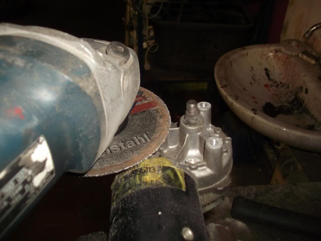

First step is to cut down the tread holes to the pre mark postion
<a href="http://beta.photobucket.com/" target="_blank"><img src="http://i73.photobucket.com/albums/i205/ ... ure024.jpg" border="0" alt="Photobucket"></a>
No fancy tools here
<a href="http://beta.photobucket.com/" target="_blank"><img src="http://i73.photobucket.com/albums/i205/ ... e025-2.jpg" border="0" alt="Photobucket"></a>

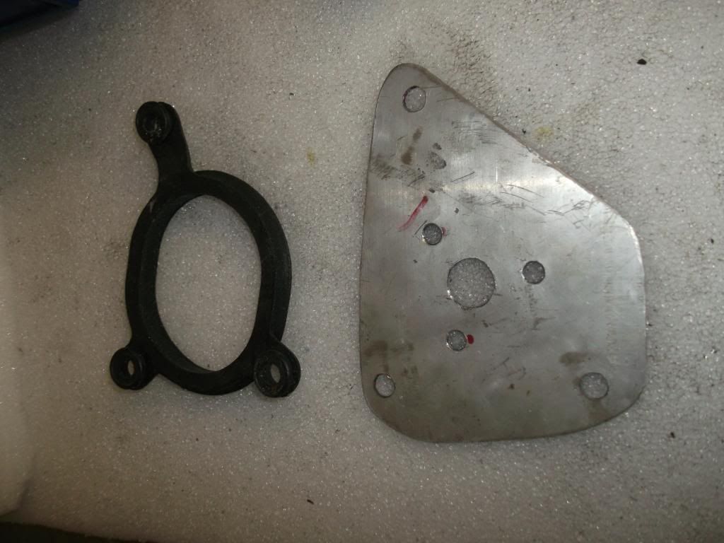

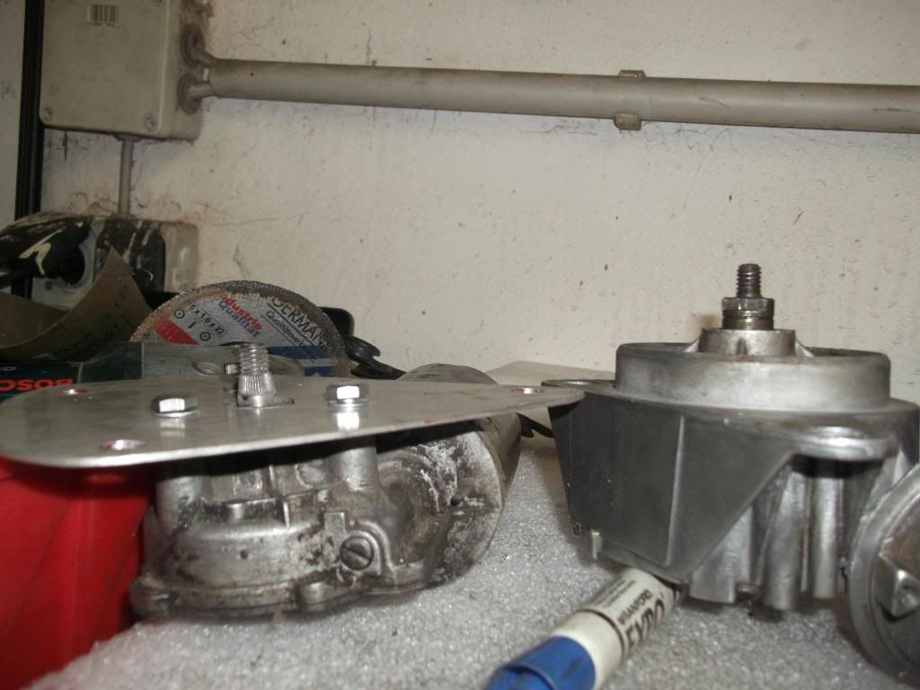

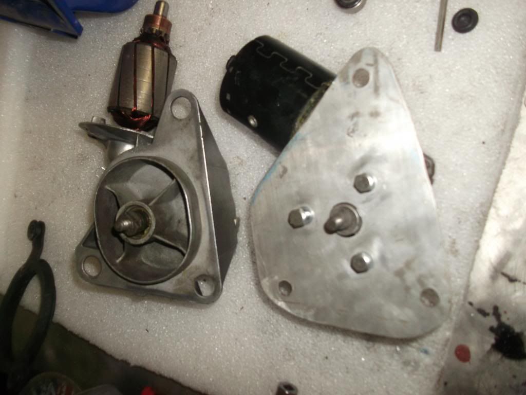

Next make a plate that will fit the car studs (use gasket for template) and the new motor studs.
<a href="http://beta.photobucket.com/" target="_blank"><img src="http://i73.photobucket.com/albums/i205/ ... e026-1.jpg" border="0" alt="Photobucket"></a>
<a href="http://beta.photobucket.com/" target="_blank"><img src="http://i73.photobucket.com/albums/i205/ ... ure027.jpg" border="0" alt="Photobucket"></a>

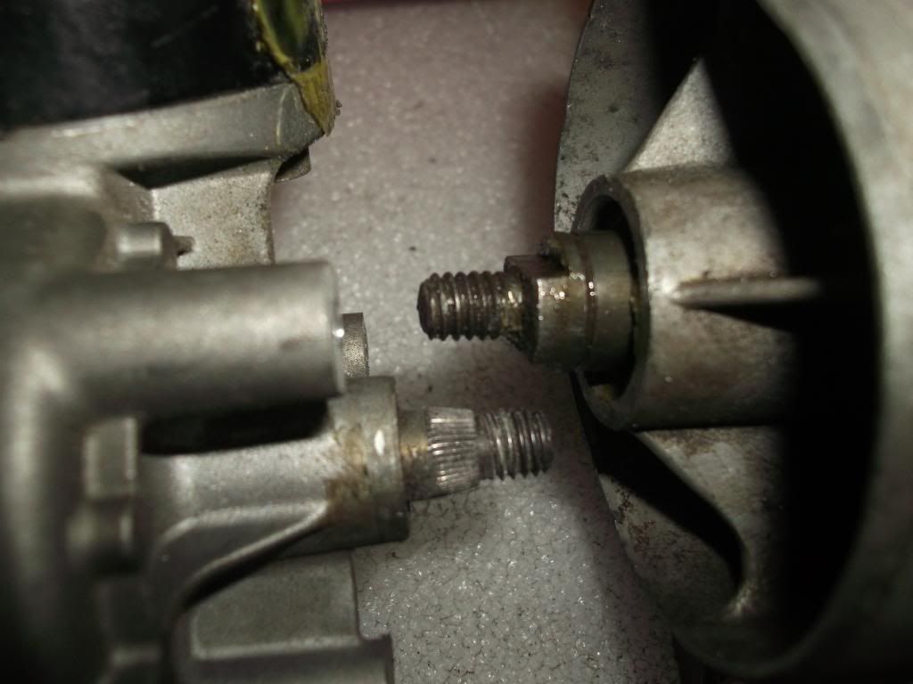

The nice thing about the vw motor is it has splines on the shalft so you can fit the arm at any postion. So when you make the plate dont worry about motor location just get it in the middle
<a href="http://beta.photobucket.com/" target="_blank"><img src="http://i73.photobucket.com/albums/i205/ ... e031-2.jpg" border="0" alt="Photobucket"></a>

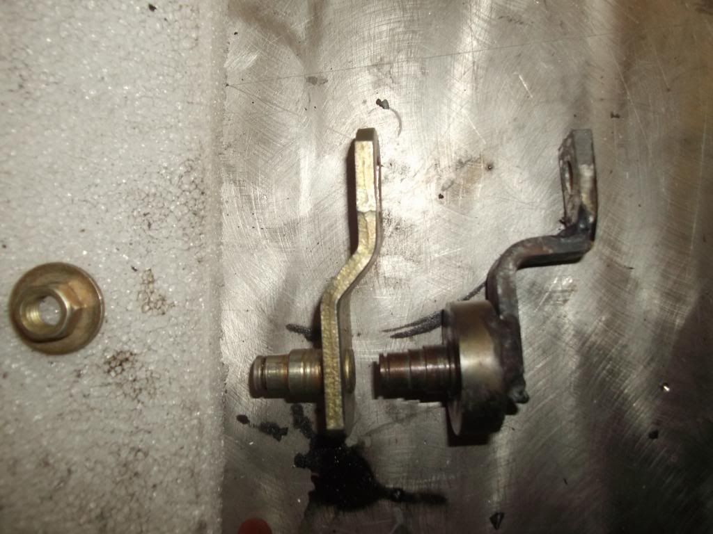

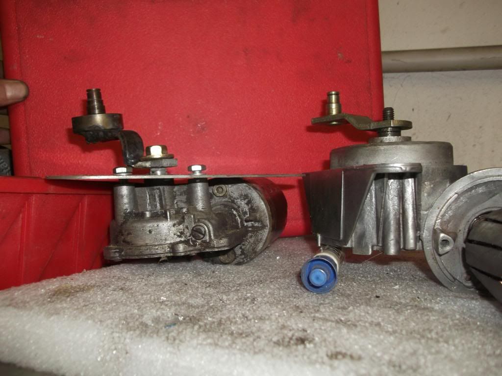

The next problem is the axle on the orginal motor sticks out more that the vw one does.
<a href="http://beta.photobucket.com/" target="_blank"><img src="http://i73.photobucket.com/albums/i205/ ... ure028.jpg" border="0" alt="Photobucket"></a>
To make this arm you could so easyly just cut the old one and weld a bit of metal so it sticks out more. i did want to cut up my orginal one as was in test stage so i made one badly.
<a href="http://beta.photobucket.com/" target="_blank"><img src="http://i73.photobucket.com/albums/i205/ ... e030-2.jpg" border="0" alt="Photobucket"></a>
<a href="http://beta.photobucket.com/" target="_blank"><img src="http://i73.photobucket.com/albums/i205/ ... e029-1.jpg" border="0" alt="Photobucket"></a>

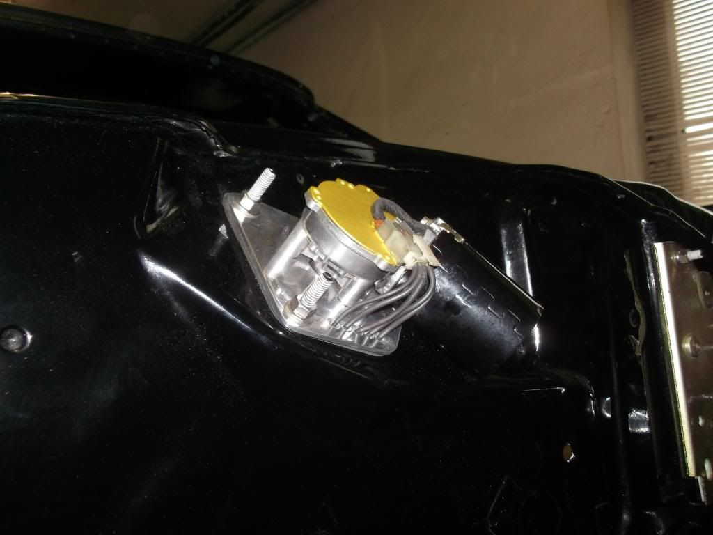

You should now have a modem motor that turns at simular speed in the same place as the old you can now just clip on the orginal wiper mech and fanny is your ant.

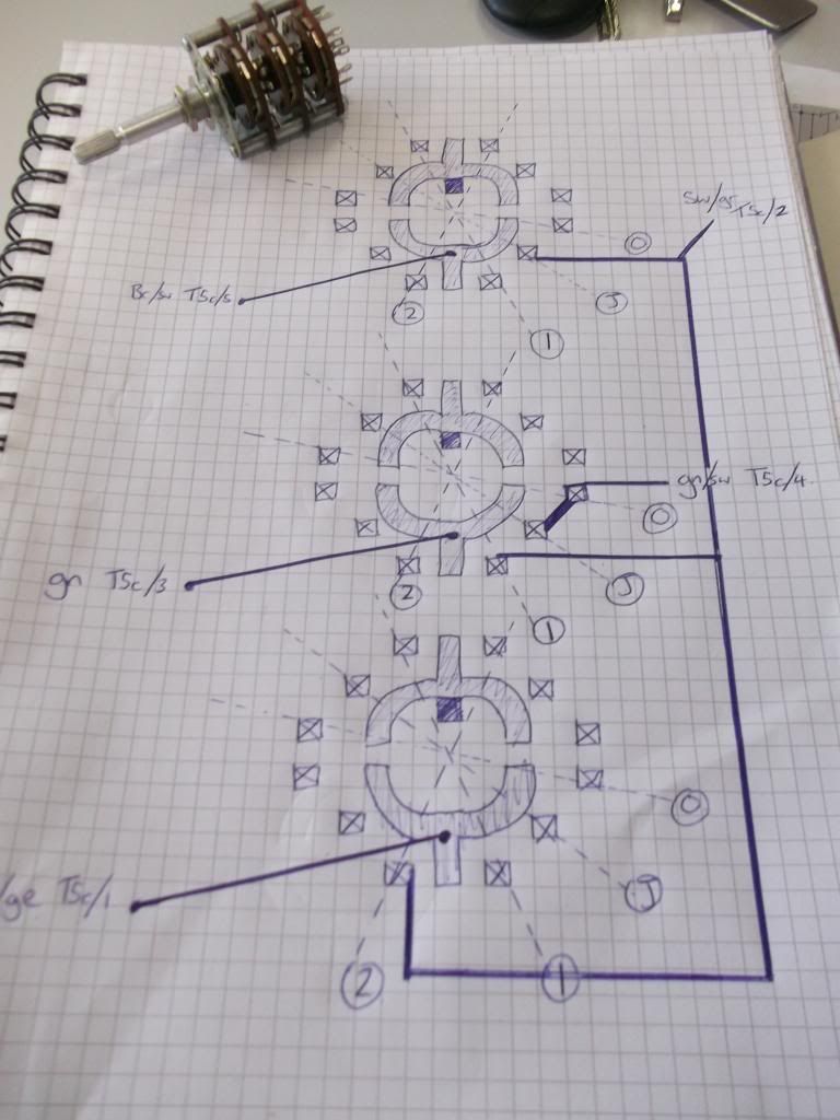

For a 2 speed slow and fast really easy.
If you want ajustable inter and water wash 3 wipe then you gona have fun.
Im now building a switch to use in J 0 T 1 2 3

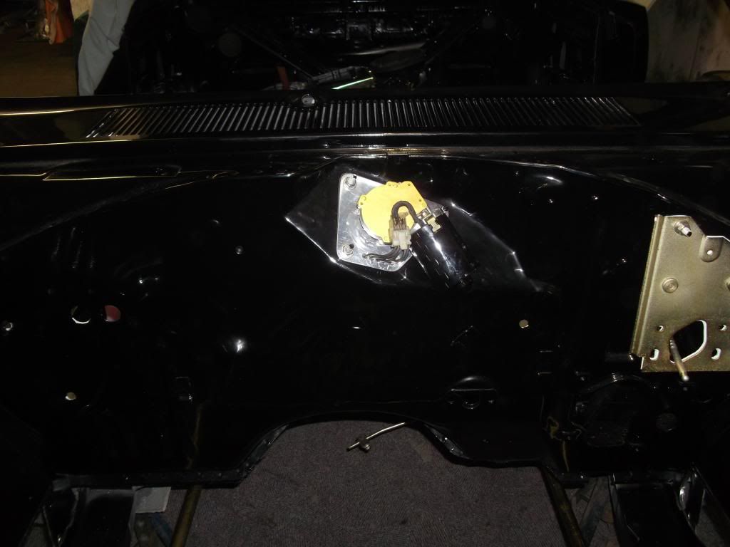

<a href="http://beta.photobucket.com/" target="_blank"><img src="http://i73.photobucket.com/albums/i205/ ... e044-1.jpg" border="0" alt="Photobucket"></a>

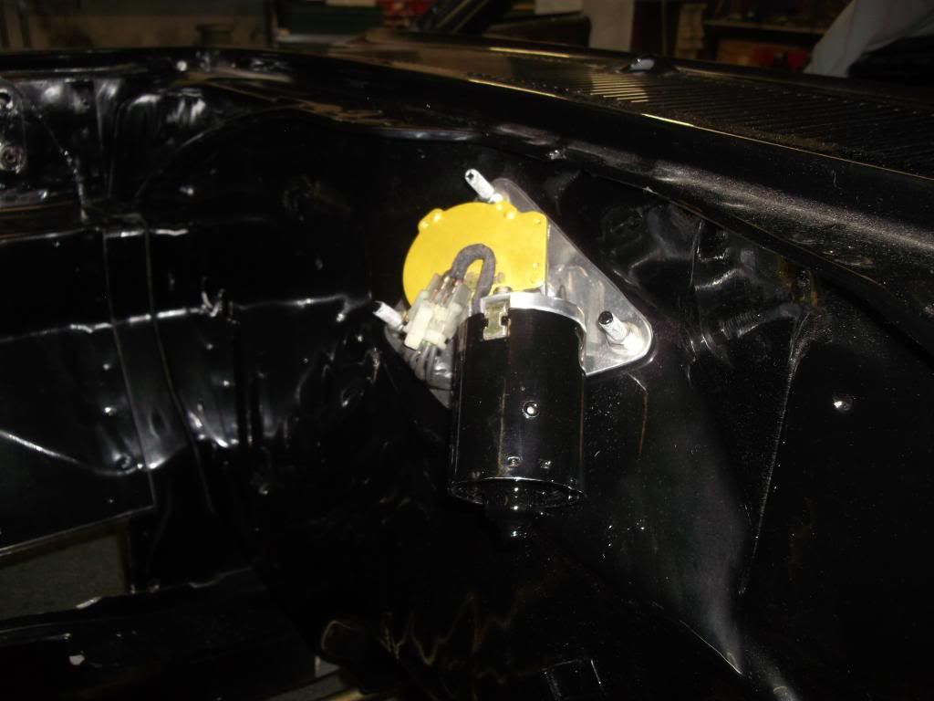

Cleaned up on car
<a href="http://beta.photobucket.com/" target="_blank"><img src="http://i73.photobucket.com/albums/i205/ ... e035-2.jpg" border="0" alt="Photobucket"></a>
<a href="http://beta.photobucket.com/" target="_blank"><img src="http://i73.photobucket.com/albums/i205/ ... e032-2.jpg" border="0" alt="Photobucket"></a>
<a href="http://beta.photobucket.com/" target="_blank"><img src="http://i73.photobucket.com/albums/i205/ ... e038-1.jpg" border="0" alt="Photobucket"></a>
<a href="http://beta.photobucket.com/" target="_blank"><img src="http://i73.photobucket.com/albums/i205/ ... e037-1.jpg" border="0" alt="Photobucket"></a>

Cleaned up on car

jee up you have virtually built a car and using viper brakes while Allkiller is slashing us about them, ha ha,
