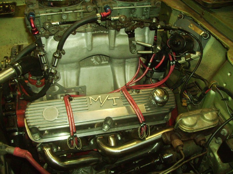

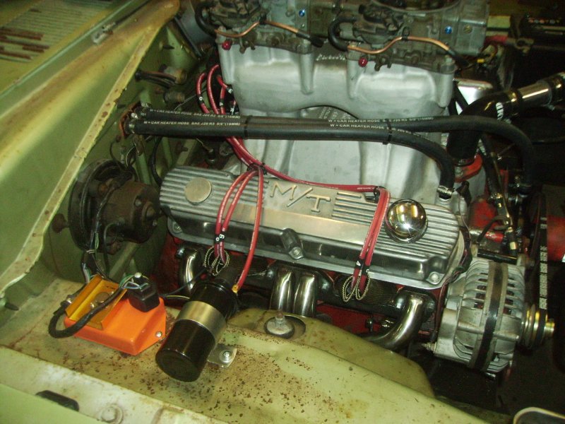

it seems to be early week as my oil filter also came 2 days before it was due so it'd be rude not to fill it with oil and spin it onto the engine surely? :D
and whilst out there i thought why not make up the plug wires too? i copied the layout from a member of the A bodies forum as it looked very neat an di tend to be anal about neat plug wires :roll: . 2 hours later i'm happy with the look. i found a set of moroso heat shrink wire numbers (2 of each, for both ends) so used them too along with a set of heat shield boots at the plug end of each.
not long before the fire up now :thumbright:
IMG_0001 (34).JPG (131.33 KiB) Viewed 1762 times
IMG_0002 (29).JPG (122.7 KiB) Viewed 1762 times
