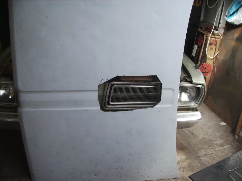

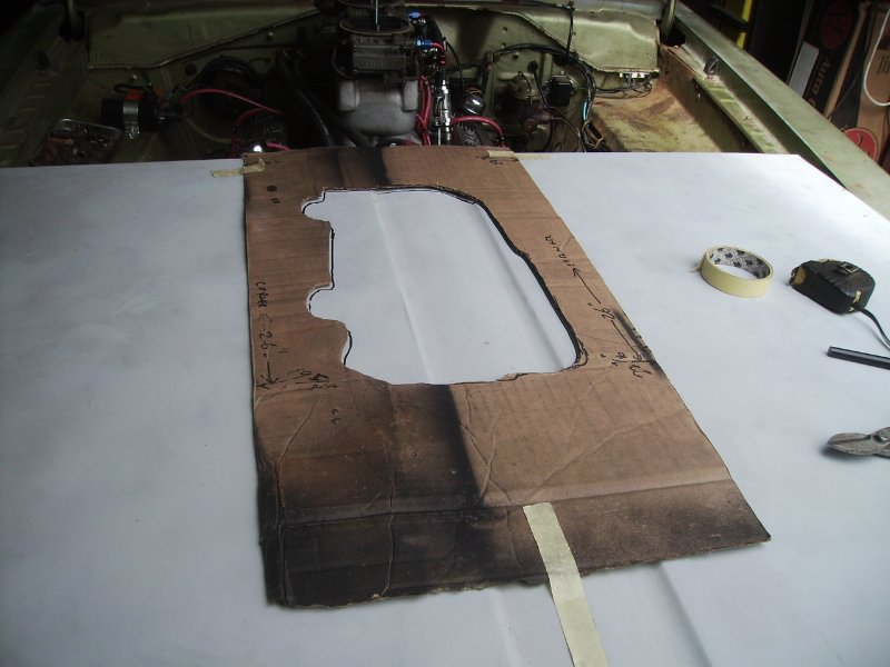

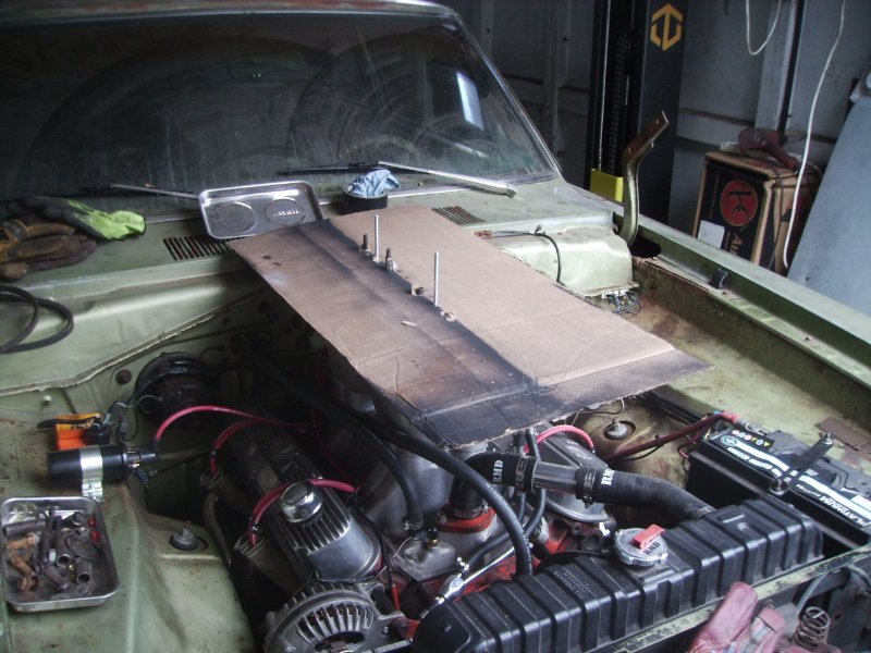

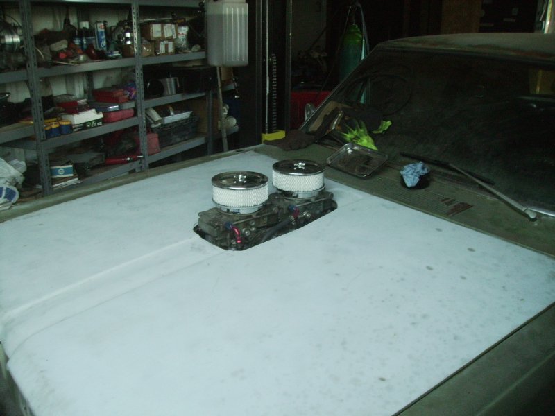

i made a start on the hole in the hood today. first was to make a template that fitted pretty close round the carbs etc, i drew underneath the card holding the sharpie vertical (ish). then transfer that to the hood with measurements and finally the first cut. i've cut slightly smaller on purpose, you can always cut more but if you cut too far one way due to a cock up with the measuring then you're done. next job is get ashley here to help me bolt it in place for final trimming.
neil.

Re: 68 valiant signet 2 door
OCD nightmare...Do you centre the hole round the bonnet pressing or the protruding carbs #-o :argue: :-k

Dom66 wrote: Mon Jul 05, 21 8:36 am OCD nightmare...Do you centre the hole round the bonnet pressing or the protruding carbs #-o :argue: :-k
i know 8-[
at the moment it'll be close to the carbs so off centre. i will make some sort of scoop later which if it's attached to the bonnet will be centred to the bonnet :thumbright:

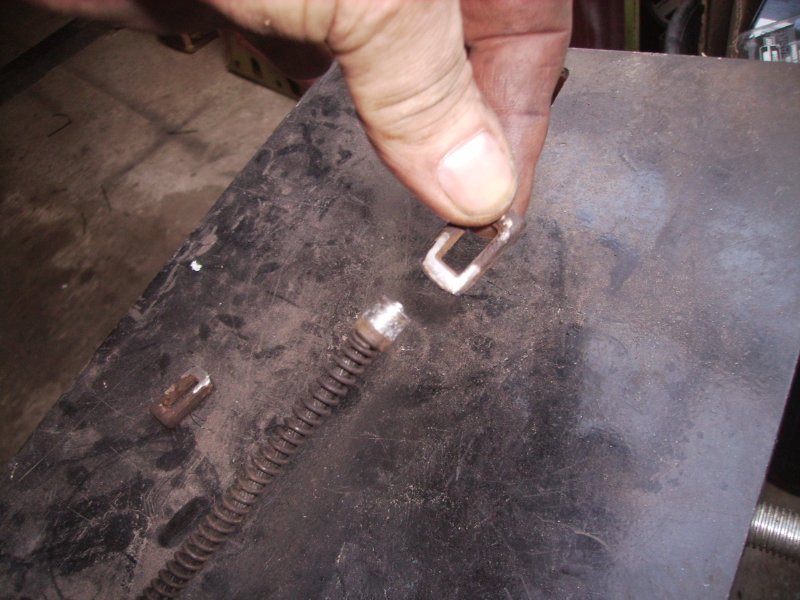

i've started the hybrid valiant/explorer handbrake cables today. i removed both rear cables so i can lube them before use (see pic) and i'll also reroute the front cable inside the chassis so it won't be in the way when i get round to doing chassis/frame connectors later on. i cut the 'loop' off of the end of each explorer cable and these will be welded to the valiant cable's end nipples. i'll need to make a couple of tube spacers as the cables look like they'll be too long otherwise but that's easy enough (already found some suitable tube).

handbrake cables made up and fitted and front cable rerouted inside the chassis. handbrake now works, tick.

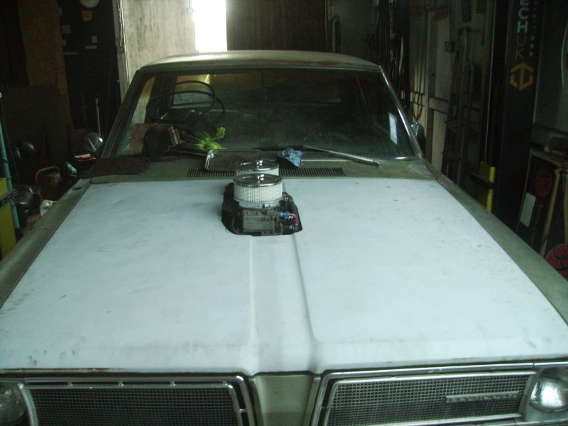

ashley came round after work and we fitted and trimmed the bonnet so that's done too, woohoo :thumbright:
neil.

Posts: 5893
Looking good, never a nice job cutting a hole in a bonnet.
I made numerous cups of tea and re-measured several times before doing mine.
Posts: 3537
Oi mister, your engines not in straight.....

Dom66 wrote: Fri Jul 09, 21 8:33 am Oi mister, your engines not in straight.....
8-) 8-) 8-)
i know it's proper wonky. not in the middle at all ;)

MattH wrote: Thu Jul 08, 21 11:01 pm Looking good, never a nice job cutting a hole in a bonnet.
it was ok i used cad (cardboard aided design) :thumbright:
i did it once before on my 390 gta '66 fairlane :D
