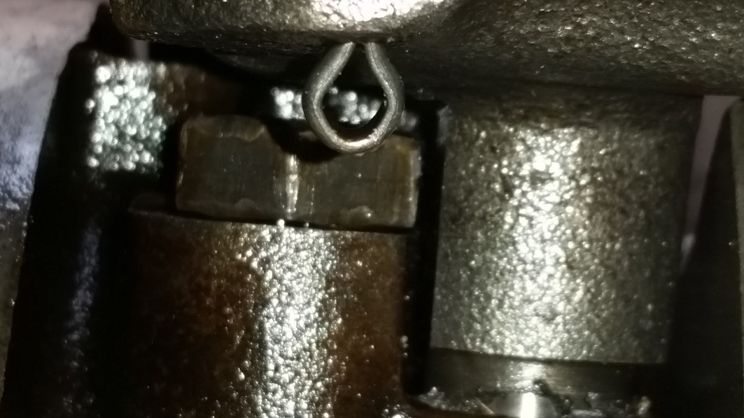

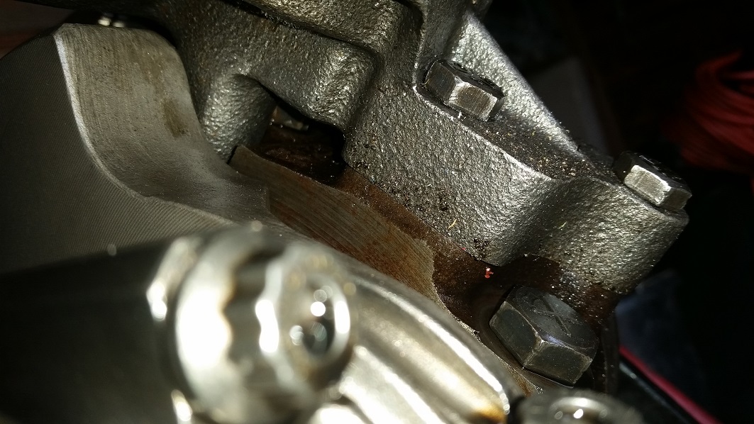

chances are oil pump does not sit flat on block because of aftermarket main bolts/studs.

Pump and bolts are the same that were on the engine prior to rebuild. I did check the pump was sitting flush with the block when I re-fitted it, but half the gasket had vanished when I unbolted the pump, could have been enough play to destroy the pump?

check again,pump will be sat on one of main bolts,the pump will be cocked over

Carl wrote:Pump and bolts are the same that were on the engine prior to rebuild. I did check the pump was sitting flush with the block when I re-fitted it, but half the gasket had vanished when I unbolted the pump, could have been enough play to destroy the pump?
DaveB wrote:check again,pump will be sat on one of main bolts,the pump will be cocked over

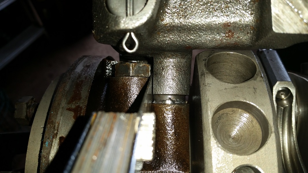

Appreciate what your saying Dave and grateful for your input. I bolted pump back up to check fitting again without touching anything else and as I said pump is not sitting on a bolt or cocked over and is flat on the block. And plenty of space between the bolt and pump body 0.035" feeler gauge slipped in nicely between bolt head and pump.

And plenty of room over the bolt too

stuck relief piston? was it shimmed?
or just a minute crack in the pump that failed?

Was the pump shaft that cracked and failed and the outside casing had a chunk out of it, not sure if that missing chunk on the outer case had anything to do with it, could of caused play in the pumps shaft im suspecting. Didn't find the missing chunk in the oil or sump either, maybe missing when I installed the pump and I never noticed?
