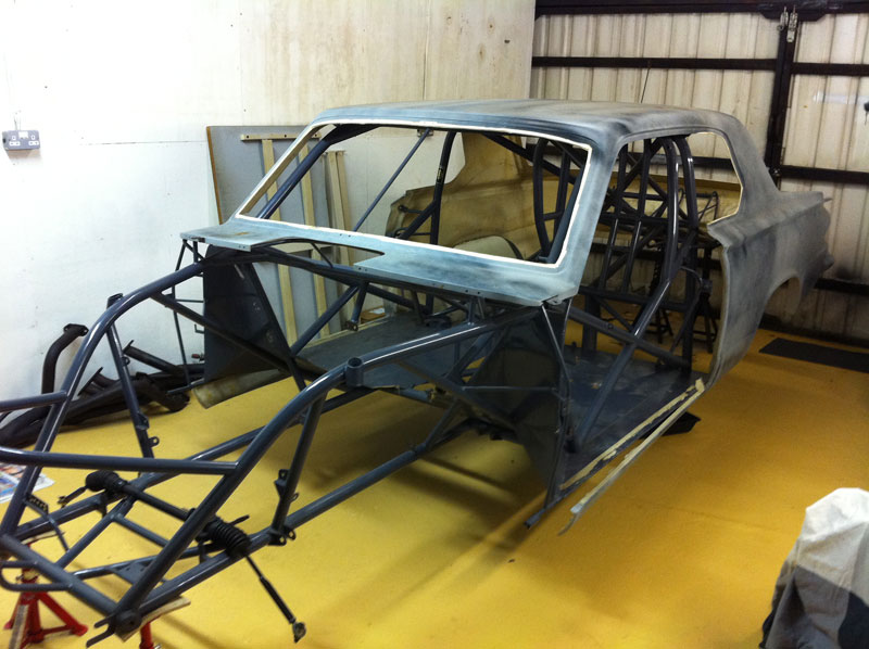

Hi Jon, When I've got the engine and transmission out I'm going to lift the body off so that I can give the chassis a clean and paint the inside of the fibreglass body. Before I do I'll take pictures of all the mounting points and post them up. The body is bolted straight on to the chassis, I have been wondering whether I should use some sort of rubber or plastic spacers or washers to avoid the fibreglass cracking? :?
Any advice Duncan, Mark, Trev... ?

TyreFryer wrote:Hi Jon, When I've got the engine and transmission out I'm going to lift the body off so that I can give the chassis a clean and paint the inside of the fibreglass body. Before I do I'll take pictures of all the mounting points and post them up. The body is bolted straight on to the chassis, I have been wondering whether I should use some sort of rubber or plastic spacers or washers to avoid the fibreglass cracking? :?
Being a custom chassis & custom body, the body mounting points would of been specifically made to ensure there was the least or nil distortion.
I personally would use a med- hardish rubber between the chassis & body mounting point, in addition I would use large style washers to spread the load, when tightening the body to the chassis

Anyway, tonight I pulled the engine and transmission out so the chassis is completely stripped apart from the body which I'll unbolt tomorrow night (I'll take the mounting pics first Jon) and the steering rack, which I need to give a bit of a whack with a mallet and a soft drift. I'll have to leave that until the weekend as I don't want to annoy the neighbours.
