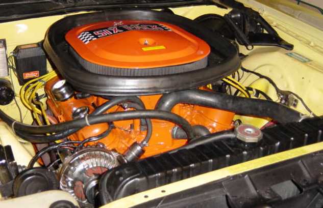

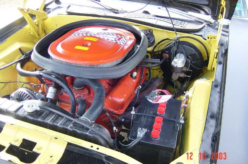

Nope. Well my AAR didn't and it was pretty damn near original...........pretty much the same set up as any 6 pak Mopar car - a big tray to catch the water......
Posts: 22109
Found some pictures of my old AAR and also the T/A.
The rubber at the top of the pan did not mate a great seal against the hood as the latter curved away due to hood spring tension.
The A12 does not even have a rubber seal.
You can also see the over flow pipe from the tray that then sprays water all over the engine... :roll:

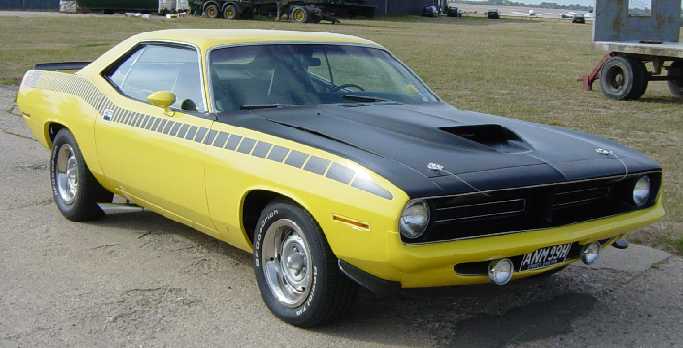

Pete was the AAR for sale at Dave Madders? looks like the one he had for sale when I bought my Duster.
Posts: 22109
Yep. I imported it from Rochester, Pennsylvania...Alex Doig and I picked it up in person...

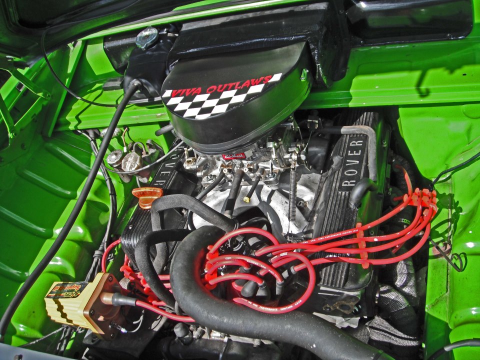

Hood all pinned down and secured and fuel supply sorted out, ta MickRR!, amazed to see the difference that just installing the Performer intake has made :thumbright:
Really quick throttle response and a whole lot more midrange and top end power, making full use of the cams lift and a good increase in plenum volume, well pleased just a shame I didn't do it for last sunday :oops:
Hood looks Bananarama! out in the sunlight tho, my drug fuelled painter must have been proper flyin when he painted this.......... and last night in the garage Hermans partner in crime, Lily, ran head long into the hood while it was leaning against the wall and took an inch off one of the corners :roll:
