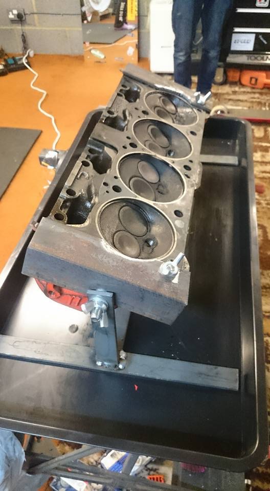

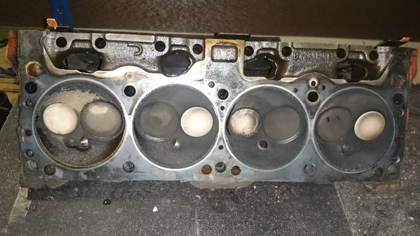

OK, so this is the first time I have ever removed cylinder heads. Compared to what I have found so far, this looks a bit crusty to me :dontknow:
Appears to be 1973 J heads on a block thats casted 1971 :( Post emissions smaller inlet valves then?
Any cleaning tips or am I being too picky? :read2:
I have pics of each piston head in the cylinder but the internet is on a rural go slow so they might have to wait :roll:

all pistons are ali mate ,its had a rebore to +40,maybe worth having a look at your bearings while its out,and throw a new timing chain in and see what cam it is ,its a mopar perforemance purple jobbie in there ,is there a step at the top of the bores ,if nothing major id say its fine,,pistons look a fair way up the bore too :thumbright: looking at the heads ,shes been running spot on,looks like a nice motor :thumbright:

Bearings are standard (dated 1999) so yes mate I'm going to replace and Pete has advised, as you have, to replace the timing chain while I'm there.
Heads are ready for a proper clean up, valve seats etc. Then simply pop her back together and ready for spring :lol:

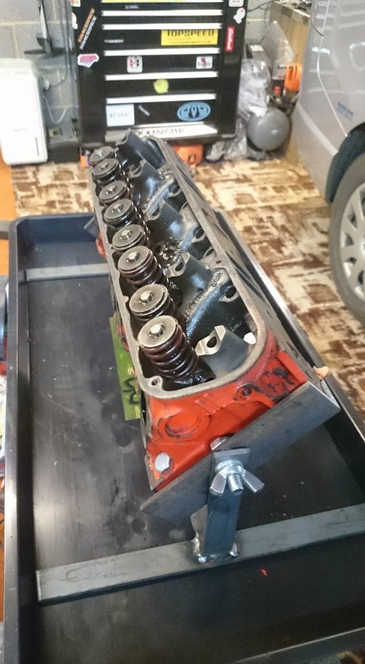

Luke is doing his Duke of Edinburgh and part of it is to learn and complete a new skill, so welding and fabrication it is, handy that :lol:
I'm not allowed to teach or assess as we are related but my employees can :thumbright: I just come up with the projects :D
Here is a prototype small block rotating cylinder head work stand, how handy :thumbright: :thumbright: cheers Luke :lol:

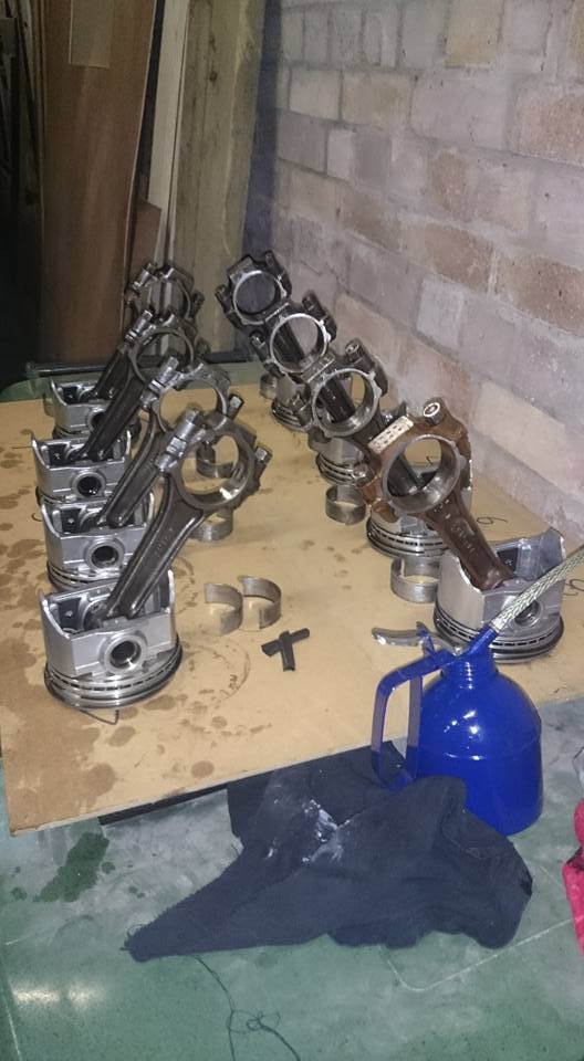

Having been away for work last week we are now back on it :thumbright:

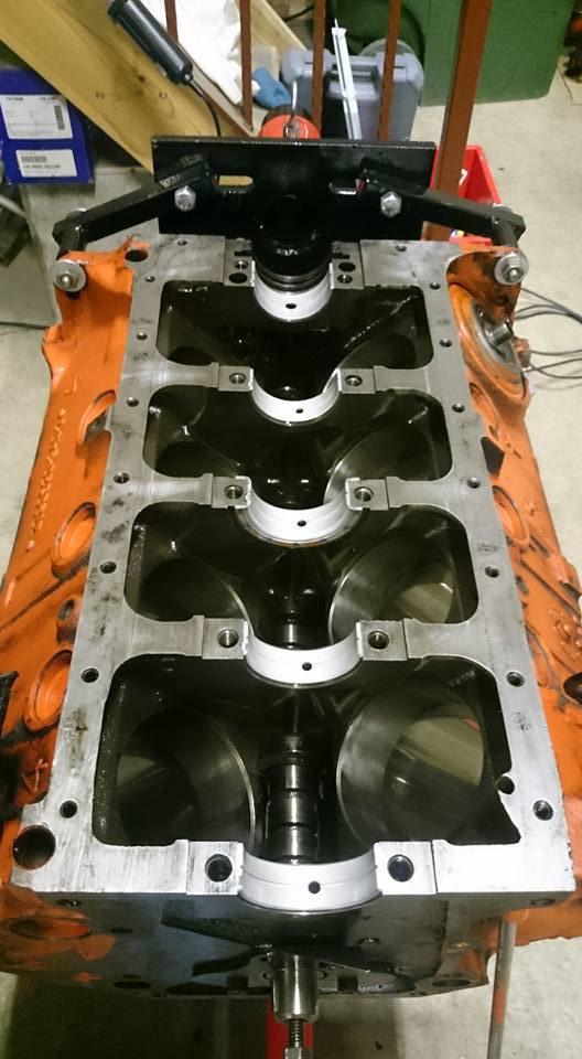

Pistons out and cleaned, crank out and clean so tomorrow should be new bearings and plastigauge so I can start getting things back together :)

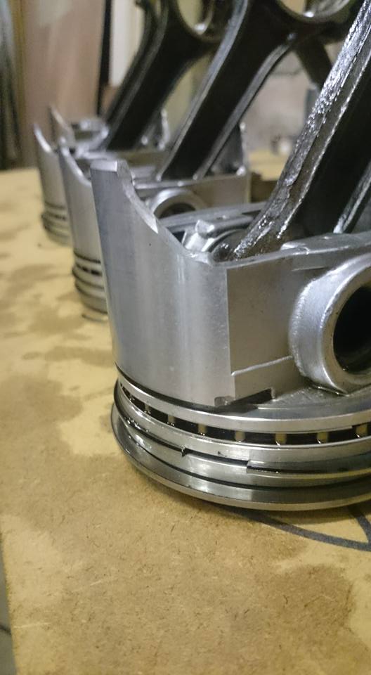

Cheers Pete, I should have taken a "before" picture really. The Pistons had burn marks past the first ring then some light yellow staining past the second ring so not so bad I guess.
Any tips on removing the third ring or leave alone as it all seems ok?

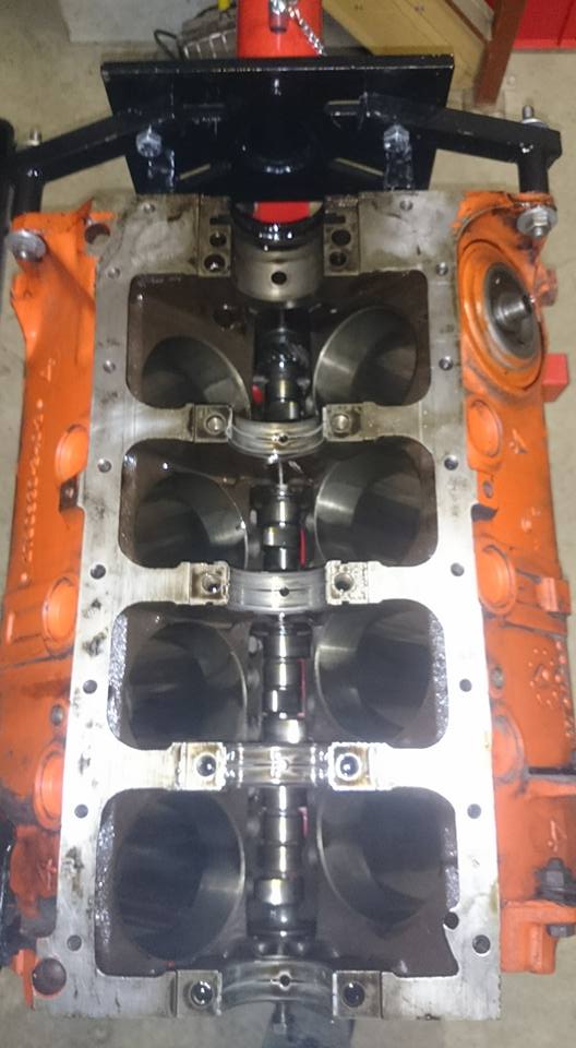

We have turned a corner (tentatively) and it's finally assembly time. Just about to plastigauge and then hopefully crank bearings done :thumbright:
