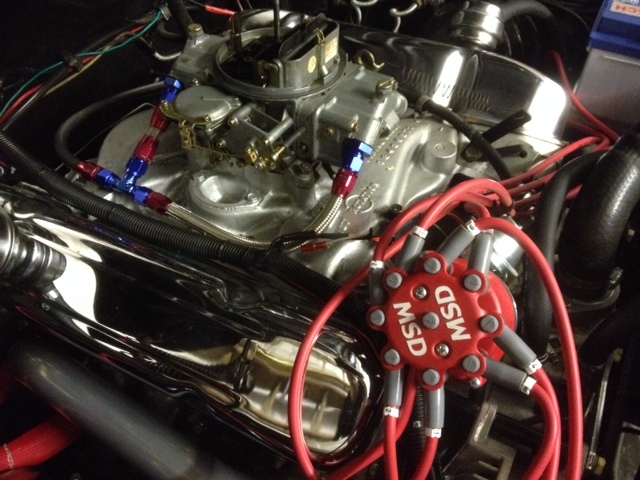

Should be OK. Checked seating etc, didnt push back out. Looks like this. (excuse artwork).
I just got lucky with my method/fittings hopefully.
How crazy is that ? Concerned because something DID go well . :)
Posts: 4226
Bolted it up. Looks good; not fired yet.

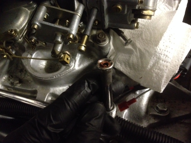

Also one of the feeds (not the leaky one interestingly)had eaten the last set of washers I put in there. Looks like overtightening had mashed it. But if the Bananarama! thing had stayed leak free then it wouldnt have been tightened so much. QED. :)

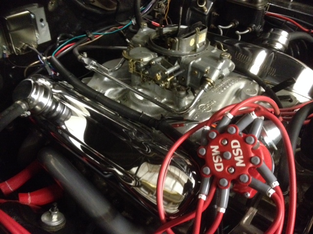

Anyway, pic1 = before, pic2 = munchymunchy washer, pic3 = after.
The fittings for those that are interested were 'torques' from ebay. The whole lot came to about £50 including the hose. A lot more than the old chrome twin pipe feed, but if it stops me catching fire then it strikes me as worth it.

photo 3.JPG (144.44 KiB) Viewed 633 times
numnumnum. Munch.
numnumnum. Munch.
photo 2.JPG (113.21 KiB) Viewed 633 times
Before. Rear one was the leaker. Nasty.
photo 1.JPG (140.06 KiB) Viewed 633 times

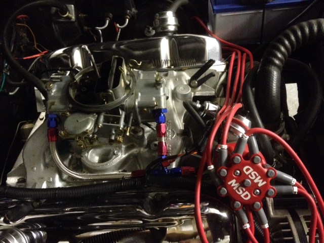

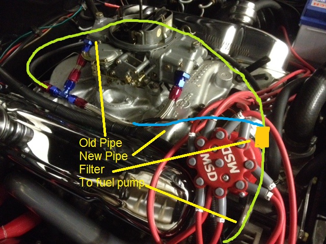

Any reason for running the fuel feed around the back of the engine like that? It's inviting fuel percolation, can you not turn it around and run it down by the dizzy?
Posts: 4226
On the previous installation the length of the chrome fittings fouled the dizzy - so no dice they had to point backward; had to go the long way round. Works OK as there is a fuel filter just behind the dizzy.
Interestingly I did play around last night with routing past the dizzy with the new setup, and it is doable, but its a bit of contortion and makes things very busy at just the point where all the wiring and dizzy come together. What I might do then is leave the existing pipe in place from the fuel pump into the filter, but shortcut from the filter onto a forward facing mount.
Hadnt experienced any issues from long pipe; but if its bad practice then I'll fix it. Thanks (as ever).

Morgan nice fittings shame you can't route around the dizzy tho...
Rich
072
Posts: 4226
Dunnit now. Cant go between rocker and dizzy (seriously, there is about 2mm) so heads out to the heater hose then back. Couple of tightish bends, but took 18" off the fuel line. Will fire up tonight and see if it links...

Well, routed OK. Had to head North of the dizzy to get enough wiggle room for the filter, but its much neater. Good call.
Flooded out the rear on first fire up (seal to the carb, not the pipe union). Gave it a good tweak. Seems OK; but might still be weeping a little. Finger was wet during the ol swab test - but that could have just been residual - once something is covered in petrol once its kinda hard to tell.
Will fire up again tonight and see. Have to say, dont want to go much harder though - its had a fair armful on it and you aint supposed to over tighten carb fittings :-k I may just have that rear one off again and check out your earlier post on 'things to slap on fittings and stop them weeping'...
