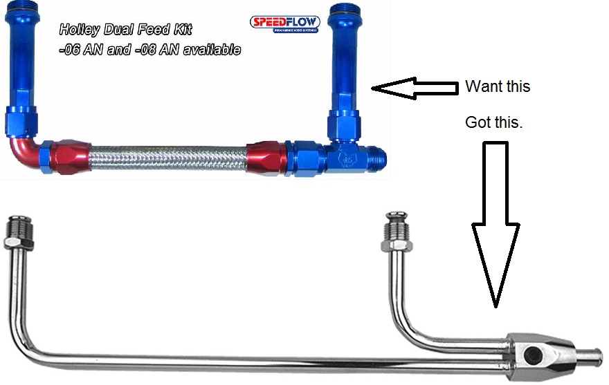

new problemette to sort - stupid fuel lines leaking again. Only a drip, but still petrol so not good. been crap since the day it went in - its the carb fitting. Tried mega tight, rubber washers, fabric washers ( which had been fine) but now oozing again.
new thread methinks. How the @@@@ do people get carb fuel lines to seal ??

morgan wrote:Thanks Ade. Yeah, i will show you what i was trying to describe. I meant to pop in some time anyway.
The fitting in to the carb?
John (Blue) told me to replace my solid type silver holley bar for some AN6 fittings, they have an o ring and are bang on. They seal even when they are not that tight. Bit of a cost buy I got all of mine and fuel line for about £100 to do the engine bay.

Yep. Thats the one. I'll get the fitting sorted first (time to give up on the old fittings, its never gonna be right) then much around some more with the vac.
Vac is annoying. It must be moving as car bangs like a mortar-cannon when connected (which implies it isnt locked out) - but its like its over adjusting like mad. Which begs the question why isnt it adjustable ? Which means it must be me... Which is good; as it means someone with more nous may see whats wrong).
Thats the plan. I'll sort the fittings then Ade and I will have a play with the vac can.
AN6 or AN8 ? Whats the diff ? Need to research which is right for a holley750...

leaking carb mounting
if you go to halfords and find the shelf with the sump plugs on it
a BMW or ford uses a sump plug with a washer that has rubber seal bonded onto both sides. its the ideal size. take you fuel pipe with you to check. its like a tiny Misab gasket
these have a proper enginering name which i just can't remeber its a
%$^$^&%$ washer if you catch my drift.
use them and put the tinyest smear of blue hylomar on the later few threads.
so you deal with the mount and you deal with thread leakage
you can use plumbers teflon but it goes stringy and makes it way to easy to split the carb top
becasue real tight on a dry thread is approx 1/2 as tight as real tight with a teflon coated thread
you will hear different views on teflon tape and fuel systems
i used it on the fuel pressure gauge bung with no adverse effect and no needle valve blockages.
in an emregency i have used BOSS white plumbers putty..... however i would not suggest that is particulary good idea
linseed oil based putty will of course be diluted by fuel and thats not that good
get you home though
-6-8 are the sizes
AN is arm navy
The 6 or 8 depicts how many 1/16
So 8 x 1/16 = 1/2 OUTSIDE DIAMETER
This meaning that every manufacture is slightly different and as a rule of tumb pipes and fitting need to matched. As some pipes has thicker thinner walls
Fitting to fitting normally matched between brands but check the degrees of flare on both sides
-6 is fine for what your running
-8 would be a dommy on methanol
Speed flow and good ridge are not cheap
Torques UK on eBay sell a cheap version which a lot of members are using
There after sales is fantastic and product seem great
Kev
Posts: 13955
Location: Brisbane, Oz.
Post by Kev »
Dowty Washer, Dave......

thats the one
i always get bowden tube and dowty washer mixed up
dave
latil
Posts: 12076
Post by latil »
Dowty washer for a doubtful connection. The bowden stuff makes your twattle work when you floor the pedal. :thumbright:

Posts: 4226
Here's it is. Then back to stinkystinky.
