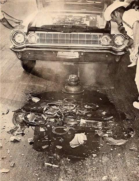

mad machs

Coulda been worse...
Mike that is called Mike.

Time I've pulled it out Mike it wil look like that ;)

Posts: 22137
Looks like an old picture of a dead drop to me.

That's a real oildown :shock: Not the 2 drips that Santa Pod take 1/2 hour to mop up :lol:

Posts: 14457
Pete wrote:Looks like an old picture of a dead drop to me.
Ron Mancini way back in '64, last of the legal neutral drops, NHRA banned such craziness after that little episode and quite right too.

Dead drop?
