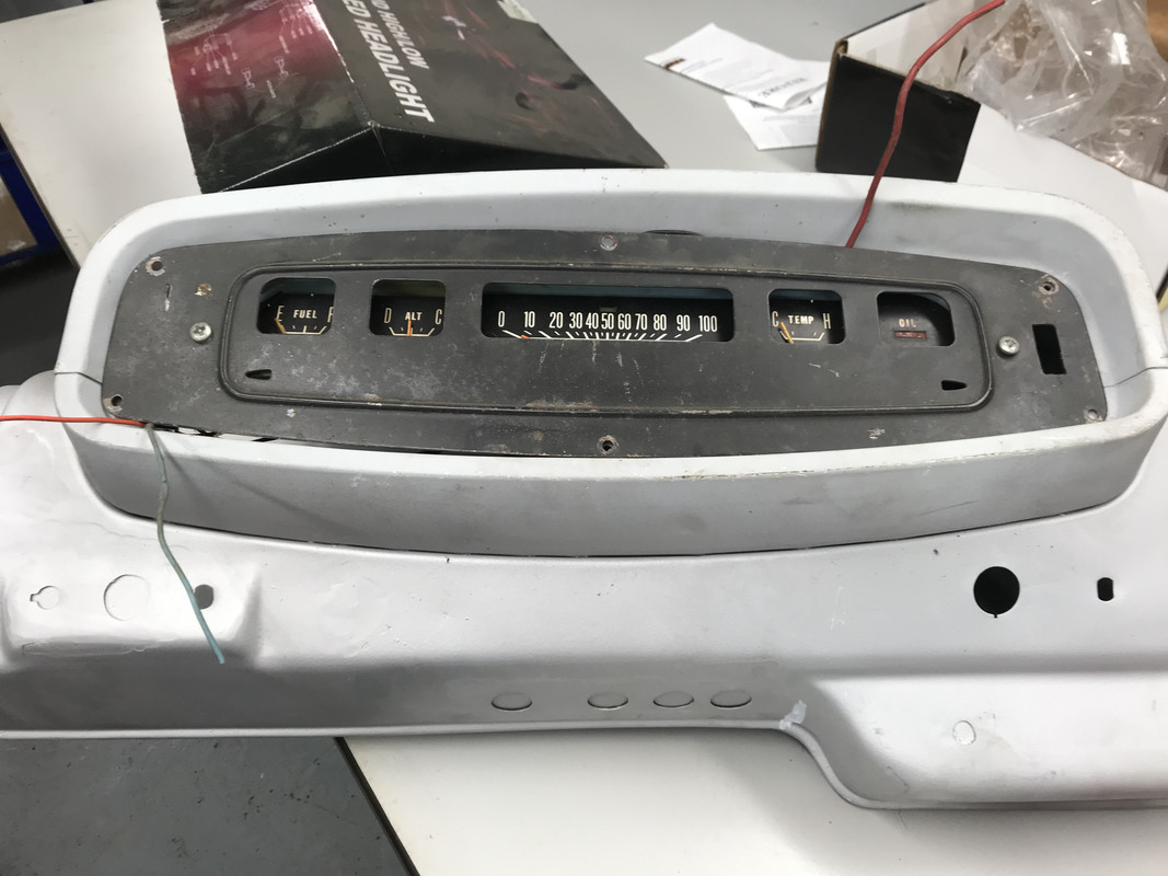

Dash Out with the old in with the new.

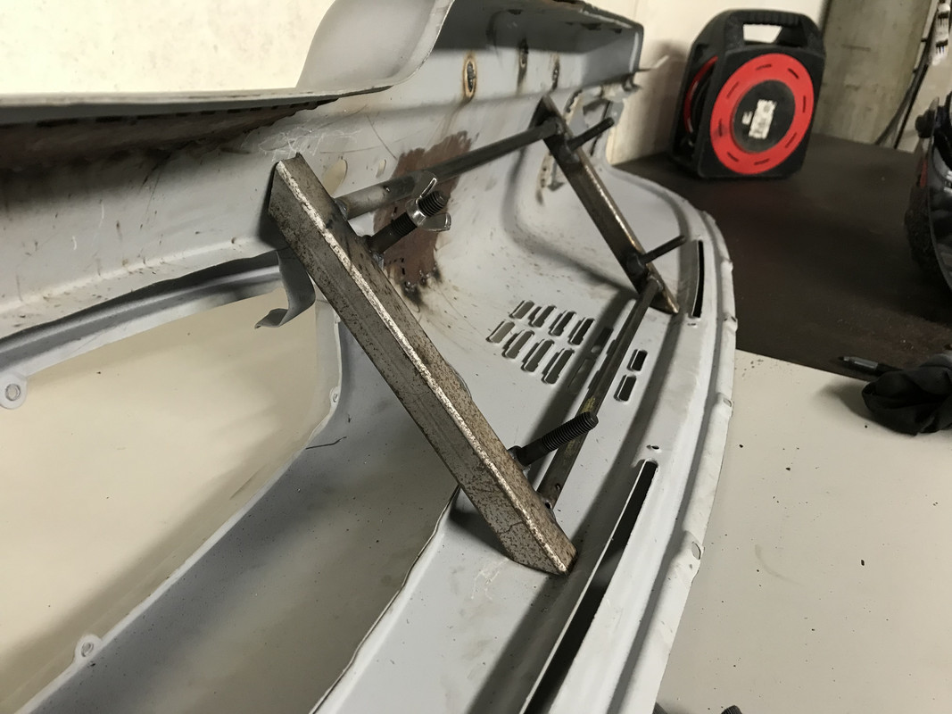

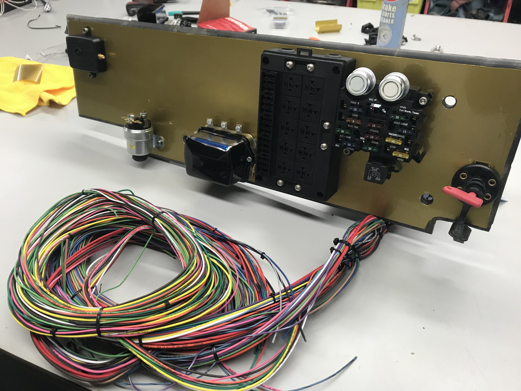

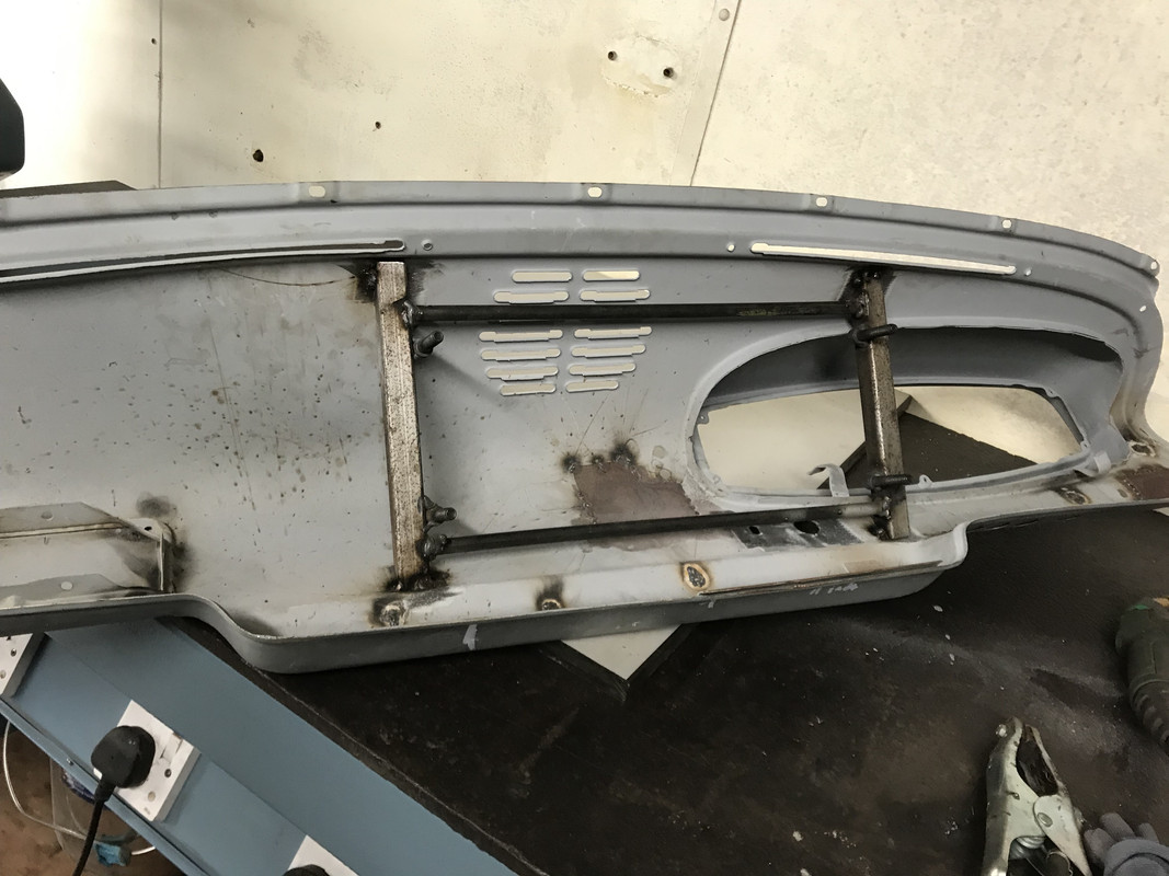

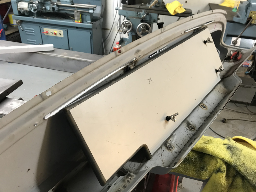

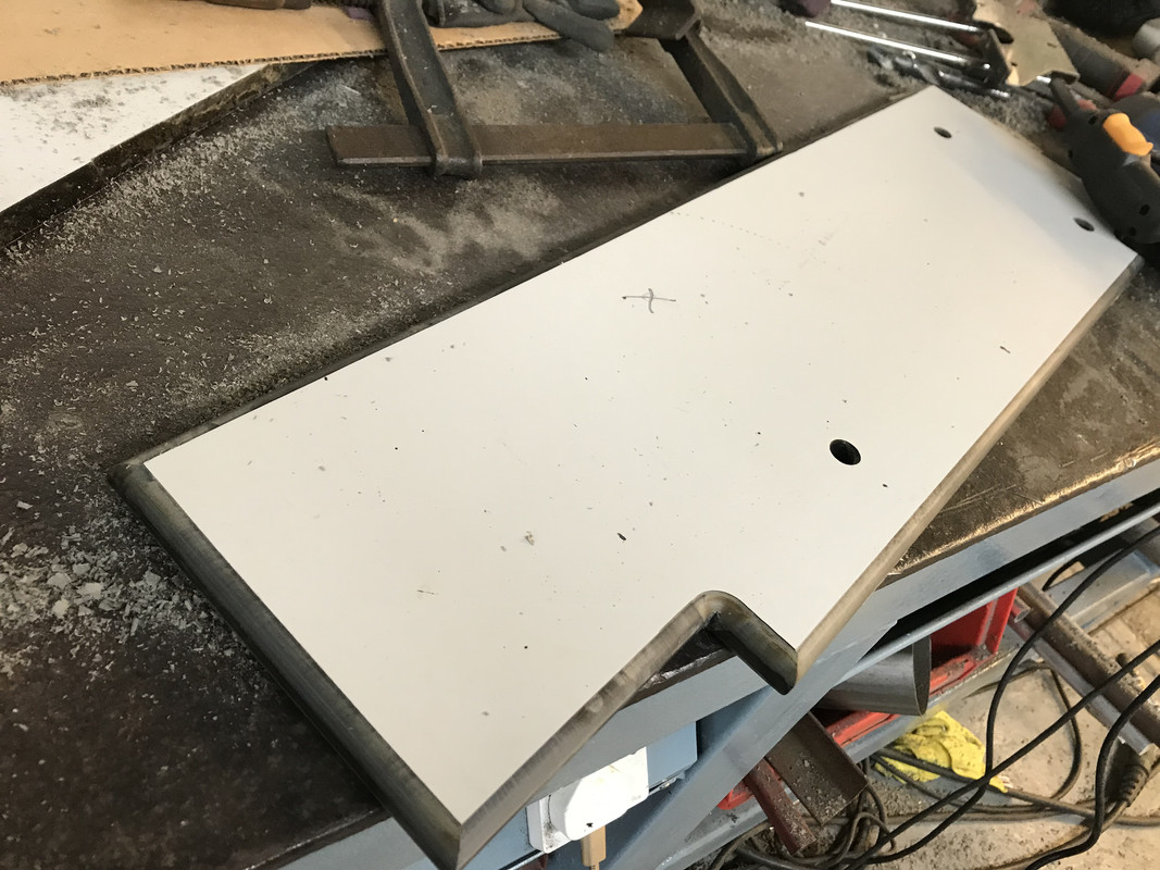

Welded a cage to underside of dash this will hold a sheet of 20mm plastic (old lab bench top cut up)
To this sheet all electronic will be mounted
The biggest pain with the charger is working on all the electrics under the dash.
The plan with the truck is the panel will be design to come out with a long loom allowing it to be placed on the seats and worked on for upgrades.

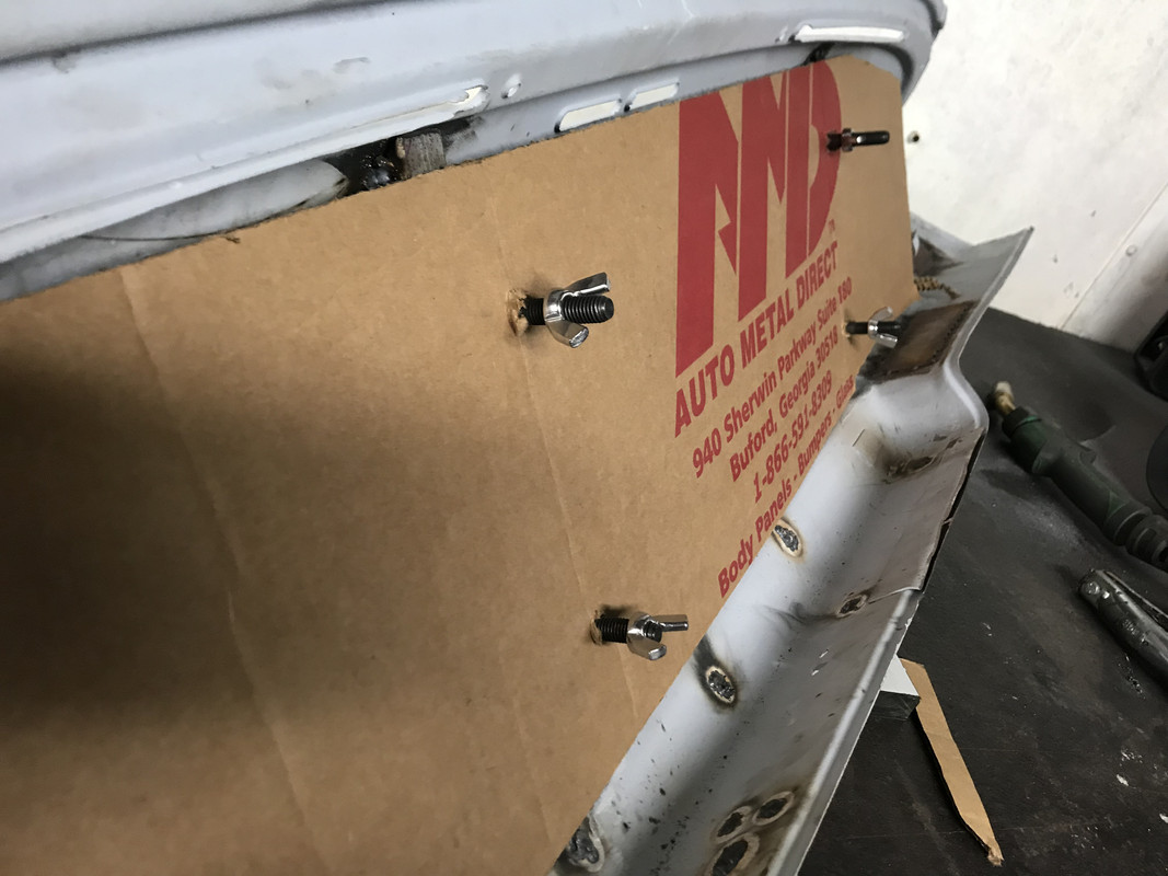

Re: Will´s 1968 Dodge Truck
I'd probably use something other than cardboard for mounting electrics :D
Sorry Will ;)
Mossy68 wrote: Fri Nov 16, 18 10:21 pm I'd probably use something other than cardboard for mounting electrics :D
Sorry Will ;)

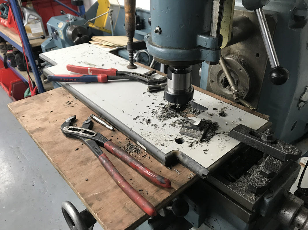

Good idea !

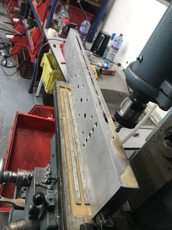

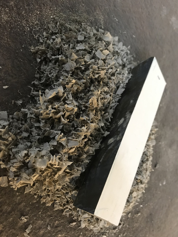

I cut up some very hard plastic (lab bench worktop)
Forgot how much of a mess a router makes and what a Versatile tool it is.

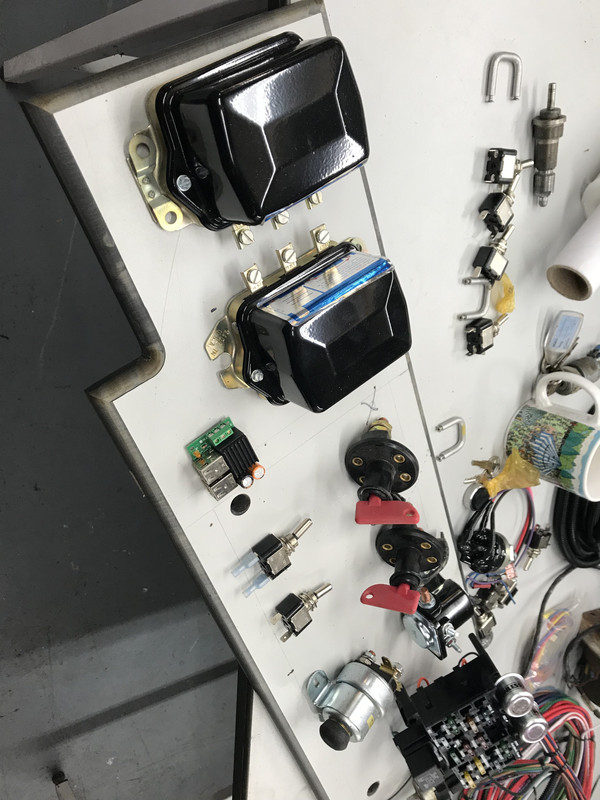

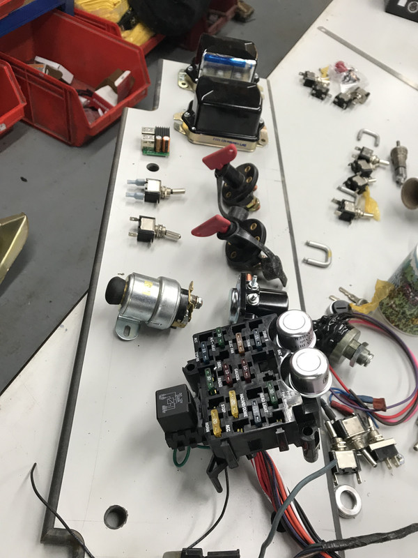

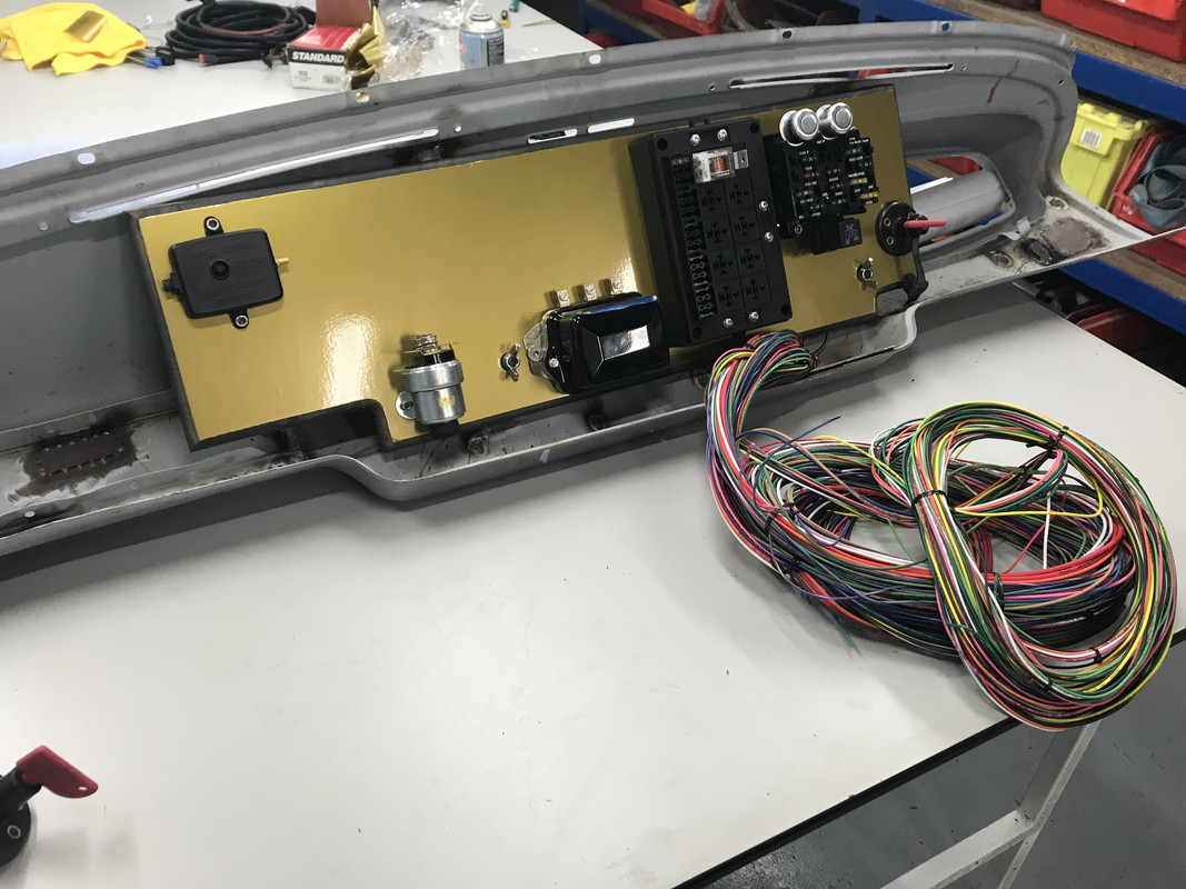

Drilled some square holes :reindeer:
Rubbed my golden goose on it and tested fitted everything

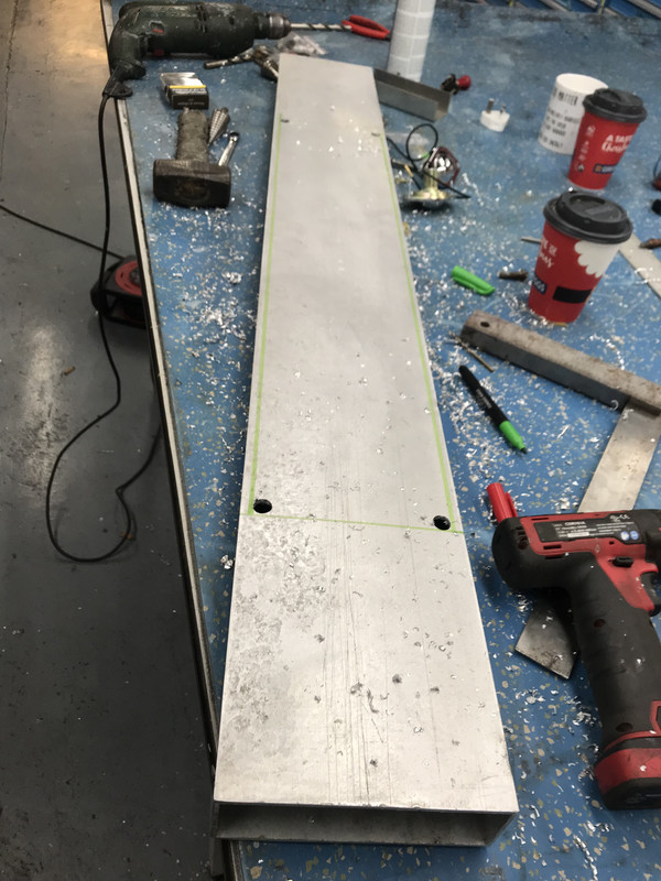

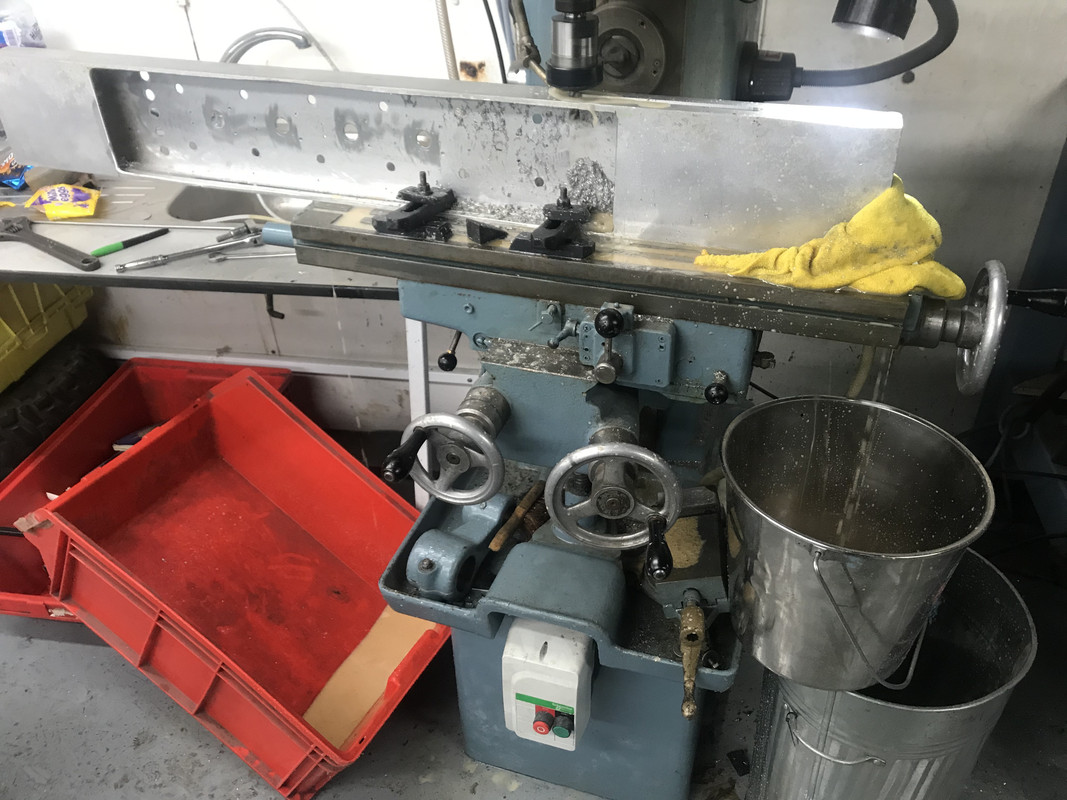

A main aluminium beam from an old conservatory pulled from a skip !
