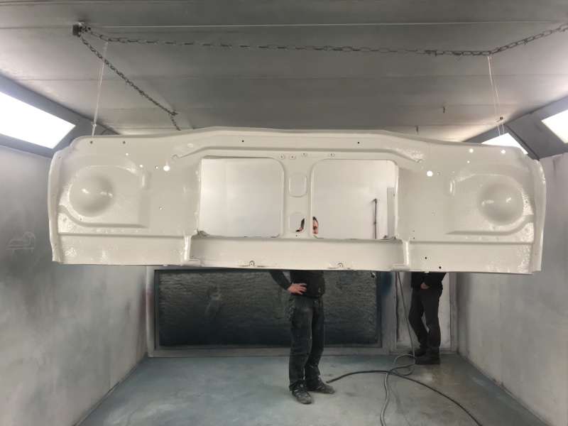

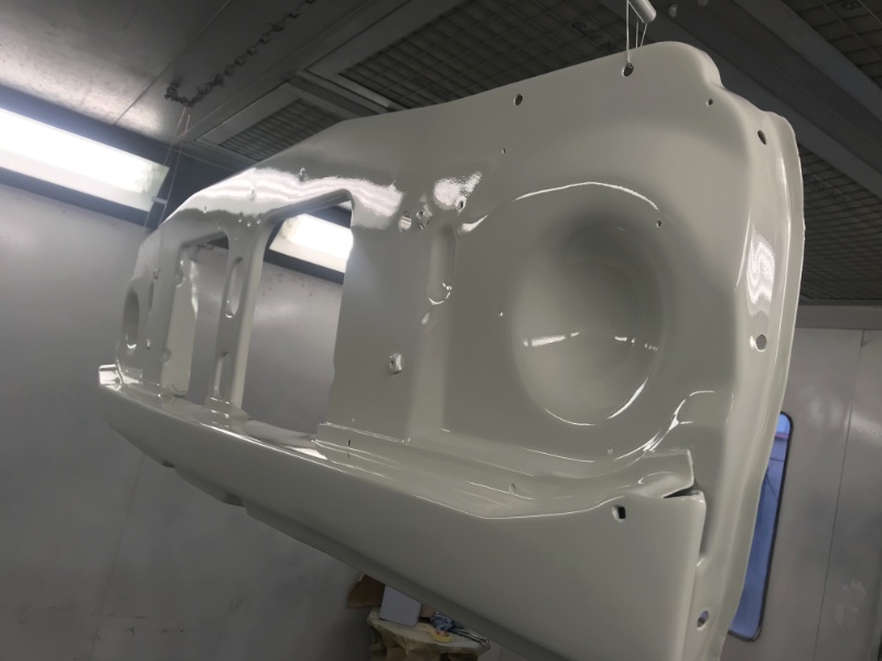

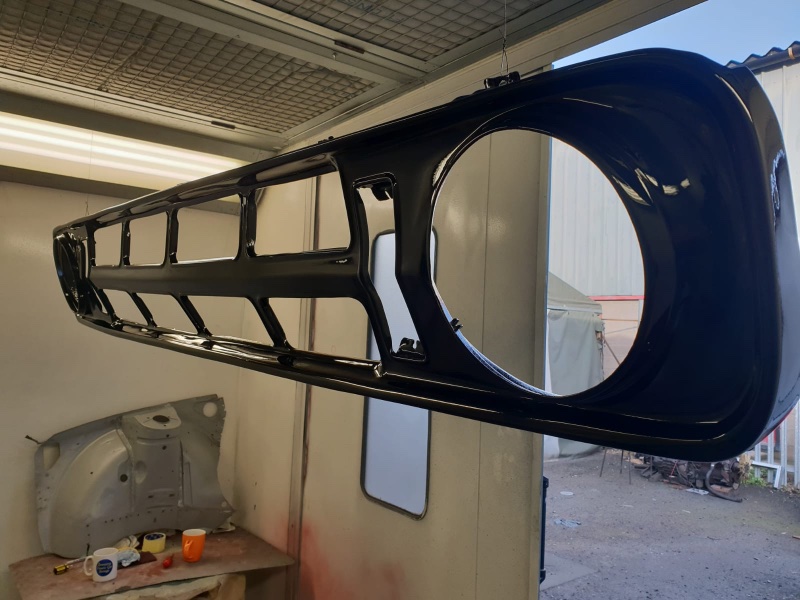

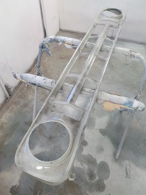

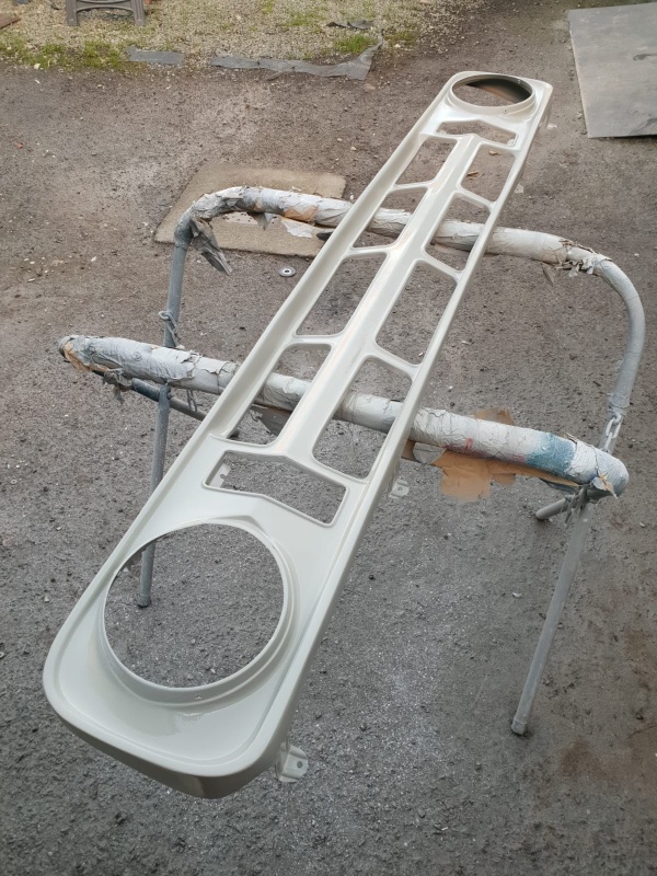

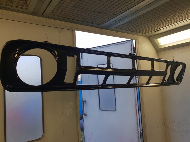

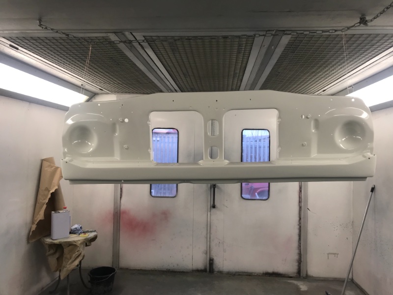

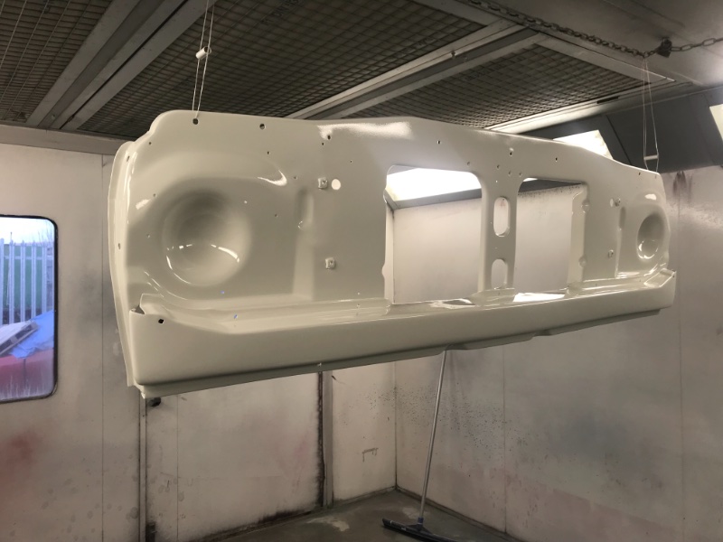

Next Up everything nut Bolt pannel washer part was sent for Sandblasting
Straight after Blasting, everything was cleaned over and over again to remove all sand and then sprayed with 2k etching primer
I use U-POL S20:20 2K HS Primer :stummin:

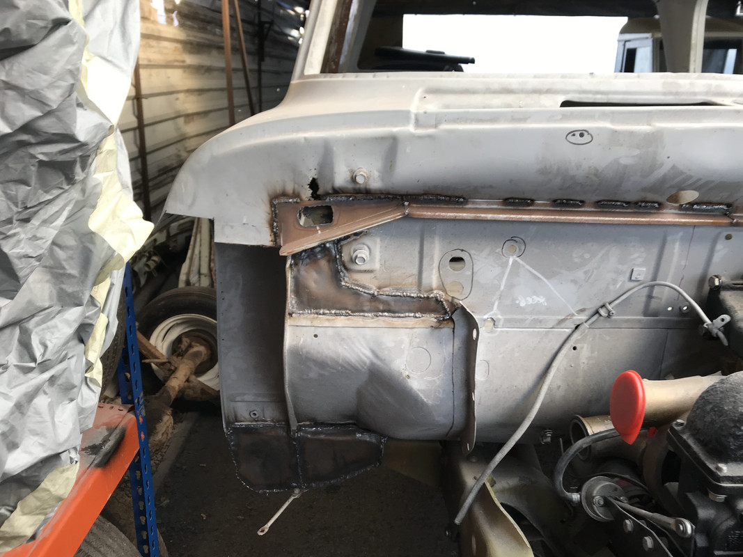

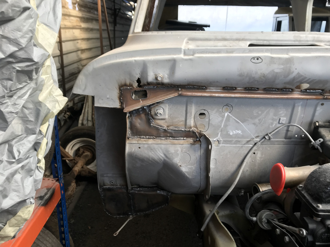

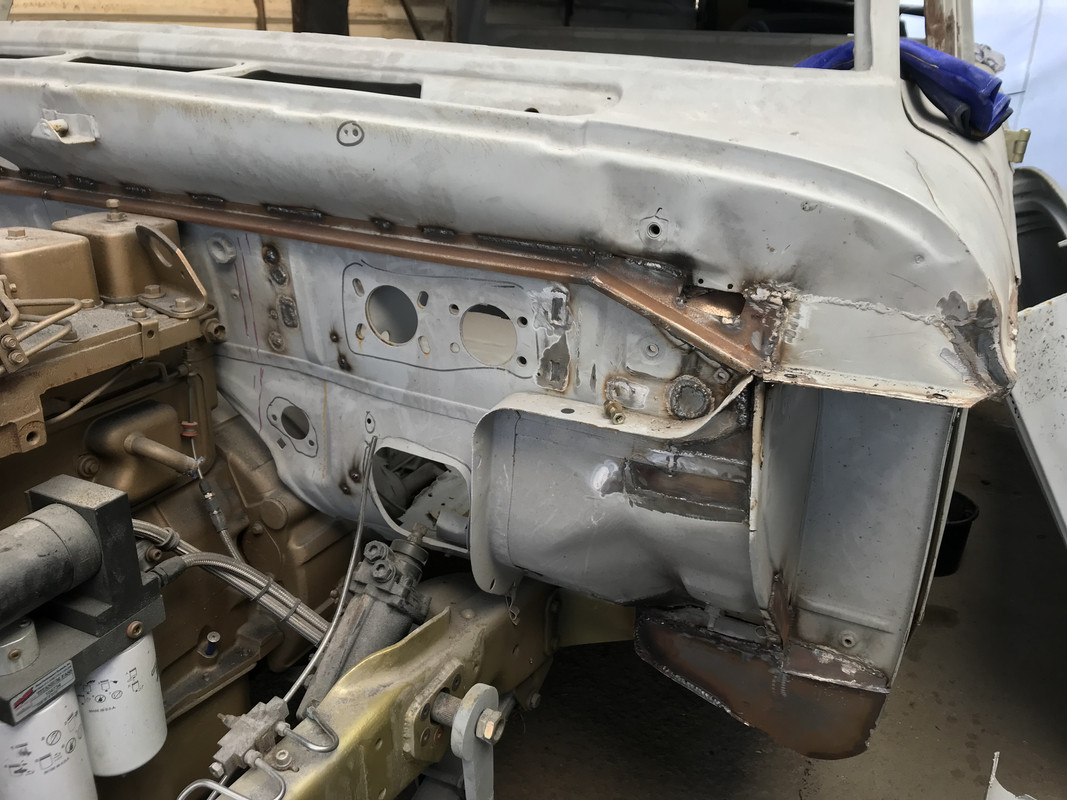

..... and then out with the tin snips, angle Grinder, and Welder!!!

Re: Will´s 1968 Dodge Truck

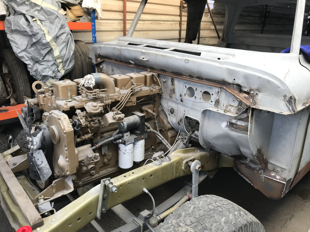

I ummed and ahhed for weeks 440 Blown, Merlin, Small block....
In the end, went with a turbocharged Cummins 6BT out of a DAF Lorry :lol

Fair play to you, you never mess about, great project. I also think the Cummins is a great choice, big old Diesel with bags of Torque, what’s not to love
The engine got a mini-rebuild ( was running low mileage)
Mounts where placed and the cross member got butchered
Painted engine and put chassis back together with rubber seals joints gaskets etc
Also fitted a toe bar which I don't think will break :)

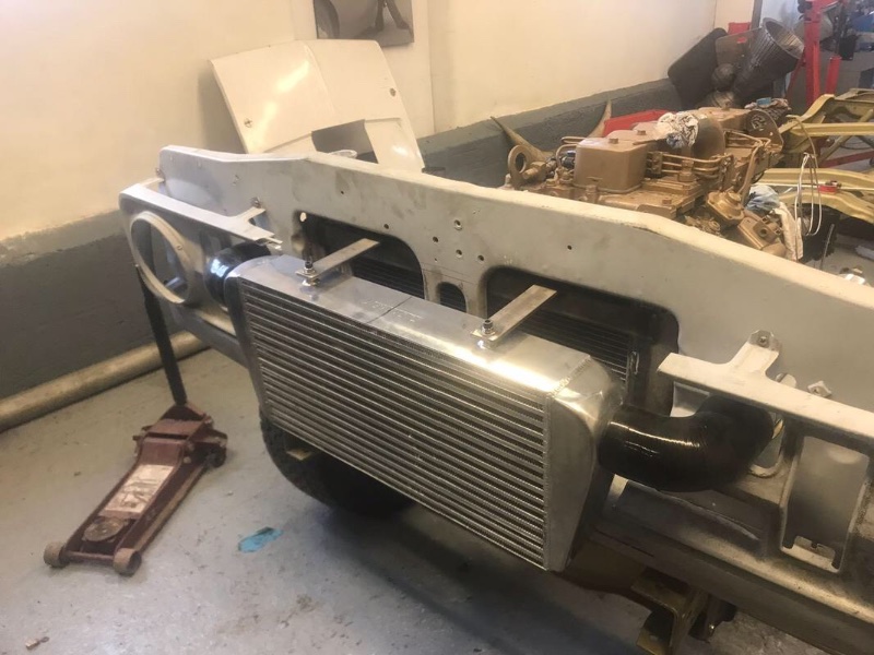

The Gearbox in the DAF lorry uses the gearbox as its rear engine mount.
I drilled the rear engine bell housing bit and made some mounts to cross member.
Next so the gearbox would fit under the transmission tunnel i took a grinder to the aluminium box and cut it up a bit
