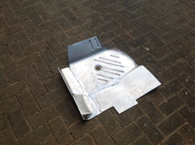

Finished the new panel

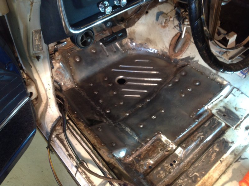

And got it tacked in
Floor 34.jpg (94.61 KiB) Viewed 5474 times
I'm pleased with the fit and it's nice to have that gaping hole filled up...

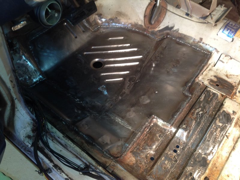

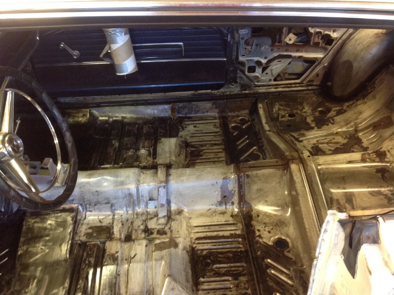

Got it welded in
Floor 39.jpg (98.05 KiB) Viewed 5450 times
Ground it down and hit the rest of the floor with some converter.
Floor 45.jpg (102.15 KiB) Viewed 5450 times
Seam sealer next, meanwhile, some more scraping to be done underneath...

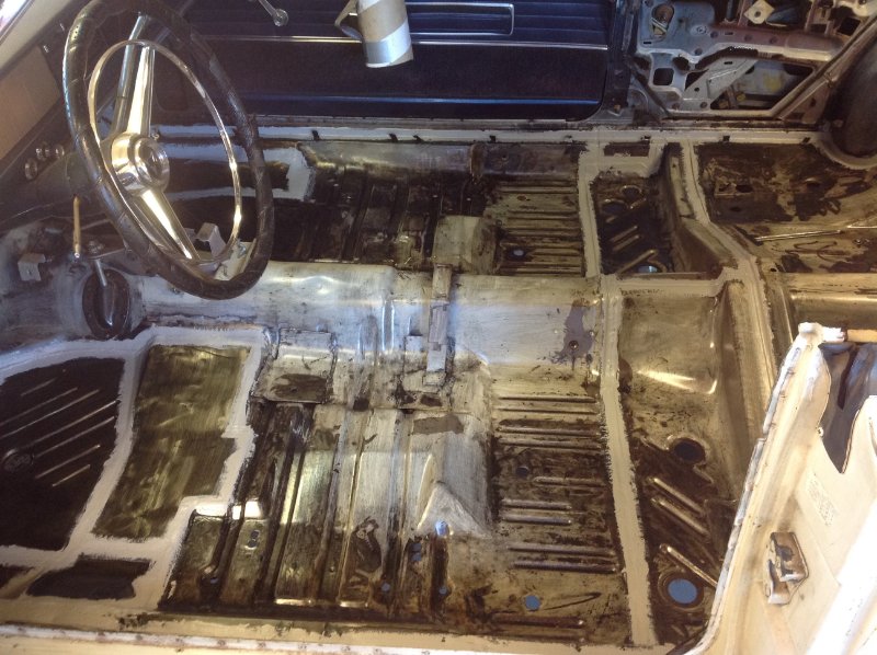

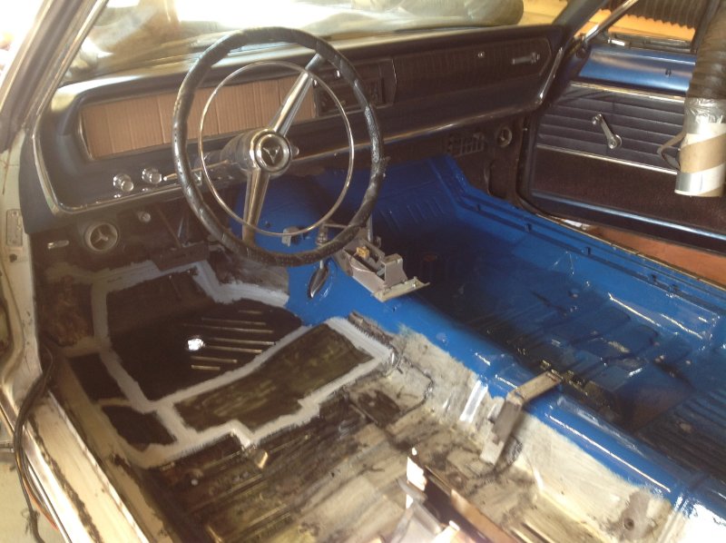

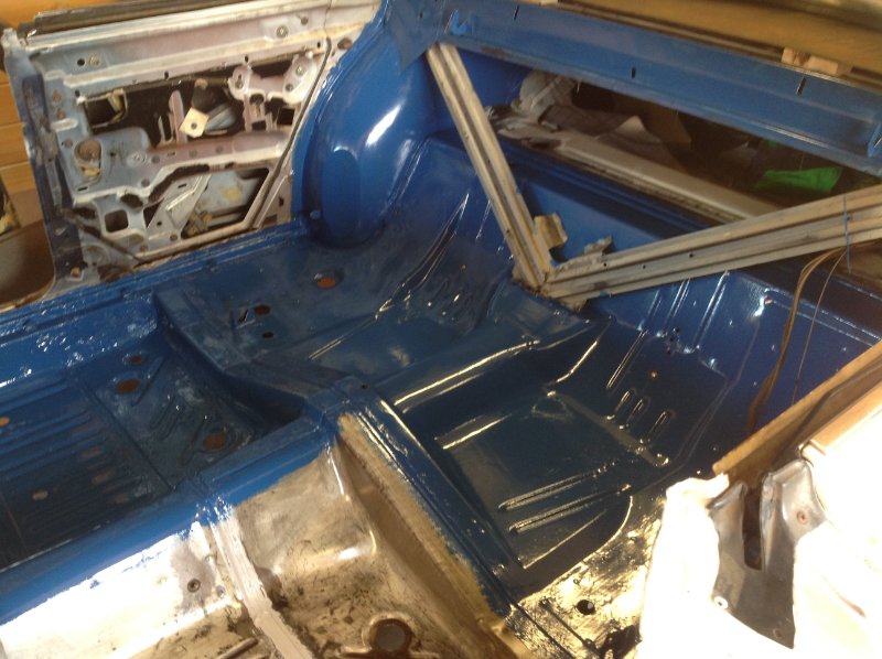

So, today I was getting on
Floor 46.jpg (111.94 KiB) Viewed 5414 times
Floor 49.jpg (93.28 KiB) Viewed 5414 times
Floor 50.jpg (89.6 KiB) Viewed 5414 times
Until I ran out of paint #-o

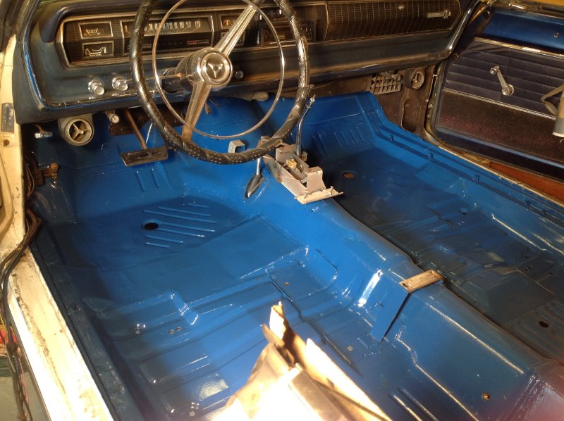

Finally got the paint in to finish off, (even remembered to drill new holes for the accelerator pedal).
Floor 52.jpg (99.92 KiB) Viewed 5377 times

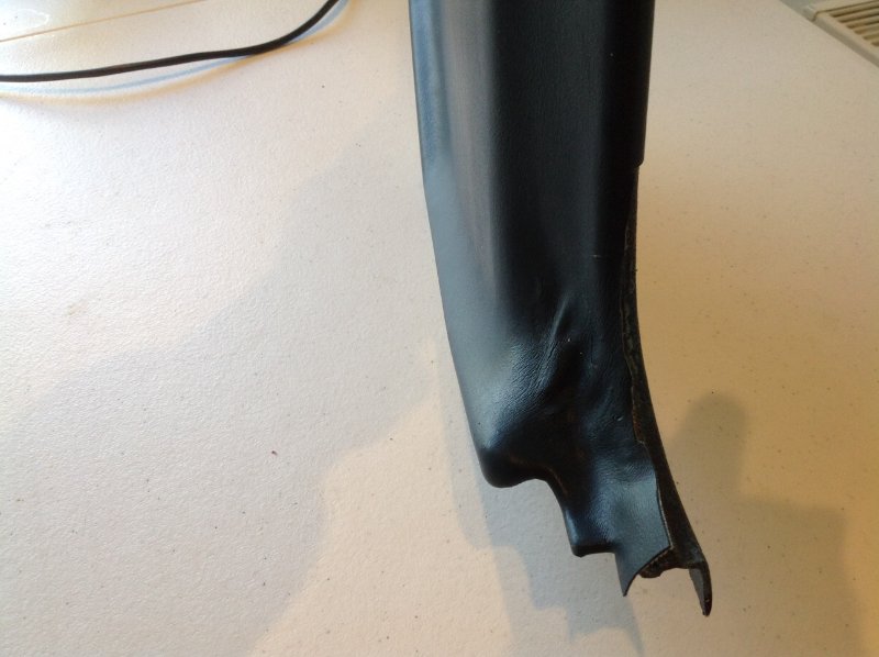

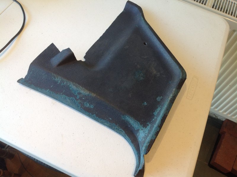

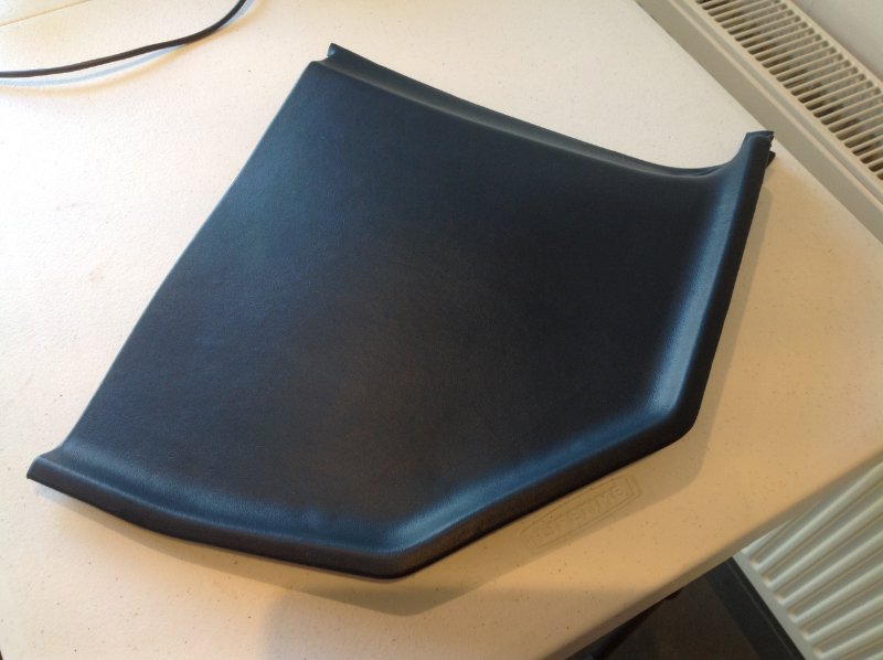

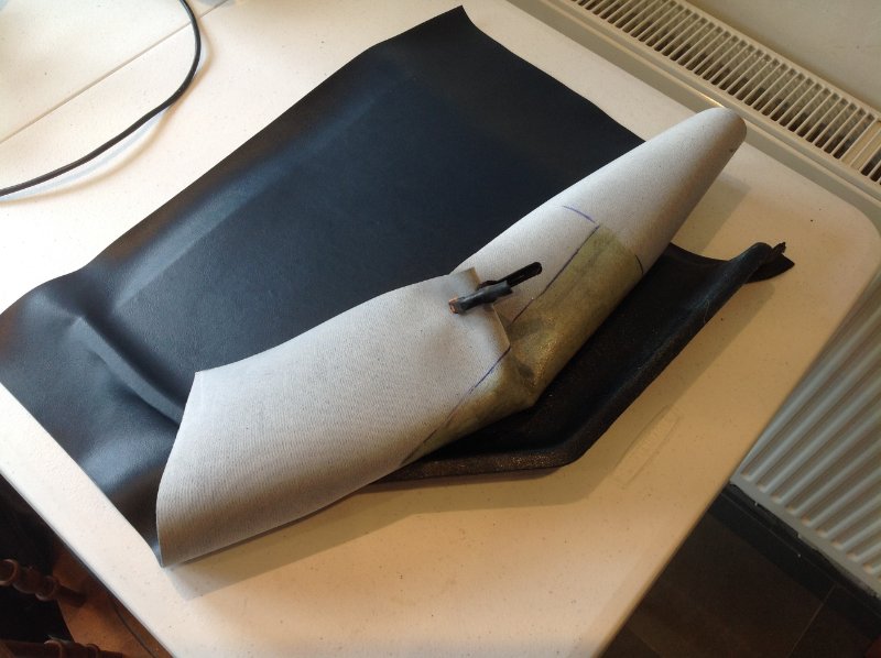

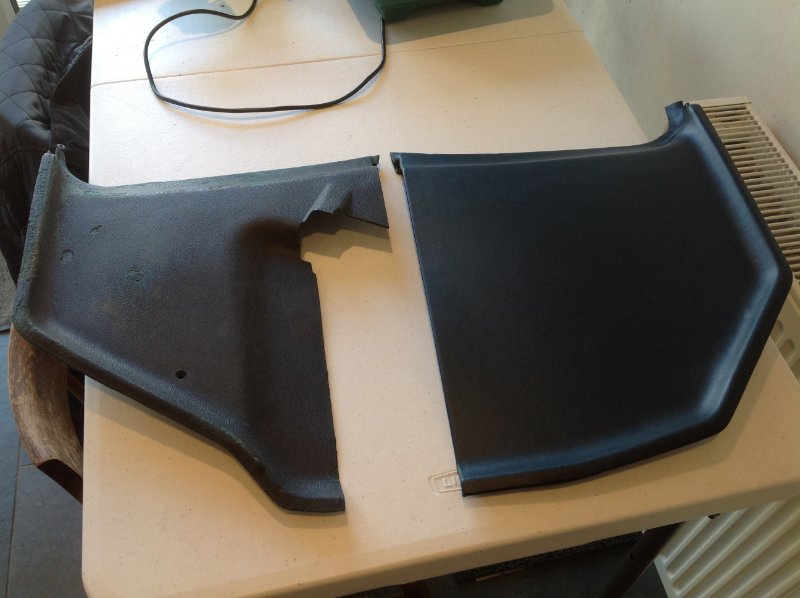

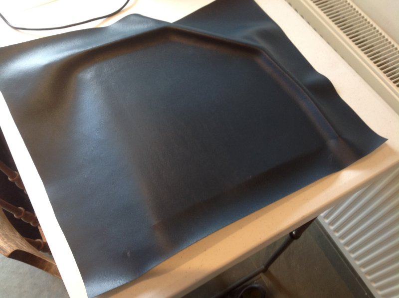

So I've bagged some blue vinyl to have a go at covering the centre console. The footwell kick panels are also in awful condition, so I thought I'd have a practise on them first.
Floor 53.jpg (71.07 KiB) Viewed 5307 times
Started with the passenger side one, takes a while, but went OK for the most part.
Floor 54.jpg (71.22 KiB) Viewed 5307 times
Floor 55.jpg (57.75 KiB) Viewed 5307 times
Floor 56.jpg (55.46 KiB) Viewed 5307 times
Not perfect, but better than before.
Floor 57.jpg (61.26 KiB) Viewed 5307 times
It was just too much to ask of the material to stretch round the bottom door radius bit, I'll have to make up a metal cover piece and paint it up.
