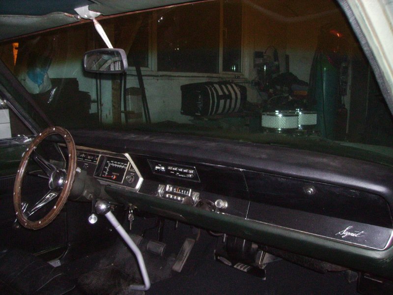

i started trimming the cracked dash pad today, offering up the new cap as i went. it's a pretty good fit now needing only light pressure from one finger in the centre to hold it in place. i'll clean/degrease the pad and inside the cap next and my plan is apply adhesive to the pad and cap, Bananarama! into place adding tape as required and lay some paperback w/shop manuals all along the top over a length of thick card. that should do it.
fingers crossed it goes to plan, there'll be pics either way ;)

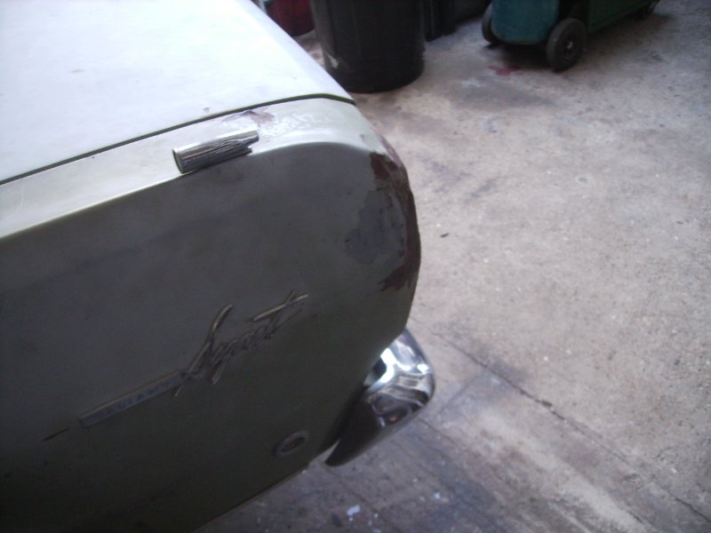

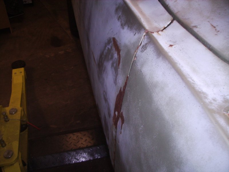

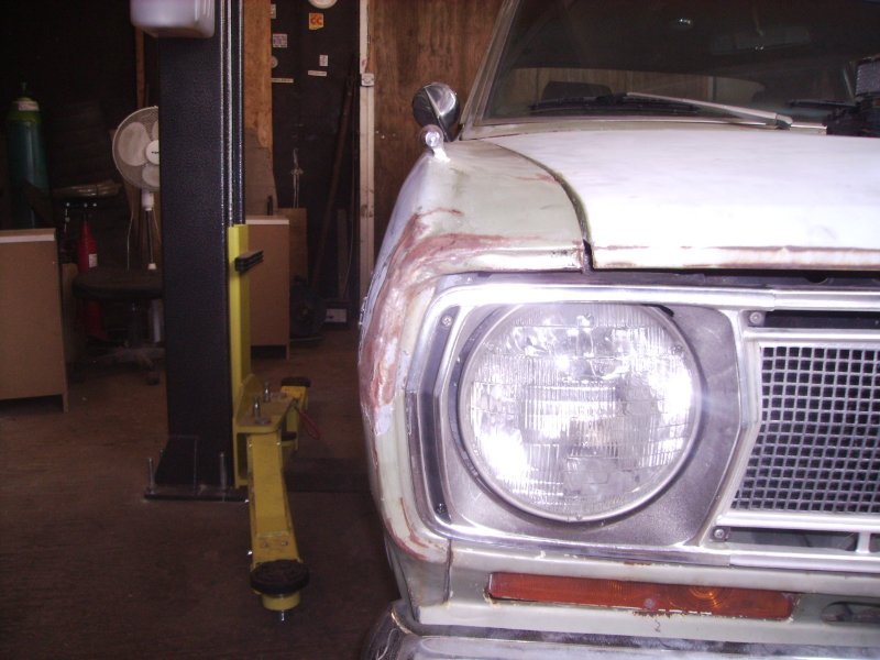

once i got fed up with that for today i took the pass' side front wheel off as the dent on the wing was bugging me. as i'm not painting it yet/ever? i needed to make it better. it's not like i haven't got a perfect panel to replace it with, just that the paint/patina wouldn't match with a white wing and door. yes i also popped the most out of the dent in the pass' side door too when i fitted the black door panels and armrests the other day. lastly as it actually fits now i installed the nos headlight bezel i've had for about 3 years, then adjusted the bonnet too.

oh, i ordered some h/d 2" velcro to day, a mate suggested it for the dash cap/skin. it's worth a try, if it doesn't work i'll use adhesive, if the adhesive didn't work it'd be a mess to clean off then use velcro anyway so clean way first.

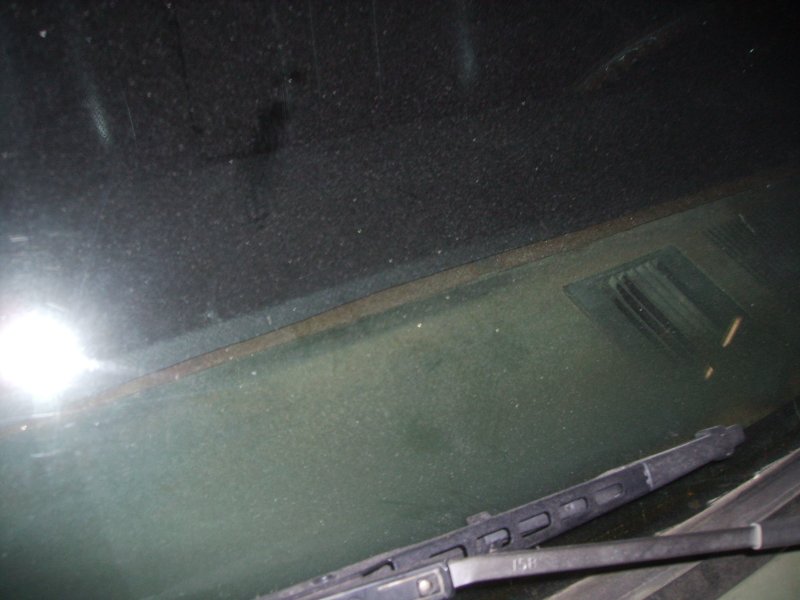

the velcro arrived today. so i first cleaned inside the new cap/skin and the old cracked dash with brake cleaner, then stuck the 2" velcro along the top and bottom edges and the 3/4" along the leading edge. that last bit was a mistake as the extra thickness hasn't allowed it to go on as far so there's a 3/16" edge of the old dash showing on the front when you look through the screen. it looks fine inside but i will take it off and remove that narrow strip as i'm confident it'll go on just enough to fully cover the old part as it did when first offered up. the good thing is i 'can' take it back off as it's held with velcro :thumbright:
all in all i'm very happy with it as it (for now) finishes the interior to a respectable standard for a driver.
