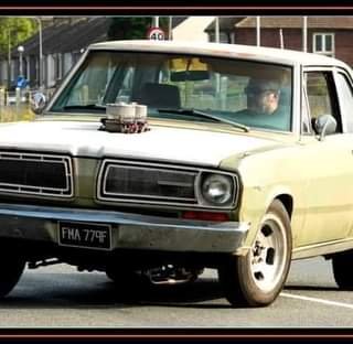

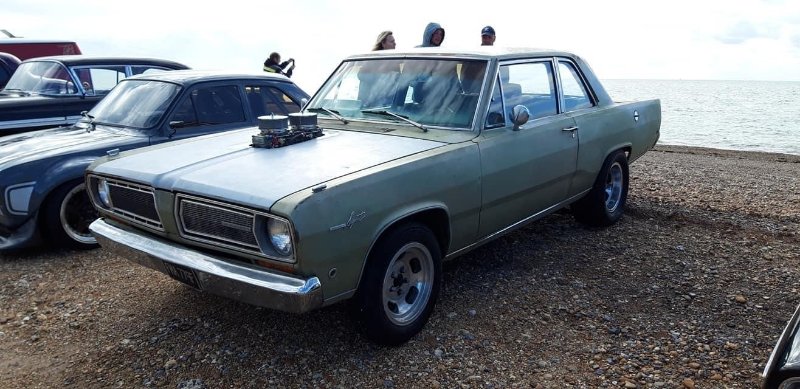

here's a couple of pics the meet photographer took last night
neil.

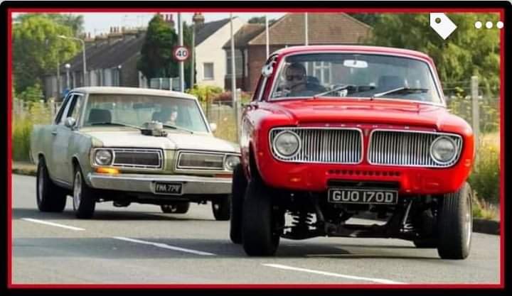

Posts: 3537
Re: 68 valiant signet 2 door
Spotted on Facebook 8-)
