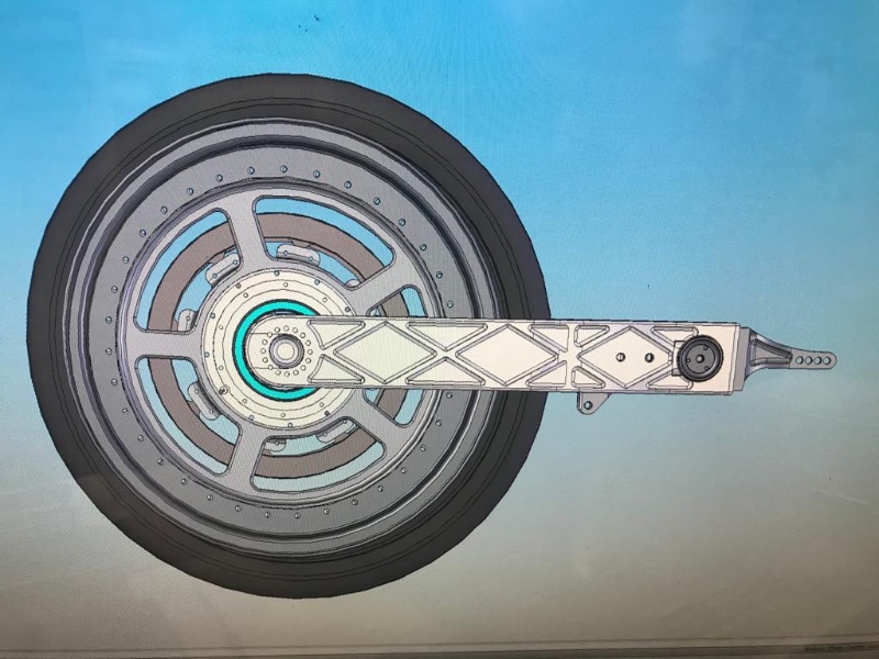

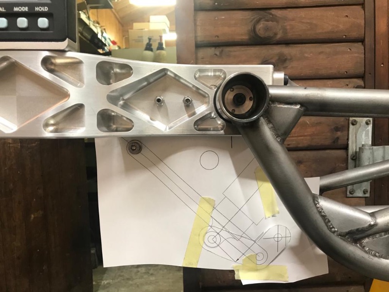

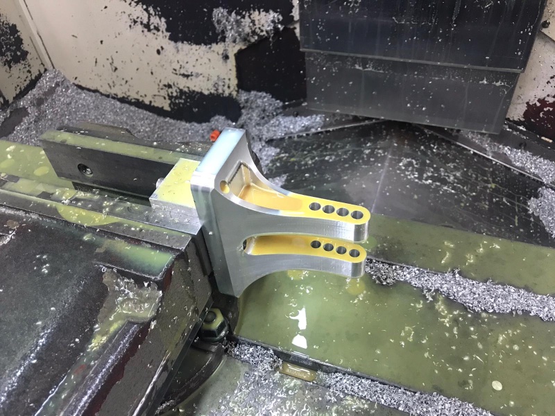

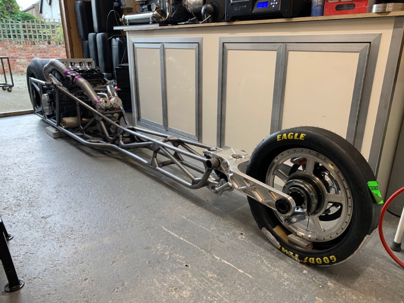

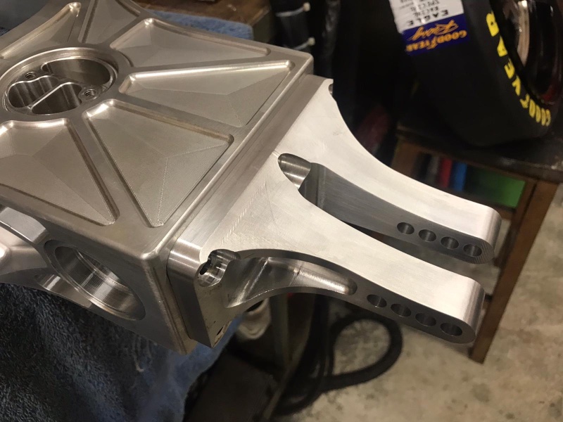

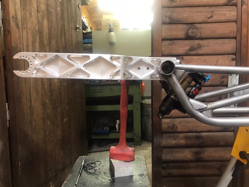

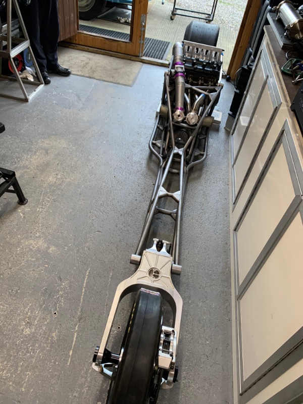

mygasser wrote: Thu Oct 29, 20 7:07 pm as above very nice work as always :thumbright: are the multiple mounting holes in the swingarm where the axle mounts to allow for some castor adjustment?
neil.
Correct !
:trophy: :trophy:

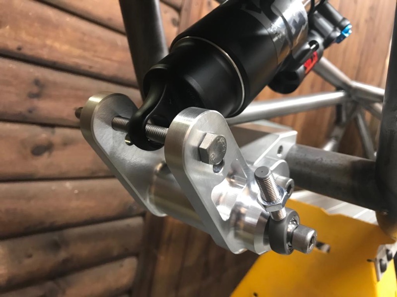

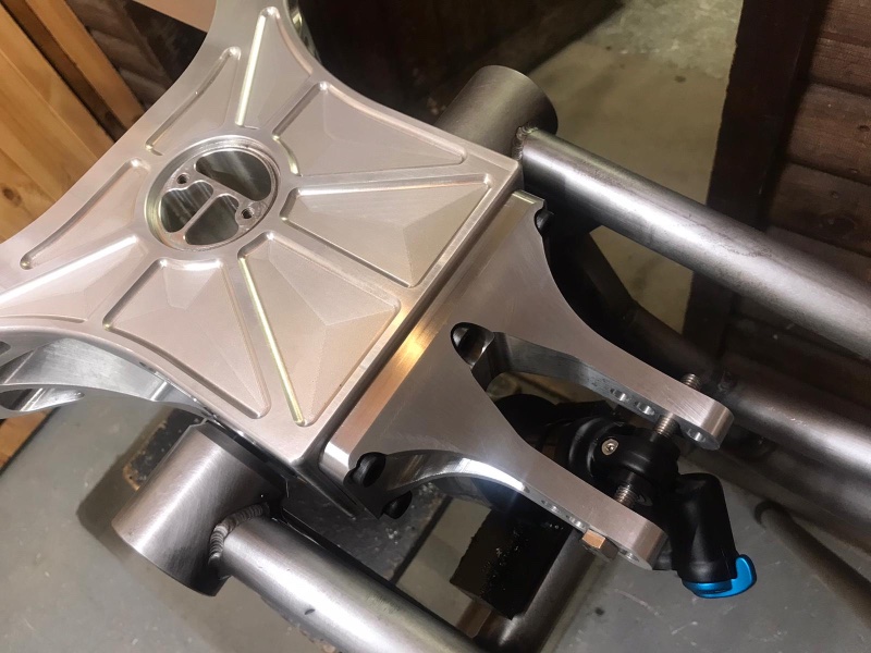

So next up front suspension and let’s think outside the box

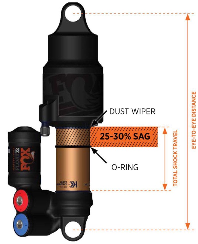

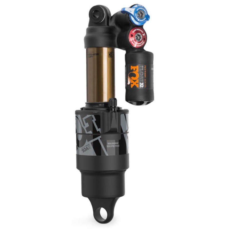

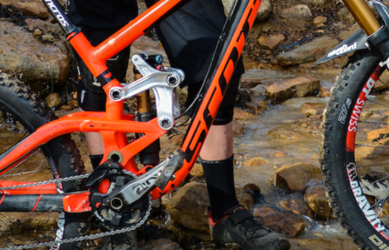

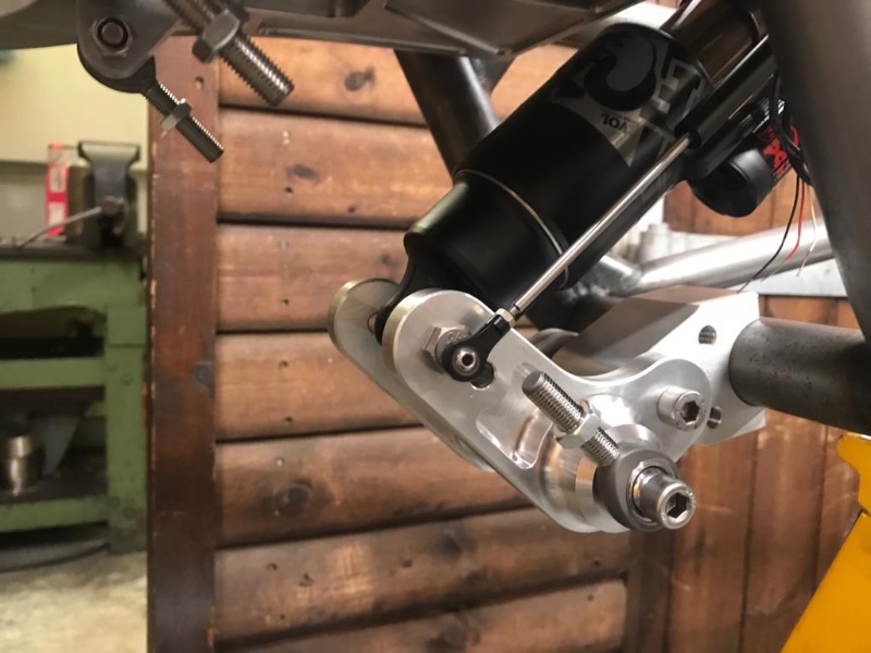

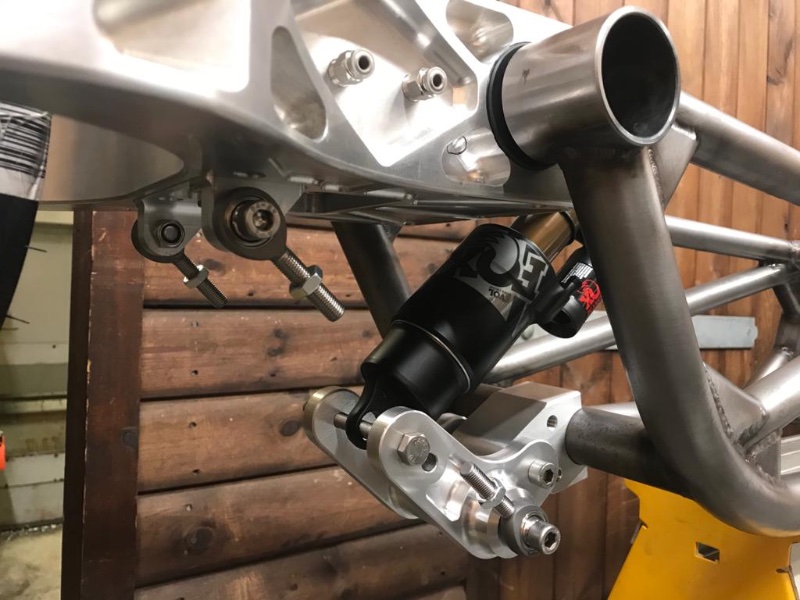

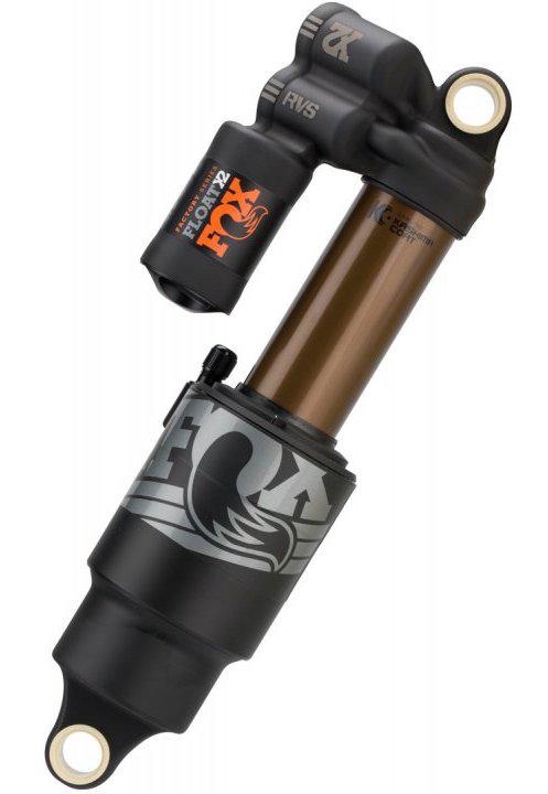

For the bike front suspension we will be using a rear air shock from a high down hill mountain bike
:reindeer:
Re: Fifty shades of Jade

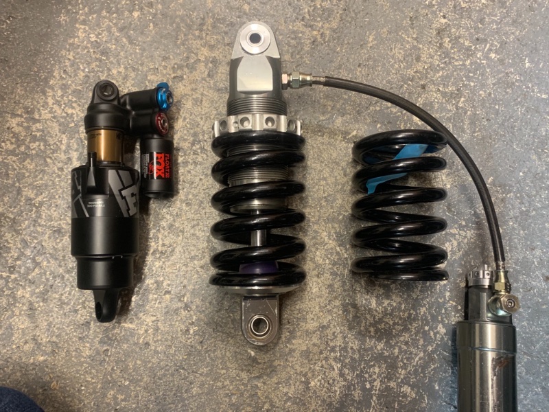

This unit weights in at 637g !!! compared to last season more traditional motorcycle shock absorber 4.7kg
:shock:

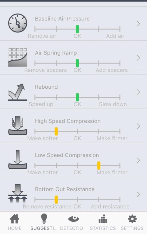

The unit is an air shock which you pump up to the desired pressure circa 250psi

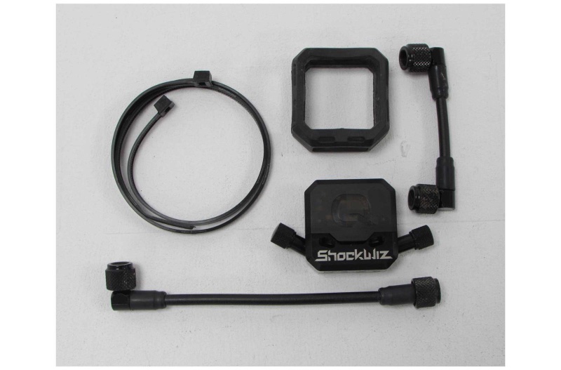

Thanks to the popularity’s of mountain biking the unit comes with a Bluetooth box and phone app.
Monitoring Motion and Internal pressure the app can helps you tune you suspension via the app
:read2:

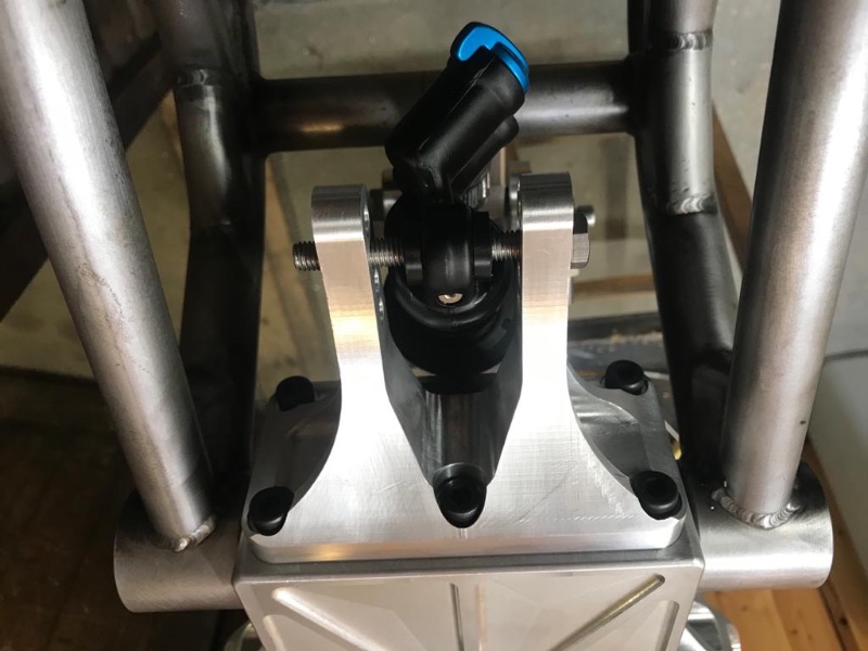

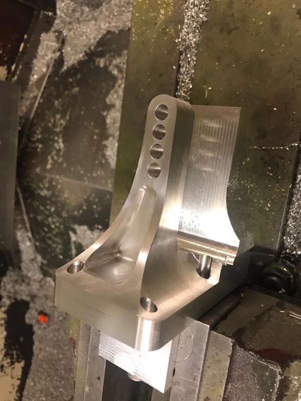

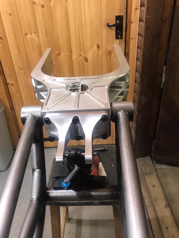

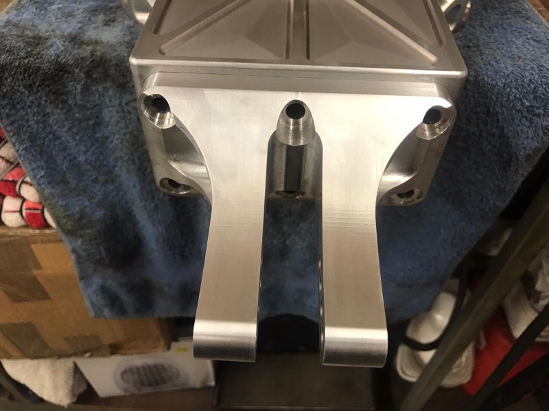

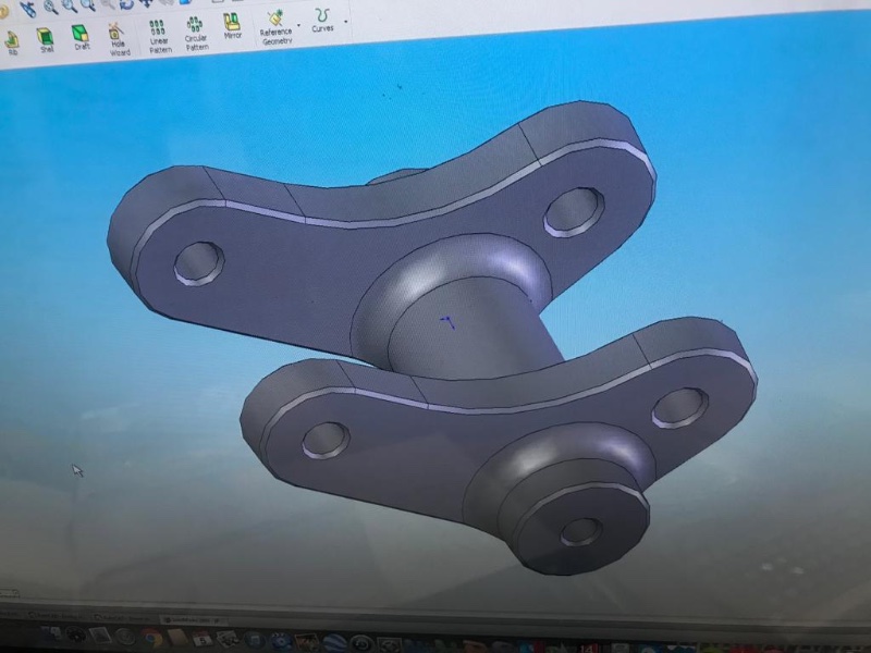

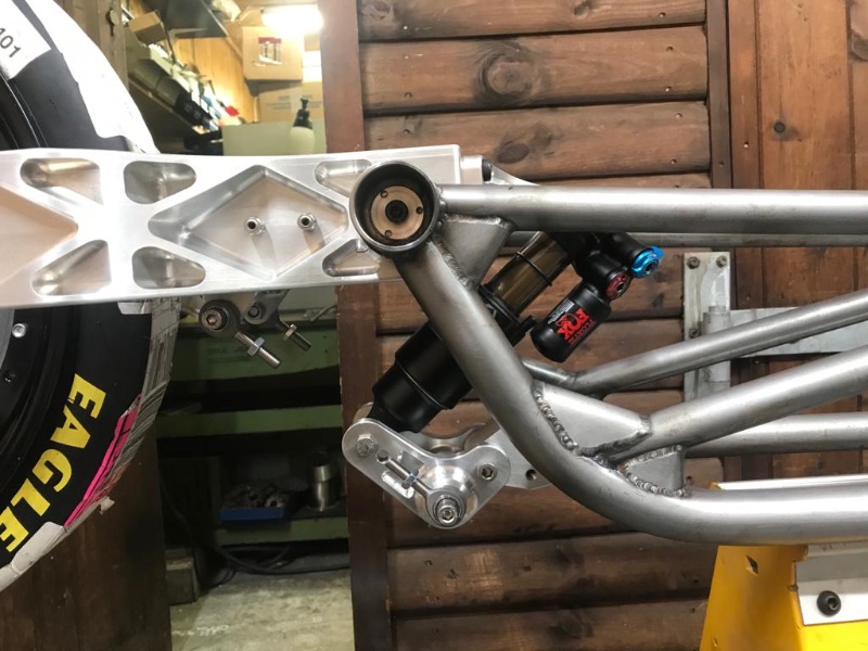

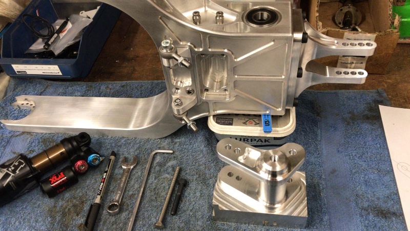

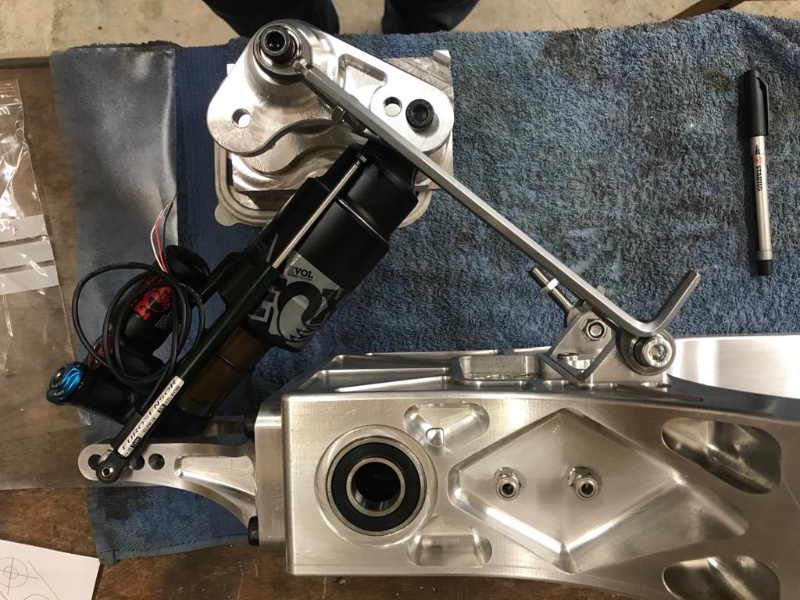

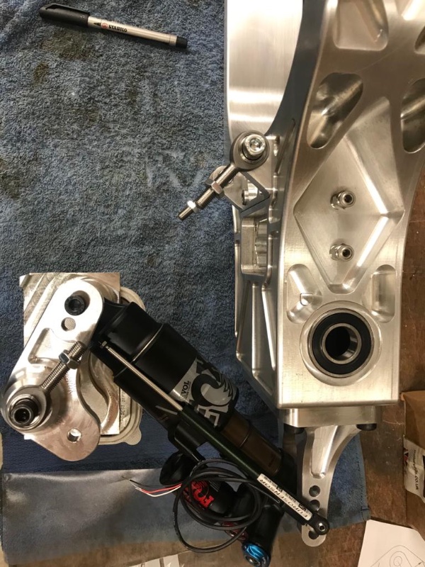

A bracket was created to bolt the shock to the front swing arm
Bluetooth phone app controlled fully dynamic air suspension :salute:
Let the games begin..
Post by mygasser »
could the suspension linkage on that pushbike be any more complicated? :-k

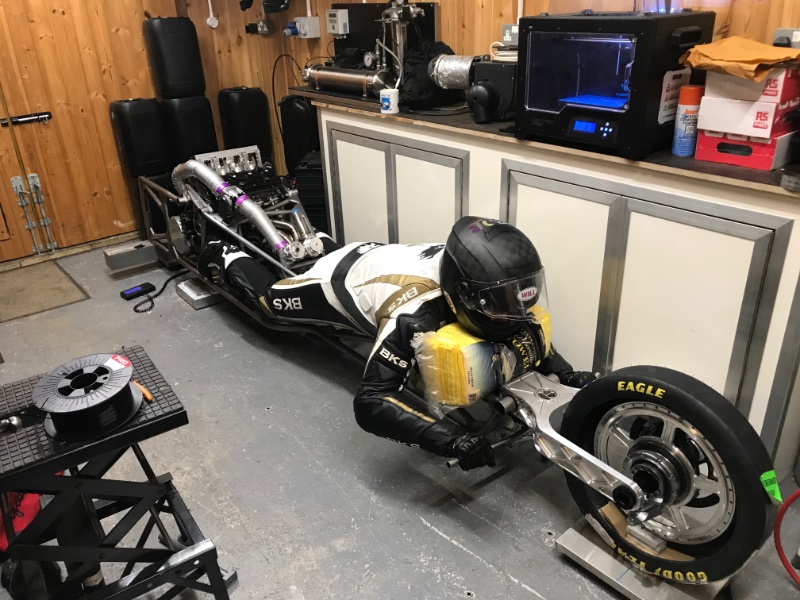

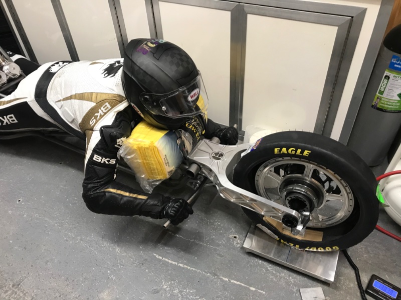

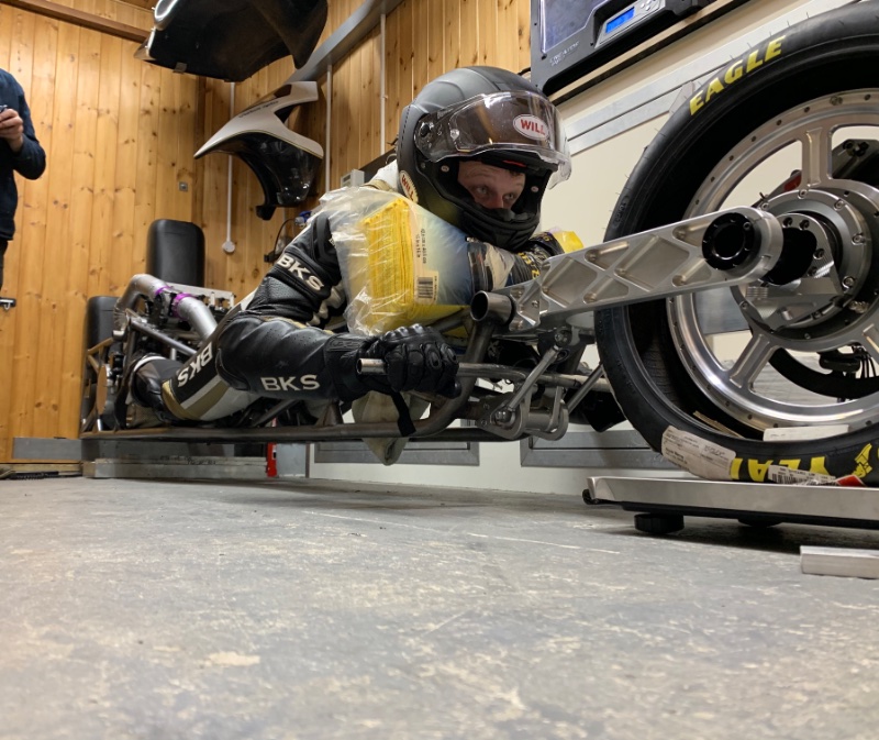

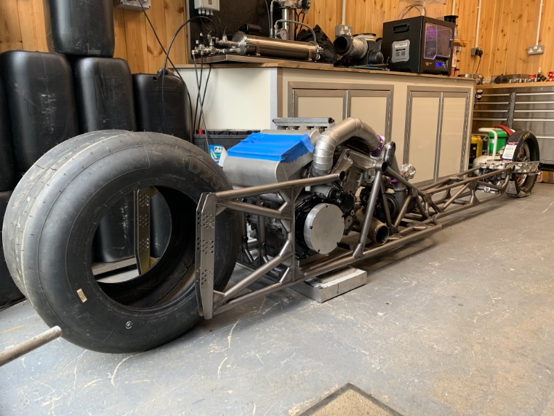

It fits !!!

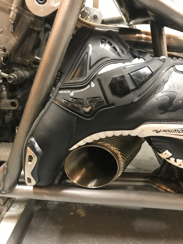

Beauty and madness at the same time!!!
The Ergonomics look a LOT better than the earlier models..... the model is just as ugly....
Posts: 1350

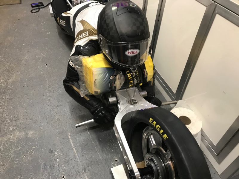

are you going to deploy the dusters as some kind of parachute?
Posts: 3539
Seeing the sticker on your helmet made me think, have you made a will yet ?
Just asking....
