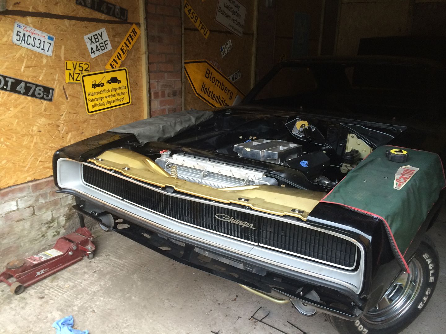

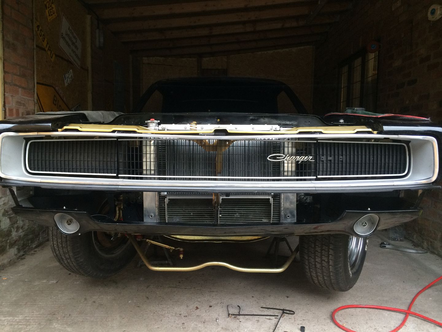

Pass never done this beforeMossy68 wrote:Very neat.
Will mounting them there starve the radiator of air though ?
Will´s 1968 Dodge Charger
- autofetish
- Posts: 5599
- autofetish
- Posts: 5599
Sorry if I've put doubt in your mind Willautofetish wrote:Have electric fan other side to pull air though both cooler and rad
Seems the way most people do it
Is this all wrong ??
May be a perfect set up ?
Only me thinking aloud and like I said I know nowt !
- autofetish
- Posts: 5599
It's all good fella better to find out now hence why I post my life here
Had a look
Most modem cars stack like this
There are issues with some heat soak form rad to rad but ideally all should be the same temp ( i think ) not sure on gear box
I reckon it's a Gooden but anyone else think different please say
Had a look
Very neat and it does seem to be how most production cars do it. Personally I've always tried to keep them separate, it just seems logical that the heat will dissipate better if one hot thing is far away from another hot thing. Possibly the difference is so slight it doesn't matter?

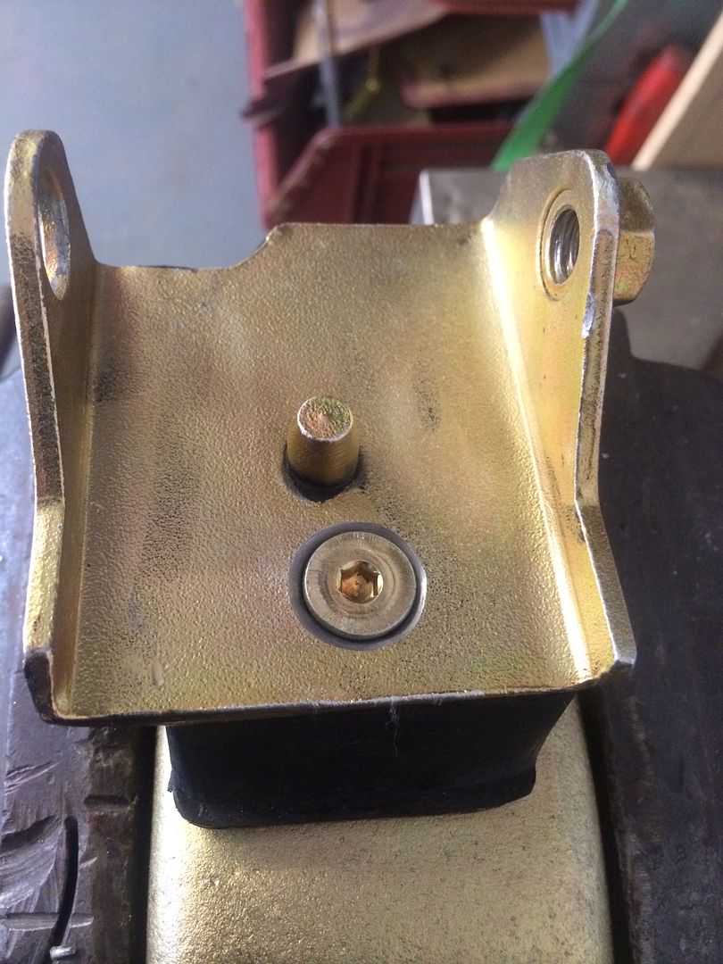

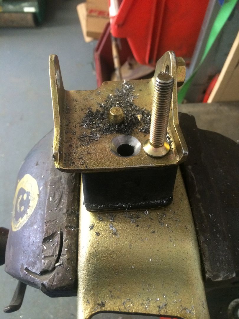

Next was worried about the NSF engine mount as there are know to rip out due to engine torque so I drilled hole fitted counter sink head bolt.
Now if you tighten it up it squashes the mount so welded the nut so she is not coming off soon.

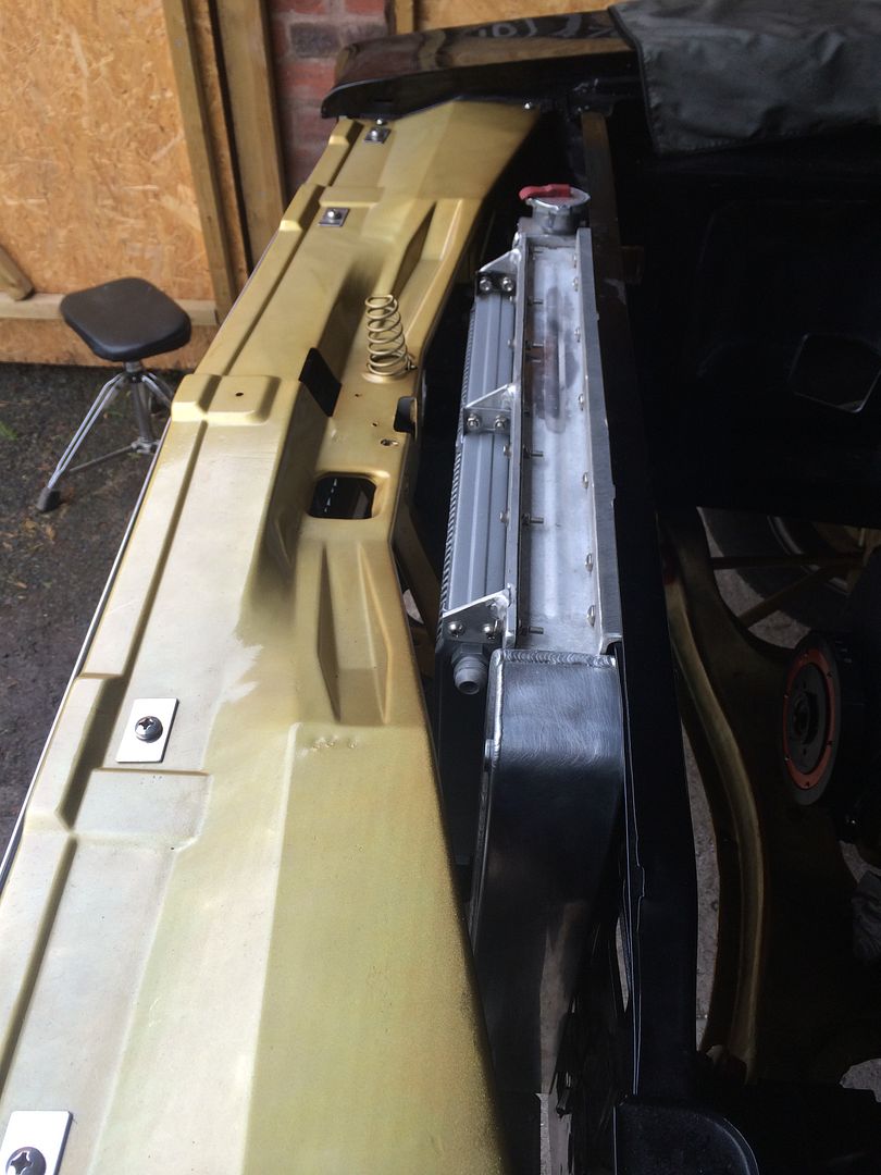

Finally managed to shoehorn 1 rad and 2 oil down the front of a charger
Had to cut grill support and fix to rad

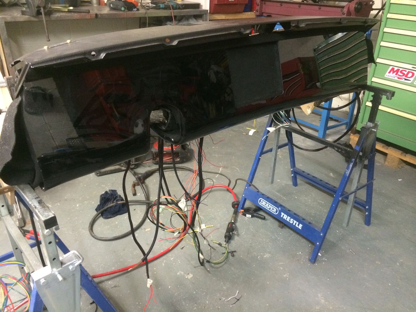

This Stupid bit of plastic had been driving me mental
My first plan was to Velcro this on but it won't last so I glued a Alu strip to it and this now bolts the plastic to welded nuts on inside of dash frame
