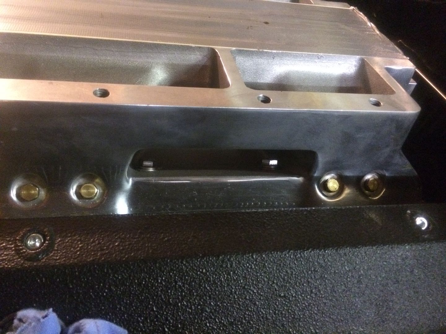

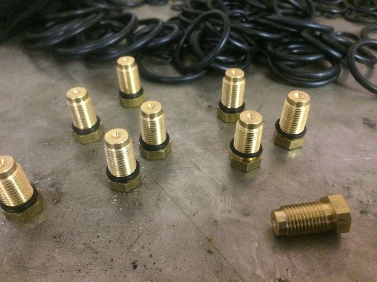

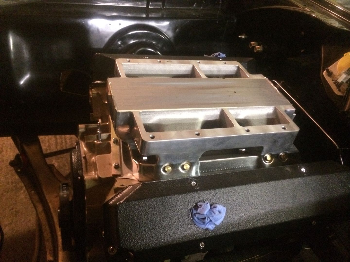

my indy blower mainfold had injector port as i have now final decided to go Carbs i need to block these off.
they are a 3/8 -24UNF same as a suba tank valve block off
(which is strange as most injectors i have seen are held in by the rail )
Fitted these to simply block off holes
<a href="http://photobucket.com/" target="_blank"><img src="http://i73.photobucket.com/albums/i205/ ... hcdtdg.jpg" border="0" alt=" photo 9FD9786E-7540-4426-AD5B-65EFBA4CCD63_zpsduhcdtdg.jpg"></a>
<a href="http://photobucket.com/" target="_blank"><img src="http://i73.photobucket.com/albums/i205/ ... if7rjk.jpg" border="0" alt=" photo 71C22120-0CFF-4264-9C27-8AEFACE28463_zpstkif7rjk.jpg"></a>
<a href="http://photobucket.com/" target="_blank"><img src="http://i73.photobucket.com/albums/i205/ ... ctqvmw.jpg" border="0" alt=" photo 0A9AA7D9-3AAF-4CD4-97AA-B65A50AF65C0_zpsractqvmw.jpg"></a>
Some sort of Alu from a conservator :scratch:
Blue style :thumbright:

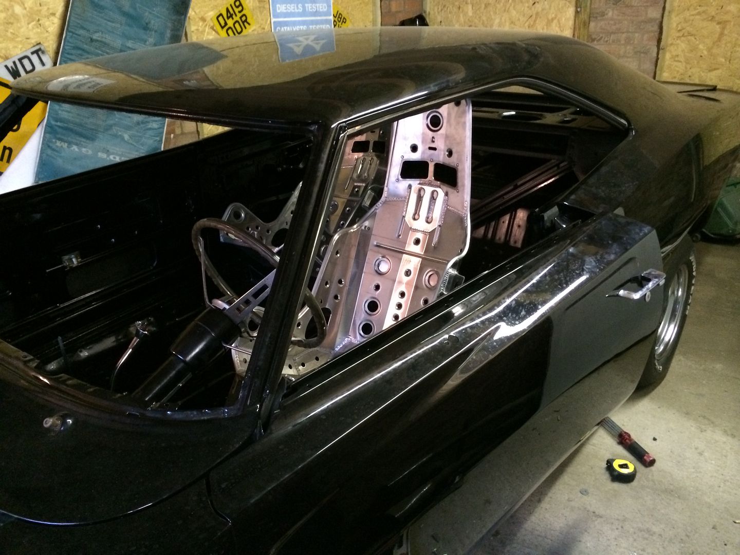

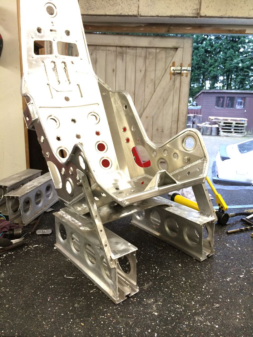

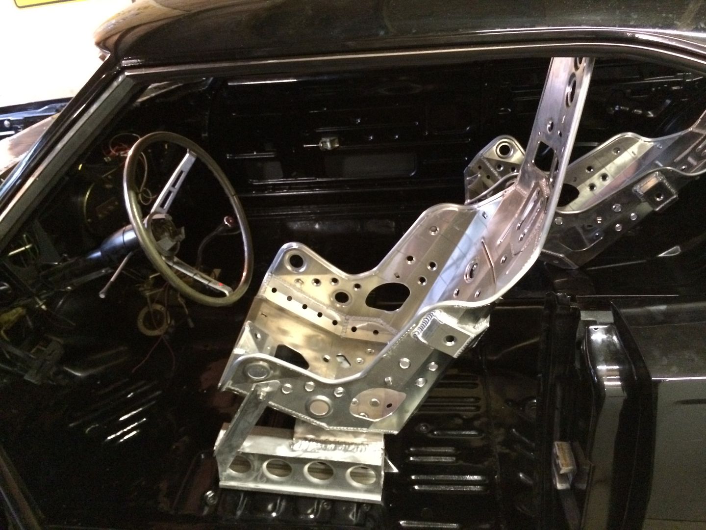

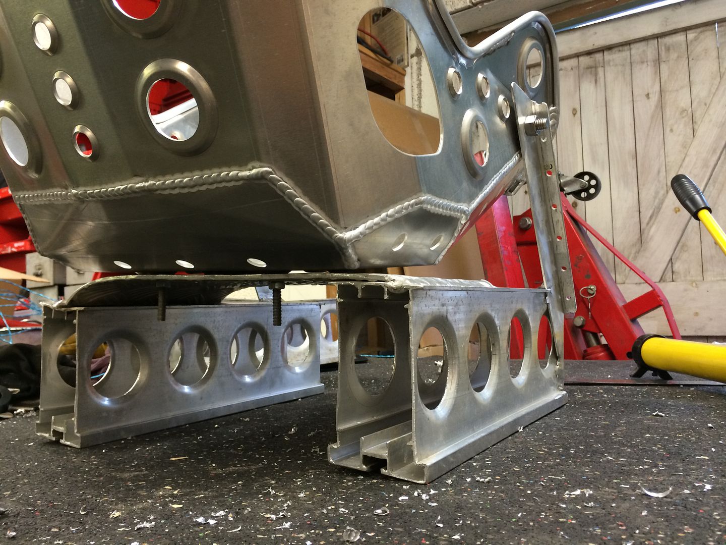

Got passenger seat in :thumbright:

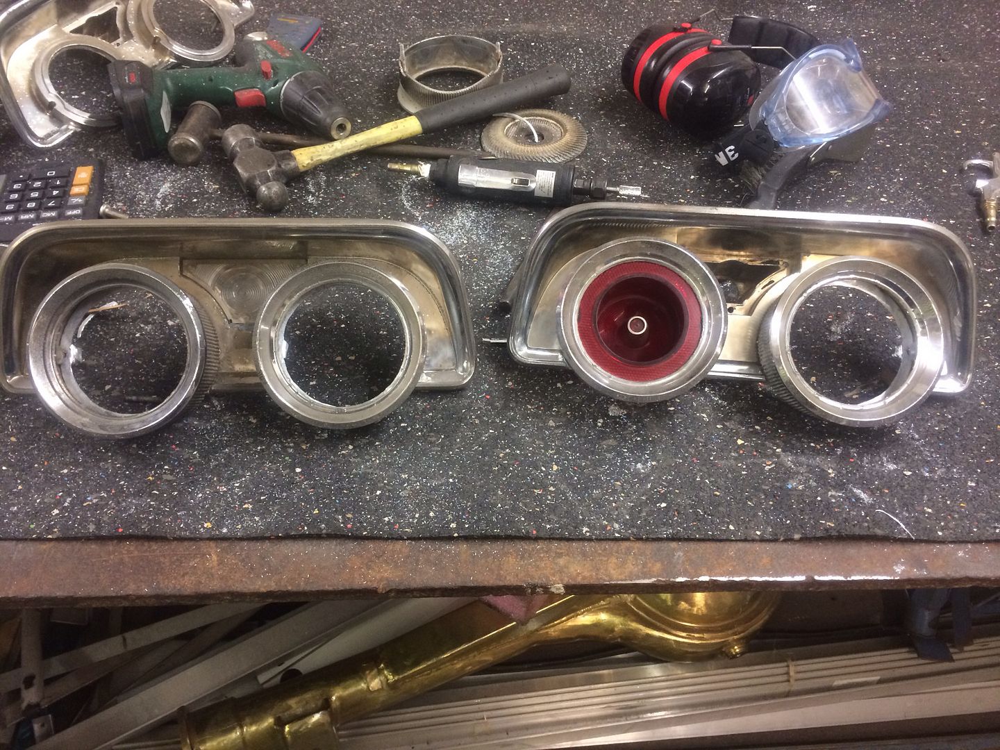

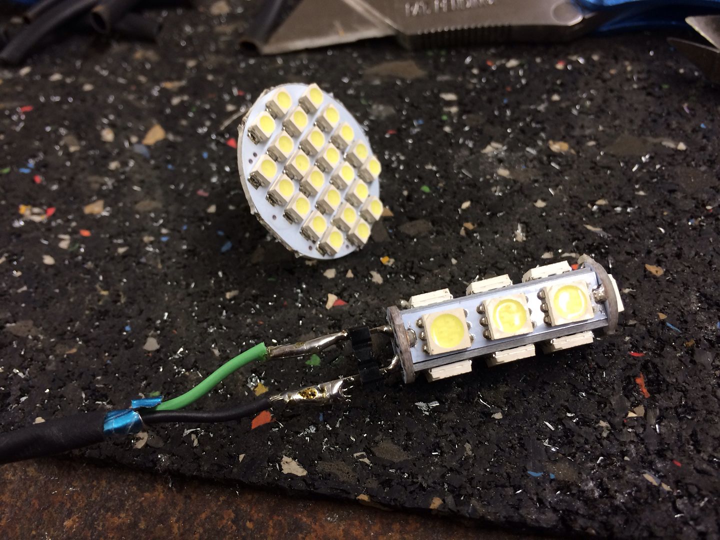

(13SMD 5050) LED = 39 x 10 per light = 390
x 4 tail light = 1560
+ 46 for indicators + 46 for side lights
= 1652 LEDs :D :D :D :D
Ran out of LEDs so only got one light working

Excellent will
love the lights I want a set

Those seats look like something out of the Terminator film :shock: :shock:
