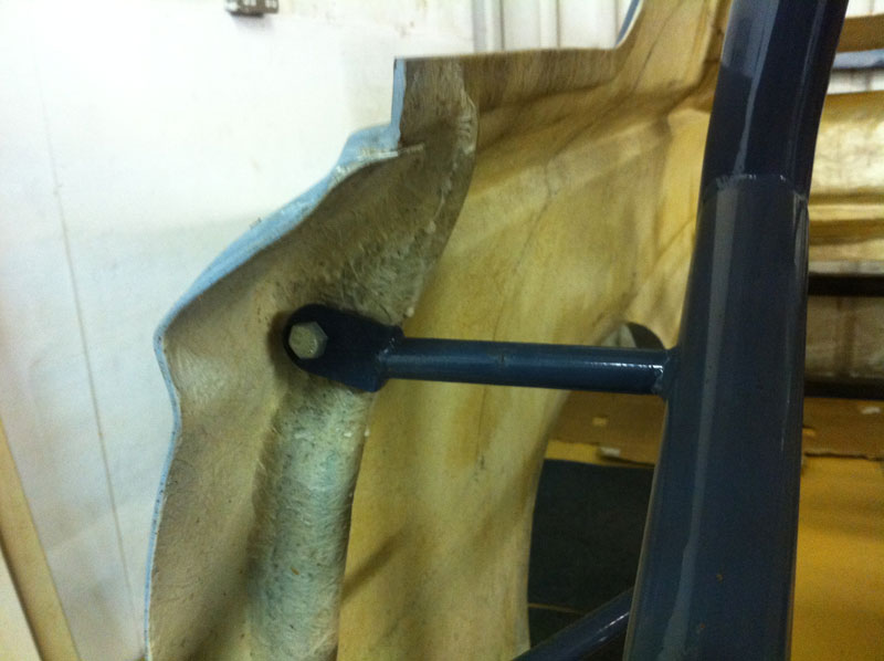

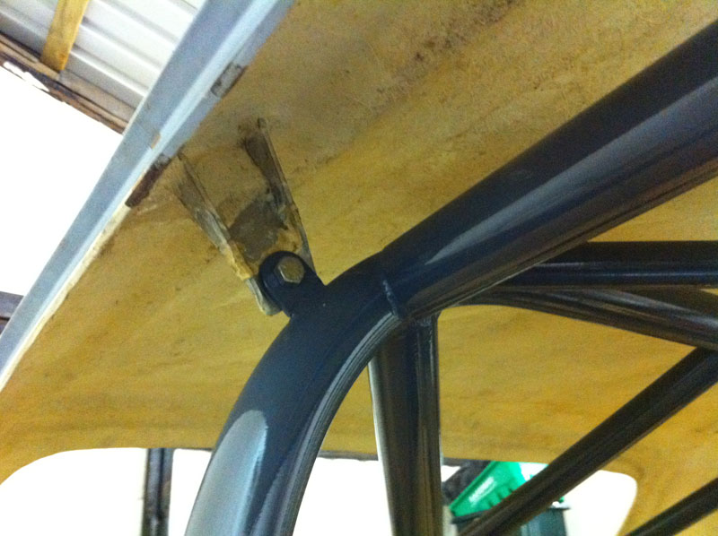

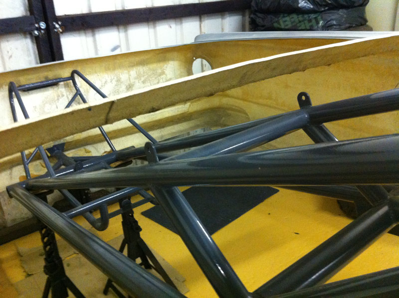

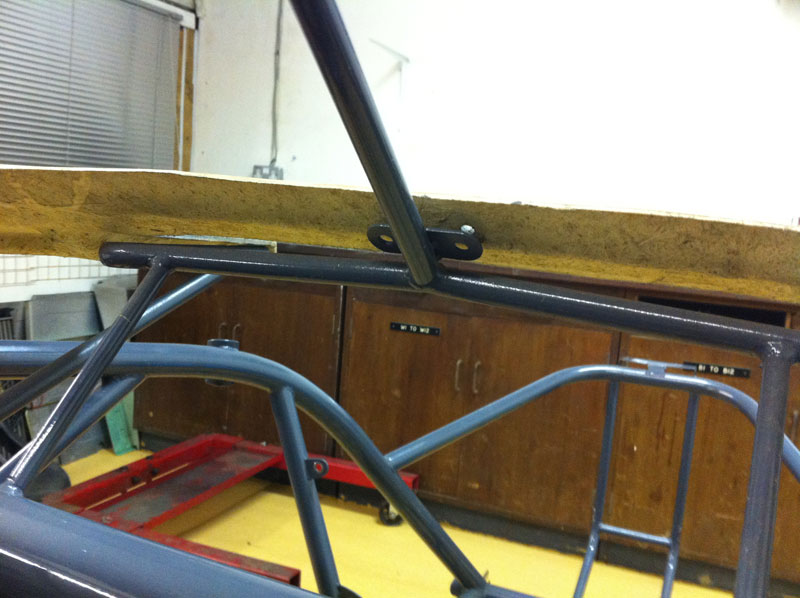

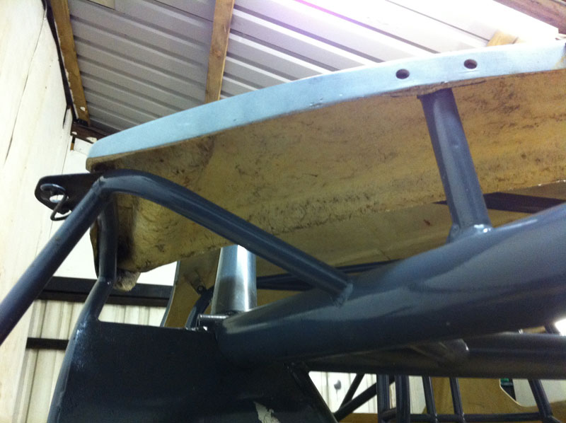

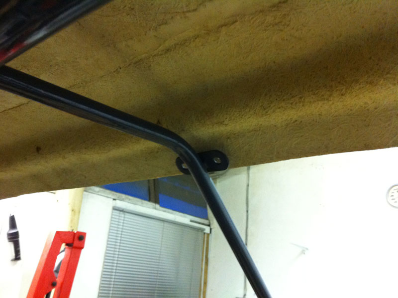

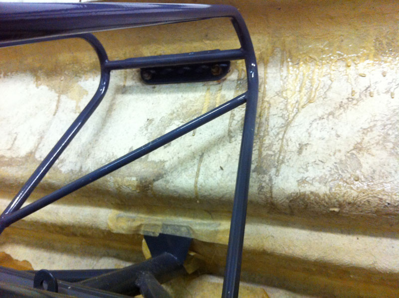

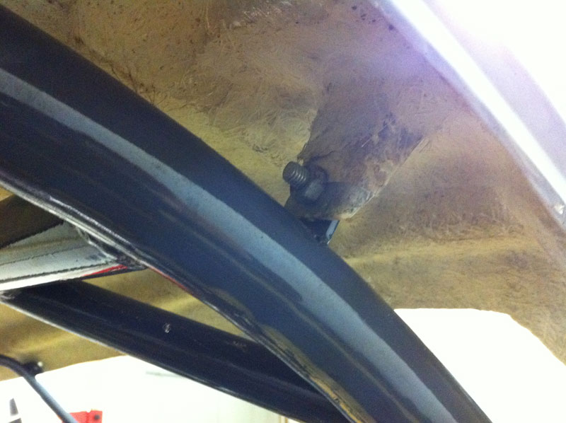

In the meantime, here are all the mounting point details for Jon and anyone else who's interested, the bolts were just temporary to hold it in place. (I hope the descriptions of what each is are OK, ask me if not, obviously the righthand mountings are symmetrical on the lefthand side).
Upper rear of righthand door shut
Rear of trunk outside
Rear of trunk inside
Bottom of rear windscreen
Righthand side of panel in front of windscreen
Lower centre of windscreen opening
Upper centre of windscreen opening
Upper front of righthand door opening (roof)
Upper rear of righthand door opening (roof)

Interesting use of cupboard doors as a bulkhead. :lol:

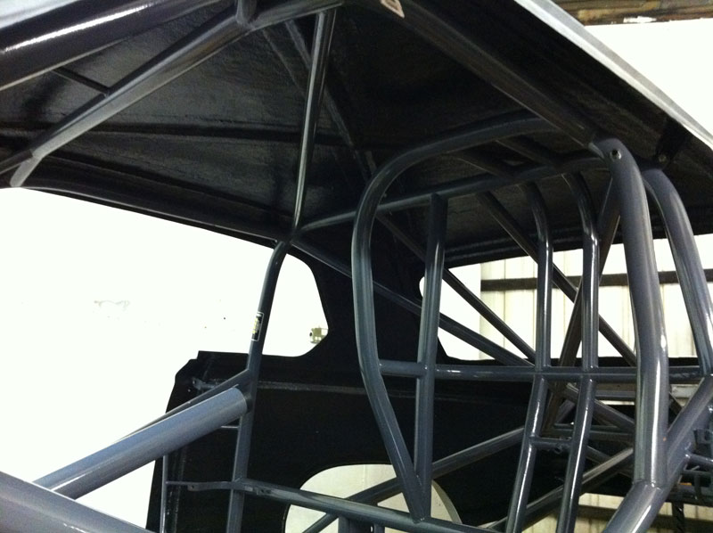

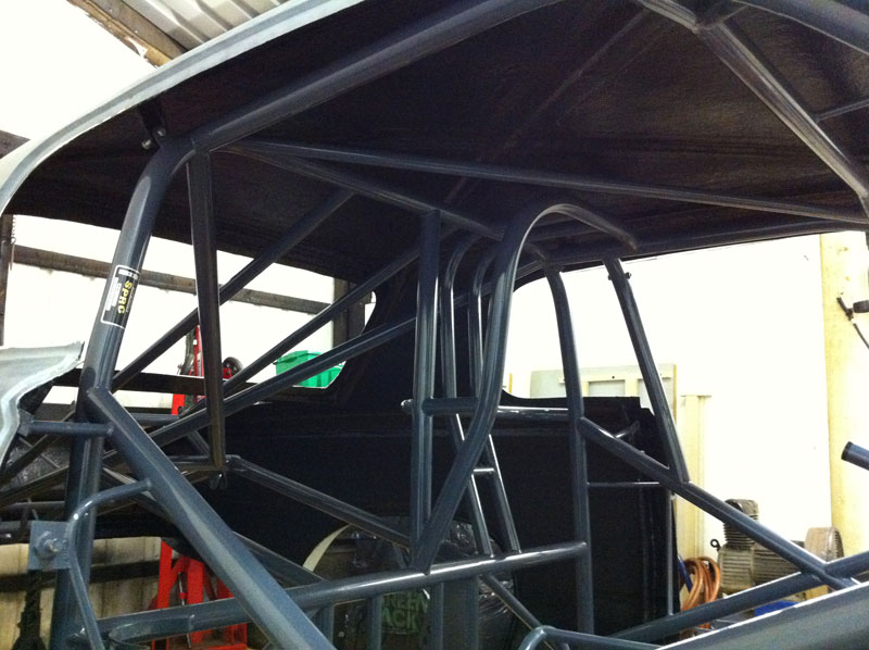

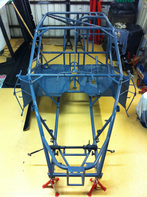

I've spent the last week painting the interior of the glass body. After a bit of experimenting I decided to brush paint the rough side of the glassfibre, I figured it would be easier to touch up if the paint gets chipped and the brush marks are already in the resin in any case. (As it happens, the paint I used lost any brush marks when dry). Wickes sell a water based metal paint in satin and matt finish that doesn't require an undercoat, (they also sell a gloss version that is spirit based) for just under £11 per 750ml. They also have a water based primer but I found this wasn't needed and it DID leave a lot of brush marks, being very thick to apply.
I didn't want a blackboard matt finish as I thought this would mark easily so I tried the satin version. This turned out to be quite shiny (toffee apple) so I ended up using the matt, which I would say has a satin finish when dry. I found I needed to apply 5 thin coats in the end (just over 3 750ml cans) but the paint seems to be quite resilient, having a plastic type of consistency (I guess it's vinyl), it isn't at all brittle.
Here's the paint: http://www.wickes.co.uk/smooth-matt-met ... vt/214320/
And this is what it looks like on the body, and a pic of the chassis polished up:
