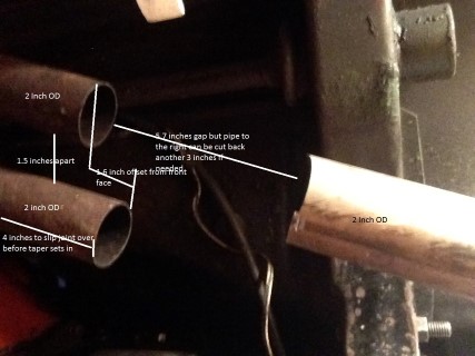

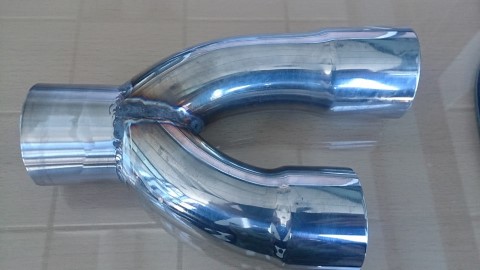

saturday
trip to the post office to pick up exhaust joiner from MIJ exhaust (nottingham check ebay)
see pics
sent them the measurements they sent the part
fitted like a glove
this is a temporary fix get MOT get to NATS
clamped that lot on and levered the rest of the system off the under floor with a big pole new headers are left by 3 inches and caused the system to kink up
see pics
fitted like a glove
