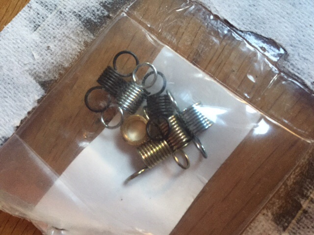

Kit arrived, the paperwork says use one stock spring withe on of the new springs. I thought I just put two of the new springs on??
Also there is a little brass coller with the springs but I don't see any mention of what that's for, any ideas
- image.jpg (76.79 KiB) Viewed 1286 times
- image.jpg (90.97 KiB) Viewed 1286 times
