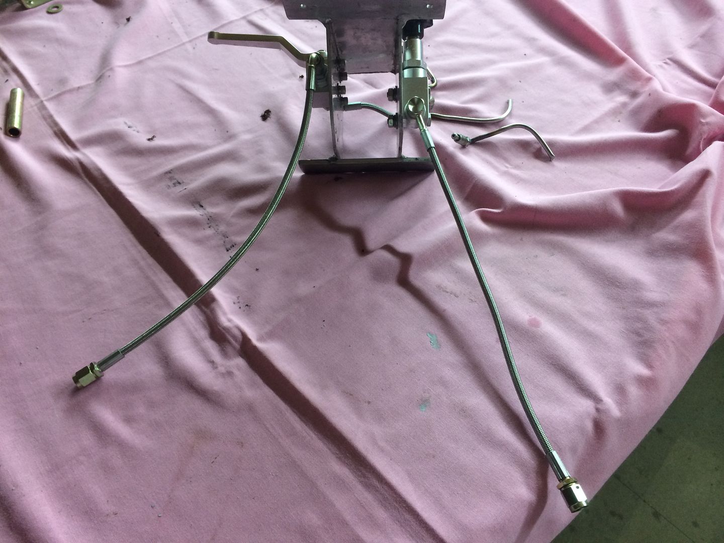

After playing with hard 3/16 stainless brake lines.
I found a little heat and they bend a treat.
For around the line lock and bias valve after many try's and 1/8npt seating issues. I went and had braided line made.
They will connect to the 3/16 hard lines under the car

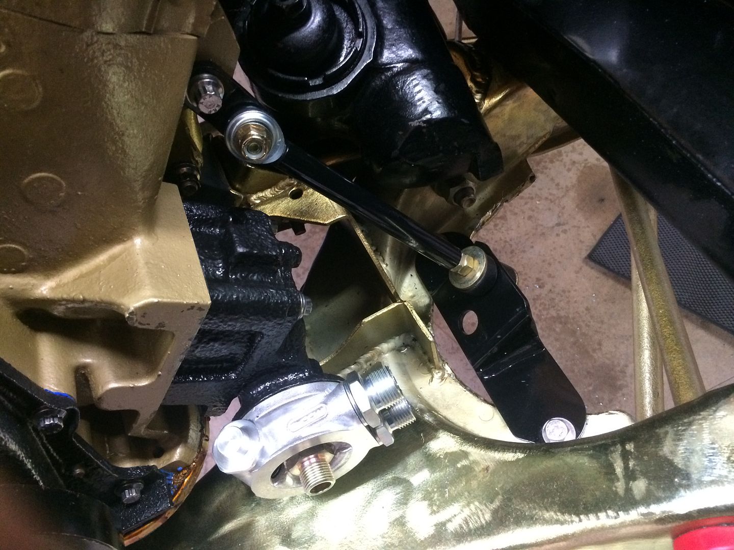

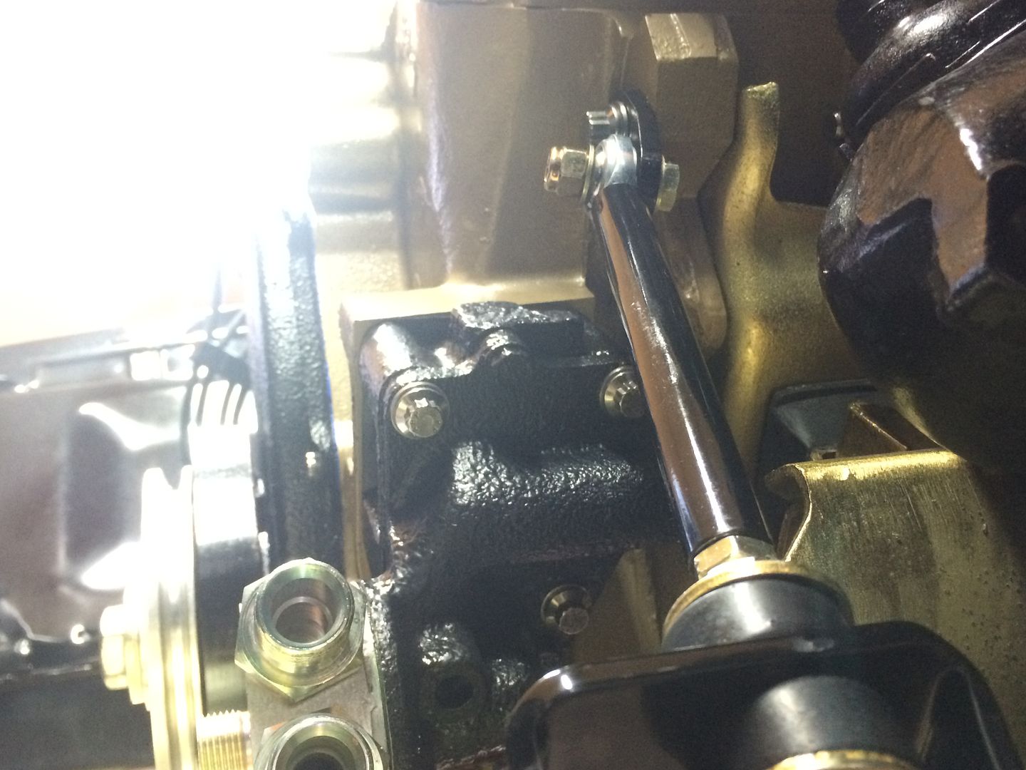

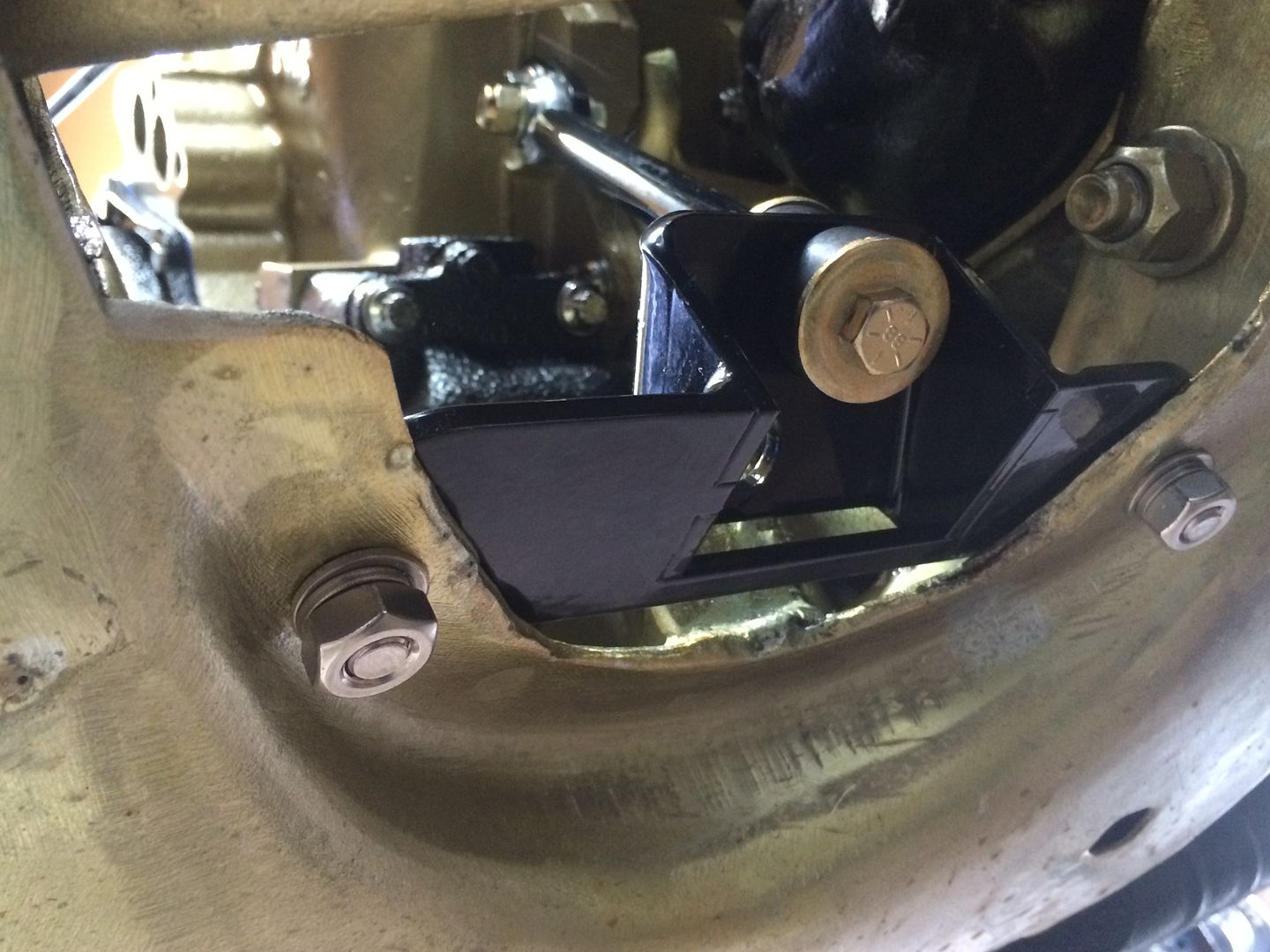

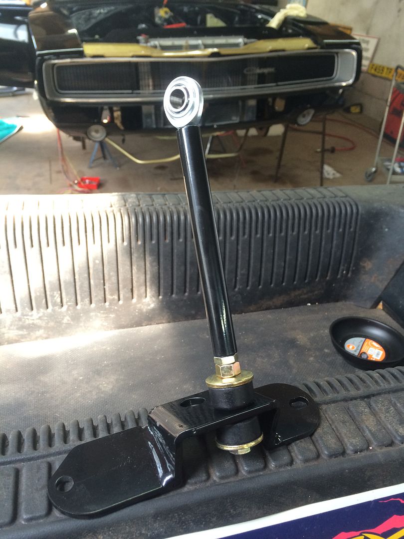

I installed a torque strap this required drilling holes in Kframe
