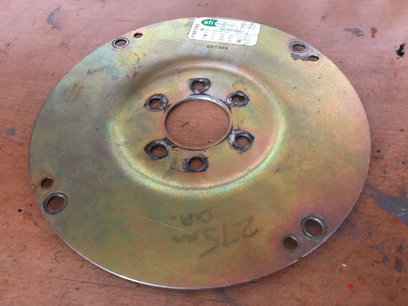

B&M are no longer producing a neutral balance flexplate for use with a 904, so I had a 727 one turned down to the correct diameter, hopefully this will do the trick.

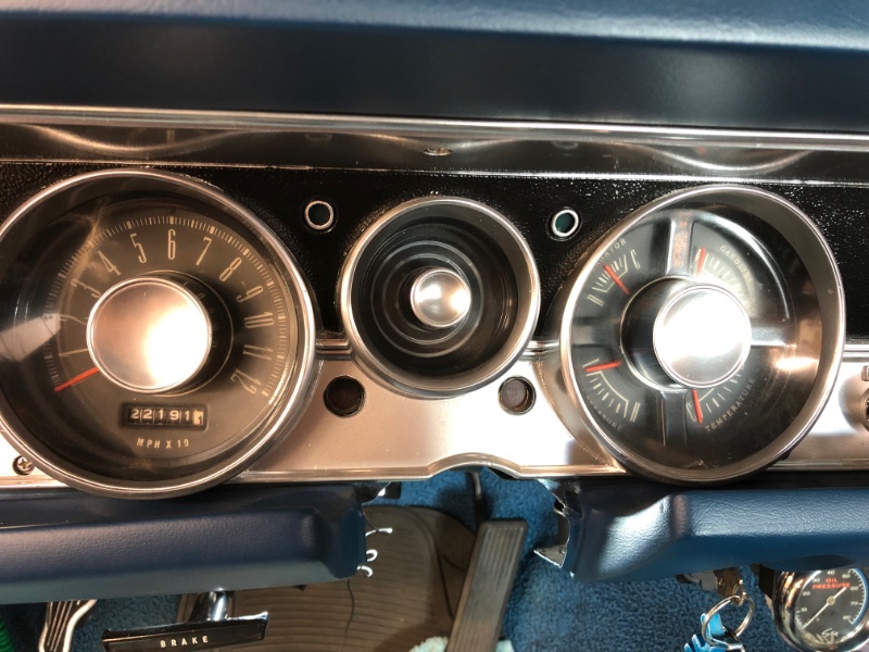

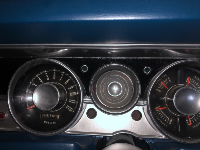

My new ignition system has the ability to operate a shift light so I wanted to fit one. I’m not a big fan of “stuff” so I had a think about how I might incorporate it into the existing layout. On an A body rallye dash the central dial comes blanked off unless a vacuum gauge or tach was optioned so that seemed the best location.
Re: Blue's Barracuda

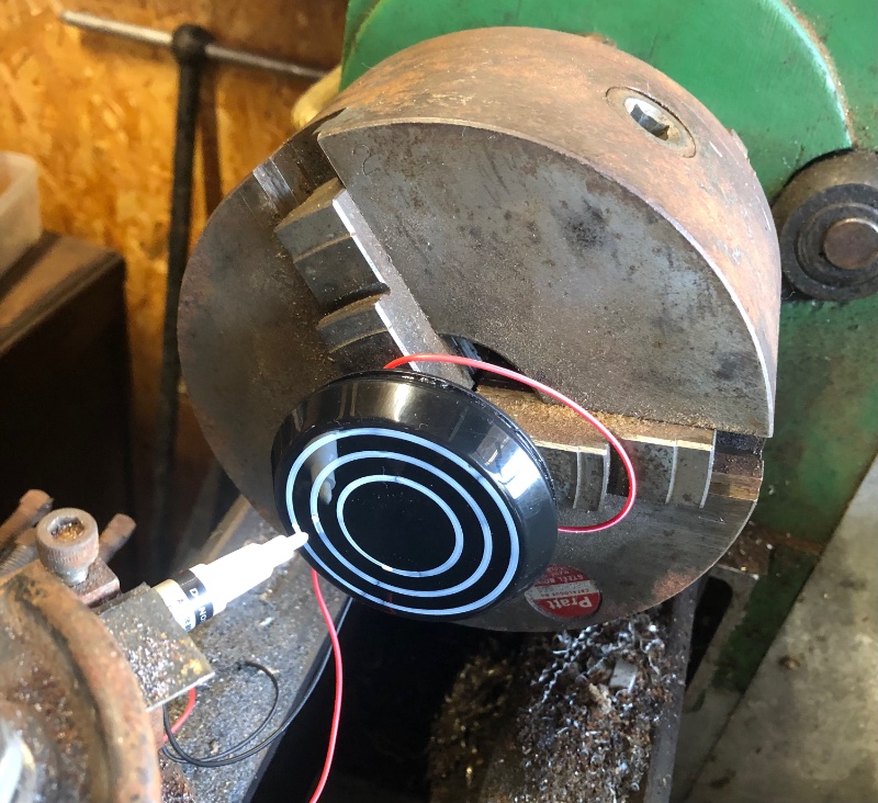

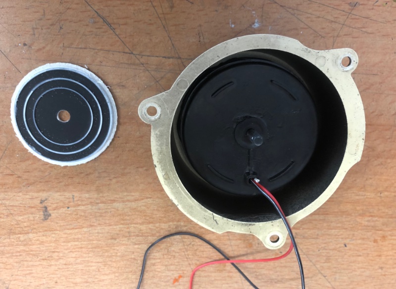

I found a suitable black faced flat LED lamp on eBay and used a paint pen and lathe to replicate the pattern of the blanking plate. Cut out the centre of the blanking plate and glued the LED in from the back.

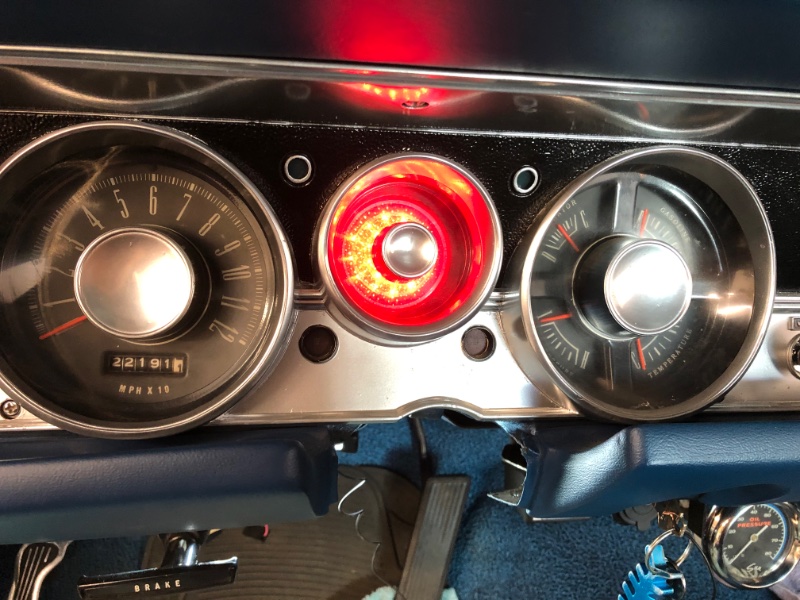

Boom!
Posts: 7111
I wondered what you were doing with that. :shock:
Brilliant solution and can’t imagine you’ll miss it in the heat in battle! :D
Awesome. 8-)
Ace, what a great idea :thumbright:

Excellent! Great solution :thumbright:

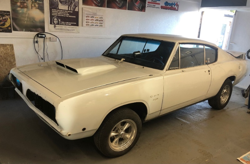

Paint guy had a cancellation so only had a couple of days to get the new screen in and de trim the car. Goes in Tuesday so should be back for Crimbo…
