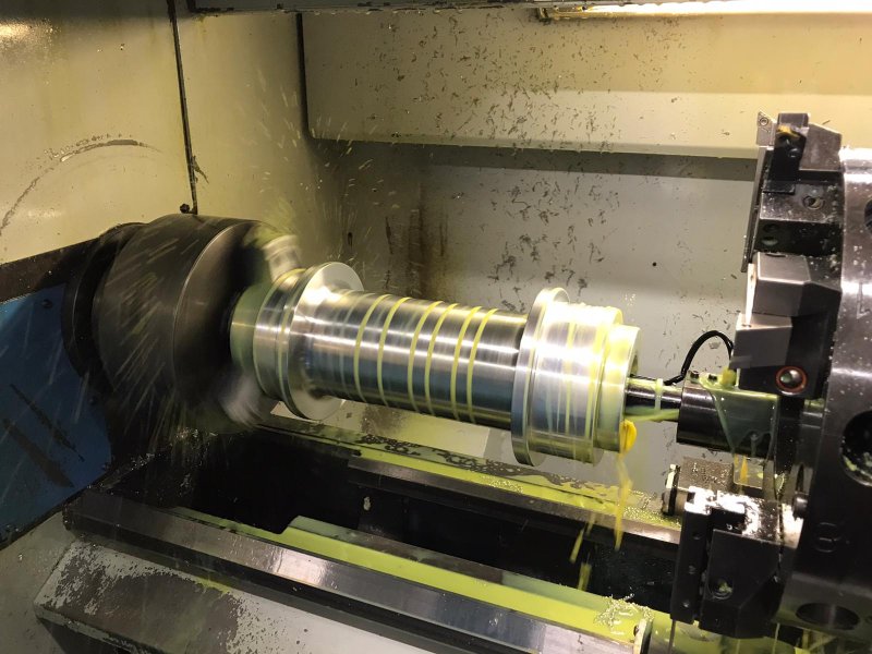

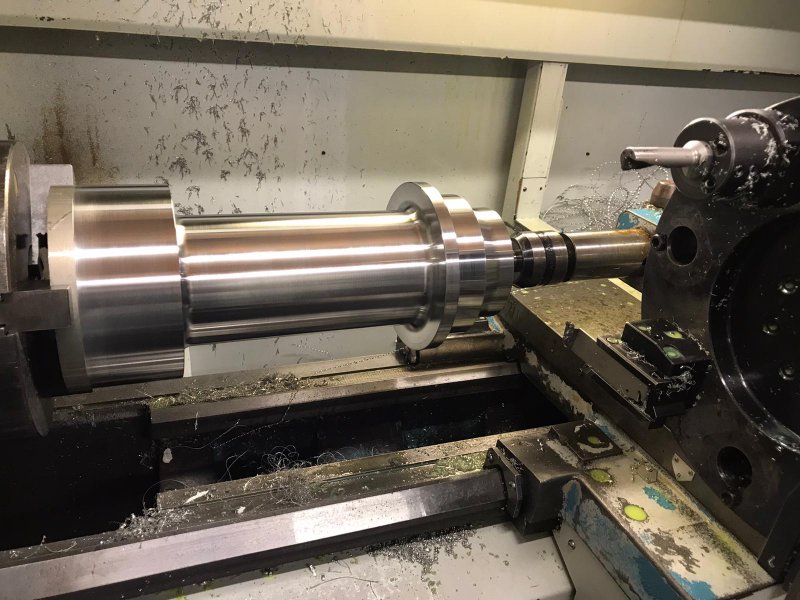

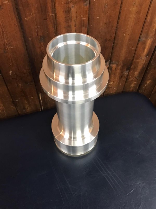

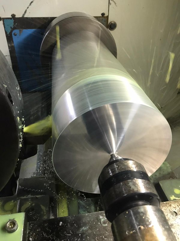

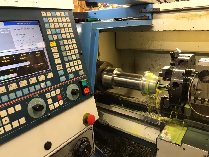

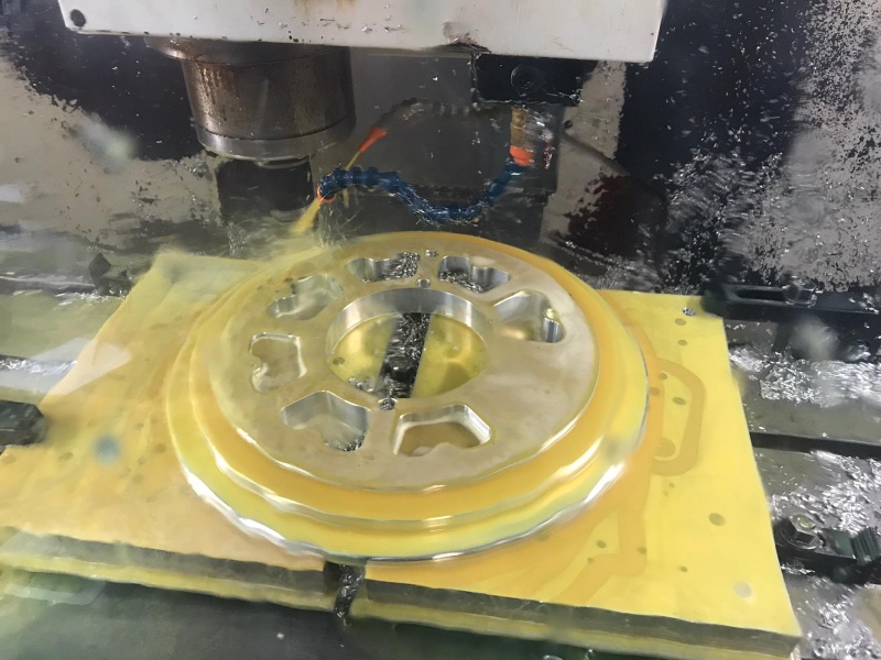

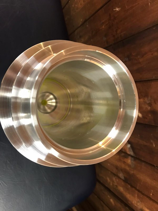

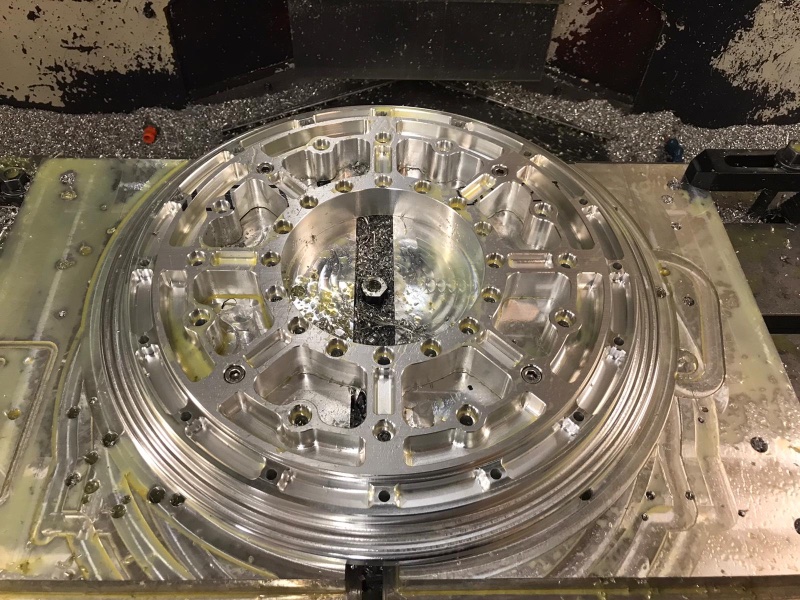

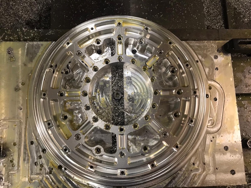

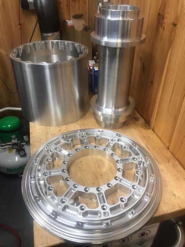

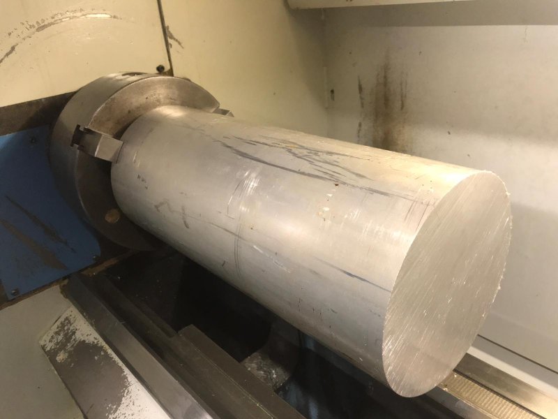

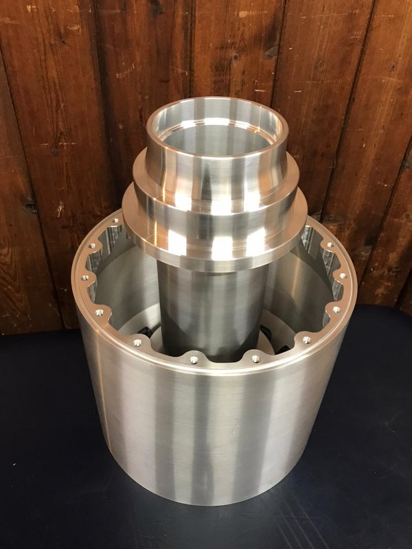

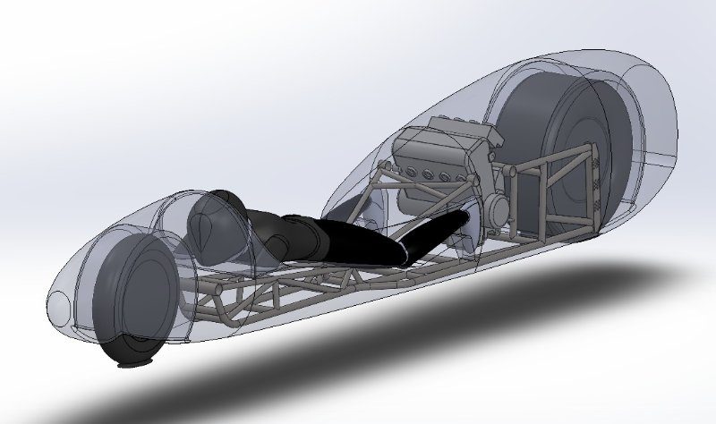

Finished machining the axle bearing housing.
It's a 100mm Hole up the middle and it's a 10" wide wheel !!
This will mean we can use huge bearings!

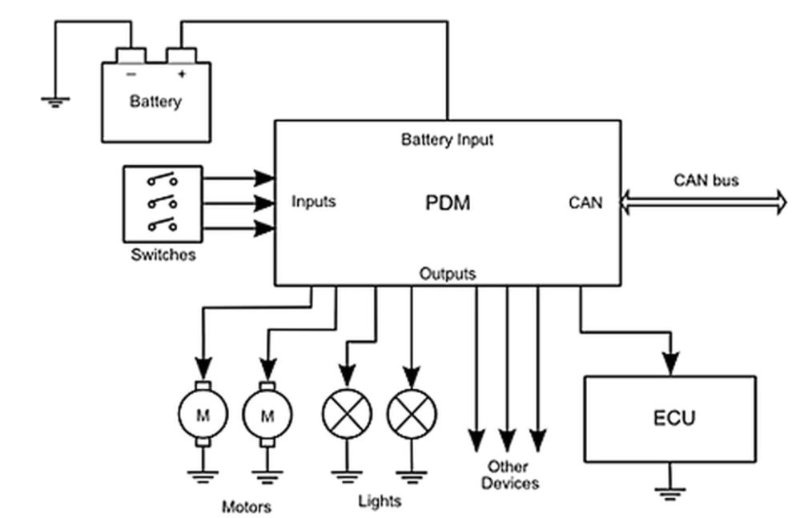

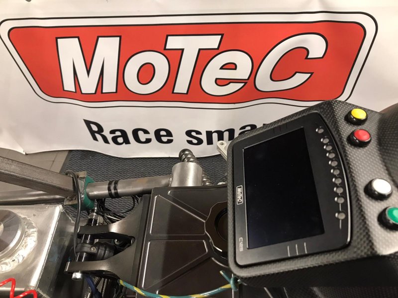

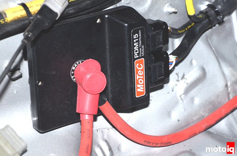

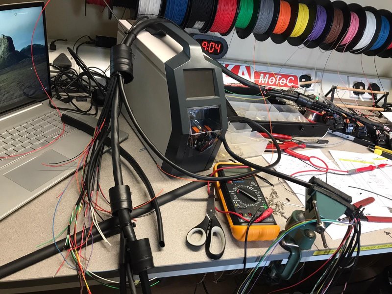

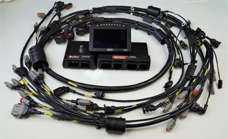

PDM - Power Distrbultion module
The world is moving over to solid-state relays and software-defined fuses
The PDM takes one large power cable directly from the battery and then using software you can define what the outputs are and there fuse rating.
For example
Pin 32
Your a + DC Voltage 12v
You're an indicator
when you come on you will switch on for 2 sec and off for 3 sec (flash)
You are a 5 amp fuse
If you trip your 5amp fuse you will try and reset it 3 times
If you cant reset after 3x you will put a warning on the dash.
etc etc etc
The possibilities are endless and allow a lot of intelligence.
Functions could be triggered from any system on the bike like a simple temp sensor and fan set point.
All the way to active aero dynamic control systems
Re: Fifty shades of Jade

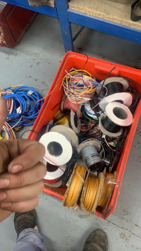

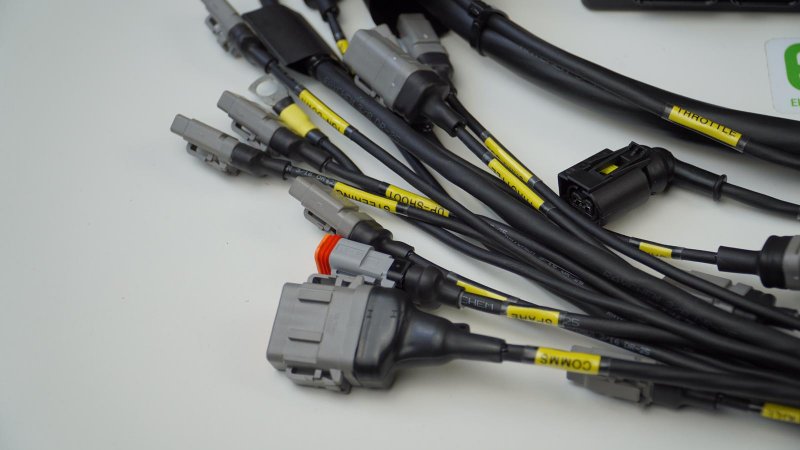

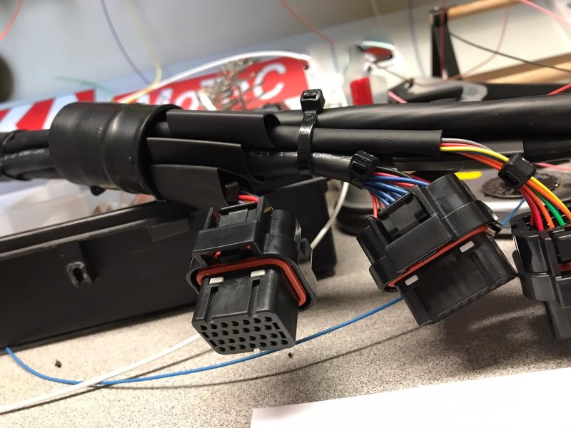

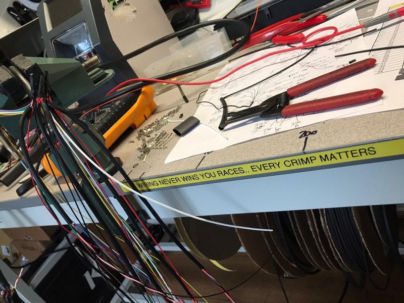

Wiring Harness
Its a monster ! All made and being fitted onto the bike this week. :shock:
Next is to start her up :help:
:geek:

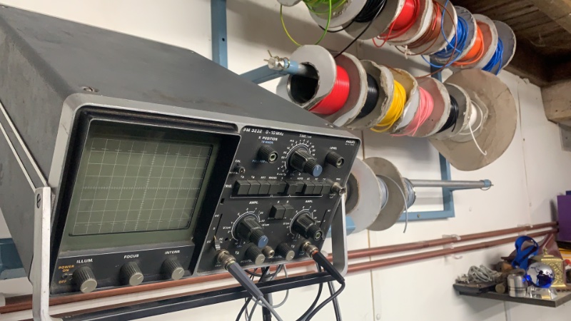

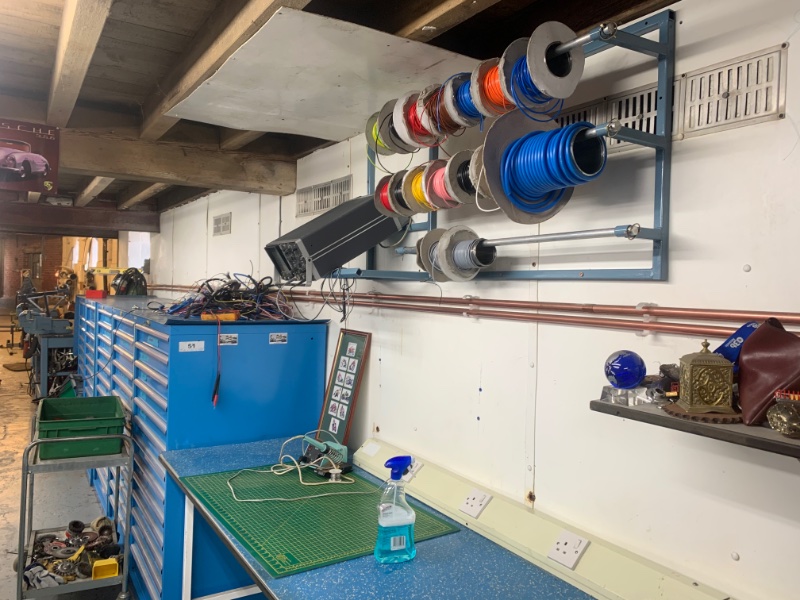

'f knows' hahaha - I've got loads of those on my car :)

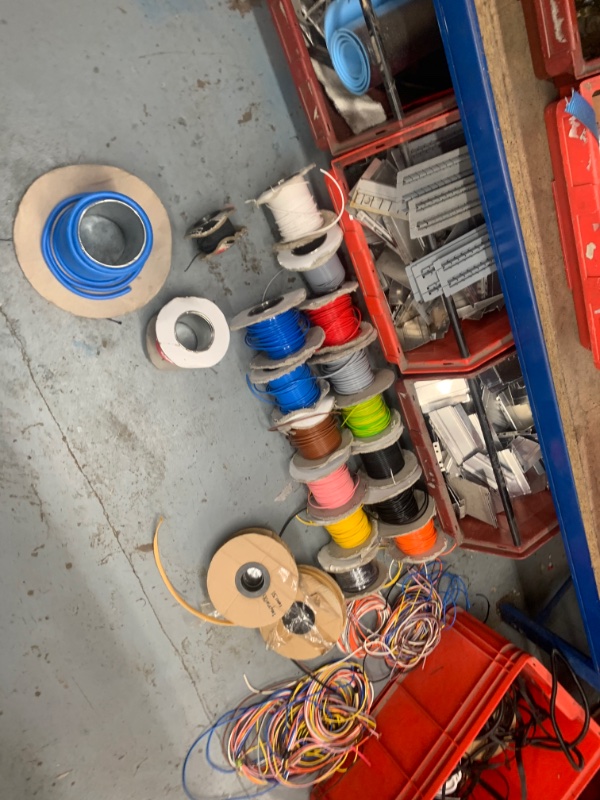

I am very jealous of your coloured wiring spools of all things. What a lovely thing...

This is endlessly stunning. :salute:

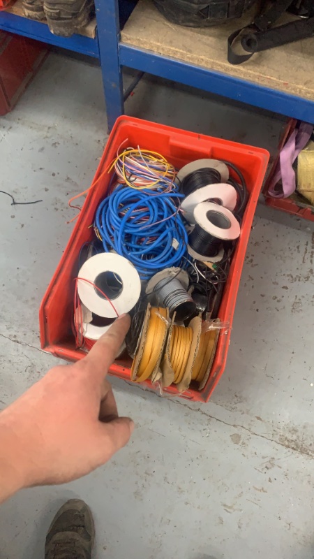

The wiring reels alone are a thing of beauty, I only have red and black which was fine putting it in, but is a headache now I'm trying to fault find.

:study:
Thanks to 3D printers there are loads of Empty plastic reels kicking about the world.
You can then decant your rolls onto these plastic rolls using the lathe on low speed :shock: :lol:

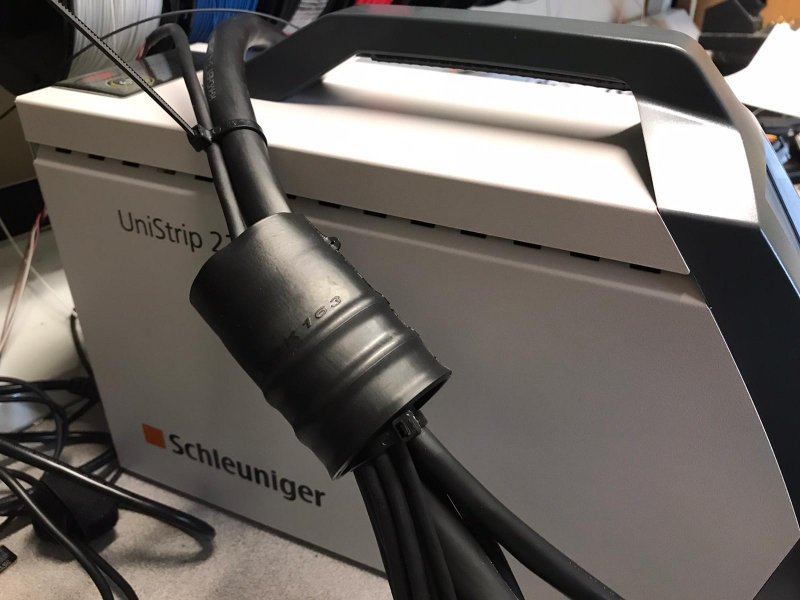

Aw man - even your wiring spooling which I find so strangely appealing is more advanced than anything I have done on my car ! I love it.
Poor mans version below - £14.99 on amazon. hahaha :)

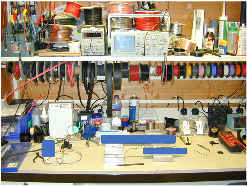

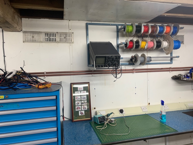

You can never have too much coloured wire :D I wish I had your space though :salute:
What is that :read2: :D
Im well impressed with your setup wow
Posts: 3597
autofetish wrote: Thu Mar 25, 21 8:51 am What is that :read2: :D
Ha, that is an old manual ribbon cable stripping machine, very useful if you need one.... Anything you can buy now is automated and costs ££££ so I'm hanging on to it !
