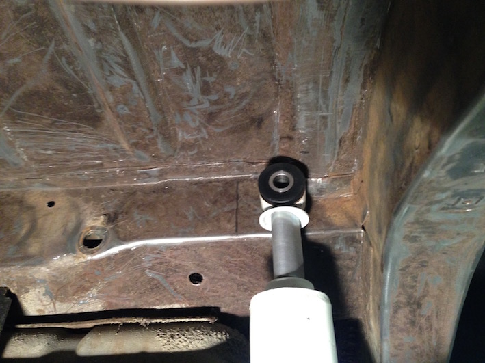

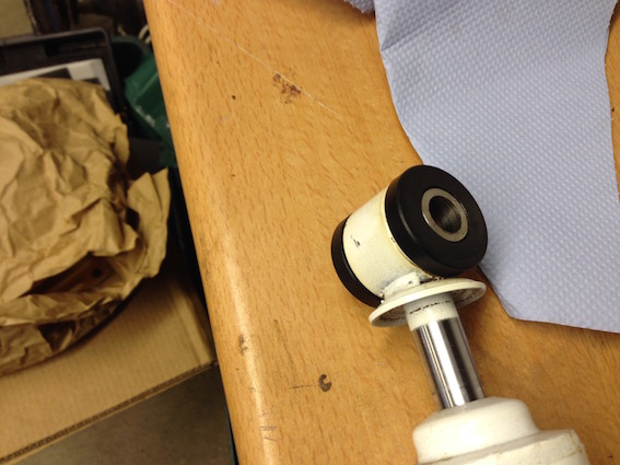

Bit of a mock up to look at mounting the shocks upright. First job was to get Trev to turn up some plastic bushes with a steel insert for the top eyes.

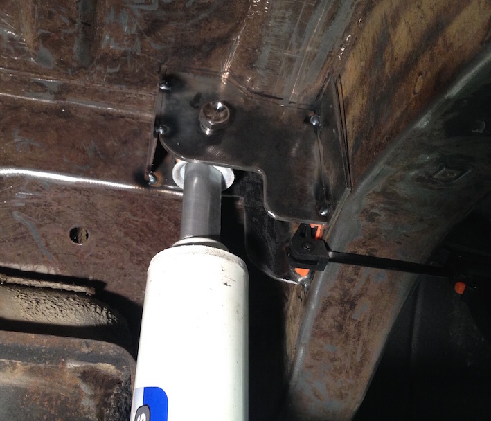

Posts: 14459
After much deliberation, this is pretty much the finished top mount ready to weld up. Just need to make the other side now :roll:
I trust you'll be drilling some holes in those!! ;)
Posts: 14459
Believe me I've thought about it...
