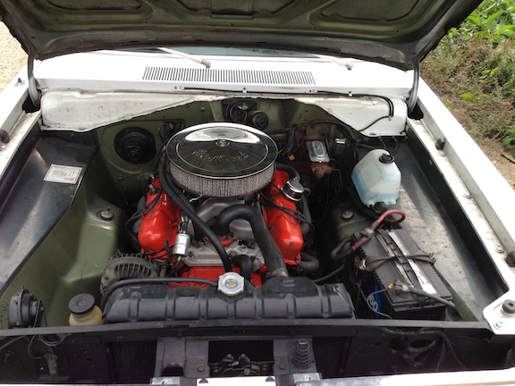

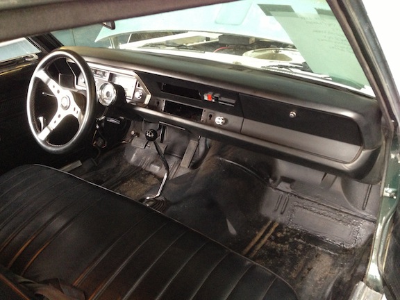

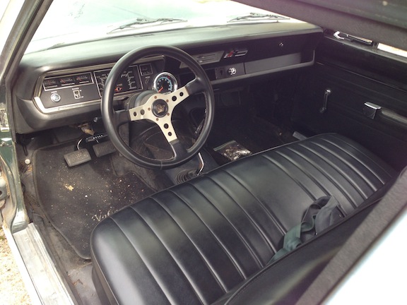

Ok, here we go! Someone asked for more pictures so here they are.
Posts: 14457
So, it's a 318 4 speed car with an 8 3/4" and 3.23 gears with an open diff. manual steering, manual drum brakes, no options base model. Motor has headers, mini starter, Isky cam, air gap manifold, 750 double pumper, Mallory ignition. Currently running on 7 cylinders, suspect it has a burnt valve, previous owner was upfront about all it's shortcomings so no problem there.

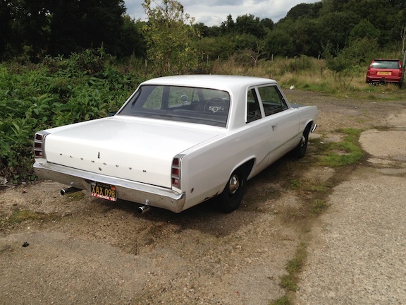

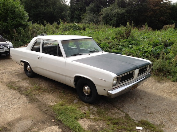

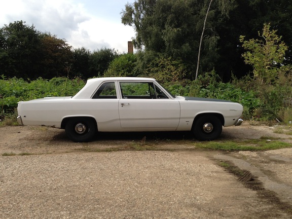

So far it appears to be rust free apart from a bit on the lower rear quarter, no real problem. Originally a pale green car, someome decided to Bananarama! over in white, but for reasons best known to themselves, decided not to paint the hood :roll: paint is pretty poor but again I was told that. So, on with the prep for MOT...

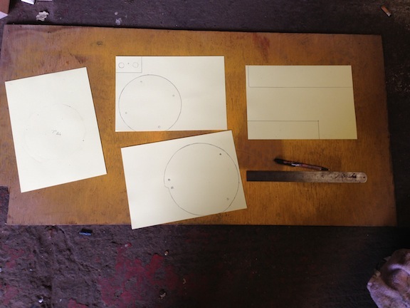

Made a reasonable start this afternoon, heater out, stereo out, speakers out. Marked out templates on card to transfer to ally sheet for the necessary blanking plates, and wrote out a to do list.
Does the to do list contain the word " hacksaw" by any chance ? :D
Posts: 14457
Not at this point...
