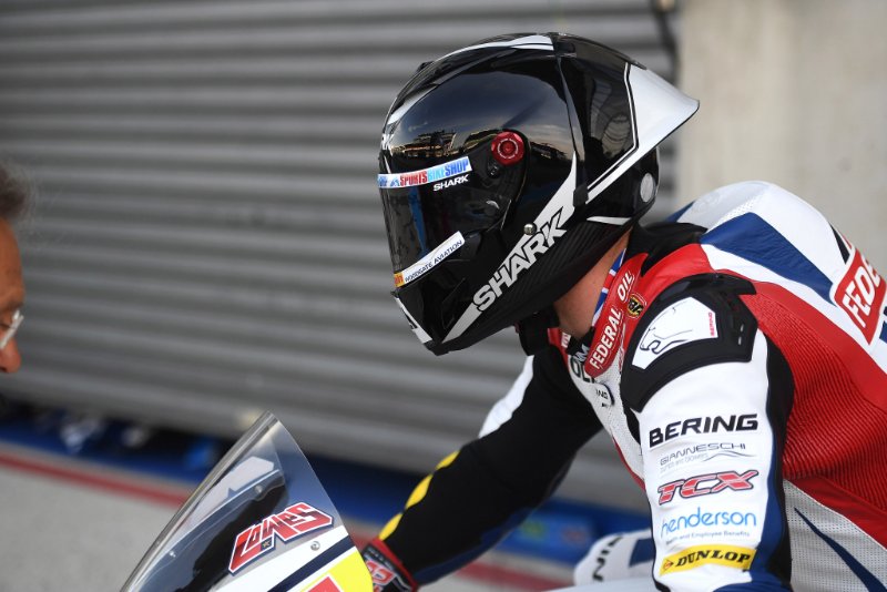

Your cad/wind tunnel rider seems to have a standard helmet and suit - where race bike riders now have both wind deflectors on the helmets and humps on the suits. Would this make any difference to your modelling?
Re: Fifty shades of Jade
Posted: Sun May 16, 21 7:36 pm
by morgan
Prothed wrote: Sun May 16, 21 3:54 pm Your cad/wind tunnel rider seems to have a standard helmet and suit - where race bike riders now have both wind deflectors on the helmets and humps on the suits. Would this make any difference to your modelling?
Is that for Aero ? Or is it like the hans device; stops the neck snapping backward in a crash ?
Posted: Sun May 16, 21 11:03 pm
by mygasser
i believe it's for aero.
neil.
Posted: Mon May 17, 21 11:07 am
by Prothed
Yes, its aero.
Posted: Tue May 18, 21 9:53 am
by autofetish
:read2:
Even with the very large helmet scope and back hump surprisingly we only see a very slight 1.5% change in Drag coefficient
