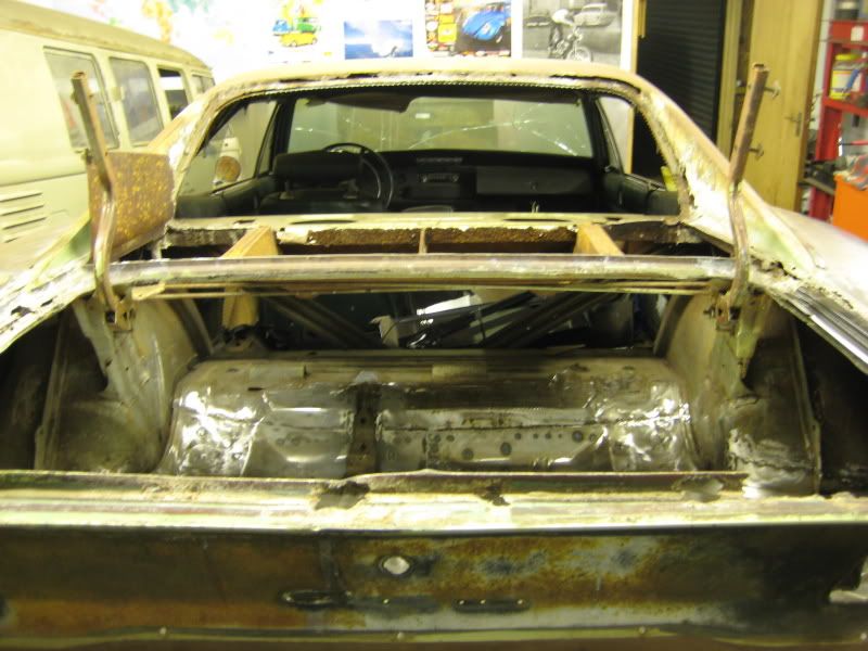

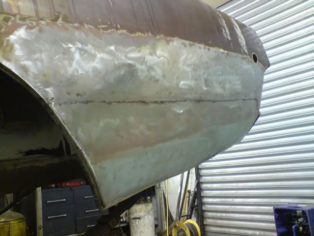

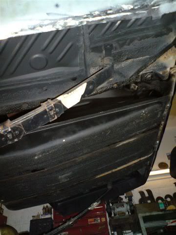

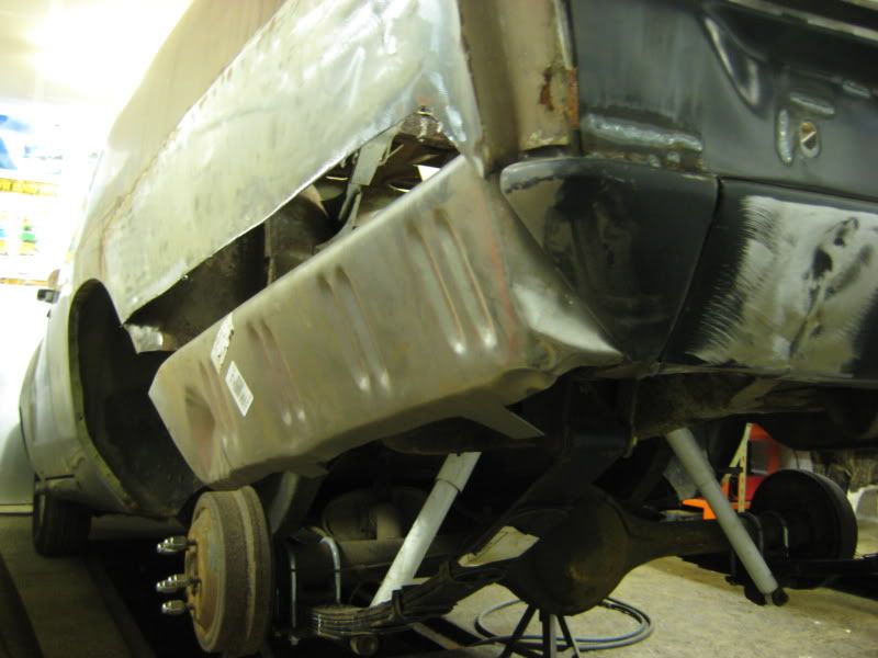

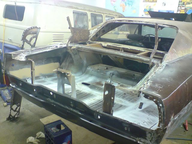

I am glad to report lots of progress on the weather beaten Death Proof mobile, so now she;s almost rust free. The entire rear end has had surgery bar the rear panel (soon) and the sail panels (being done now). Here's a few crappy pics before the camera gets dowloaded:
Fuel tank in, trunk floor in, lower quarters done, trunk floor drop sides in, one rear panel support saved, one new. Tim @ Roadhouseretro.com is a damn good welder/fabber and he loves working on historical tin.
More stuff soon. MoT by xmas I hope!

making some good progress .. i see you charger has the extra back panel supports ...they were only on early 68 models that were built in 67 ... would of had a diffferent trunk lid also with a seperate inner frame !
keep the pictures coming ..love looking at stuff like this :thumbright: :atthemovies:

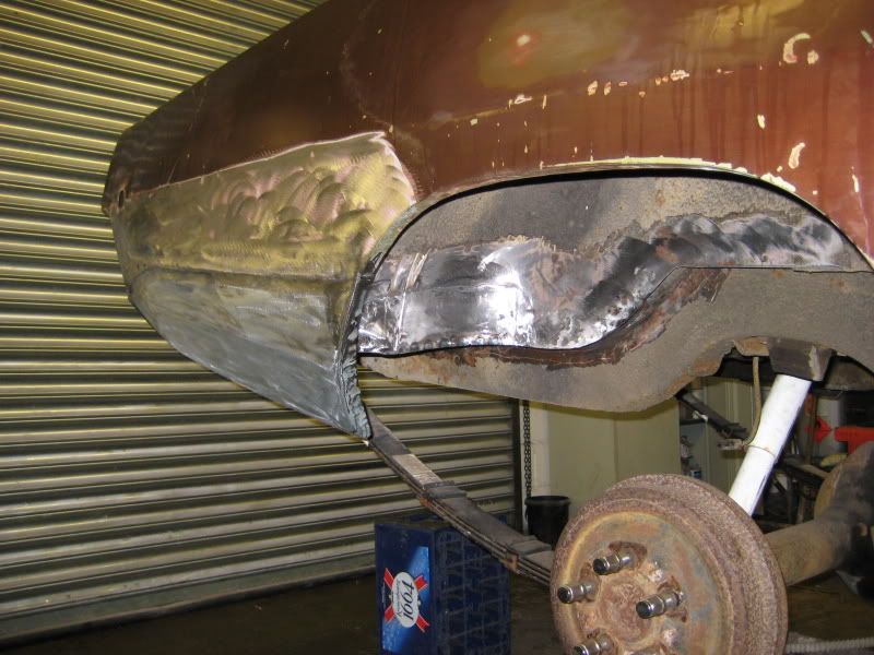

Cheers Steveo - the decoding site I used reckons she was built December 01 which means the car will be 41 years old tomorrow, right? If it is an early one then I think it does have separate inner trunk lid. The rear panel braces were all unstitched (spot welds drilled out) and then we managed to save one. The other was peppered with holes so I got a replacement.
Here's some more welding shots. New rear panel shot on its way
