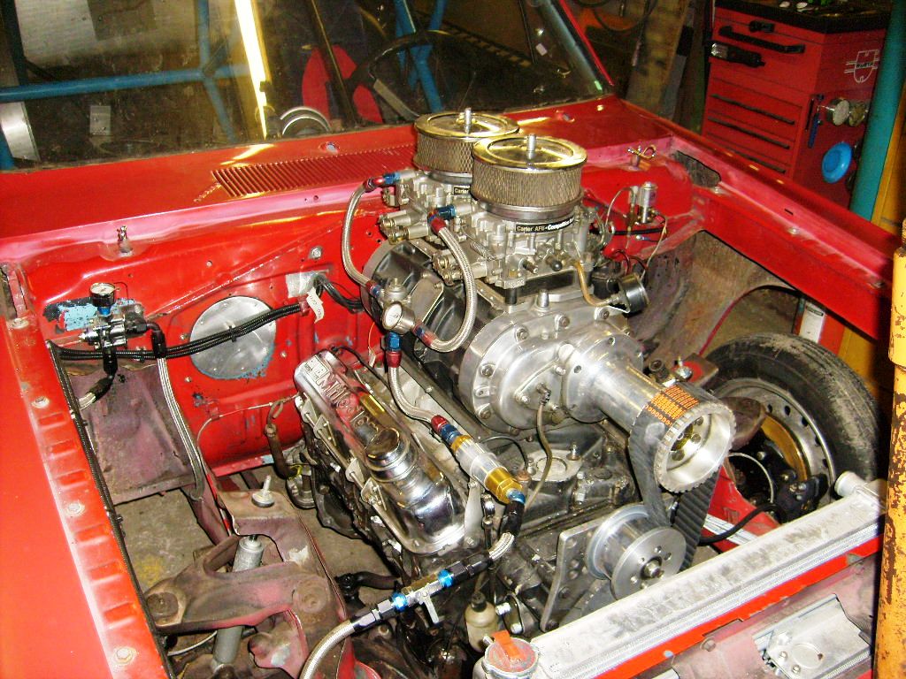

It fits
- S6302343.JPG (217.57 KiB) Viewed 1460 times
- Jon Connolly
- Posts: 3116
- Joined: Fri Jan 26, 07 8:53 pm
- Location: Asleep on the tarmac ... I`m tired and emotional

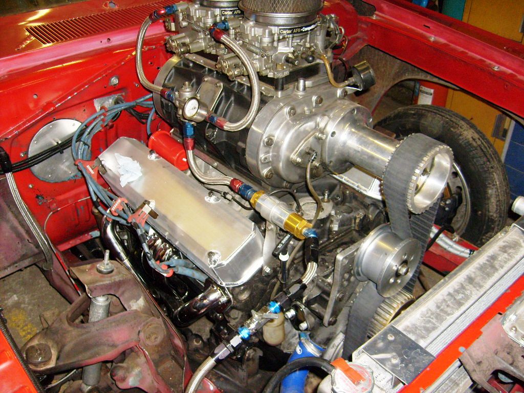

TTI headers on
Valve covers on
Radiator in
MSD ignition in
Just got to make an air filter, change plug leads then set timing and boost.
Valve covers on
Radiator in
MSD ignition in

Thanks
Did start it earlier but water not connected yet
Will post a clip up in a week or so

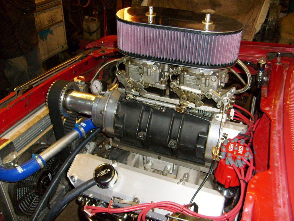

Made the air filter by sandwiching 2 sheets of 2 mm alli plate between the filter element ... simple and effective
Timing done
Fuel pressure set up to 6.5 psi
Blower set to 6 psi
Runs nice, temperature good
Ready to rock n roll
Timing done
Blower set to 6 psi
