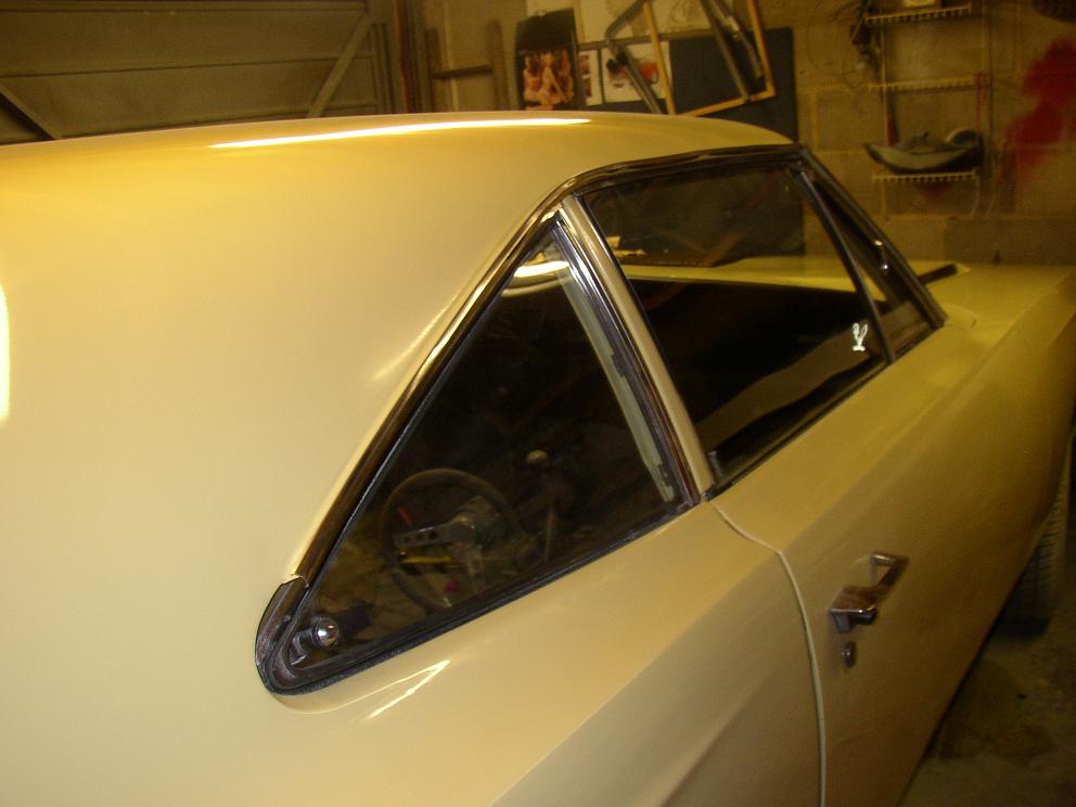

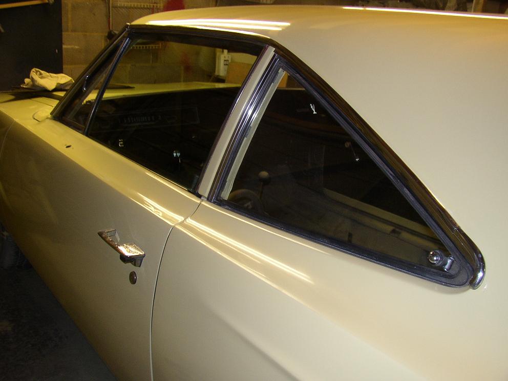

side glass went in first the drivers window is the wrong size 1 inch gap it looks like a hand cut replacement. new felts and top rail seals were fitted.missing one end gutter trim have found one in the states though its on its way.

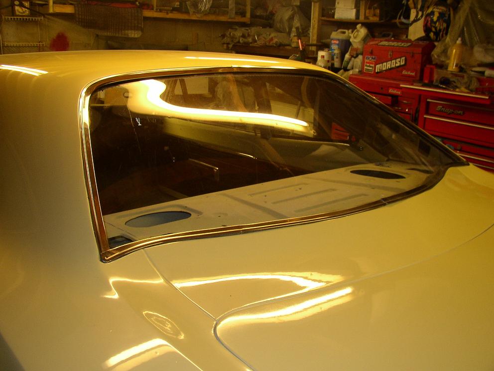

rear window went in well new trim clips fitted. i had a job getting sealer and primmer all the large windscreen company's wont sell it anymore went to a tractor firm then had it on the shelf. trim fitted well considering i had to rebuild the whole bottom channel that the screen rests on

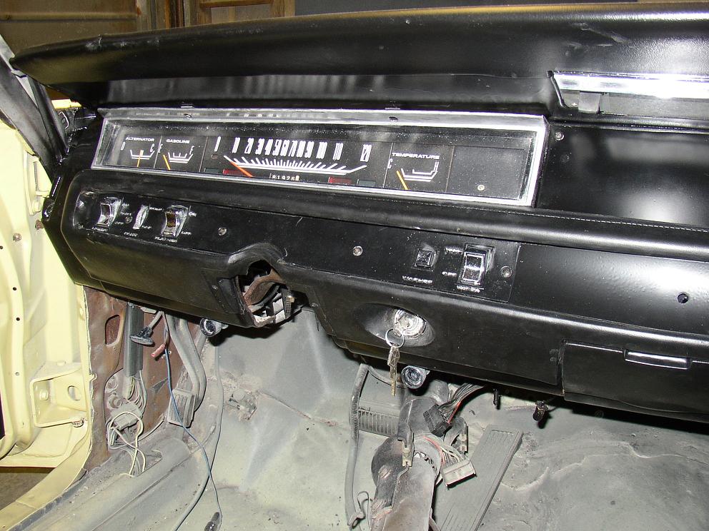

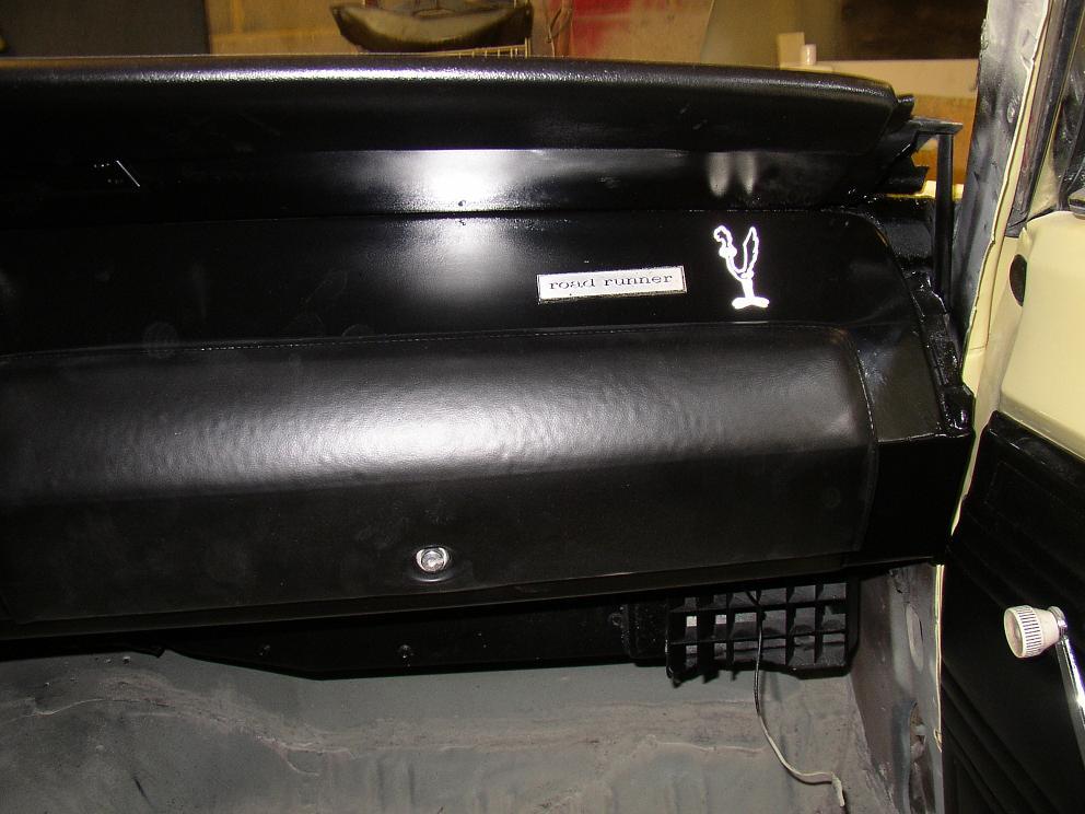

stripped the dash and cleaned up the speedo Assembly. the dash was tan which i have sprayed gloss black, all the trim surround have been sprayed with trim paint came out well considering how poor condition it was in will look to replace once the car is on the road. new roadrunner sticker fitted looks great. new key and barrel fitted.i should of cleaned the white dust and finger prints but i just dont have the time!!

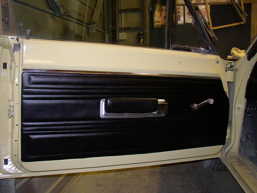

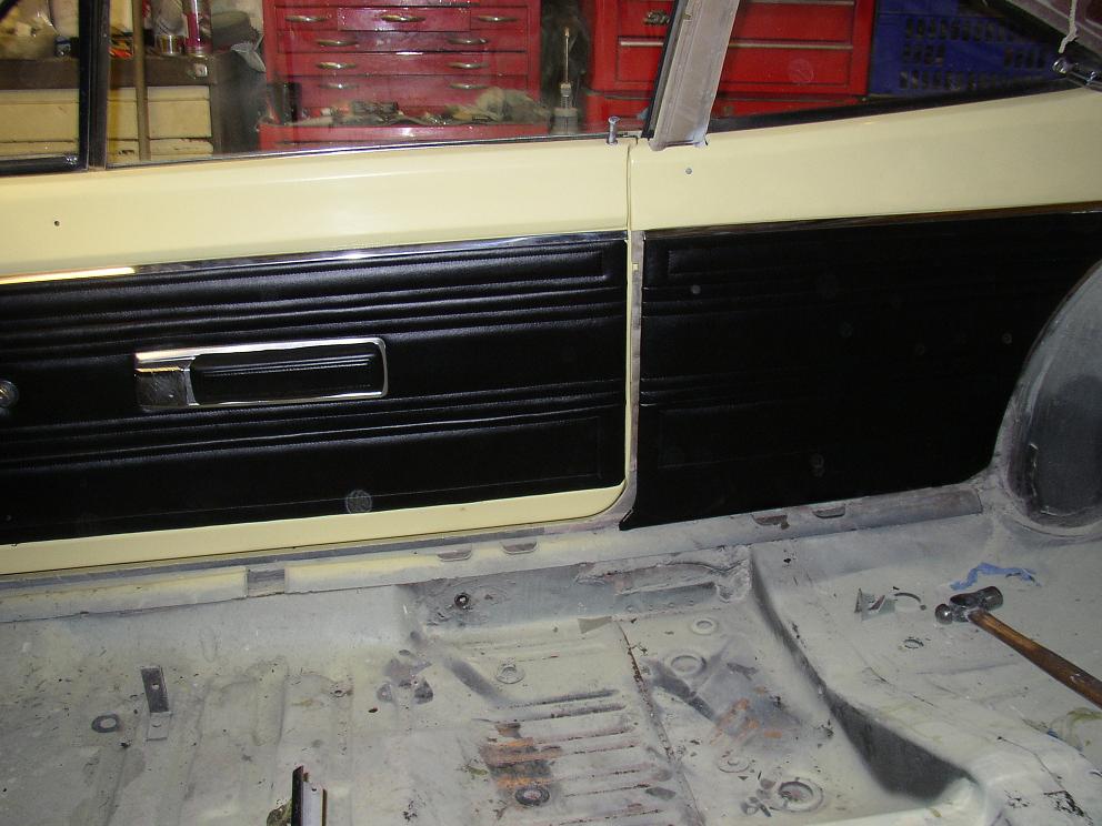

new door cards fitted found them on ebay fit is great ( the guy make about six different pattern's and ships to uk from the states.he is planing to make replacement seat covers as well.i was please to find the stainless trims when sifting through the pile of bit i picked with the car.
i painted the backings for the arm rests as the chrome had worn off again i will replace at a later date
you will be lucky to find a sideglass in the uk as yours is a post car, i have maybe 10 pairs of regular be body side windows,

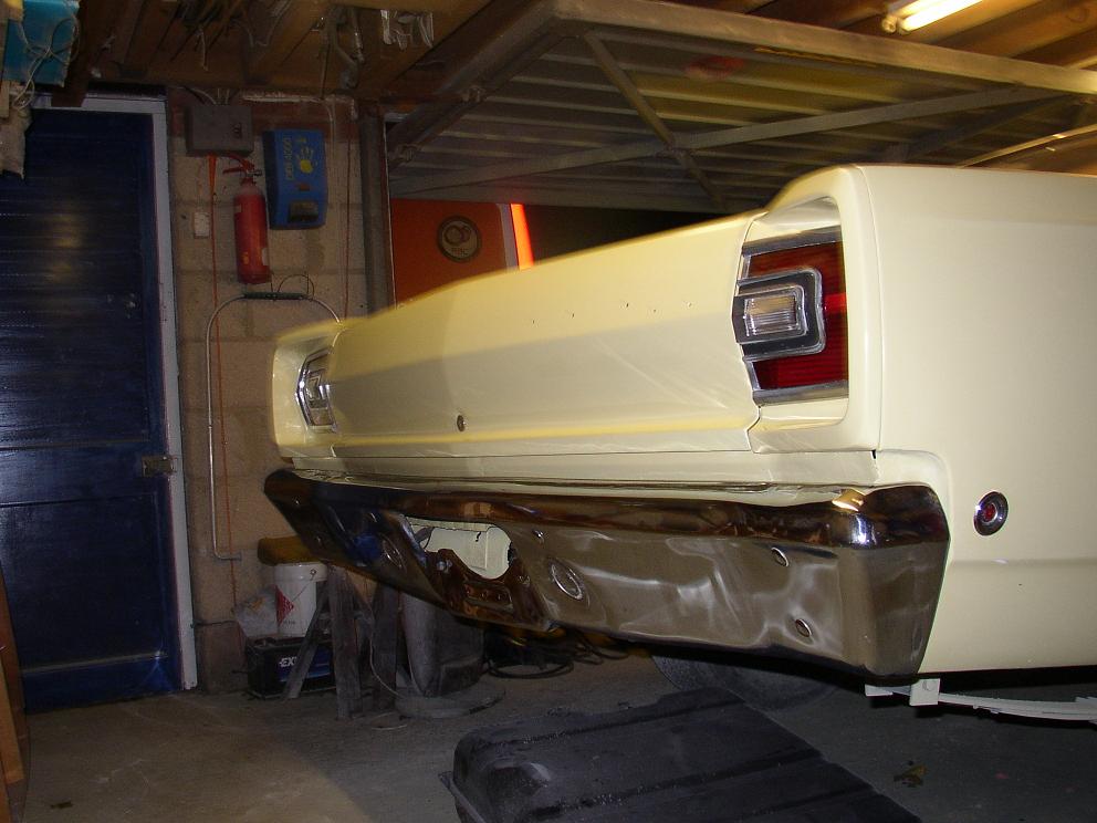

New Rear bumper cleaned up great,.new rear light lens from Canada look great going to use the reverse as indicators, and before someone tells me yes i know its a 69 rear bumper.cheap and its a bumper.i do like swap meets.new emblems are on the way.

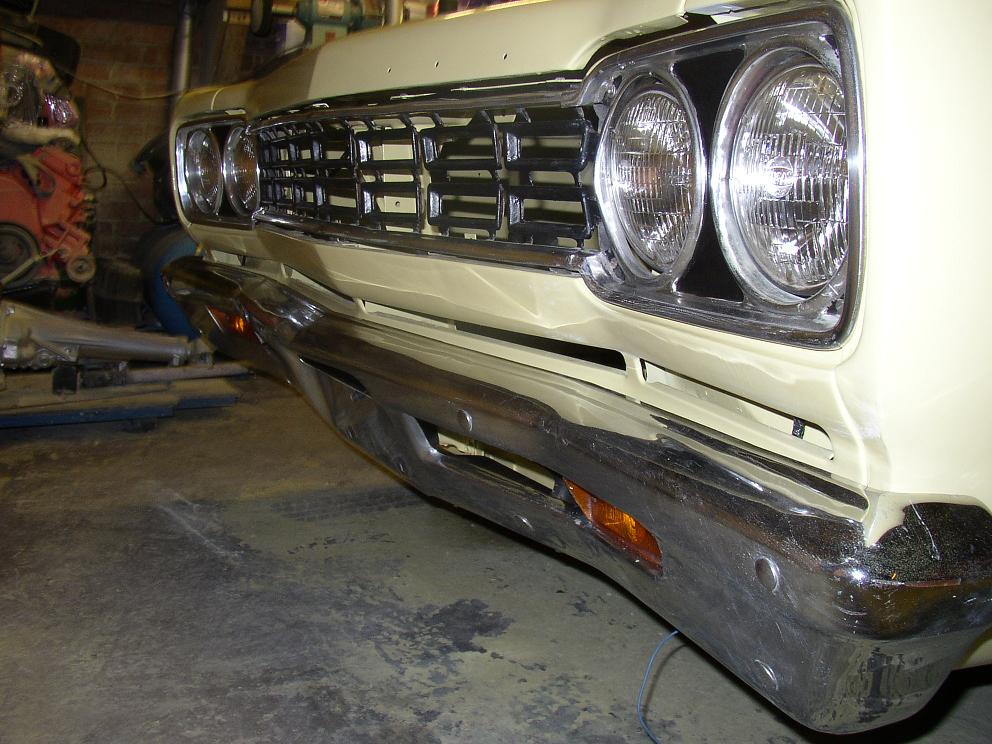

grill sorted
