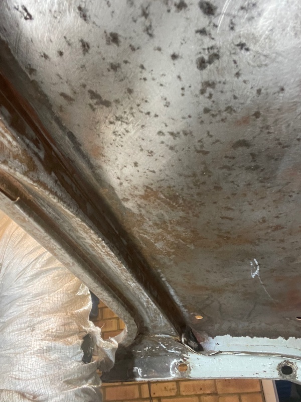

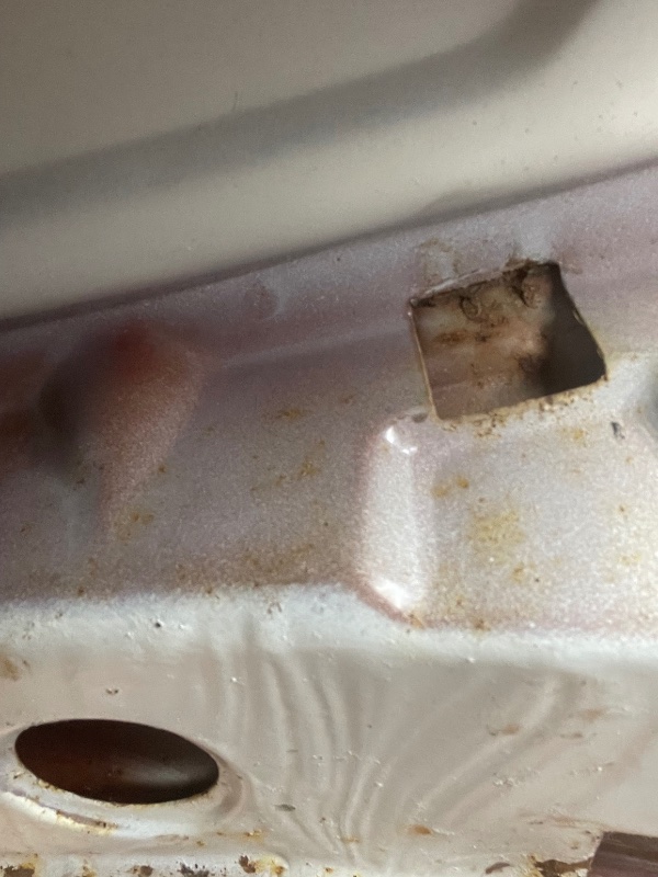

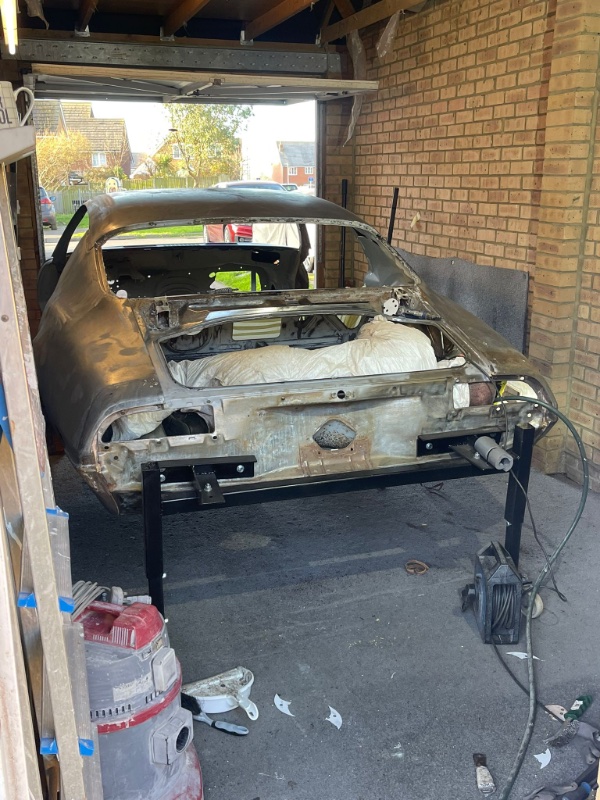

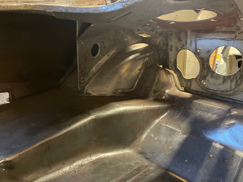

Got most of my mobility back so managed to get a few hours on my Body Shell,
Dark , wet and generally crap weather today so metal cleaning was order of the day
So back in the boot !
Generally very good with some light pitting
Got some pitting around the boot hinge bases which will hole so got some welding repairs to do

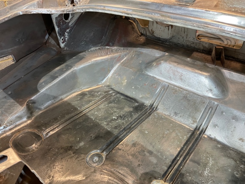

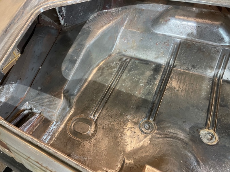

Managed a few hours today, weather was rubbish again so carried on cleaning the boot area,
It’s a horrible job as access is terrible and has to be done through the tiny boot lid opening!
I’ actually have to fold myself up and squeeze into the trunk
Not easy at my age and especially with my damaged limbs !

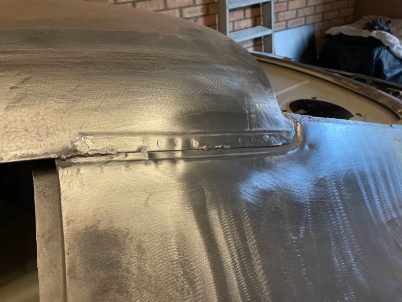

I also pulled the lead fill from the sail panel all looks good apart from a few tiny Pitts which will have to be dealt with,
Hopefully the other side will be similar,
The lead fill has been in there for 55 years almost
So it pays to pull it and relead it , as one never knows what’s going on beneath!!

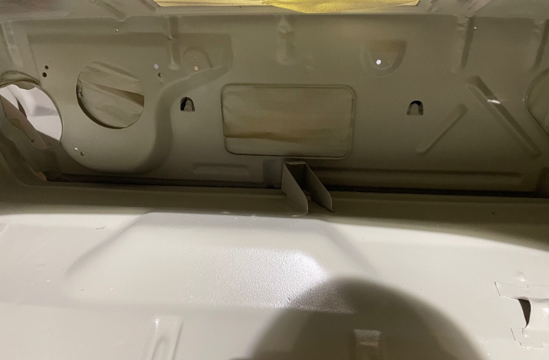

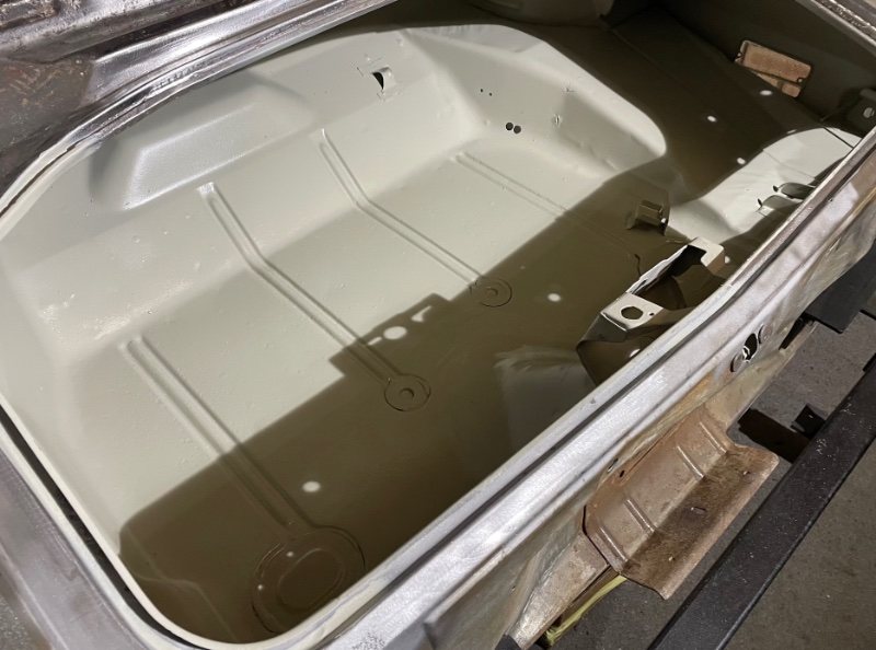

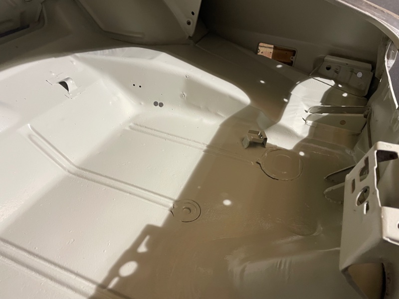

Weather changed completely today so I decided to go for it
Nine hours later my boot floor and rear bulkhead is in Epoxy!
So pleased as this was a complete bitch to do

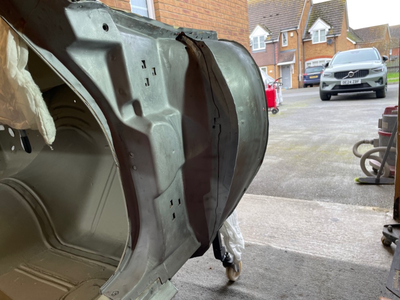

Also got time to

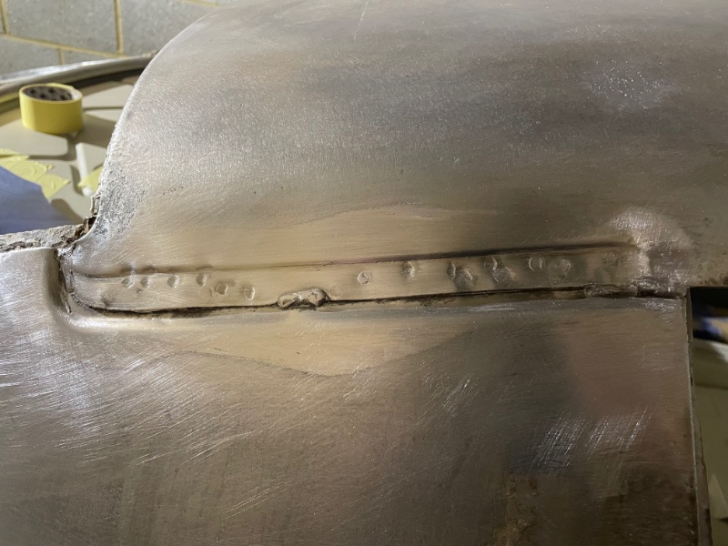

Pull the lead from the offside , all good except for a rather large hole at the corner of the rear screen flange
Well I say large it’s about the size of my little finger
Must have been like it when the roof and quarter were welded on , so the factory just filled with lead !
Lovely
Lovely

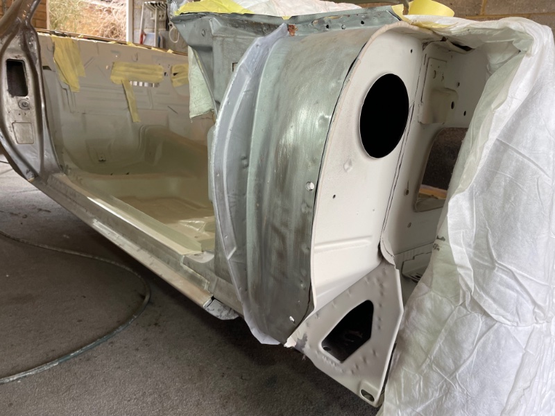

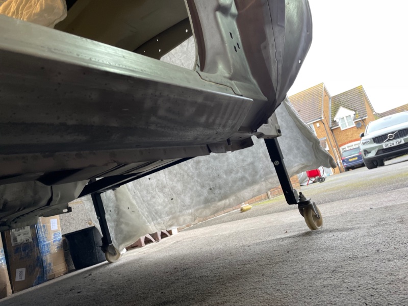

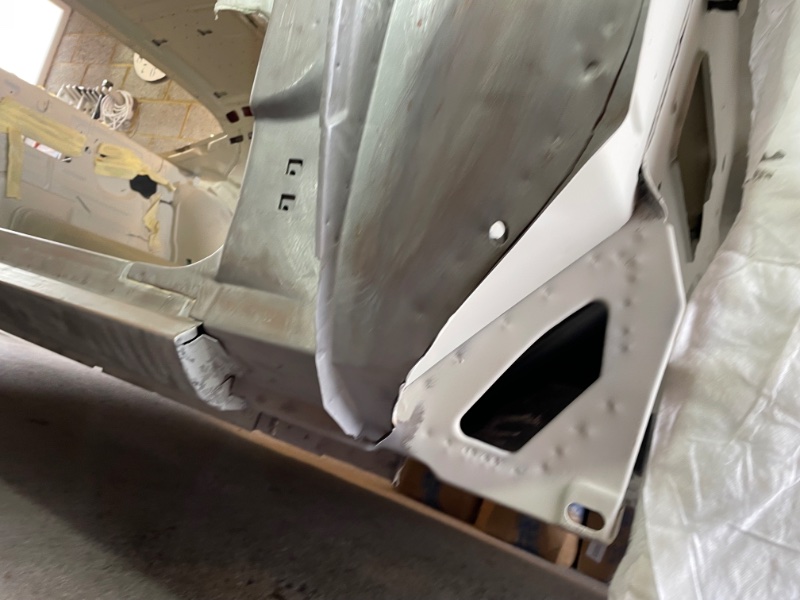

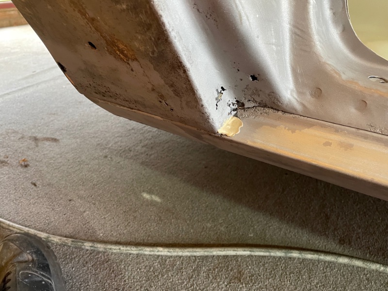

Been busy couple of days ,
Boot area is all fully sealed now thank goodness!
And finally got around to getting the right hand A post and Rocker blasted and now in Epoxy,
Unfortunately I’ve uncovered some corrosion at the rear lower quarter but to be honest not surprising given it location, so I’ve now got to do some actual restoration!!

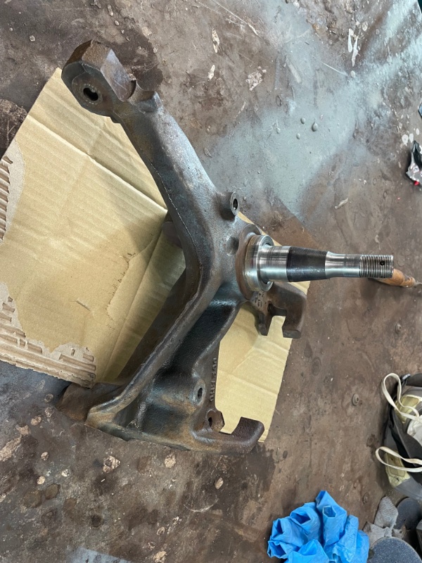

I’ve still been doing some stuff at work,
Strings, brake drums, spindles etc so at least a little bit more done !
Got a couple a small dings but nothing savage

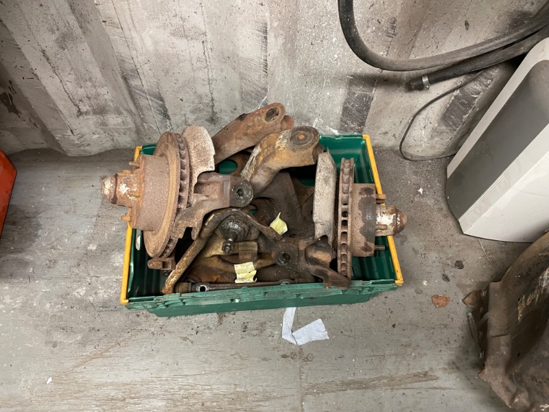

Got 4 new shocks Koni’s , full poly body mounting kit
Full poly bushes fit a rear springs, new sway bar bushes
New top and bottom ball joints , and a couple of new engine bits, Water pump and new timing chest cover etc
The bloody list seems endless!!
