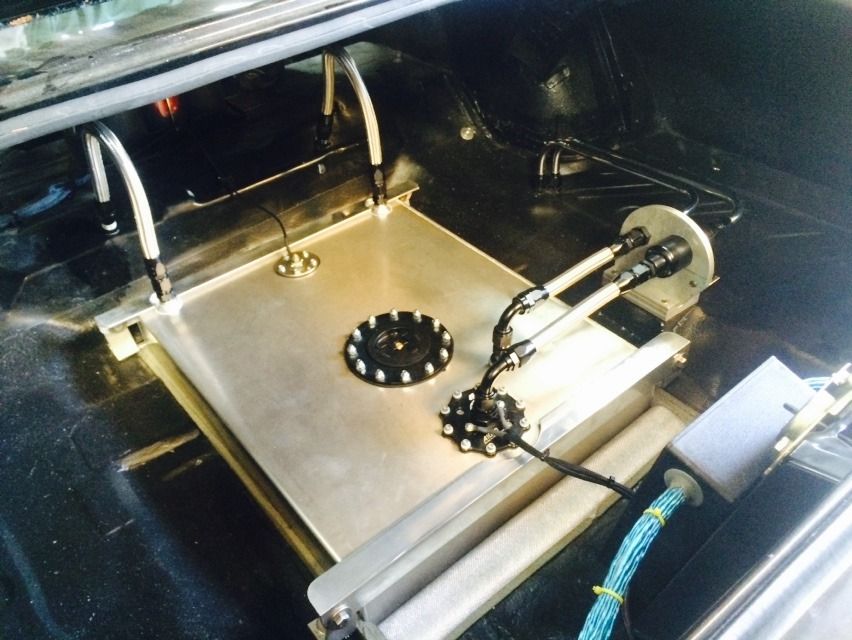

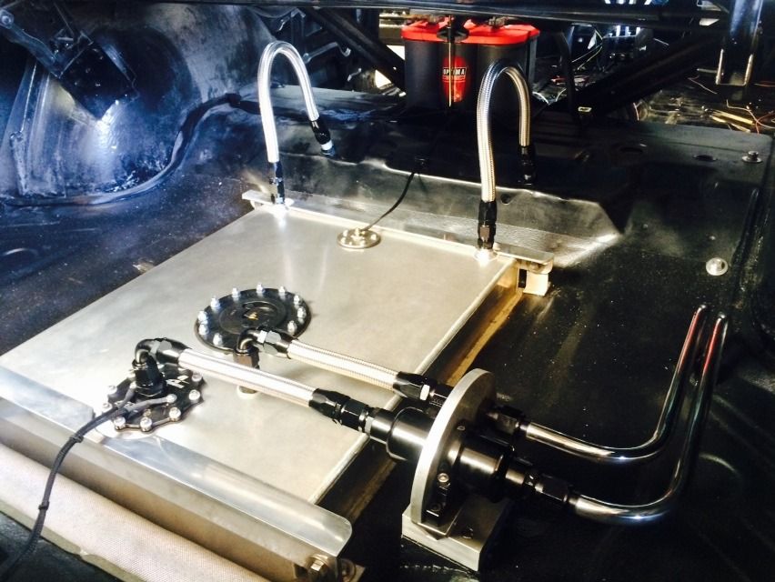

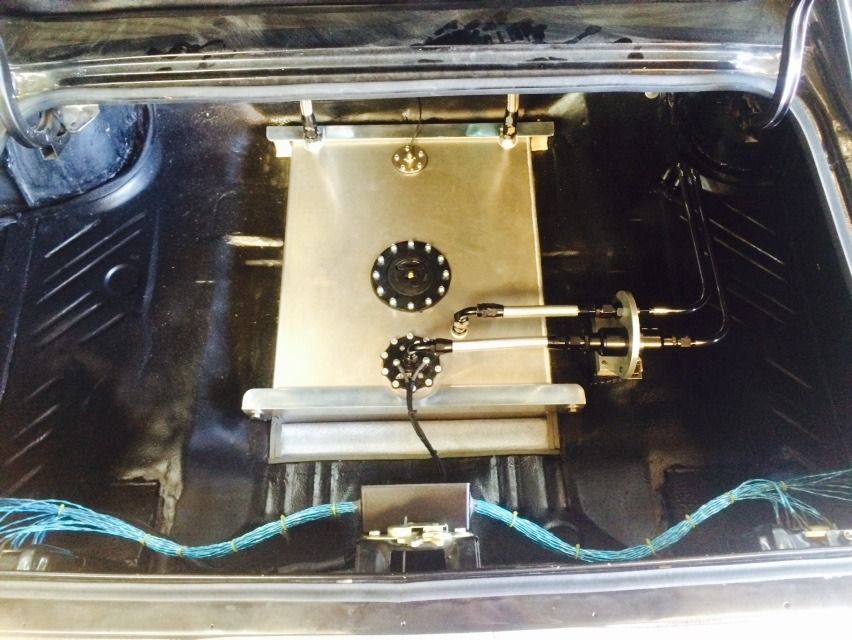

Finshed installing the tank and fuel lines

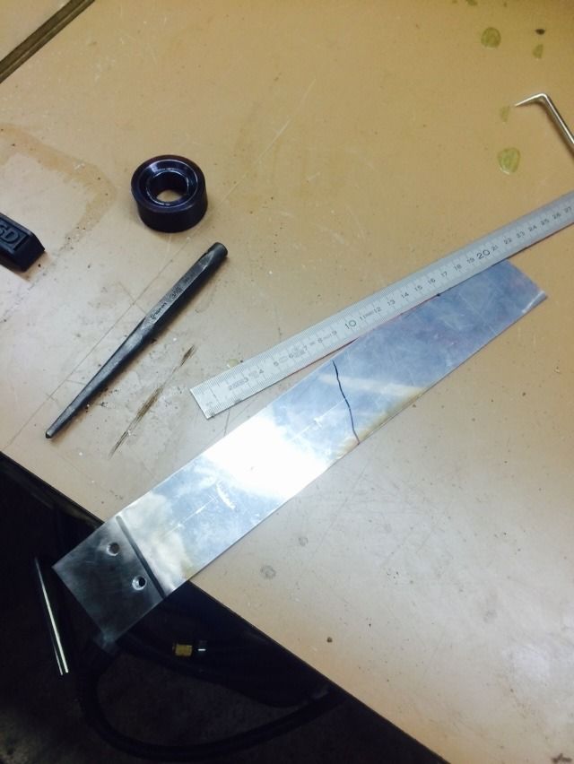

Made a Alu bracket to hold second finer filter (Course filter and pump in tank)
Welded a plate off boot floor
Slowly ticking jobs off list
<a href="http://s73.photobucket.com/user/autofet ... d.jpg.html" target="_blank"><img src="http://i73.photobucket.com/albums/i205/ ... uzo28d.jpg" border="0" alt=" photo F4D36A79-C6A4-4ABB-AF04-BC74341137F5_zpstouzo28d.jpg"></a>
<a href="http://s73.photobucket.com/user/autofet ... 7.jpg.html" target="_blank"><img src="http://i73.photobucket.com/albums/i205/ ... jt5vz7.jpg" border="0" alt=" photo 40B1D264-4D1C-4E91-90E2-564D13B65CD6_zpsqgjt5vz7.jpg"></a>
<a href="http://s73.photobucket.com/user/autofet ... s.jpg.html" target="_blank"><img src="http://i73.photobucket.com/albums/i205/ ... vwxl8s.jpg" border="0" alt=" photo 32175702-ED6D-4028-B27A-94B25F0E0139_zpsjhvwxl8s.jpg"></a>

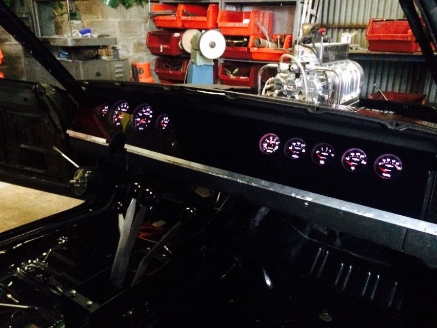

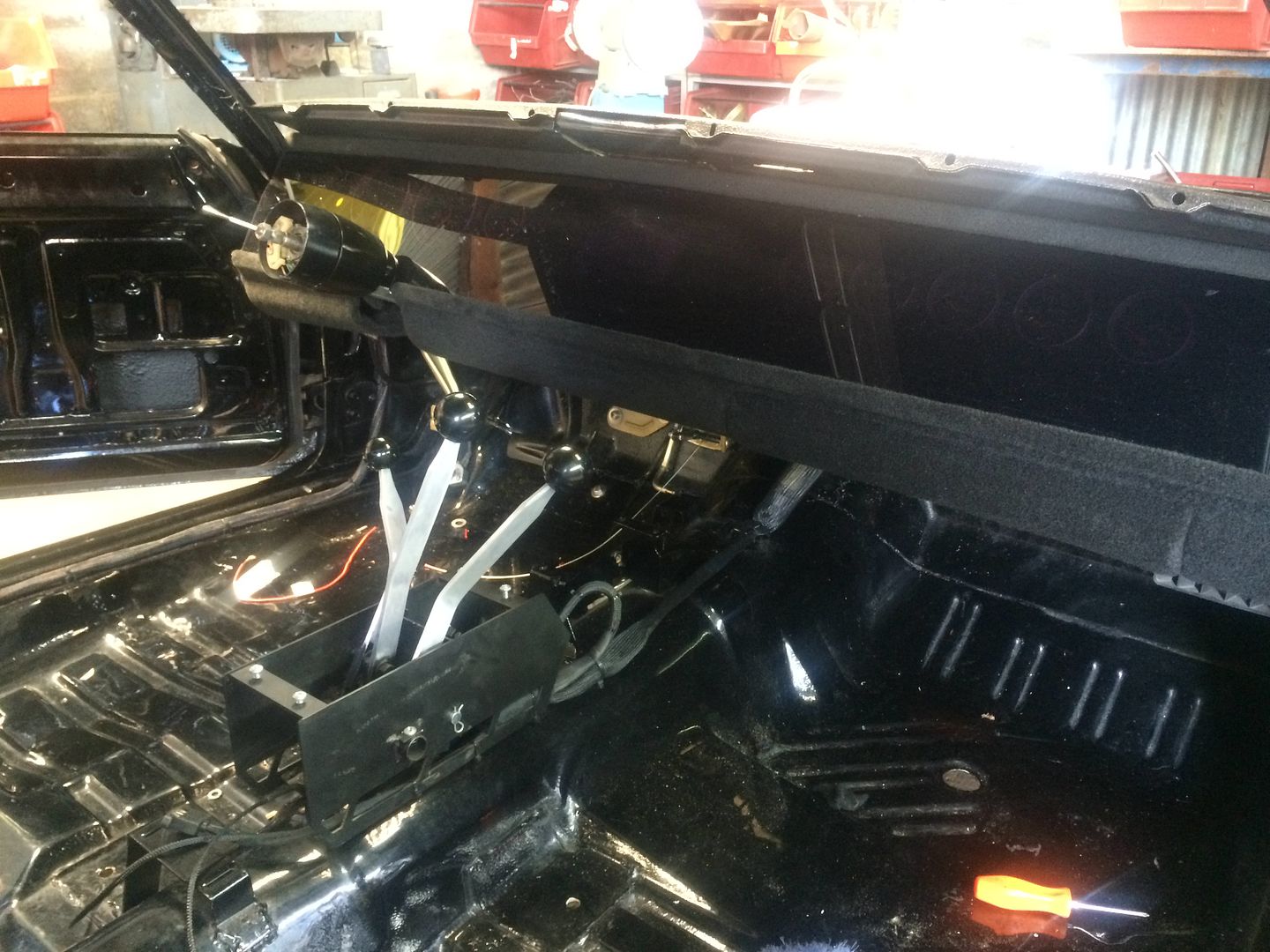

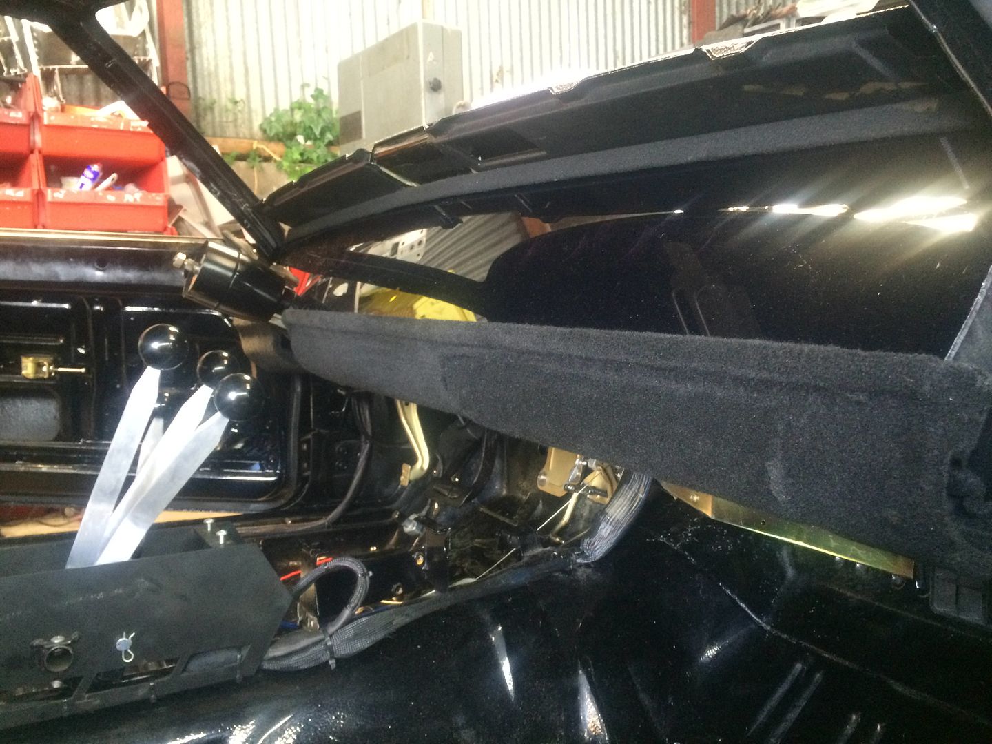

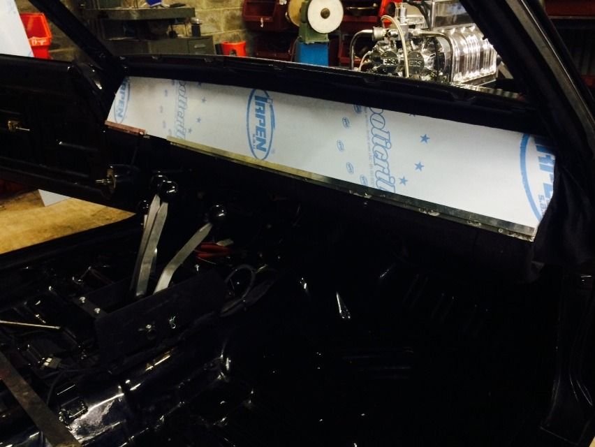

Dash all done and every switch works
<a href="http://s73.photobucket.com/user/autofet ... l.jpg.html" target="_blank"><img src="http://i73.photobucket.com/albums/i205/ ... 42feel.jpg" border="0" alt=" photo DD017563-4C9F-48B7-930A-1E49853C9216_zps3542feel.jpg"></a>
<a href="http://s73.photobucket.com/user/autofet ... y.jpg.html" target="_blank"><img src="http://i73.photobucket.com/albums/i205/ ... nkocky.jpg" border="0" alt=" photo ECFDB844-DA25-403B-83F3-47D7BD14CB00_zpstjnkocky.jpg"></a>
<a href="http://s73.photobucket.com/user/autofet ... b.jpg.html" target="_blank"><img src="http://i73.photobucket.com/albums/i205/ ... aekiub.jpg" border="0" alt=" photo DF9A9E8F-78B7-4CF2-87B9-F85B041B6CFC_zpsvlaekiub.jpg"></a>
<a href="http://s73.photobucket.com/user/autofet ... 1.jpg.html" target="_blank"><img src="http://i73.photobucket.com/albums/i205/ ... jb31h1.jpg" border="0" alt=" photo CC961030-F654-495A-8C13-6C53C5299420_zpsc2jb31h1.jpg"></a>

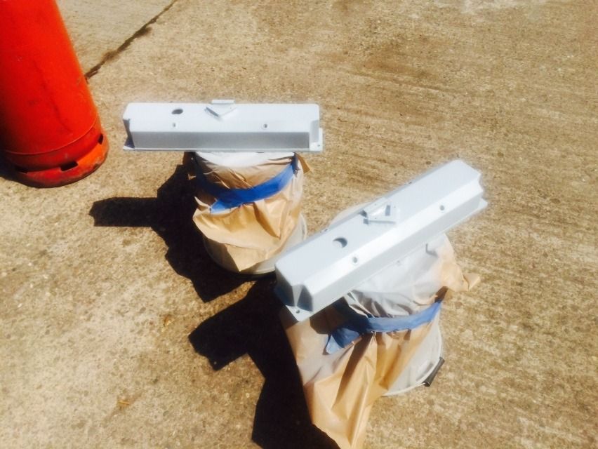

But she is a right bag of Bananarama! close up

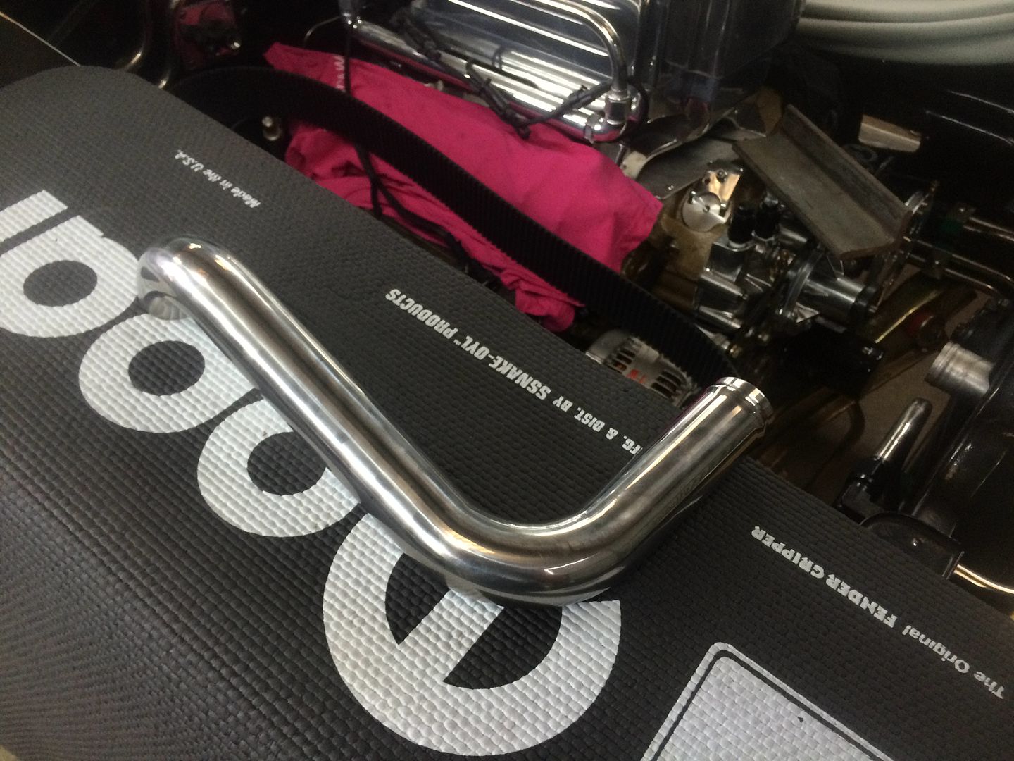

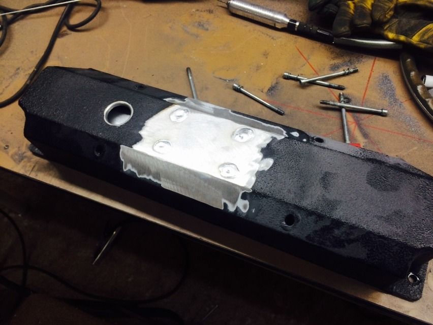

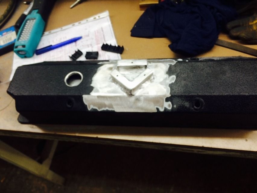

I had mounted my Bosch coil pack on the valve covers.
But as the engine does not have the firing order of a V10 Ferrari so I need to run HT leads from the same coil pack to different banks.

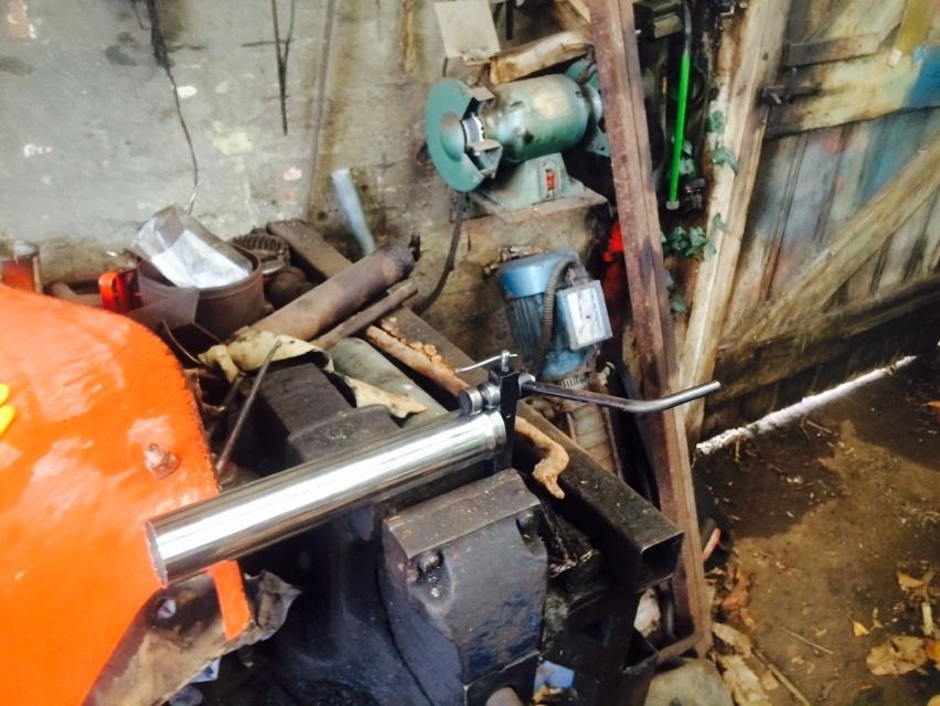

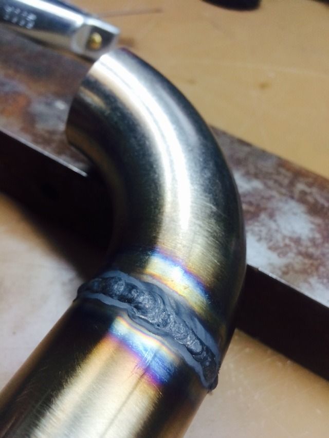

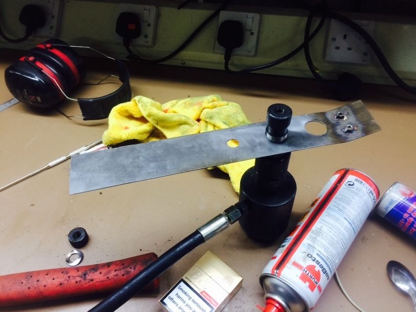

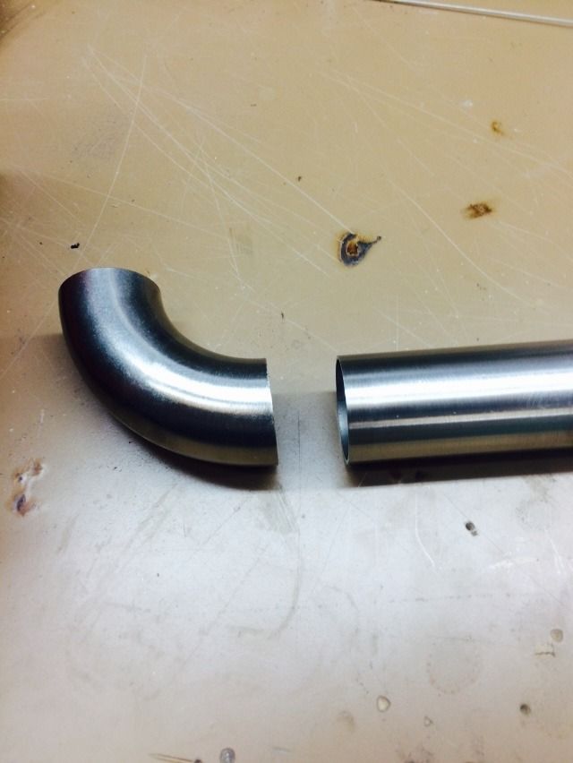

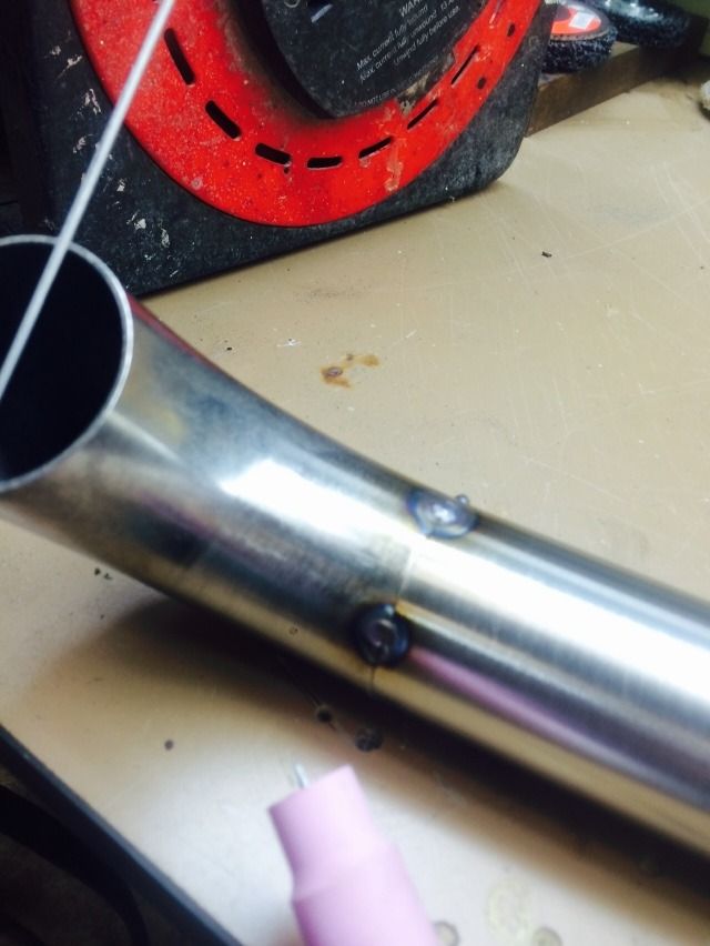

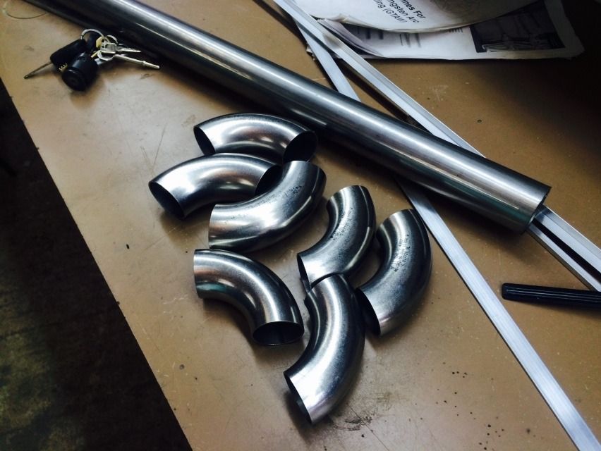

I finally took the Plunge ( you where right roger) and brought a decent TIG welder. My Alu and stainless is getting better every day.
<a href="http://s73.photobucket.com/user/autofet ... a.jpg.html" target="_blank"><img src="http://i73.photobucket.com/albums/i205/ ... mcnppa.jpg" border="0" alt=" photo A69CD56C-0A68-457A-99F4-5F6A9AD9E749_zpseemcnppa.jpg"></a>
<a href="http://s73.photobucket.com/user/autofet ... f.jpg.html" target="_blank"><img src="http://i73.photobucket.com/albums/i205/ ... ts9gnf.jpg" border="0" alt=" photo FEBE0E05-5102-4394-B015-78A42D89BDD1_zpslmts9gnf.jpg"></a>
<a href="http://s73.photobucket.com/user/autofet ... f.jpg.html" target="_blank"><img src="http://i73.photobucket.com/albums/i205/ ... m4ebif.jpg" border="0" alt=" photo A72F2D8C-2982-410C-90FD-B631D3DC59E0_zpsutm4ebif.jpg"></a>
<a href="http://s73.photobucket.com/user/autofet ... f.jpg.html" target="_blank"><img src="http://i73.photobucket.com/albums/i205/ ... peqztf.jpg" border="0" alt=" photo 3E0C2021-C5CD-45C8-A82B-FDFA33498C11_zpsdxpeqztf.jpg"></a>

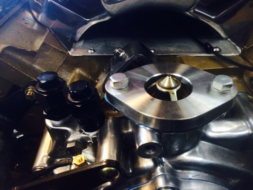

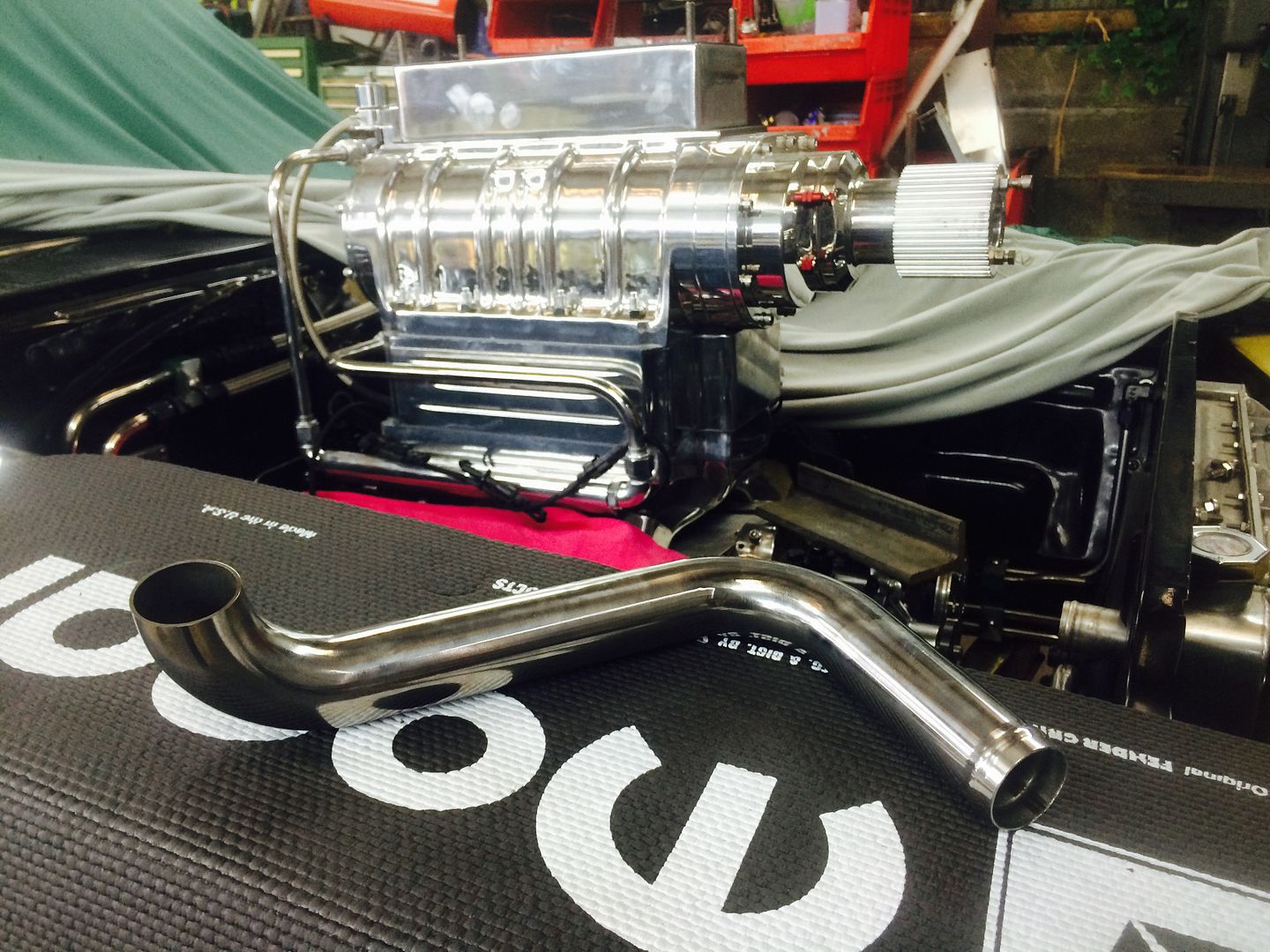

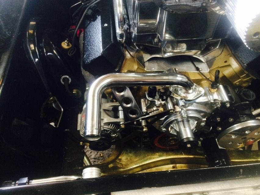

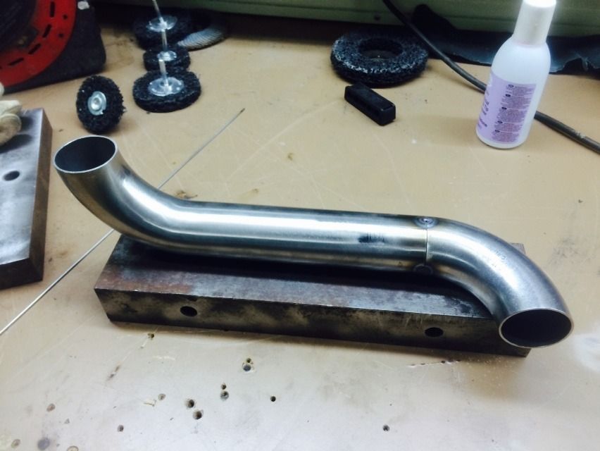

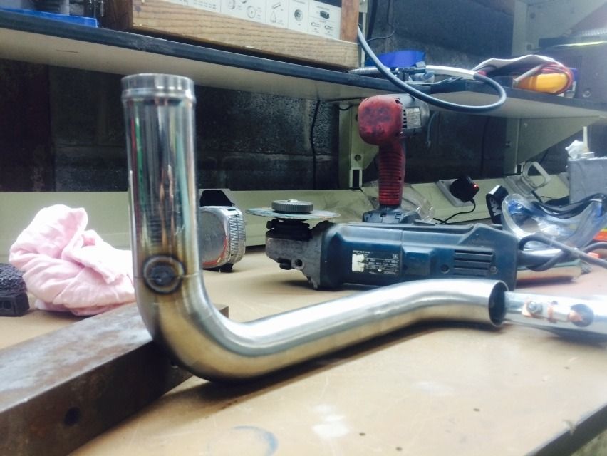

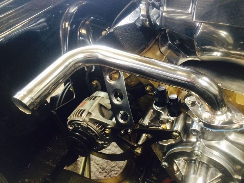

Rad top hose
