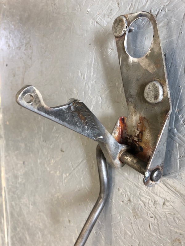

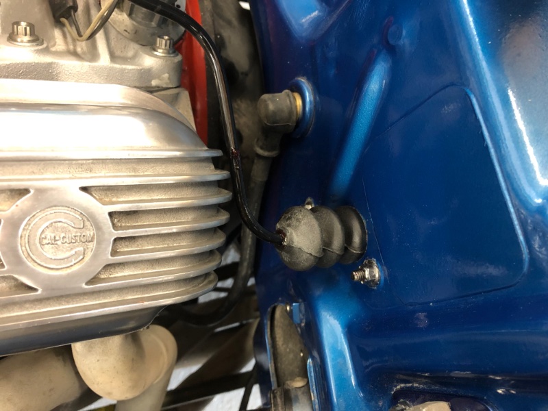

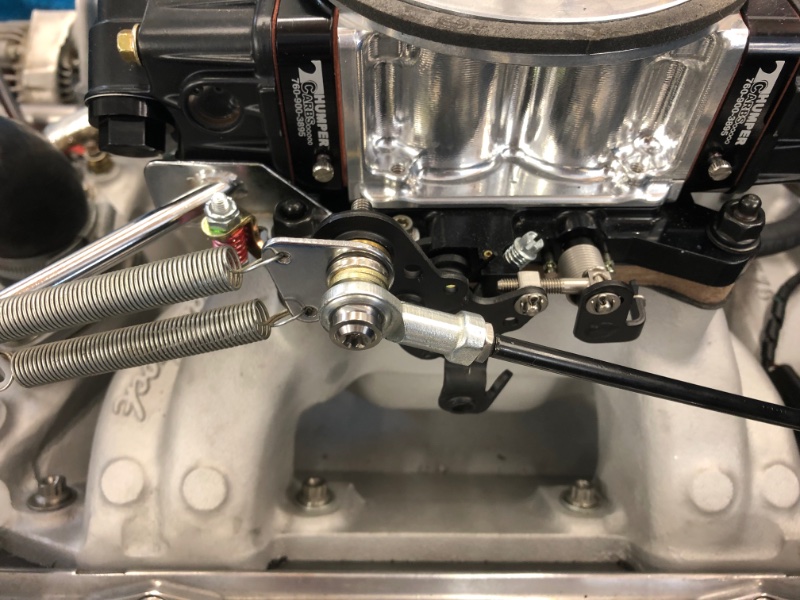

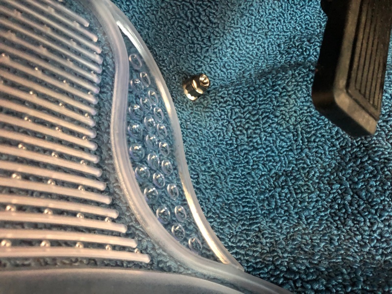

Not keen on throttle cables, I much prefer the lightness and direct action of a rod, especially for racing. Pedal needed a bit adding to take a clevis, and a bit of threaded tube welding into the floor for an adjustable pedal stop. You need one of these with this kind of set up to avoid bending or straining anything with your heavy footedness. Bit of rod bent to suit and a rod end and jobs a sausage. A boot from a Girling slave cylinder does the trick on the firewall.

Re: Blue's Barracuda
Interesting setup Blue. 😎
