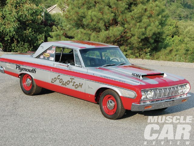

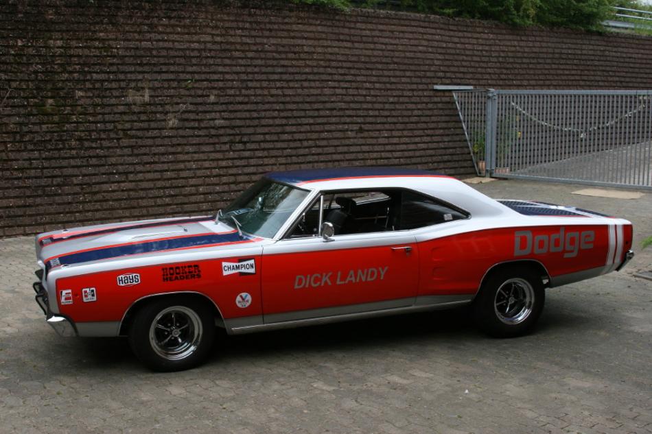

Something along these lines Paul ?
<img src="" alt="Uploaded with Imgupr">
Using your original colour and adding the white or silver ?? :thumbright:
Also I'm not sure about the glass hood- keep it satin black or colour it?
That depends on how straight you can get it ,that is one of the reasons glass hoods are flat black is they are very hard to make them look nice in gloss with the tendencies to be wavy and un even
Just what I was thinking Drew, it would take a LOT of work to get it smooth.
I spotted those too Mossy! Along with these...
Not quite there but definitely giving me ideas. I might have to print a few shots and get me crayons out ;)

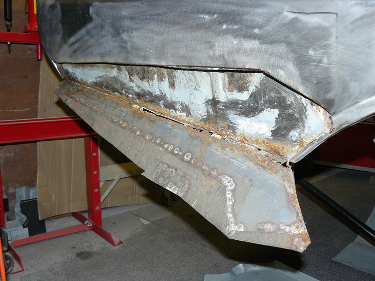

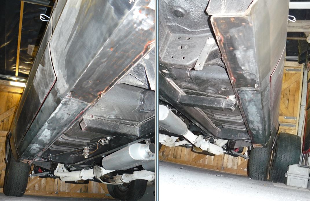

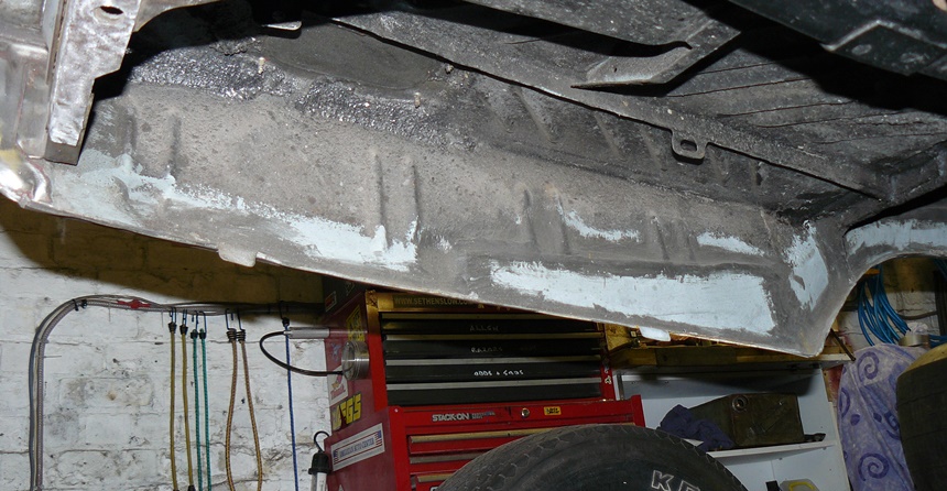

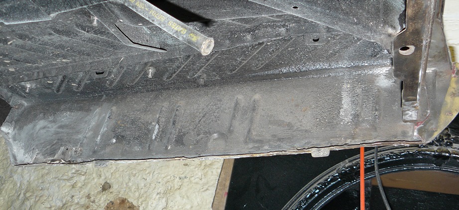

I've started cutting out the crap repairs done last year. Far worse than I thought!
I'm so glad he didn't do more damage, no wonder he can't find work anywhere!
I need to replace at least part of the trunk extensions but I've not found anywhere that does repro pieces. I'll have to make my own ;)
Trunk extension. Pass side..jpg (191.58 KiB) Viewed 963 times
Rear fender 02.jpg (172.82 KiB) Viewed 963 times
Rear fender 01.jpg (182.74 KiB) Viewed 963 times
Trunk extension. Driver side.jpg (194.56 KiB) Viewed 959 times
WOW that was done last year? jeeze it is stuff like this , you might as well do it all your self , that has always been the issue , have some else do it and cover up the crap work,
or do it your self so you know it is done correctly :read2: and it takes twice as long to fix something that was done wrong ,rather than doing it right the first time

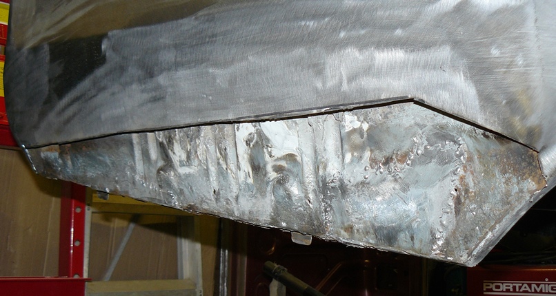

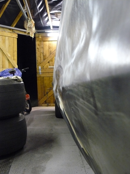

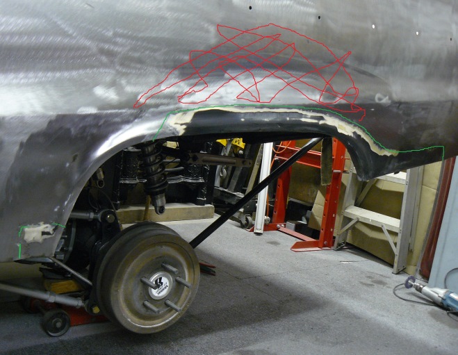

A busy day today but I managed to fit in some car time ;)
I've virtually stripped the last of the paint and filler off now, the sills (rocker panels?) like the rest of the sheet metal, are in great shape.
I'll probably paint into the door shuts but I'll just flat the paint there rather than strip to bare metal.
In the shot of the wheel arch I've marked edge of the old patches in green and the area distorted by overheating the steel in red :evil:
You can sort of see the dip in the bodyline in the last pic.
Rear wing driver.jpg (181.88 KiB) Viewed 918 times
Rear arch driver.JPG (124.03 KiB) Viewed 918 times

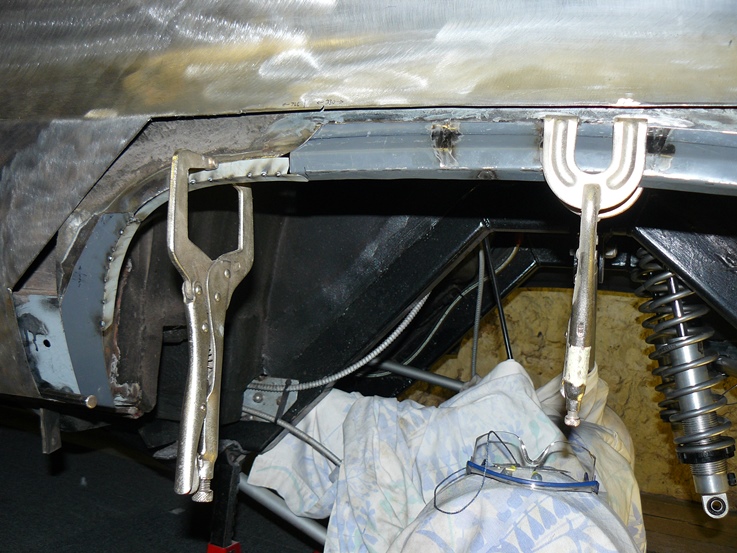

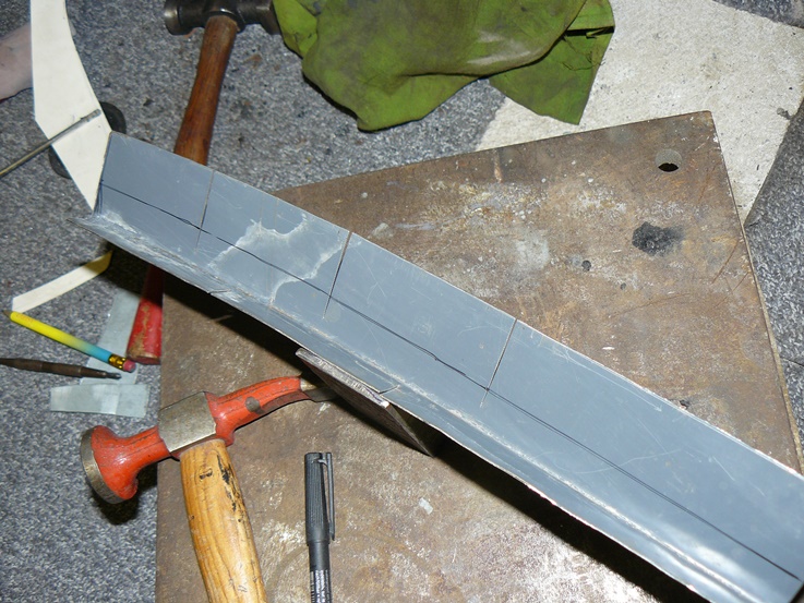

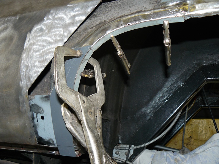

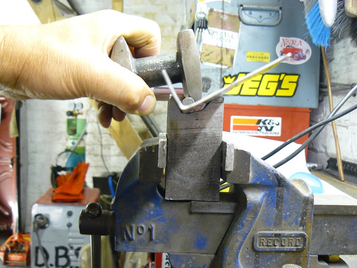

I've started repairing the inner panel, driver side arch.
I'm making all the pieces ready, but I wont weld them in until the outer panel is welded on- then I can get the outer perfect and adjust the inner pieces to fit.

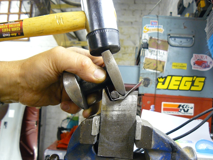

I had a practice with my home-made dolly to form the mid-section inner repair section, it worked like a dream!
I'm happy now that I should be able to improve the crappy Sherman outer panel! :thumbright:
04 Driver side arch, middle bit shaping up.jpg (194.76 KiB) Viewed 836 times
03 Driver side arch, middle bit on dolly.jpg (197.97 KiB) Viewed 836 times
02 Driver side arch, middle bit.jpg (213.93 KiB) Viewed 836 times

And the bits in place!
05 Driver side arch, middle bit test fit.jpg (206.34 KiB) Viewed 835 times
