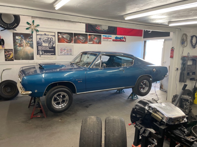

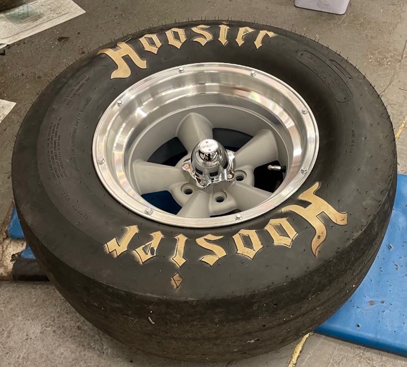

Winter upgrades finally started! Torque Thrust originals to replace the borrowed wheels for my slicks. I had the paint bead blasted off the centres in a further attempt to get the look of the original wheels.

Ta, just need to raise the money to get some matching fronts with lightweight tyres for the track.

Finally got the Barracuda back in the shop Today so time to crack on!
Re: Blue's Barracuda

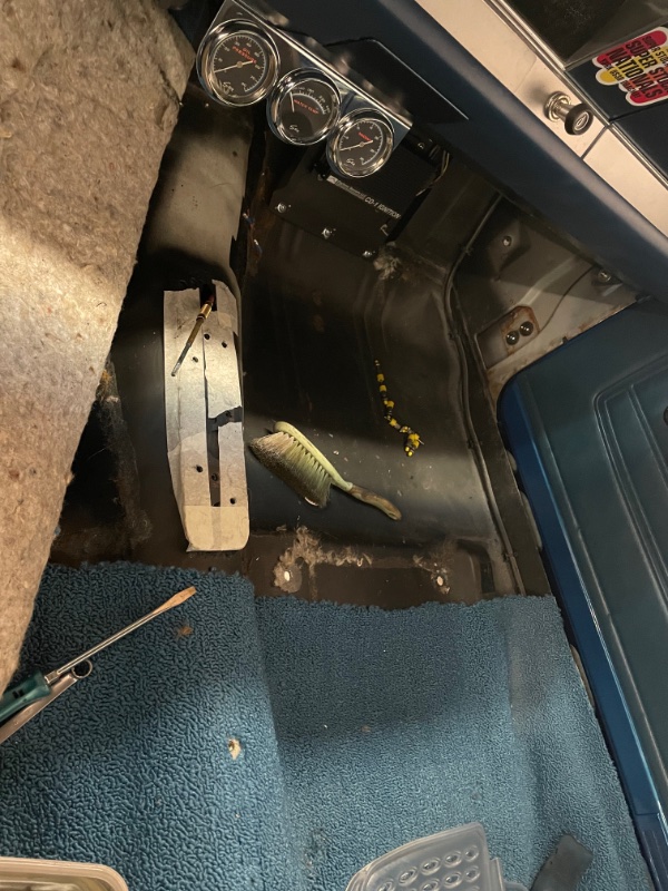

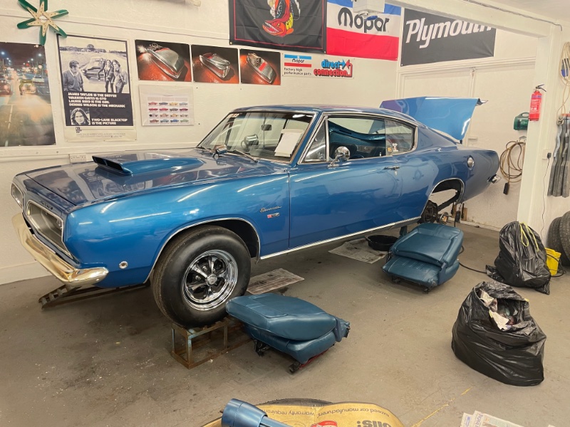

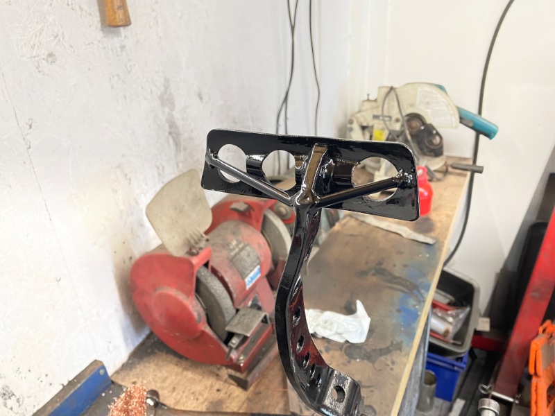

Braced up the brake pedal pad which was bending due to my over exuberant pumping of the pedal while setting the line lock. Steering column out for some mods and to fit a new indicator switch. Diff out to fit a forged 1350 yoke in preparation for getting a new prop made.
Seats out??
Just for access?
I have to take out the shifter and do some wiring, much easier with the seats out.

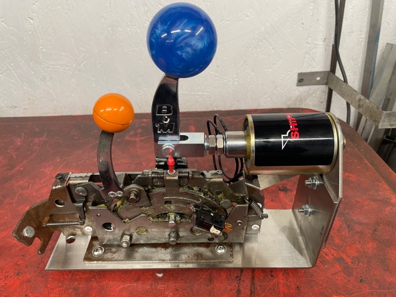

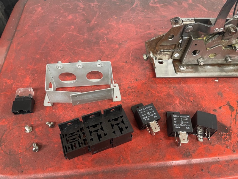

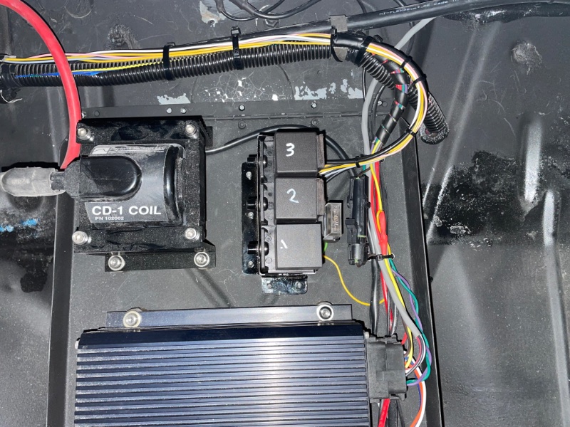

In an attempt to run more consistently in super stock I’m fitting a shifter solenoid. I can program my ignition system to operate it automatically at any RPM I like. It still allows me to operate the shifter manually the rest of the time. Unfortunately I have to fit a different shifter which means adapting it to the existing mount to fit it. It also requires 3 relays so I fabricated a mount for those. Fair bit of work but if it works like it should it will be worth the effort.

Luckily there was enough space on my electrics panel to mount the relay bank, so that's all sorted.
