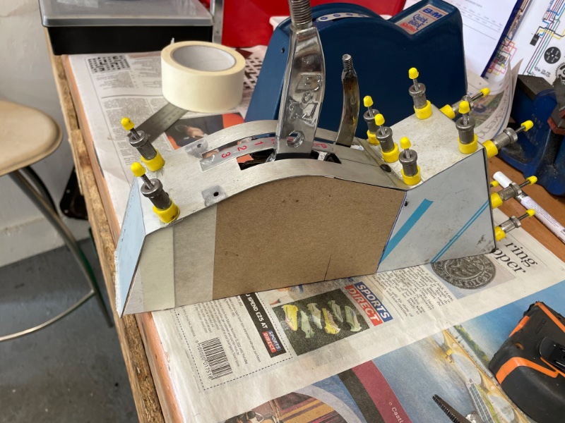

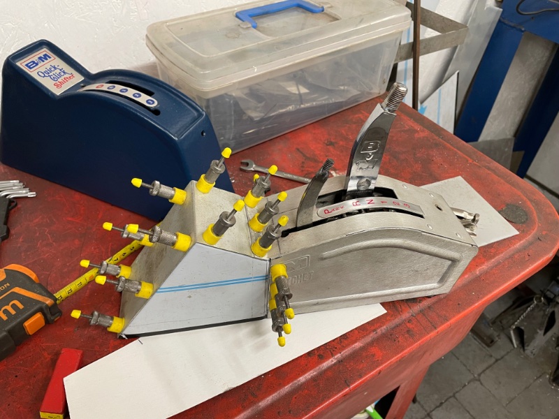

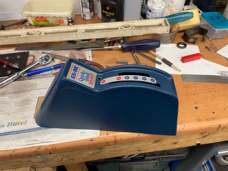

Really dislike the cheap looking tin cover for the Pro Ratchet shifter. The previous Quick Click has what I consider to be a great bit of stylish yet no nonsense design. I've set about a redesign which fully covers the cable exit using the old cover as inspiration, not sure where I'm headed with it its a work in progress..

nice one, are you going to bead roll it to match the b&m part?

No I want to get rid of the bead rolling, I’ll probably end up making new sides or beat it flat somehow and take a mould off it.

Looks like this is the way things are headed…

that'll work :thumbright:

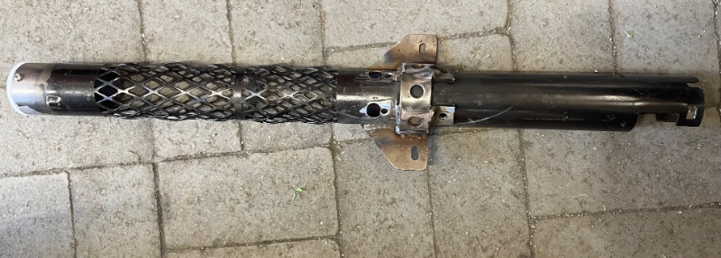

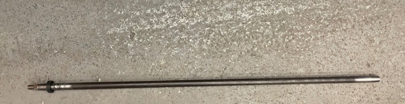

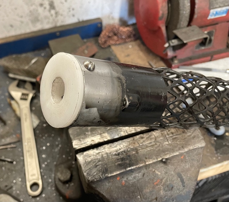

Bit of a steering column rebuild/ lighten/ tosh up going on Today. Had to get a nylon bush spun up to suit the new hollow steering shaft.

Top section of standard column grafted onto new hollow steering shaft ready to take a new UJ to fit to the steering box.

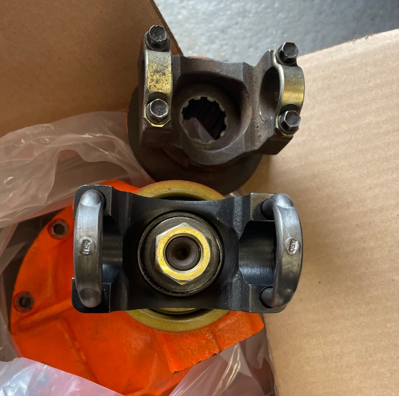

Re: Blue's Barracuda

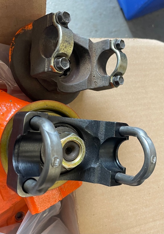

Diff fitted with billet yoke to take man sized 1350 UJ’s, original 7260 yoke for comparison.
