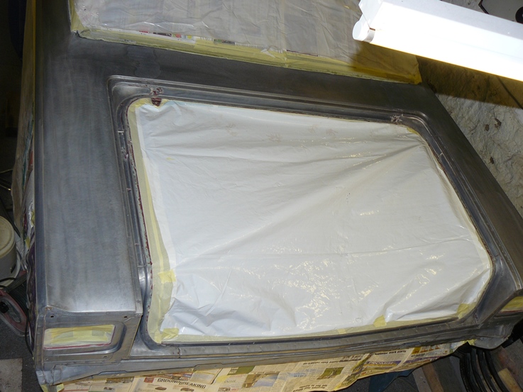

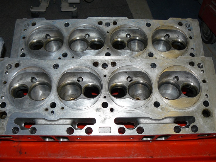

Frustrated cos the rear end is all ready for primer but it's too damn cold to paint. I settled for decoking my valves on the wire wheel.
Recommendations for decoking the heads anyone?
Rear end all ready for primer.jpg (178.95 KiB) Viewed 967 times

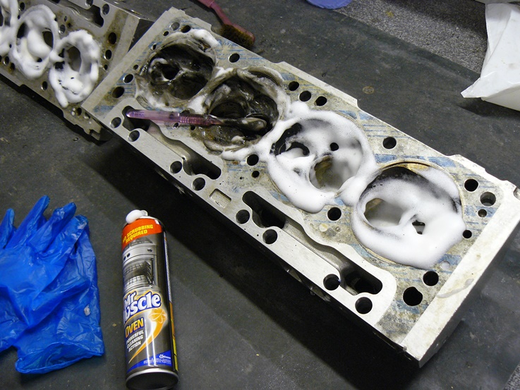

Mr muscle oven cleaner work a treat for decoding heads.

So obvious now you've said it!! Thanks mate :thumbright:
also soak in coke a cola
Well our oven cleaner says 'NOT FOR ALLY' so I'll pick up some Mr Muscle tomorrow. Or coke, whichever works out cheaper ;)

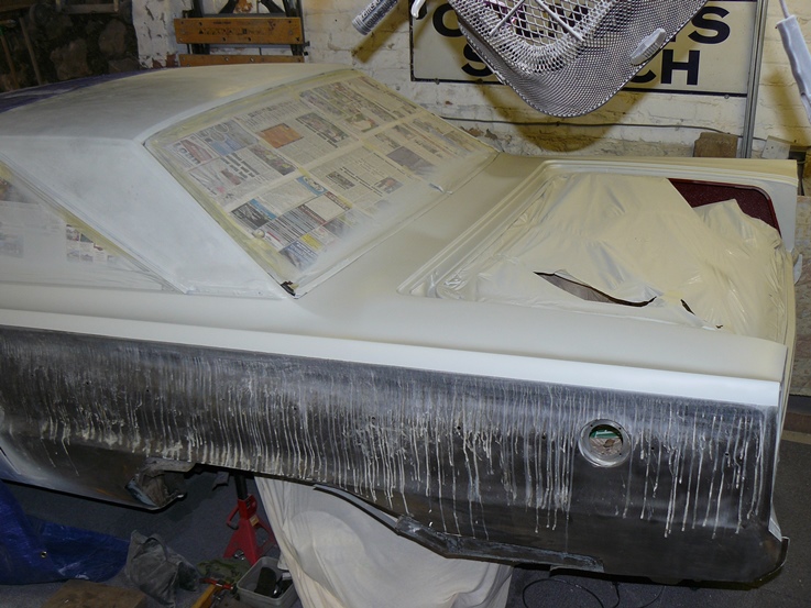

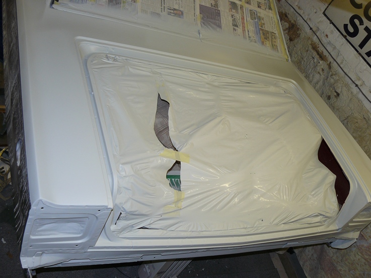

Meanwhile... rear end & tops of wings primered :thumbright:
The next job is welding up that wheel arch :help:
Rear end in primer 02.jpg (187.08 KiB) Viewed 1141 times
Rear end in primer 01.jpg (167.33 KiB) Viewed 1141 times
Back to the heads... An hour with the oven cleaner shifted a bit but not a lot. An overnight stay in Coke did bugger all so as A last resort I turned to some actual engine cleaner... :roll:
Good old Gunk and a brass wire brush shifted the lot in an hour or so's scrubbing :thumbright:
Head cleaning, gunk & wire brush.jpg (191.15 KiB) Viewed 1088 times
Head cleaning, Coke isnt it.jpg (213.02 KiB) Viewed 1088 times
Head cleaning, Mr Muscle.jpg (200.9 KiB) Viewed 1088 times

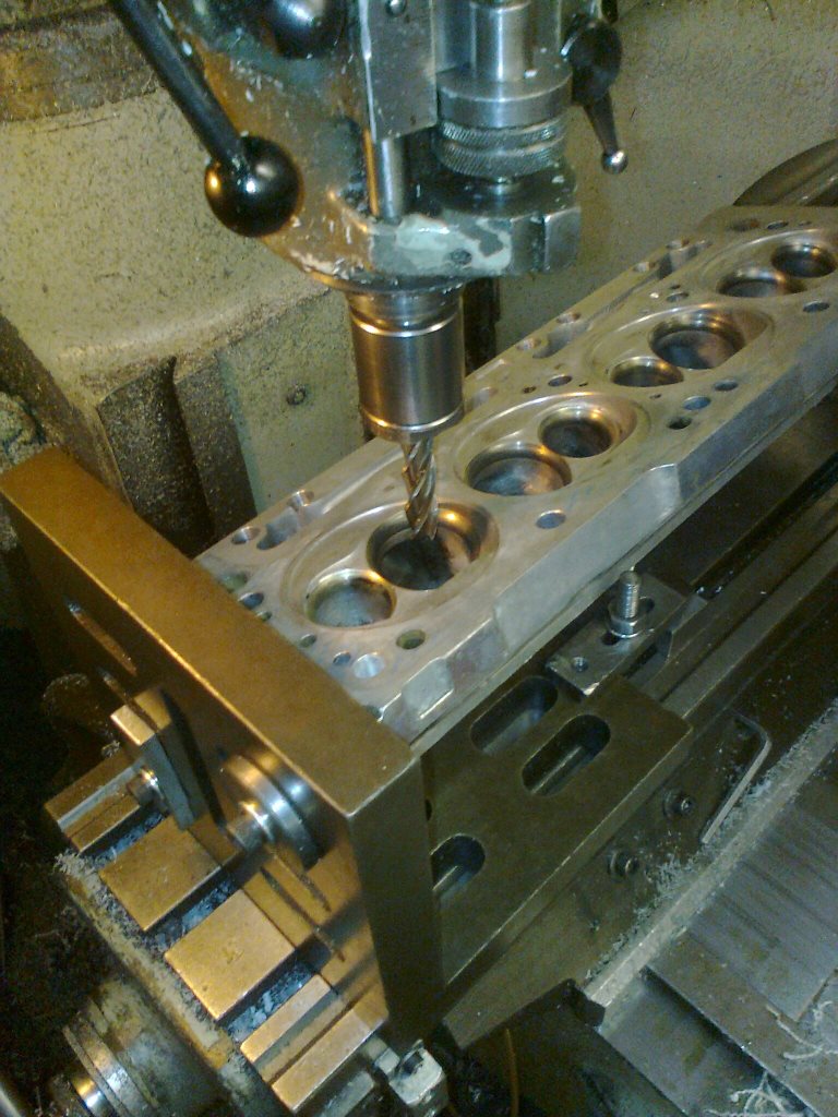

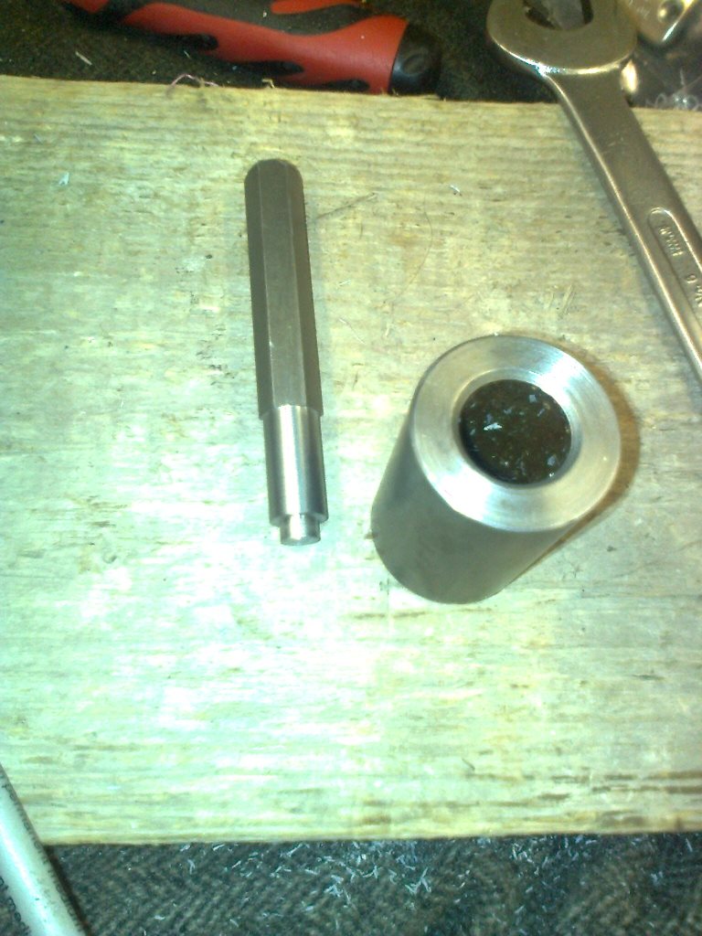

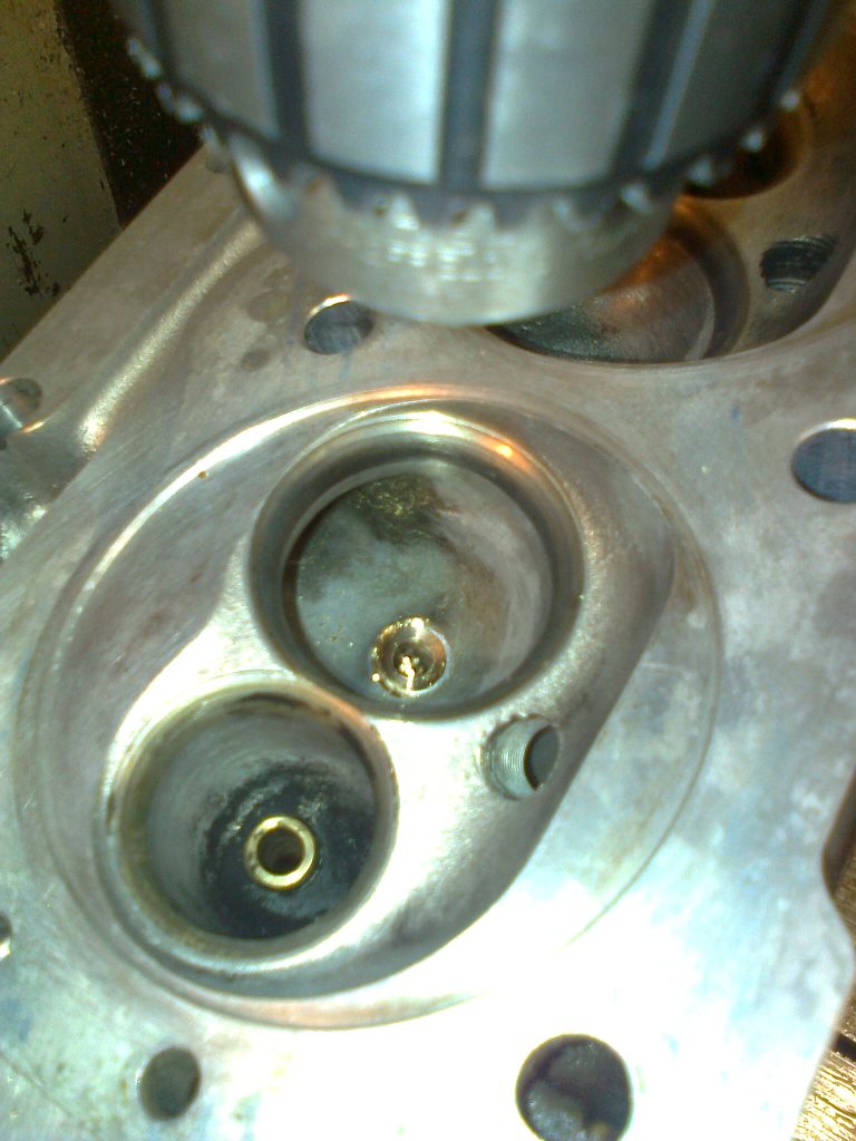

So this evening I popped up to see my mate Terry. We set the head up on his mill to remove the damaged part of the guide. He made a drift to fit it and found a bit of tube the fitted nicely into the valve spring well.
If we'd found the key to his gas bottle we'd have the guide out by now. Bugger!
Anyway I don't have the new guide yet so it'll be next week before we sort it.
