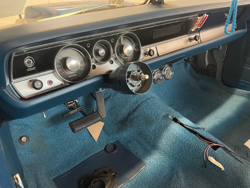

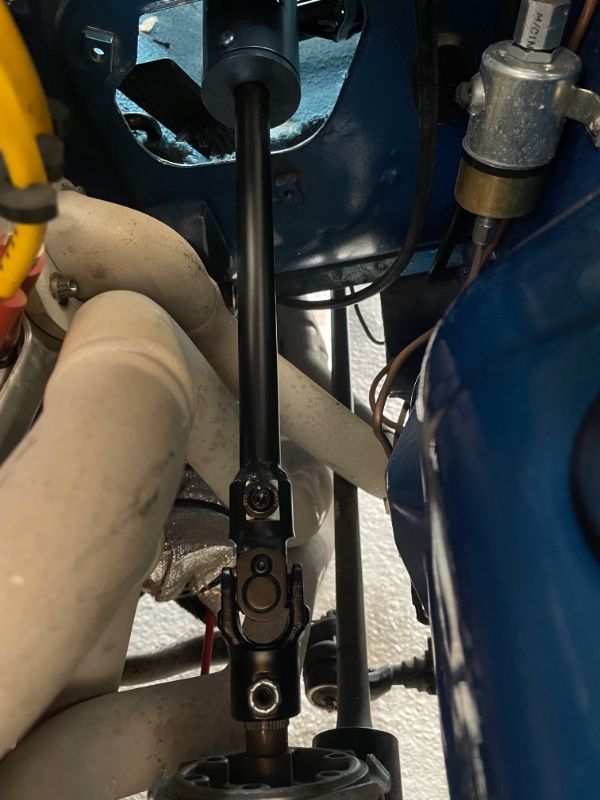

Nice upgrade, looks like that 1350 can take a lot more abuse :D
Posts: 14537

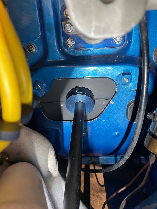

Re: Blue's Barracuda
Just need to fab a new firewall plate and the column is done.

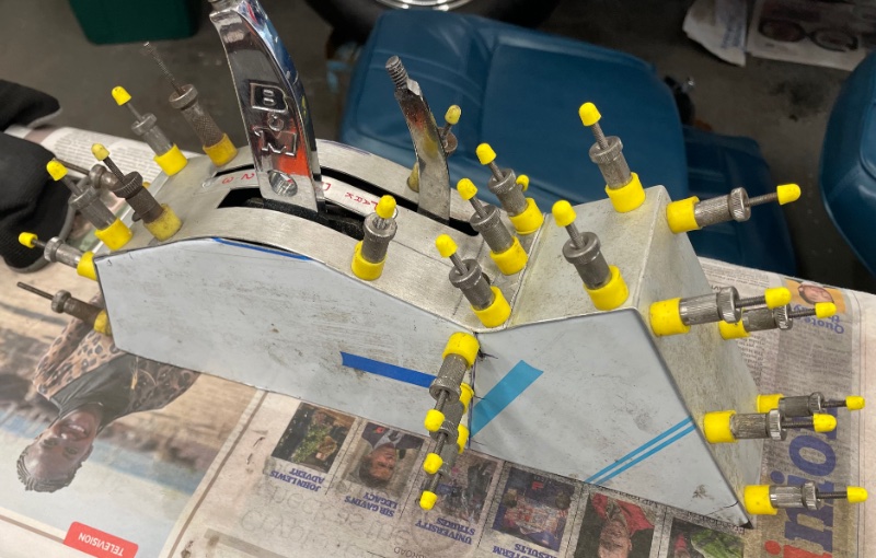

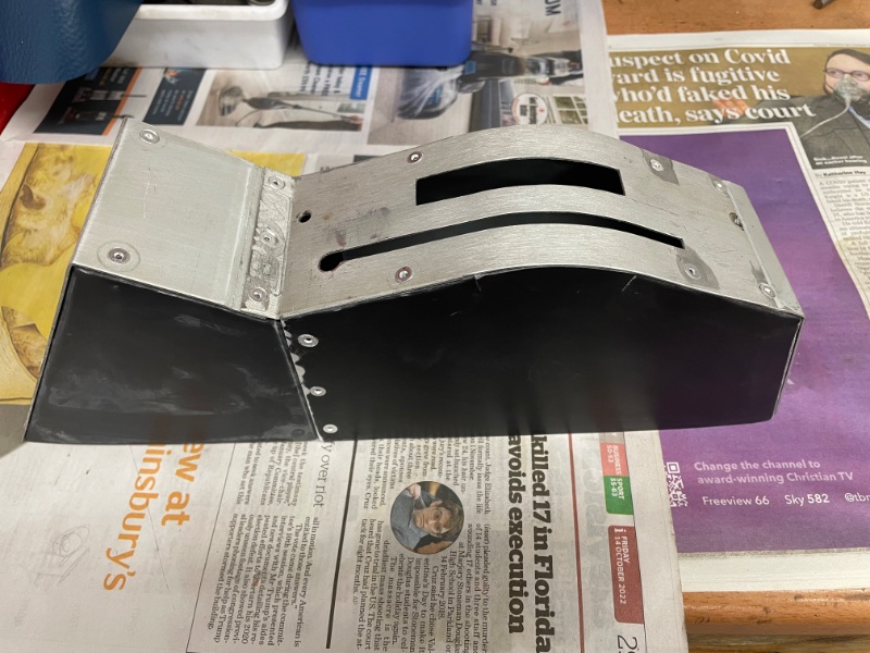

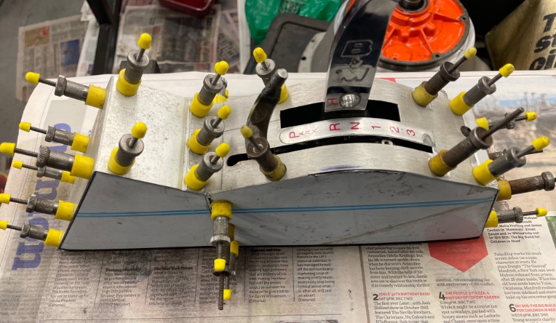

Posts: 14537
Found a couple of hours Today to finish off fabbing up the shifter cover. Bit more finessing and it can be riveted together for the next stage.

Posts: 5927
Wow, that looks neat work, you'll be restoring aircraft next. Those rivets look like they were borrowed from Duxford!
Posts: 14537
Yes Aircraft skin pins, excellent for temporary assembly. Cover is at this stage now, and column bulkhead cover is done.

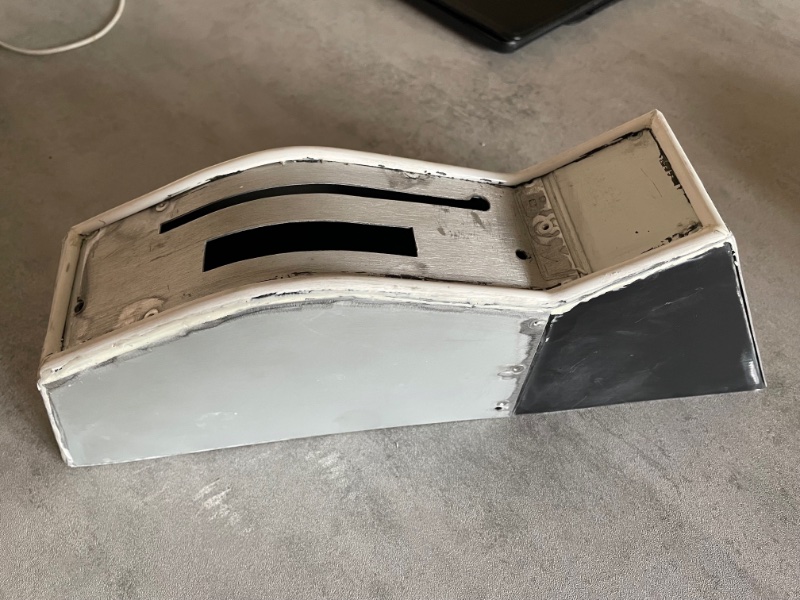

Posts: 14537
I used some half round styrene from a modelling supplier to add the edge detail. It bends easily to shape with a hot air gun and a bit of care, weatherstrip adhesive seems to stick it to ally easily enough. Just need to do some finishing off and then I can take a mould off it.
Posts: 7191
That looks great, Blue. How are you going to take a mould? Vacuum form?
